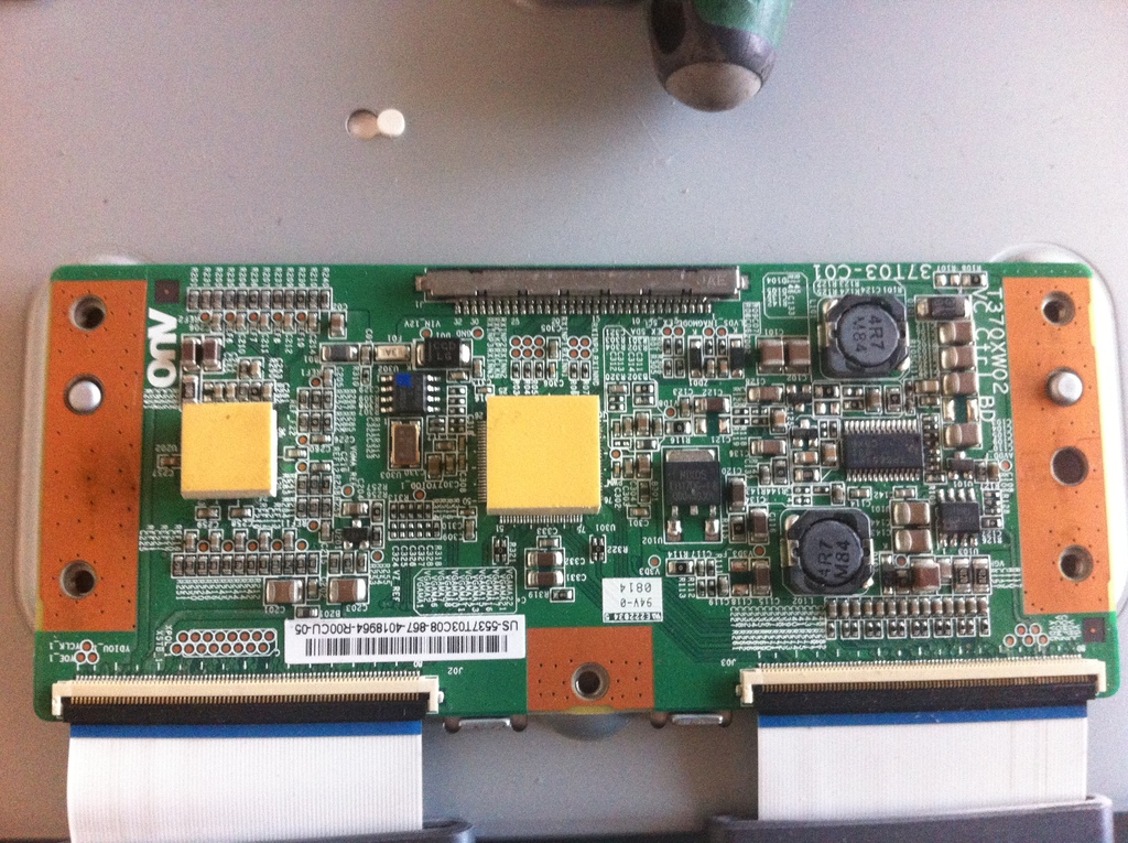

    Post a picture of the T-con board, please.

        The T-Con board is under the power supply. See the white LVDS ribbon cable going from the main board into the metal shield with a bunch of tape on it? That's where the T-Con board is.

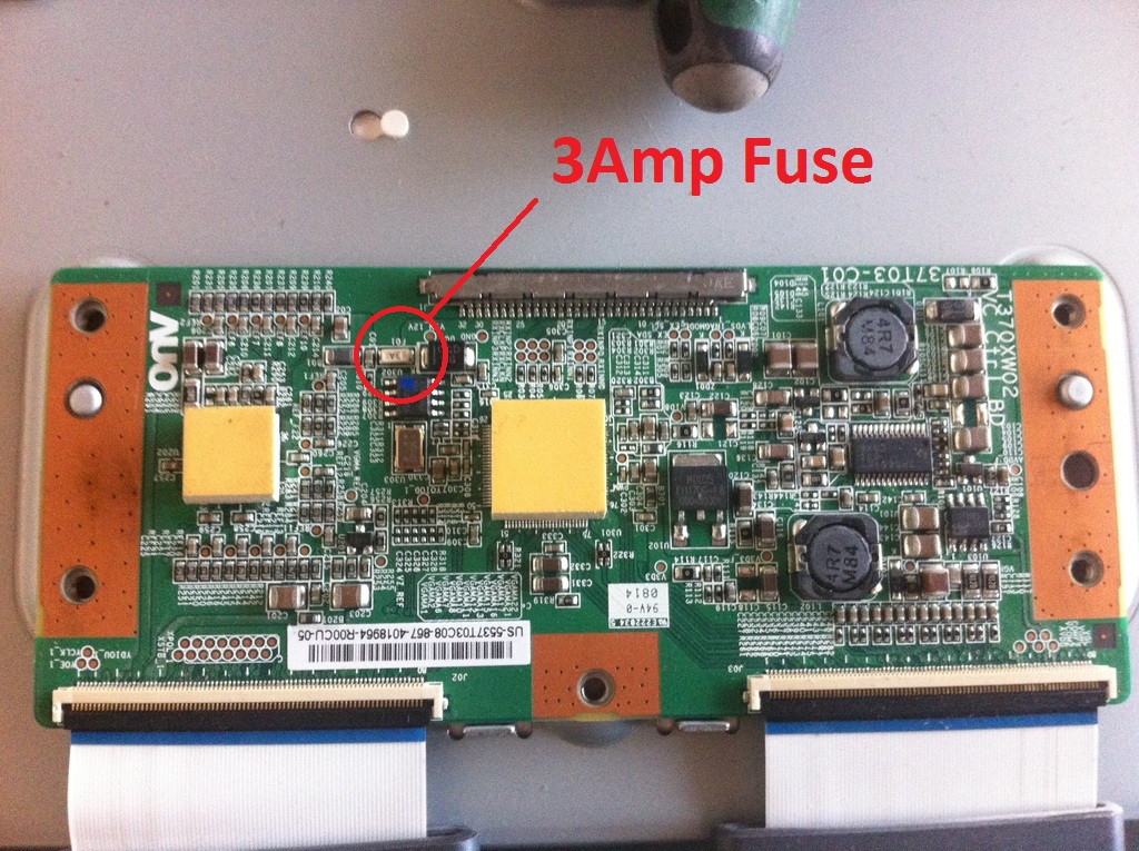

            now look the tcon over real good, check anything with an F, F=fuse. thinking since you have a pic., the fuse or fuses are prob. ok, but dont hurt to check.

                not exactly sure, but I used a car fuse with same rating on my inverter board, put it right on top of the surface mounted fuse, its been working fine.
                  Re: SAMSUNG -LE37A450C2 Bad Pic.
                  be sure and double check, but I thought I read you could use a pico fuse.

                          I might have my posts mixed up, did you say you did find a bad fuse on tcon?
                            Last all the fuses that I found work
                            Оne of them doubted me but I uninstalled it and put the external for testing unfortunately it is not the problem
                              guess it depends on what you want to do, I would prob. go for a tcon, they usually arent to expensive, could fix it quick, or at least you rule it out and have a spare in case you ever need it.
                                Fuses wouldn't cause this issue. Bad fuse, no picture at all. No poor image.
                                Your T-con uses AS15-F IC, so a good idea to check GAMMA voltages.
