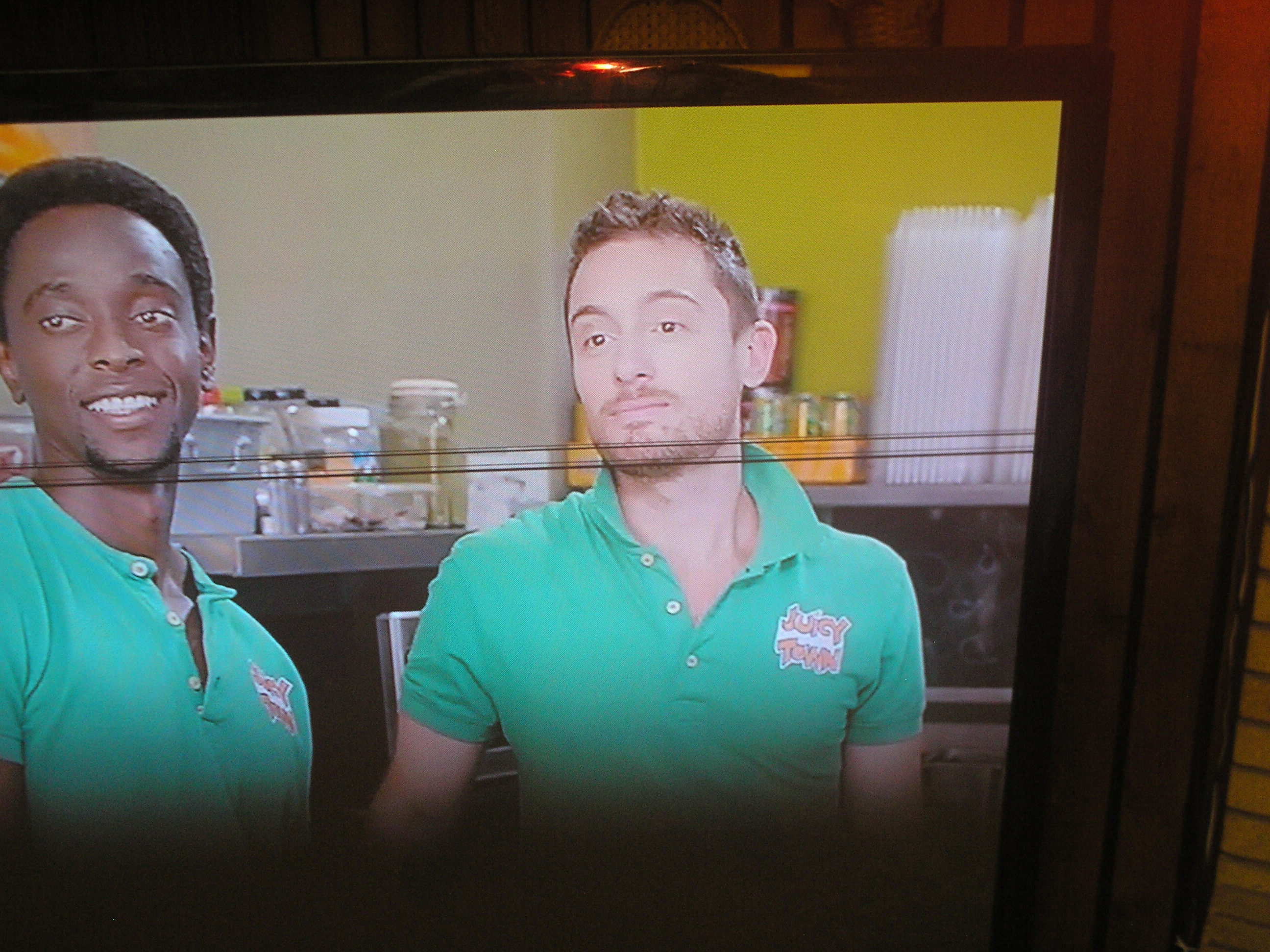

                        Just for info.. cracked screen plasma discussed earlier in thread still going strong
                        11/24 Using for main TV.. average 4 hours a day. (way too much) about a month now.

                          Re: Stumped on Samsung PN60E530A3F
                          Still going and here's the proof
