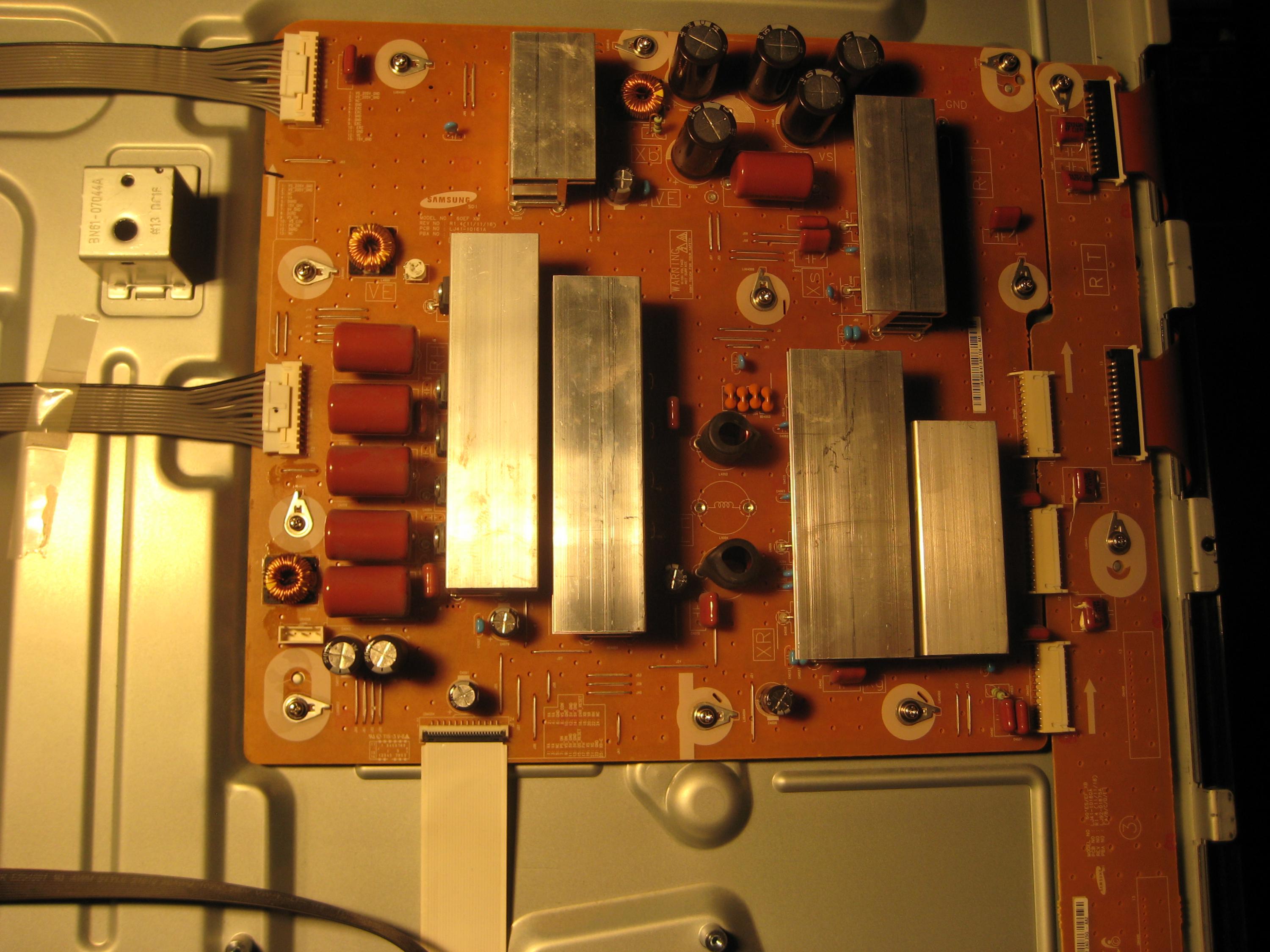

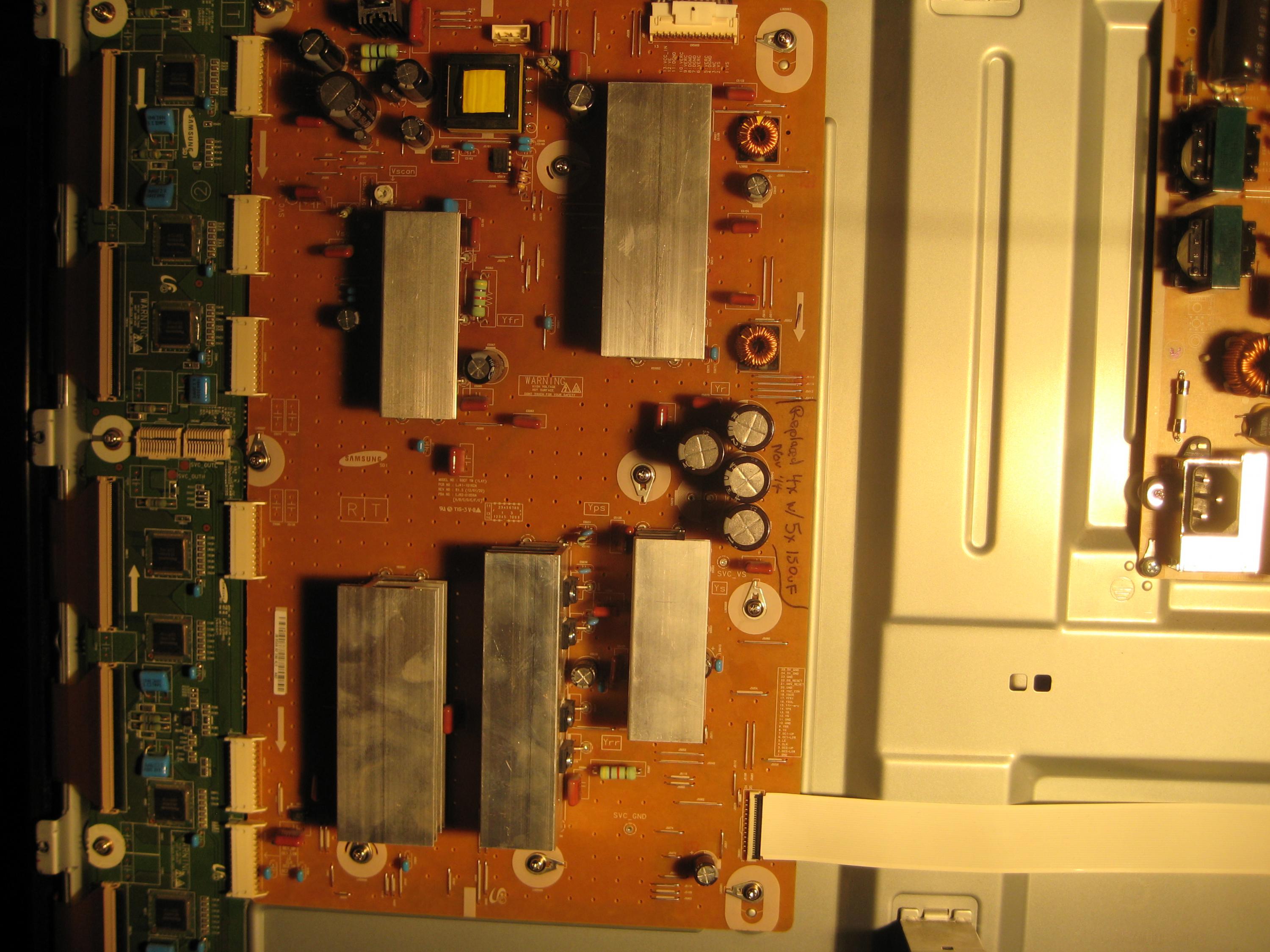

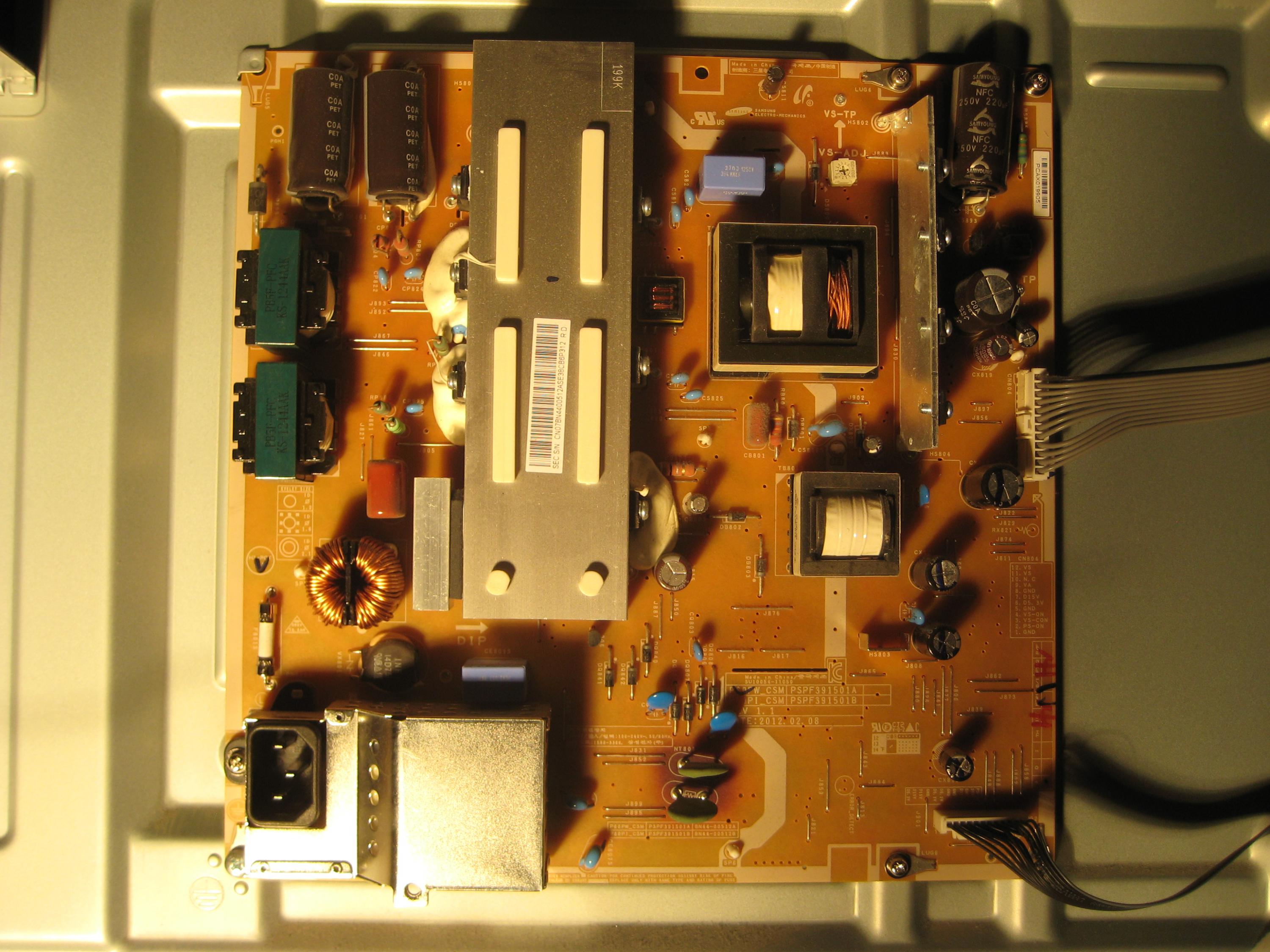

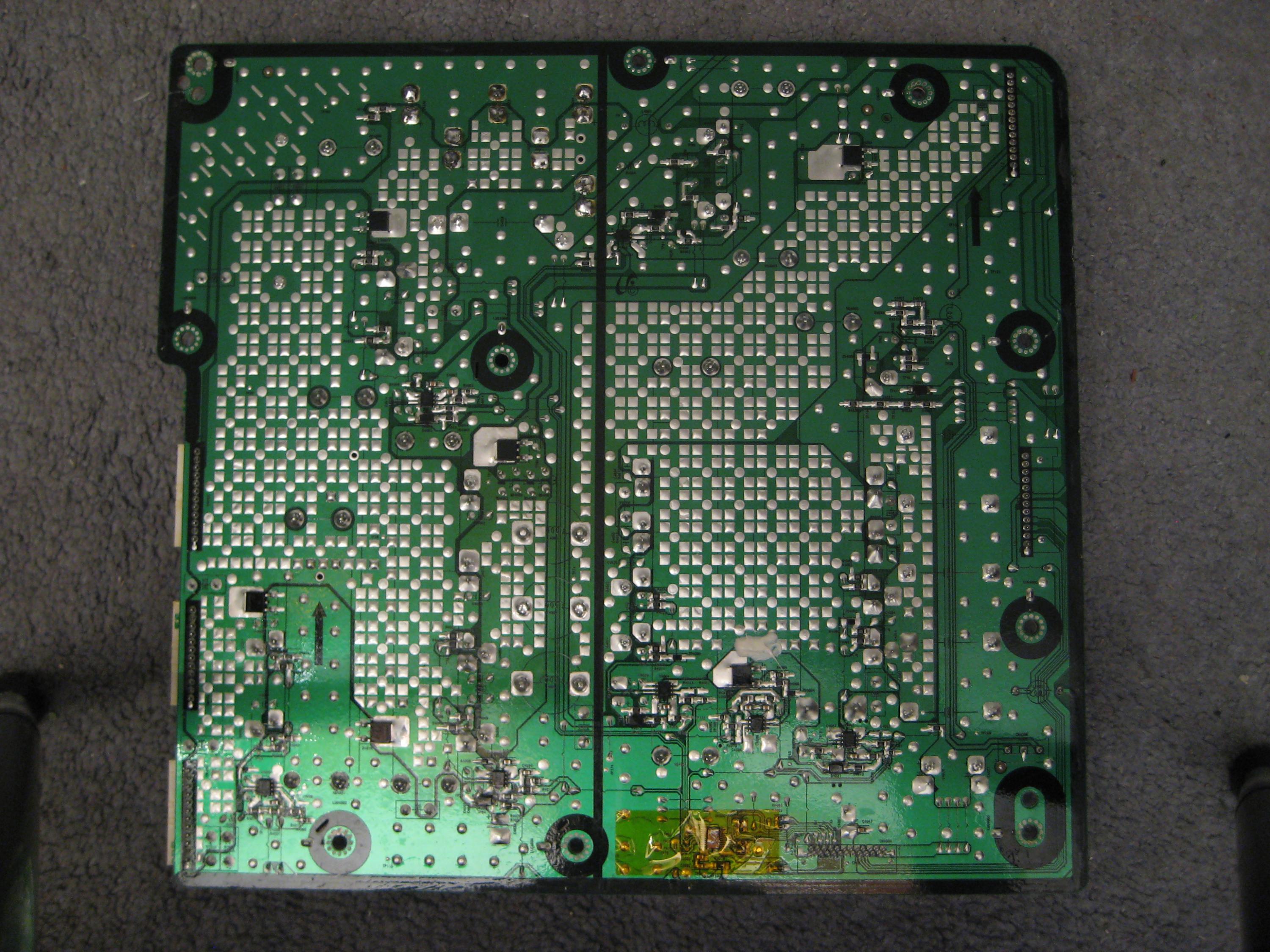

    Well, this one has me a bit lost... I'm usually pretty good at figuring out what the heck is going on but I'd appreciate any input from the gurus on this one!
    A little background... Had two of these PN60E530A3F (built in Jan 2013 and Nov 2012) showing the same symptoms initially; wouldn't always turn on in the morning first try, took several attempts with the power button before they would actually turn on. These are from a restaurant/bar so they see high hours (the 13 is about 10k hours the 12 about 8.5k currently, IIRC) but worked fine once started up for the day. Obviously, though, I could tell something was amiss and am probably chasing multiple issues so please bear with me...
    What a cheap set. Not just cost-reduced... CHEAP Samsung crap... ARGH!!
    The first one to go, (the 13) died completely; wouldn't turn on at all, so I pulled the back on-site to check for obvious PSU problems, etc. and all voltages looked fine for the split second at power up so brought back with me for further testing. I found a shorted FGPF4536 IGBT on the Yps / Yr ramp heatsink so replaced it and it's parallelled twin for good measure. This brought the set back to life but the sluggish start-up remained. Difficult to troubleshoot since it won't usually do it until turned off for some time. Updated the firmware, no change. Tried substituting pretty much every electrolytic in the thing, no change. They needed it back for football so I returned it and put it back up since it was at least working again. When I took it back, I DID, however, pull down another working one and swap boards between the two. (I was suspecting the main/hdmi input board over-twitchily sensing a problem where none existed, but it wasn't that.) The problem followed the Y-main from one set to the other. That one is still operational after 6 weeks.
    The second one to go wouldn't turn on either so I pulled the back off it, checked all the IGBTs and all were fine. I started substituting important capacitors and when I replaced the 4 x 150uF 250v caps stiffening the Vs supply on the Y-Main with 5 x 150uF better new Nichicon caps (since there was a spot for a 5th cap anyway and these things do massive current spikes) and it powered up. Put it back up and it worked fine for a few days then got dimmer than usual (like an X-Main problem) then quit completely again after another week and a half or so and wouldn't turn on.
    I pulled it down and pulled the back again, found the Ve not coming up (no surprise there since it had gone dim) causing it to go into protection. I replaced the 5 x 150uF 250v caps on the X-Main (four are on the Vs, one is the Ve) and moved the 5th cap on the Y-Main to replace the last crappy looking/feeling 150UF 250v SAMWHA that is up on the Vscan in the upper left corner of the Y-Main since I only had 10 of those Nichicons on hand. That didn't seem to make any real difference but with enough prodding of the power button and unplugging/plugging in I did get the Ve to finally spring fully to life and the set came on. (Proves there were no shorted IGBTs, that everything COULD still work, etc.) Basically, if I can get the Ve to come up, the set powers up but it's really tricky to get it to come on.
    I updated the firmware while I had it on, put it in service mode and the individual R/G/B color screens look blazingly nice and bright but the white seems dim to me (looks more like 50% gray to me, don't think that's normal ??), although the Vs stays rock solid at 211 even on the white so it at least doesn't look like the Vs dropping out. It powered up fine several times in a row, worked fine for about half an hour when I left it on to warm up and check the voltages but when I shut it off again for a few minutes, I once again couldn't get it to turn back on.
    Very annoying. I know it CAN work so there must not be any shorts, etc, but what on earth could be causing it to be this flakey coming up? Basically, when I can get the Ve to come up, it powers up but it usually only goes to a few volts at startup before it goes into protection. With enough unplug/plug-in and power cycles it gets to about 13v and doesn't drop very fast when powered down but I'm really confused as to why the Ve won't come right up full most of the time.
    Anyone seen this before? Any bright ideas?
    Thanks in advance, guys!!
    TV back, PSU, X-Main, back of X-Main, Y-main:

      Yeah, I had tried both manually jumpering the PSU (still shuts the HV supplies off) and disconnecting the various flat cables and, yes, I can make it do the fast blink and Vs/Va stay on but Ve still doesn't come up.

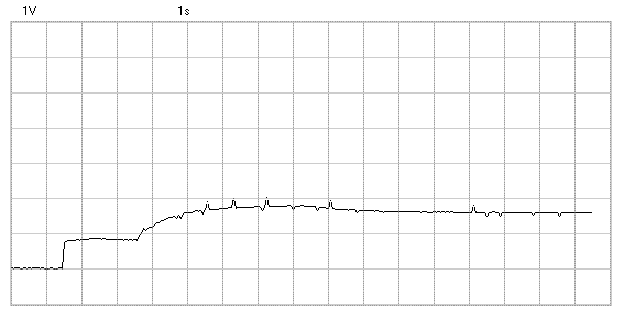

      This got me to thinking a bit more about it, though, and I believe what is happening is the voltage I'm seeing most of the time at Ve is coming back out through the panel TO the Ve and charging the capacitor; makes total sense. I see no difference in the Ve when I adjust the Ve adjustment potentiometer, for example, so I think the Ve supply is simply not coming up most of the time.
      To make this easier to watch I pulled out my old DSO and put it in Transient Recorder mode. Attached is the record of what the Ve does when I apply power with a 1s / div timescale and a x10 probe so 10v / div. With the Y-Main flat cable connected I only ever get to the first step on the graph then it goes into protecton, then the voltage slowly rises to about 10-11 volts as the supplies bleed off (I'm assuming this is being capacitively coupled through the panel, charging the Ve cap slightly.) With the cable disconnected so the supplies stay on, the voltage rises slowly to almost 20v but the exact voltage is probably panel dependent.
      I'm thinking the blips on the graph once it starts to charge up may be the Ve supply trying to start, not sure... I will have to figure out the circuit and see where to probe transistor gates, etc. to see if I'm getting any drive, etc.
      I'm going to take the X-Main out again now and ponder / trace out the circuit a bit to wrap my head around how it's supposed to be working but I'm pretty sure we're on to something here. My Ve supply can't be totally dead since I can occasionally make it come on but something is very intermittent...
      Probably something stupidly simple...
      Transient Recorder record of Ve with Y-Main flat cable disconnected:

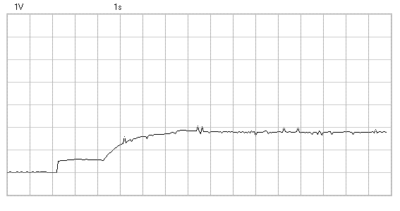

          Hmmm, very interesting that another X-Main does not solve the problem!
          I tried it with the Y-Main disconnected from the X-Main to be sure the Y-Main wasn't pulling it down somehow.
          (I did this partially because I know the flakeyness in the other set followed the Y-Main board but this may well be a completely different problem.)
          Now I really need to think this through! Argh! I'm probably not looking in the right place after all.
          This new knowledge just raises further questions!
          FWIW, this is what the Ve looks like with the Y-Main connected:
          (I had mistakenly thought it decayed from the 10v when it goes into protection but it doesn't; it stays at 10v until the power is pulled then decays)

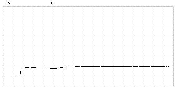

                Here is what I get with the logic board disconnected from the main...
                Sounds substantially similar to what you're seeing.
                I don't believe there is probably any difference between the panels in a 2D and 3D set rather mostly just a different signal but I'm not sure.
                The first one is with the Y-Main still connected to the logic board, then with it disconnected:
