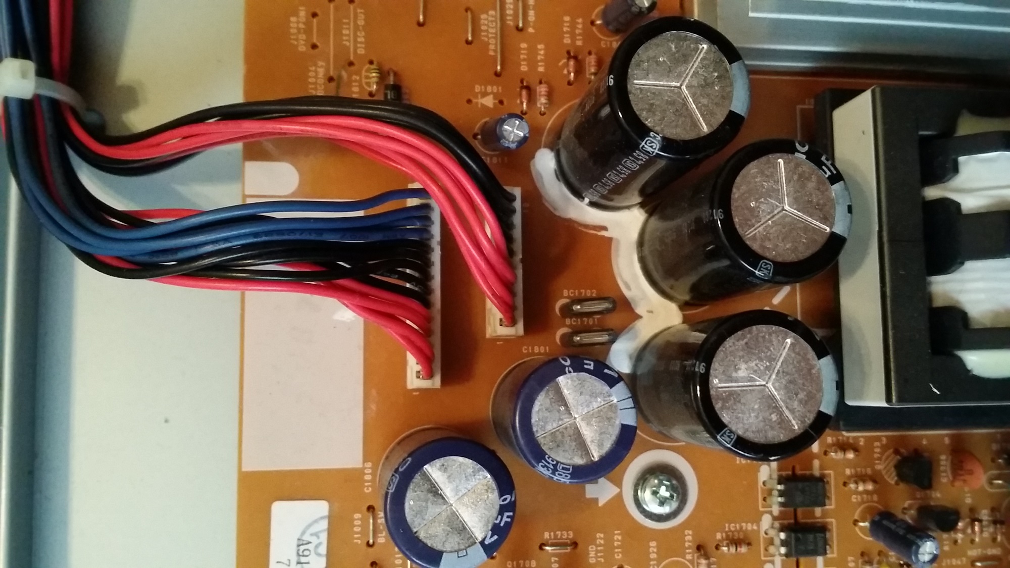

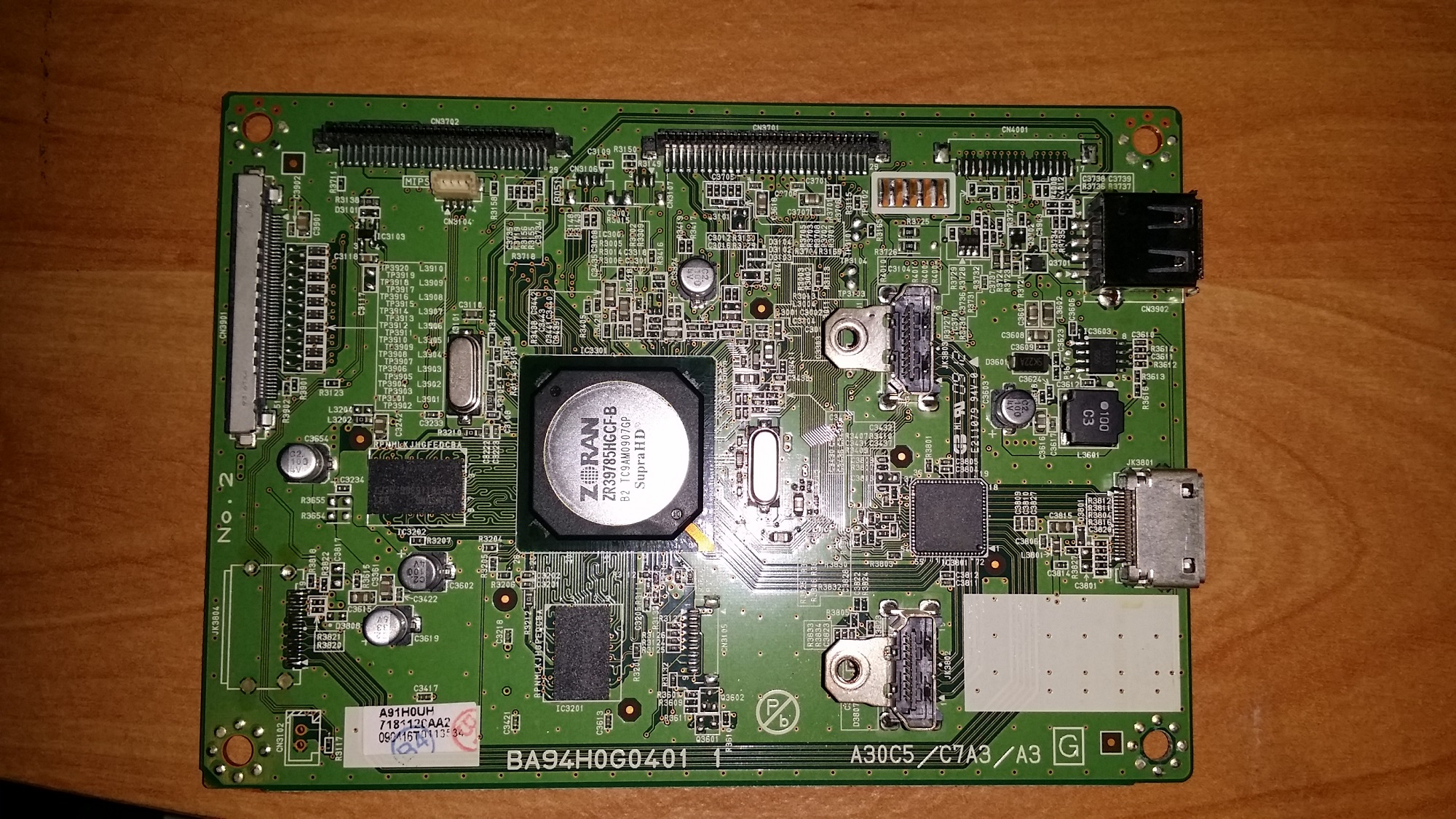

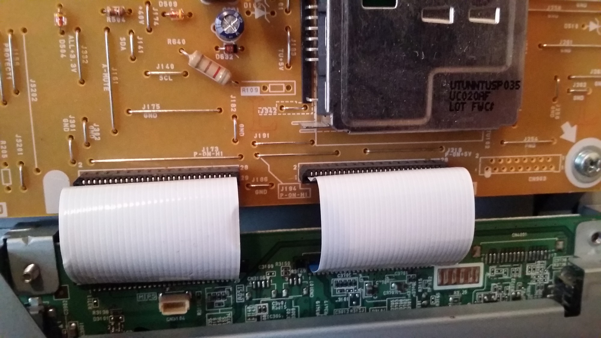

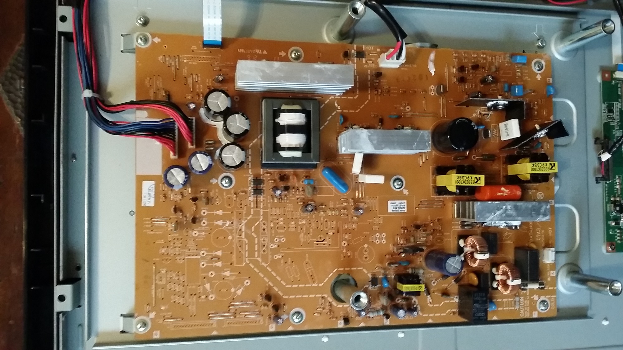

    Hello guys this will be my first post so plz be gentle lol. im working on amagnavox 42mf439b/f7 the issue is it powers on i get a solid green light and then the standby light flashs once every 15 to 30 secs ive tryed checking the screen with a flashlight as no backlighting comes on but no dice. ive checked all the caps and to the eye no bulging or bad caps. the set is unresponsive to the power button will only shut down if i ulplug the main board or the cba board. ive replaced the digital main board just out the go since it was pretty cheap. next thoughts were t con or inverter board ? im somewhat dmm friendly and can solder so fire away any help appreciated!

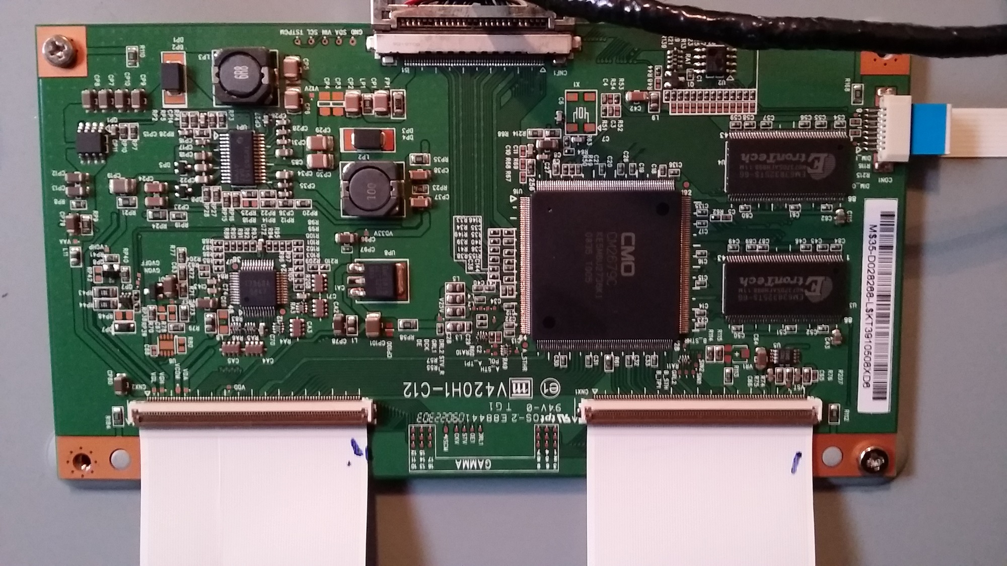

    Re: 42" Magnavox trouble
    maybe check the fuse on the tcon board, the label will start with an F for fuse.

      careful when working with the power supply board, HIGH VOLTAGE on primary side.

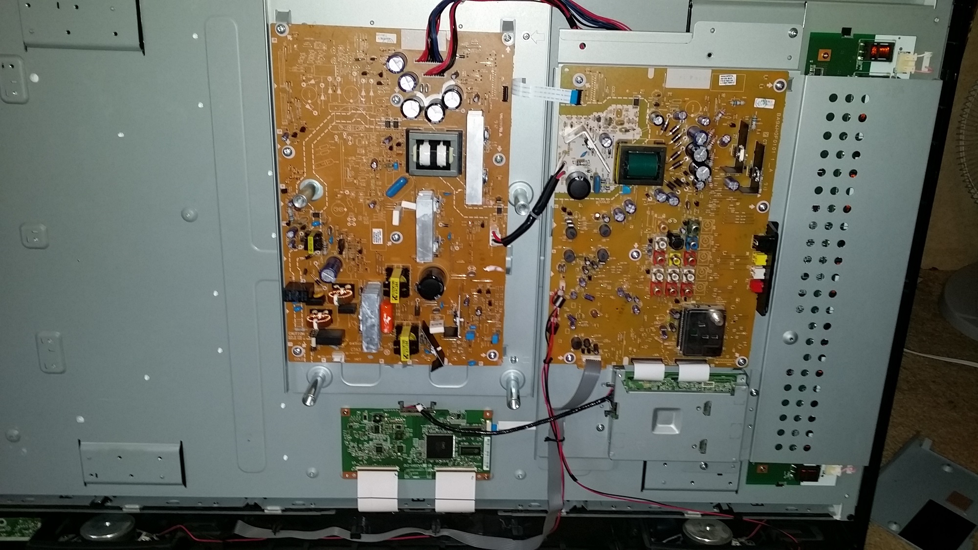

          Well, start with this so we can see what we are dealing with.
          https://www.badcaps.net/forum/showthread.php?t=39740

            i do apologize for any blurry pics im taking them and have to get to a location to upload as internet at home is slower than 56k lol any blurry pics i will retake and try again and theres a few i left out i need to retake as well

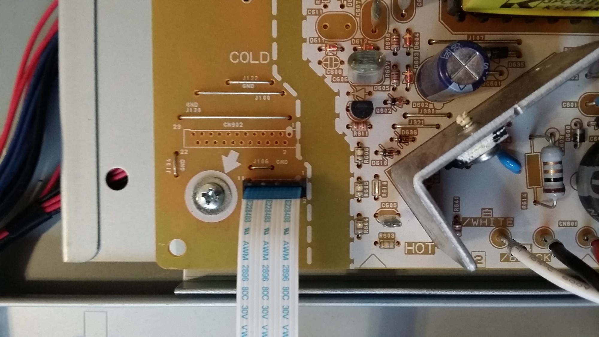

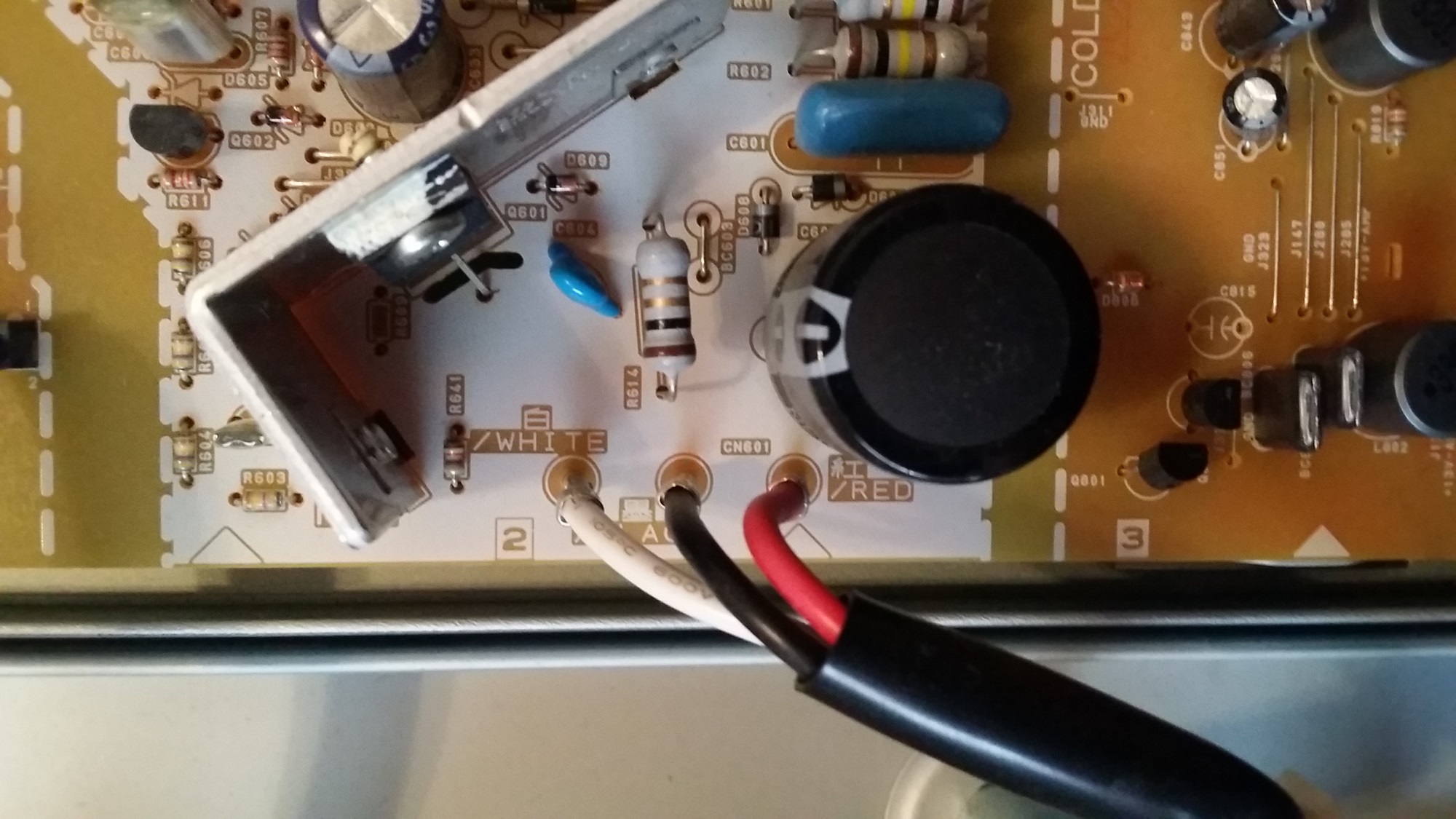

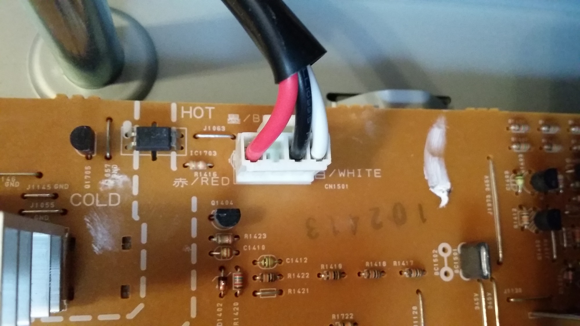

              a few extras

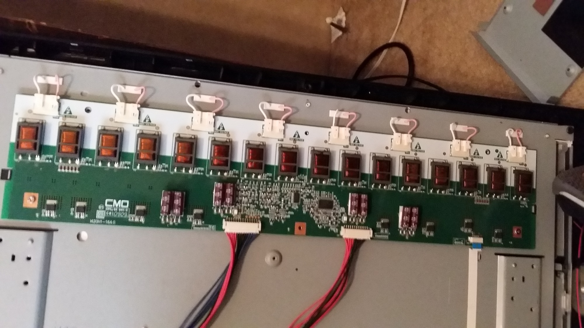

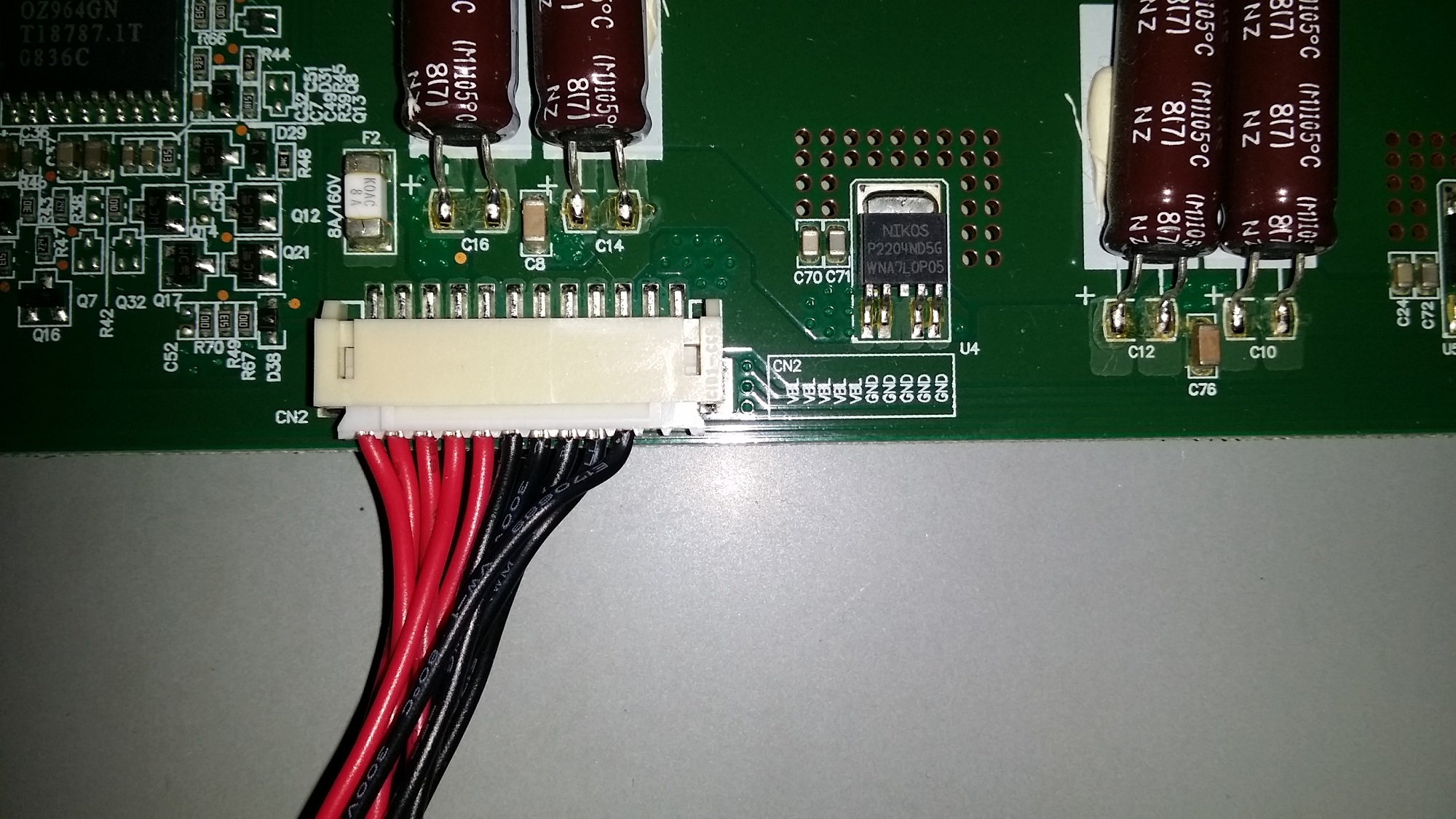

                      On pic 121643 we can see 2 fuses in the inverter board, 8A/160V. I would check those first. Good luck!
                      They are near the connectors.

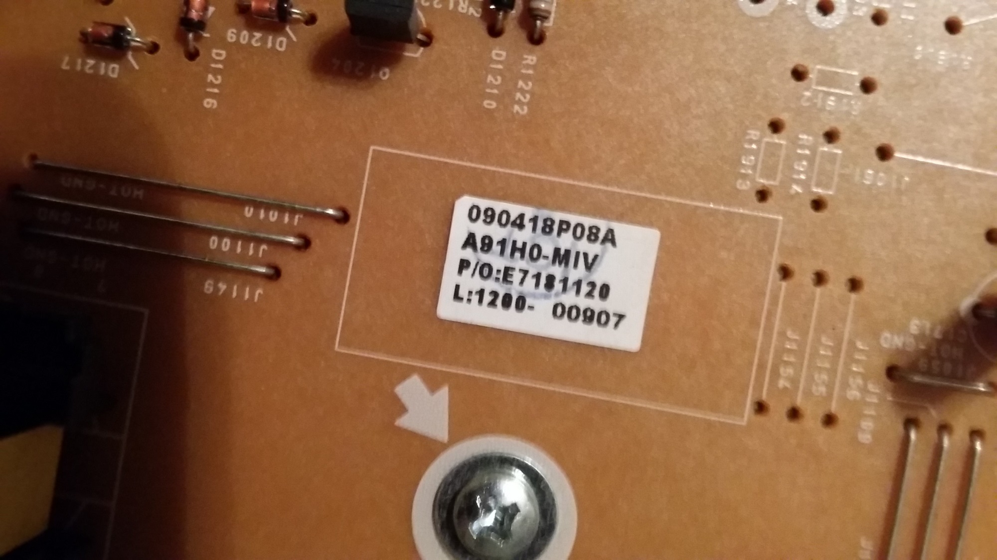

                        So you replaced the big brown board on the right?
                        This one of those FUNAI/SYLVANIA/EMERSON/PHILIPS/MAGANAVOX TV.
                        Is there a chassis number printed on the model number sticker?
                        For example:
                        42MF438BF7_LC8.14LA
                        "LC8.14LA" is the chassis number.

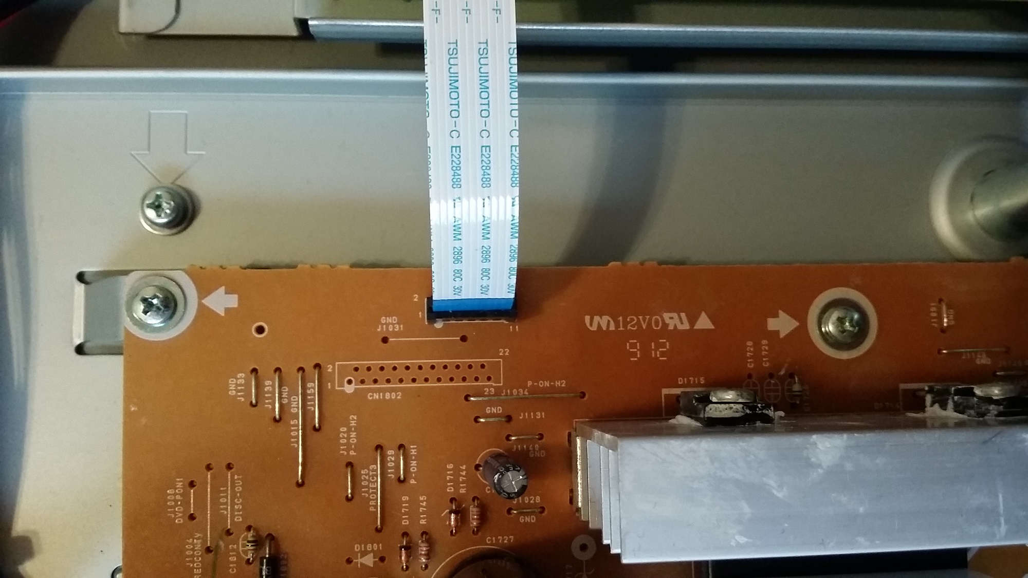

                          Yes both fuses on inverter board Check out at 24v and I get voltage at the caps on the inverter board but past the caps those transformer things lol dunno what there called there is no voltage. Both sets of connectors the red wires are all 24v.

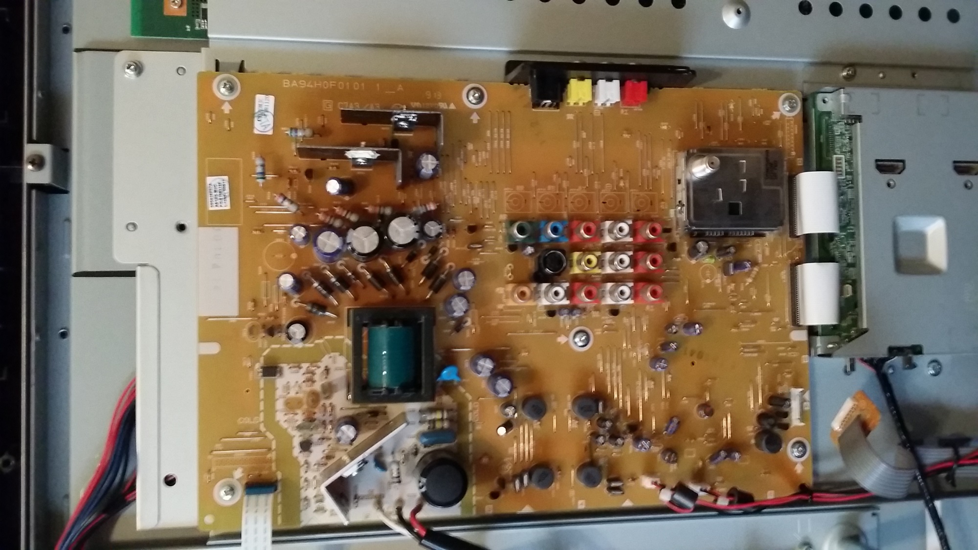

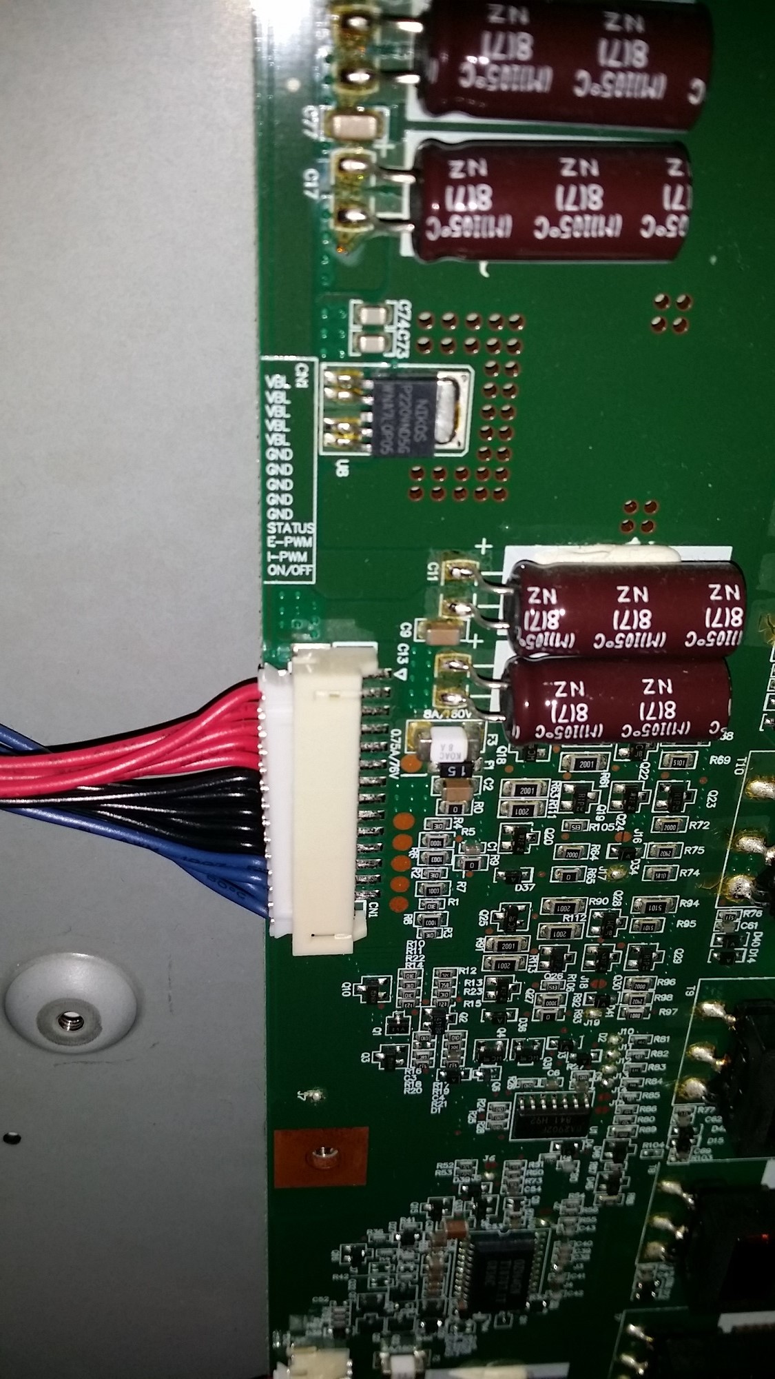

                            ok so budm this is the board that i replaced the digital main and then the sec picture is of the other connector on the inverter. all the red wires as i said read out 24v but the 4 blue wires voltage are all very low im not near the set to take the readings again but i will tonight .... and i will also try and get that model number you were asking for.
                              ok budm the only thing i see on the model number sticker other than 42mf439b/f7 is is off to the side in a white box that says S fl9.2

                                I check fuses in diode mode, one probe on each end, if no reaction or stays ol, then its probably bad, if reading is close to 000 then its prob. good.
                                    ok on this inverter board i get 24v across the red wires the vbl then the rest as follows
                                    status 0v
                                    E-pwm 0.7
                                    I-pwm 0v
                                    On/off 1.7v
                                    and sony i will have to try testing those in diode and let you know what i get

                                      fuses on inverter board read out 000
