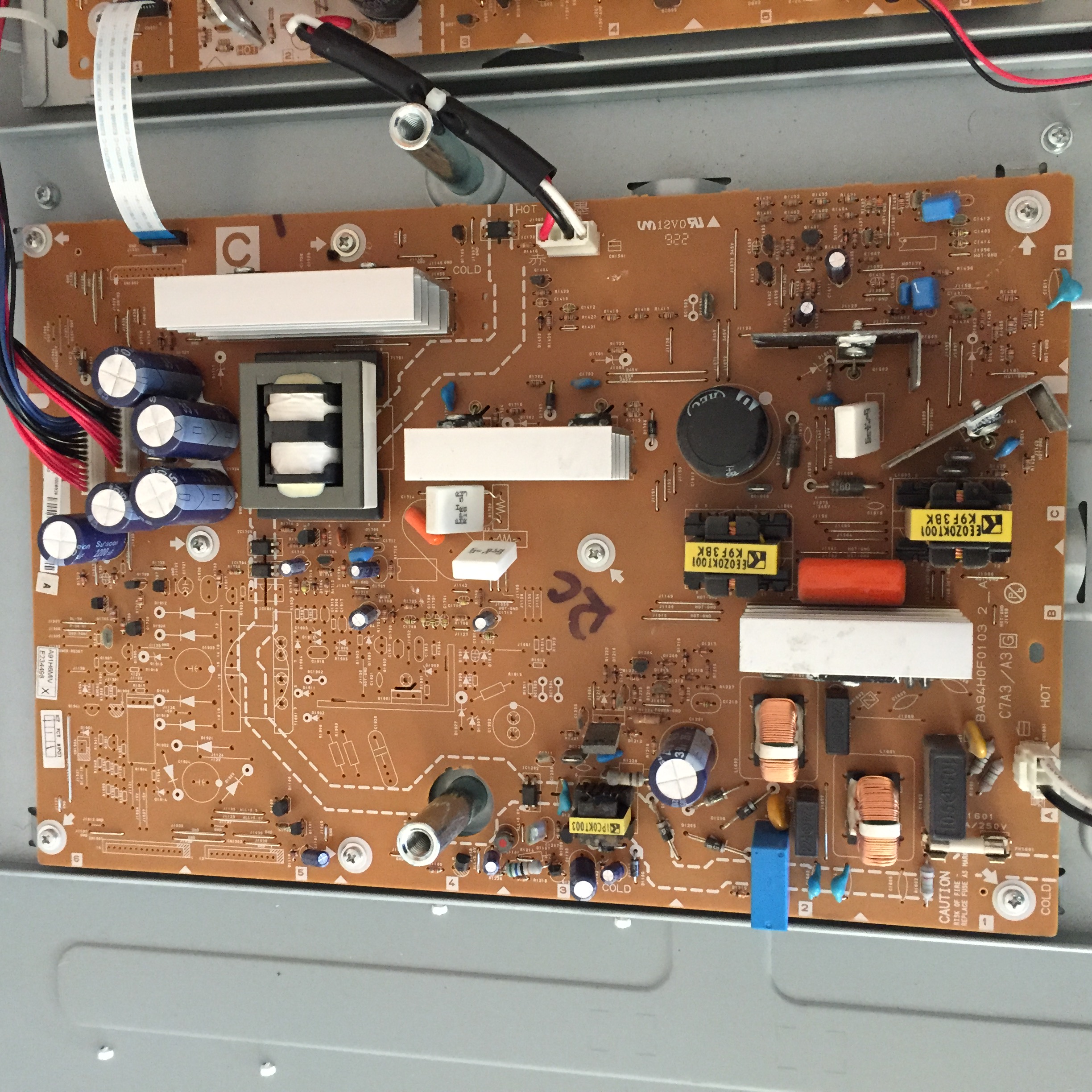

          Thought I would try to revive this thread since I have this exact TV. It has the notorious two seconds to black. My question is concerning the Inverter power supply board. There are pins marked 345v. When I test those, I only get 160v when i power on the TV. If im reading the service manual right, It needs to send the 345v over to the main board. The backlights briefly turn on and then the TV shuts down. If I unplug CN1803 that runs to the actual backlight inverter,the TV doesn't shut down. I bought a used inverter board off of ebay. No luck! Still two seconds to black. Im thinking the inverter transformer on the power supply may be shorting when a load is put on it. But I dont know much. just like trying to repair junked electronics. Any advice and guidance would be appreciated Thanks.
            Re: 42" Magnavox trouble
            Alot of times a bad transformer will give you the "2 sec. to black" condition. Use an old bulb laying over the transformers or the small blue caps then turn on tv and watch for the bulb to glow on where there are caps or transformers. If you see a pattern and one part of bulb is not lit its a bad transformer. If they all light up the bulb, you may have a bad bulb in your set. There will be a blackness at the ends of it.

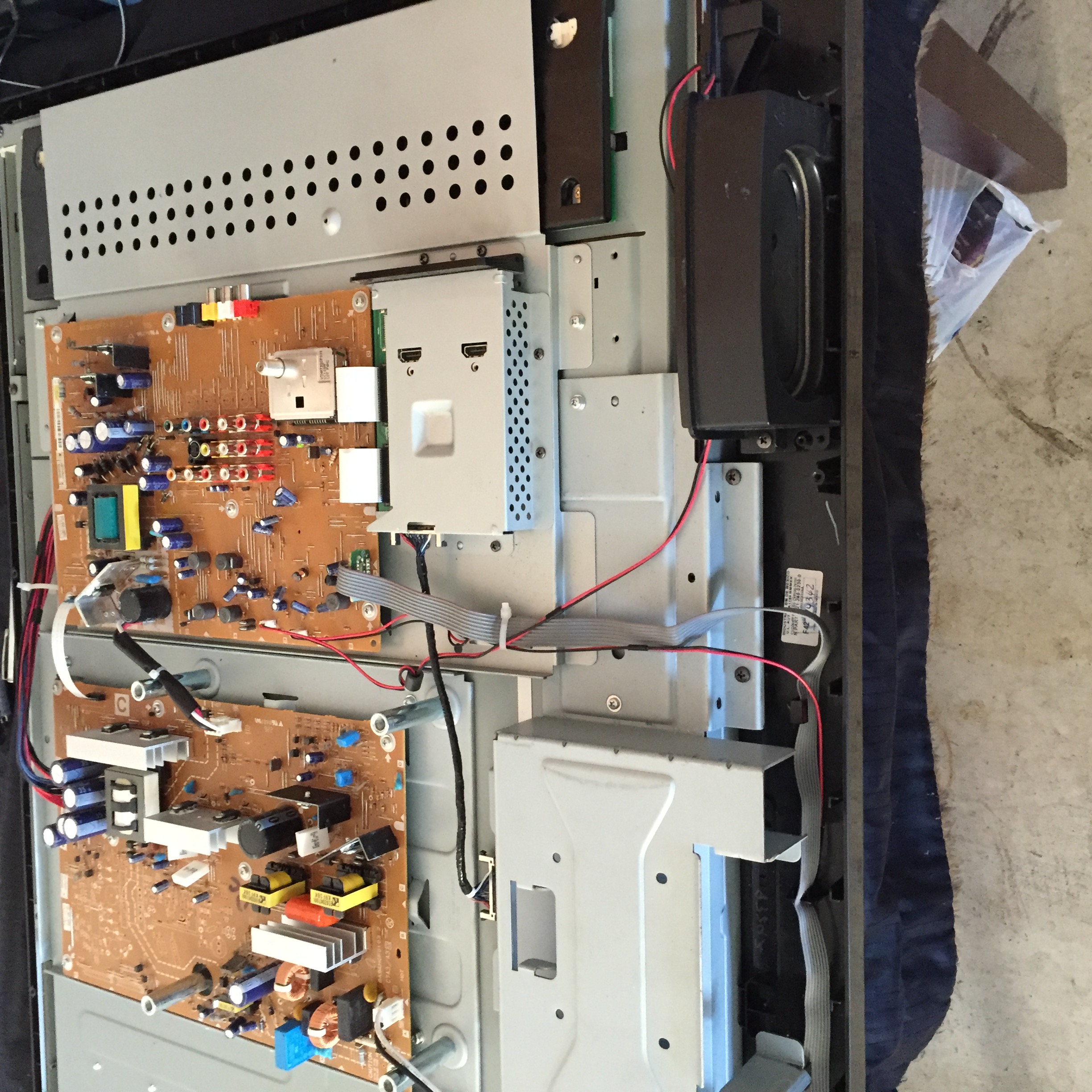

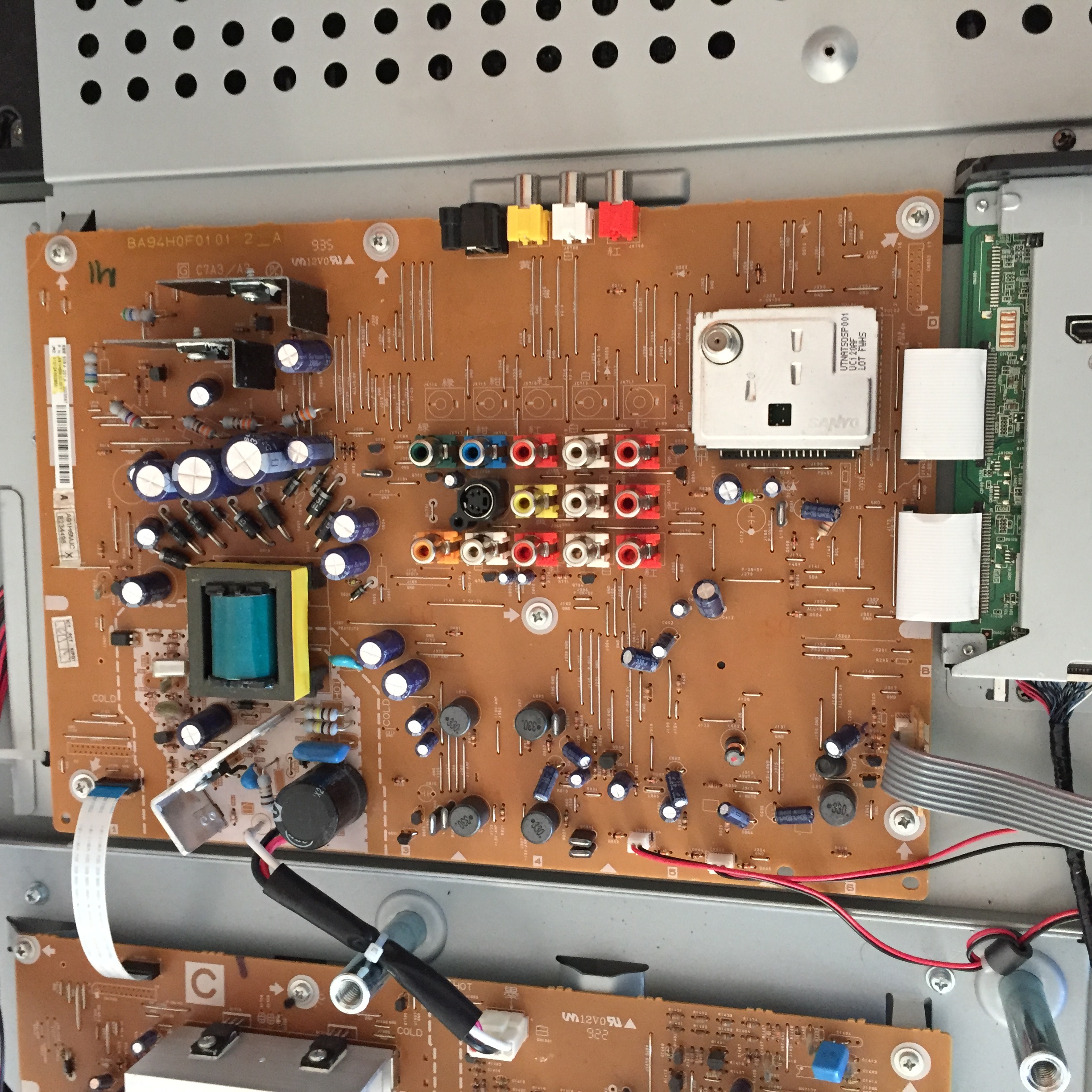

                Can we see good clear pictures of YOUR boards and the whole back side of the TV?

                    I will get some photos posted this afternoon Budm. Thanks
                      Hope these will work
