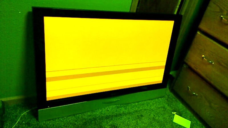

          Update: replaced all caps. the tv turns on perfectly.HOWEVER, all the screen shows is red right now. Does this mean bad buffer board? Not too good at this.

            Re: Vizio VP50 HDTV10A (Yellow he issue.and Green status light flashing)
            here is my stupid tv the color is red now
            • tschneeee
              • Jul 2014
              • 30
              • US
              Can someone help? I'm in desperate need
              • MagicSmoke
                • Feb 2011
                • 275
                Check and/or reseat all power and LVDS cables first. You may have accidentally disturbed another cable.
                Also how many LEDS on logic board are lit when set is on, and how many are blinking?

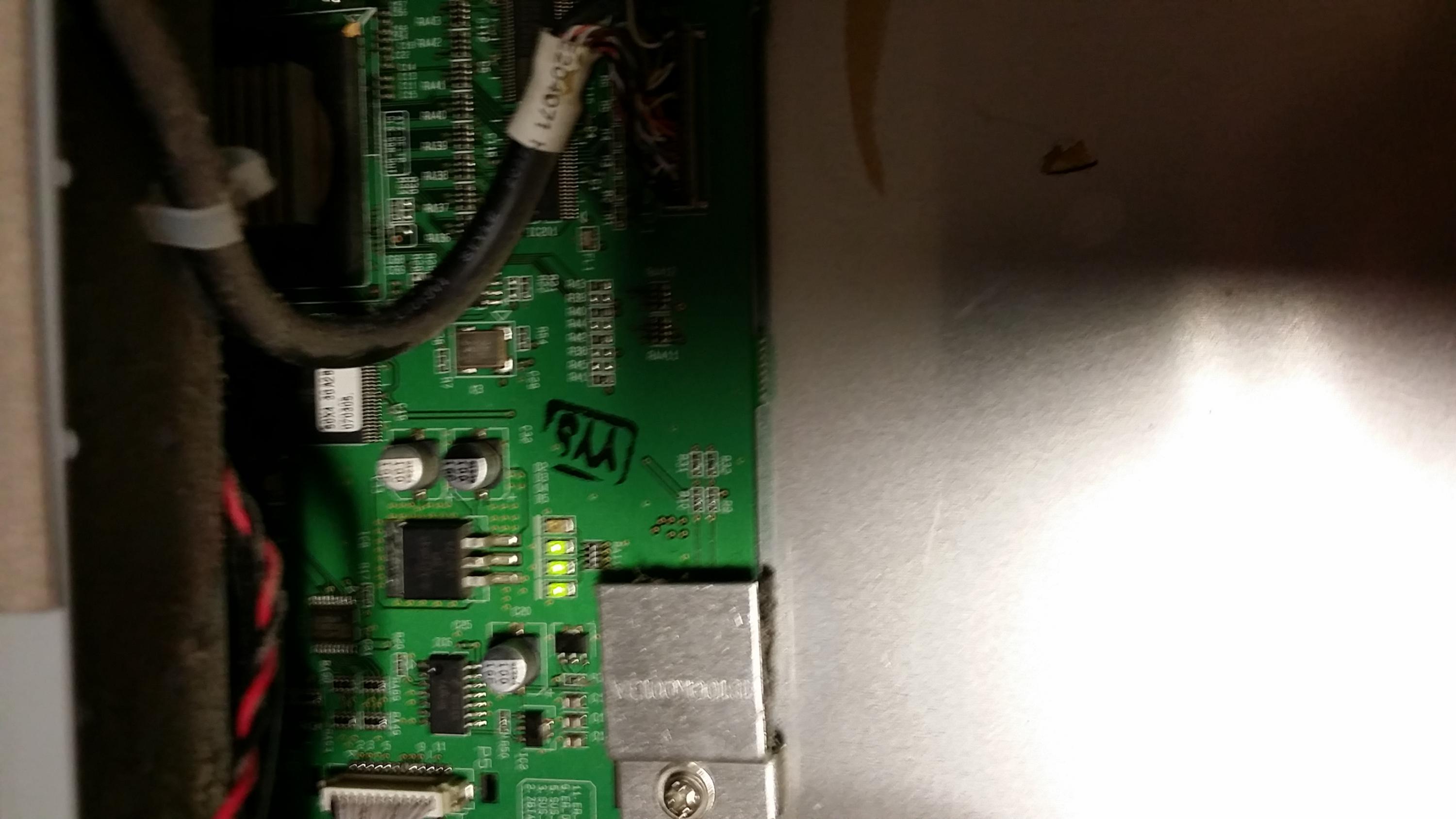

                  Is it worth mentioning that I replaced all capacitors and after that, about 2 minutes after plugging in the tv, one of the capacitors started smoking and i smelled burned residue. I don't think I used quite good solder. Could I have messed the whole power board up? Also on the logic board, I see two lights in the center out of the 4 that are lit up. Here's a picture.
                    3 lights now.
                    • MagicSmoke
                      • Feb 2011
                      • 275
                      Smoking caps is NEVER a good sign. Check the one that smoked for correct polarity. It is possible it got reversed. If not then there might be a problem on the circuit that cap is protecting.
                      3 leds lit on logic when on with picture is D3, D4, D5.
                      EDIT..... Need pics of area where cap smoked.
