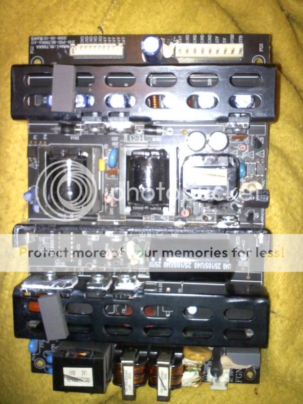

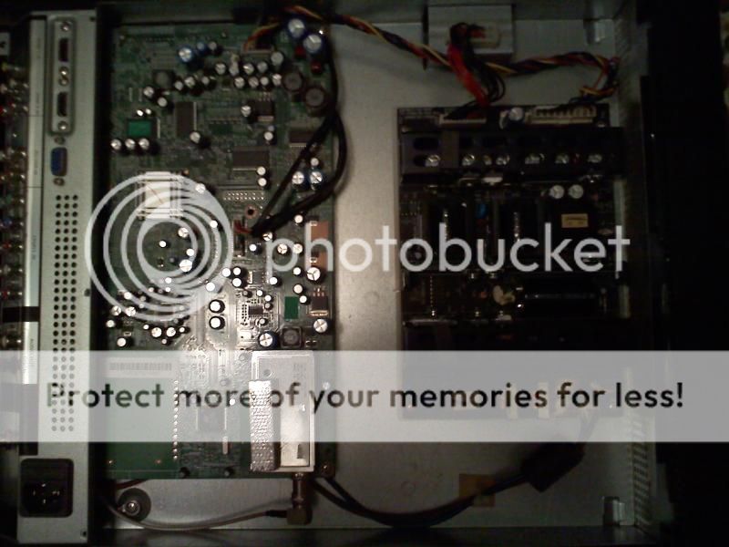

                                Re: HELP!! Polaroid 3211-TLXB
                                ok, i opened it up and got some pics, even though they refused to turn out good..
                                The caps all looked perfect no bulging at all, not in the least bit, EXCEPT for the big main cap, if you look in the pic, the end of it is bulging out but i think it may be made like that? The only thing i found was dust packed in tight around that big main cap and a few other components on the PS board, so i cleaned it out good with air.. also saw a few possible bad solder joints so i re-soldered them just to be sure. I got the TV on right now with the back off so if it goes out again, i can see if this red light on the PS board comes on like described in the above post..
                                The power supply model # is-MLT666A, then 200-poo-MLT666A-AH
                                The only thing on the other board thats beside the PS was a sticker with a bar code that says-FAR2075016957, dont know if thats the part# for that board or what but thats all its got..
                                  What volt and uf are the 2 caps by the transformer? If they are 10uf 450v then they are bad. I used Panasonic EE series to replace.
                                  The supply I repaired is different but still has the same 2 caps by the transformer.
                                  They were not bulged, but when removed I could see where both had leaked around the leads.
                                  Also all the caps under the heat sink need replaced whether they look bad or not. The high temp shortens their life.
                                  EDIT... looked at a better pic of PSU on Sj, It does not have a fault led that I could find.
                                    OK, now we see the pictures of the boards, form what you describe the problem, it sounds like it lost the 5VSB, so you need to check that pin when the TV stops working, this 5V standby power supply is running 24/7.
                                    Those two cap by the transformer (with sticker on top) are the filter caps for the 5VSB. There is small start up cap laying on it side next to Q3, that is the cap I suspect it to be bad, it will look normal but you need to check the capacitance and its ESR value.
