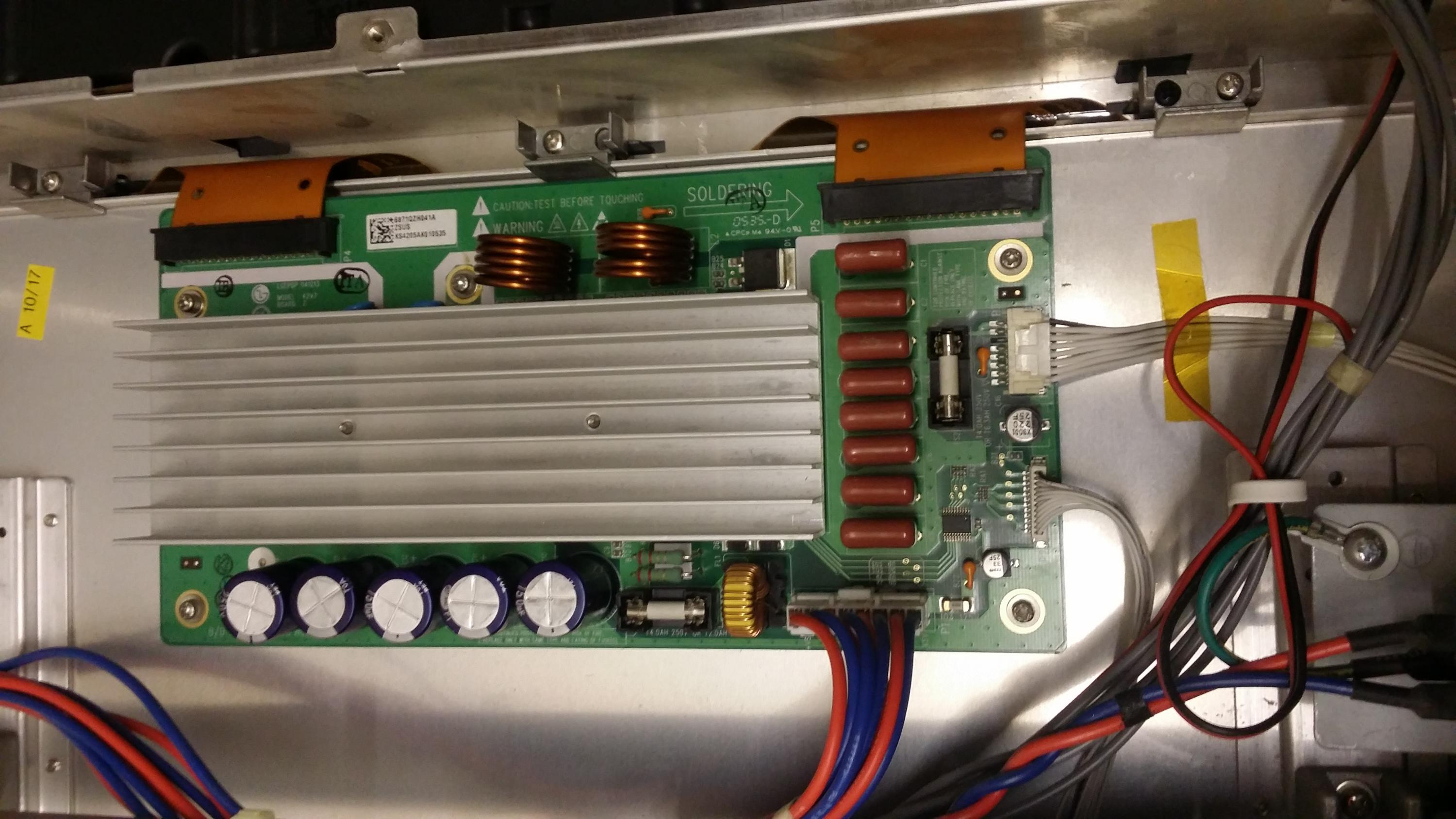

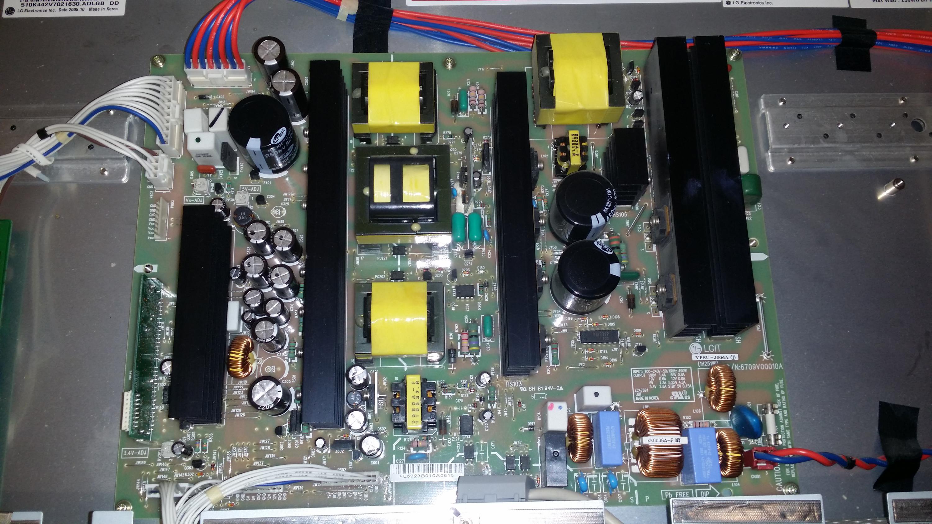

    Hey guys I've found myself a plasma and so far I'm not a fan!
    This one clicks on the light goes from red to amber to green and then clicks off and back to red. Caps all appear ok from a visual inspection. Also once its put itself back in standby if I attempt to turn it back on again the light will turn amber but theres no clicks from the power supply and the light doesn't go green I have to disconnect power for a short peroid before the supply will click again.
    I have no clue other than some thing else on the power supply is bad, any ideas?
        could still be a cap, they dont have to bulge to be bad.

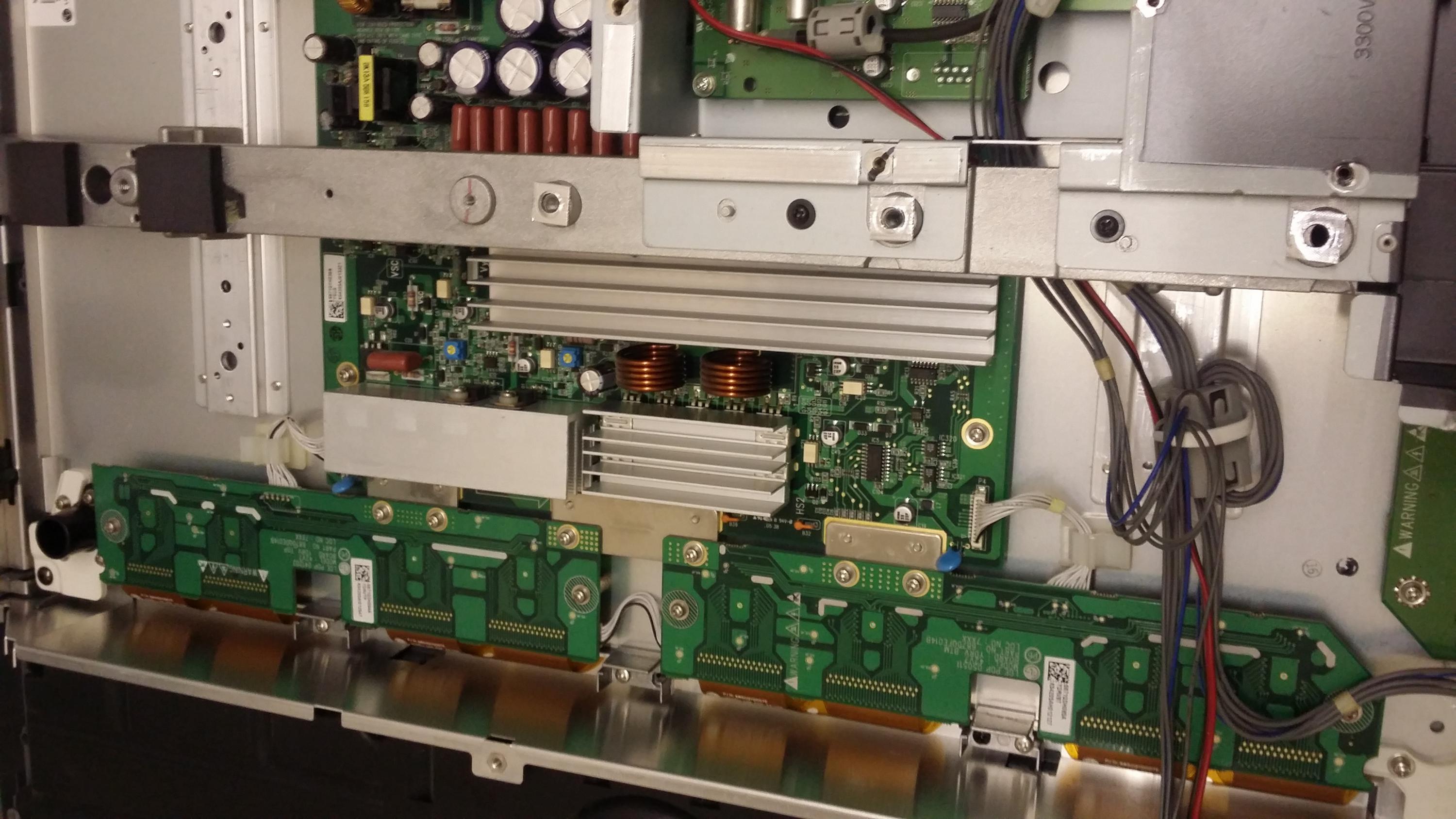

                  I think I'm making progress, with the zsus board disconnected the power supply doesn't click back off it stays on

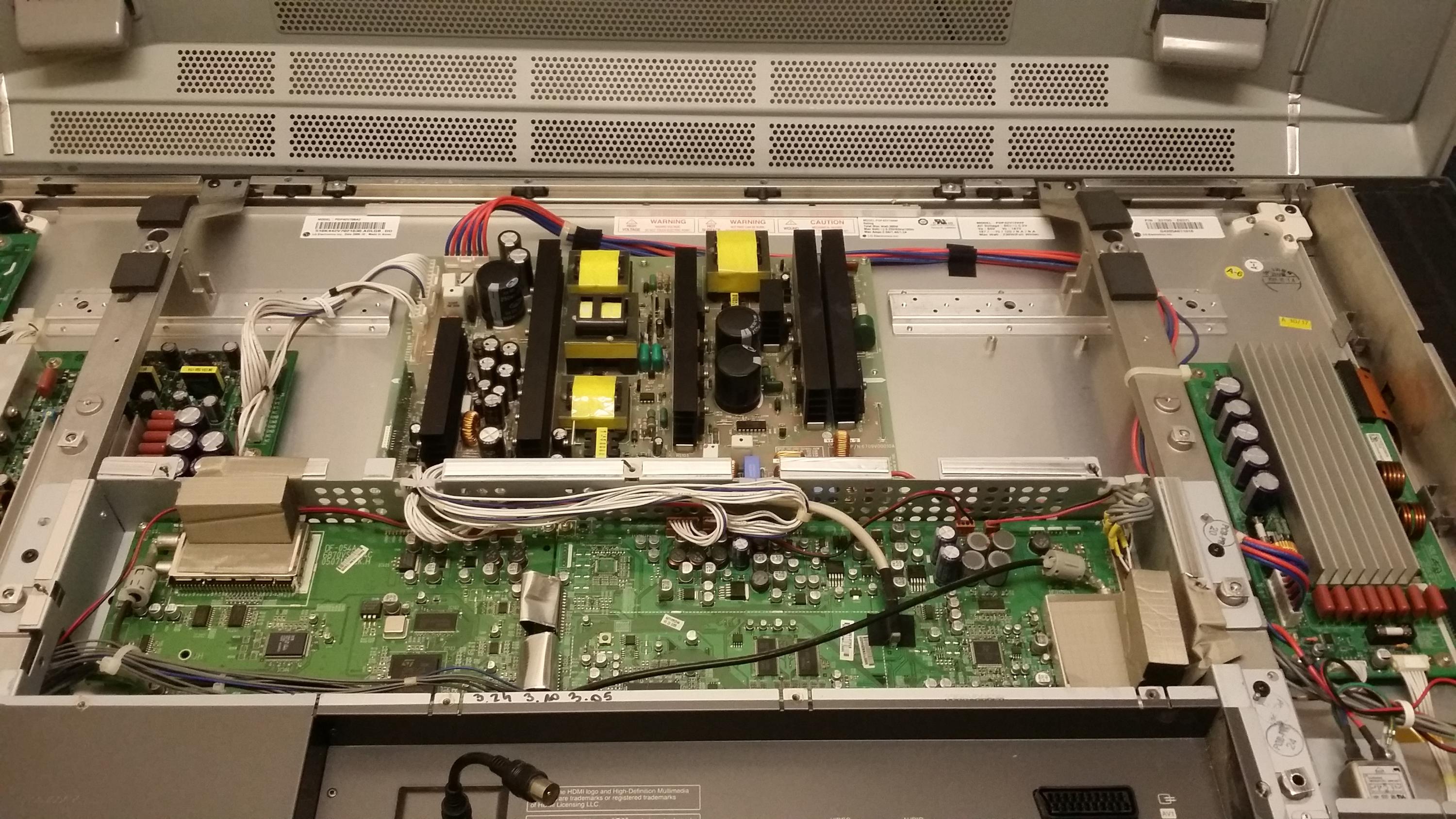

                    Re: lg 42PX4DV-EA switches on then off
                    can you post some good clear pics. of the boards and maybe one of how their all connected?
                      Probably zsus or the buffers at fault then, could you take pics of the boards please.
                            Also the fuse near the capacitors on the zboard, when thats taken out the psu remains on as well.
                              Are the pictures sufficient ?
