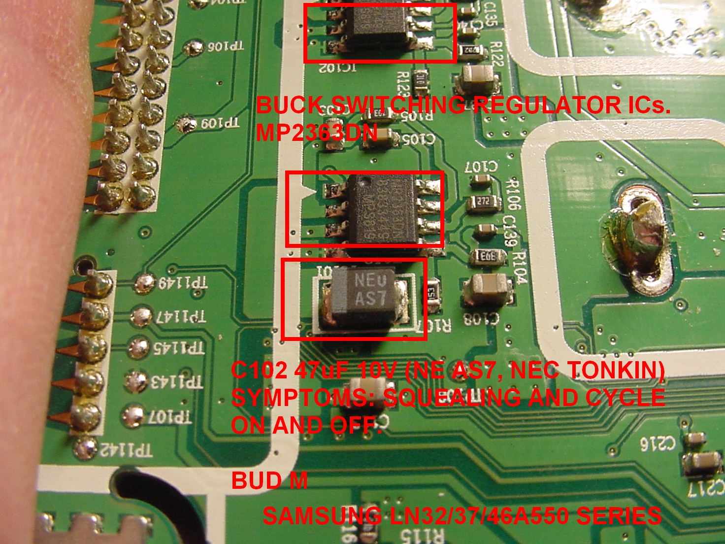

      You can look and see if it uses the same ICS, then use your scope to look at the ripple voltage on those TOKIN caps.
        Re: Samsung LN46A550P3FXZA Squealing, clicking on and off
        I replaced C102 (47uF 10V TONKIN NE AS7) cap in my LN32A550P3FXA and so far it is not squealing and starts up fine, I am going to let it run all night to see if that fixed it for sure.
        I will work on the LN37A550P3FXVA and LN46A550P3FXA next to see if it will fix the same problem too.
        It will be great to get all 3 fixed tonight!

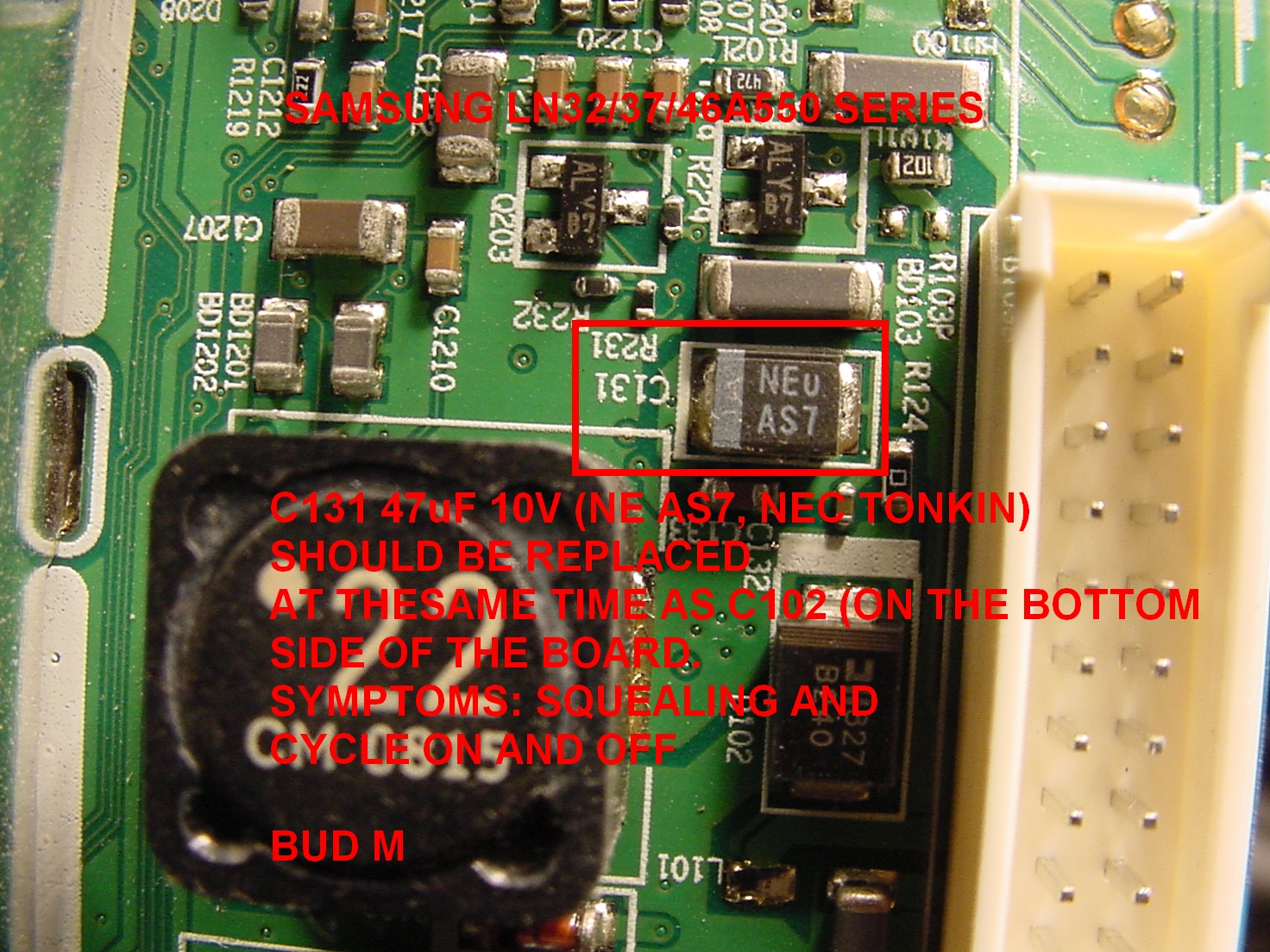

            Could not have done with the help from SHOPJIMMY website.
            I also replaced C131 which on the top side of the board and it is the exact same type of cap so if one went bad, another one may go out too.

                    You will measure the waveform on the two legs of the filter cap (the NE AS7 cap). Does it use the same cap and IC as used in the A series?

                                  You can temporary solder 100uF 10V low ESR in parallel with the C102 to see if it will solve the problem, mines did.

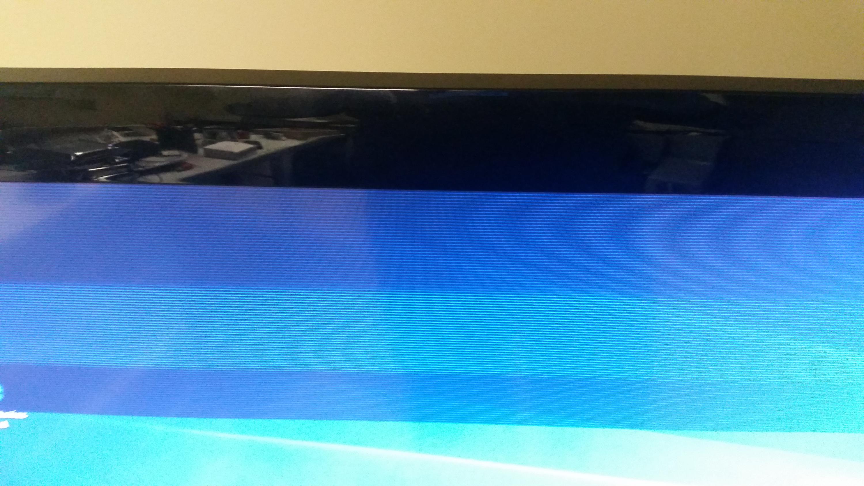

                                        I had an issue with this TV not turning on it would just play the boot tone and stop.
                                        I replaced C102 and C131 with 60V 47uf caps (All I had on hand).
                                        The TV now boots up but i get moving lines only on the top portion of display.
                                        They will go away when moving the bezel but will come back shortly after.
                                        Occasionally it will stop once warmed up 10-15 minutes.
                                        Any idea's would be appreciated.

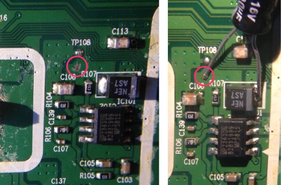

                                          Same squealing/screeching audio, power cycling with torn frozen green/blue/red pixelated video. Has been degrading more and more over the last month (would cycle itself 10+ times)
                                          Used a 100uF 16v Cap
                                          Ran in parallel with C102 - 47uf 10V (NEr AS7)
                                          Works great (See image below).
                                          Now, how long will this hold out for?
                                          should I remove the bad C102?
                                          Can I safely run this until a replacement cap arrives (with or without C102)?
