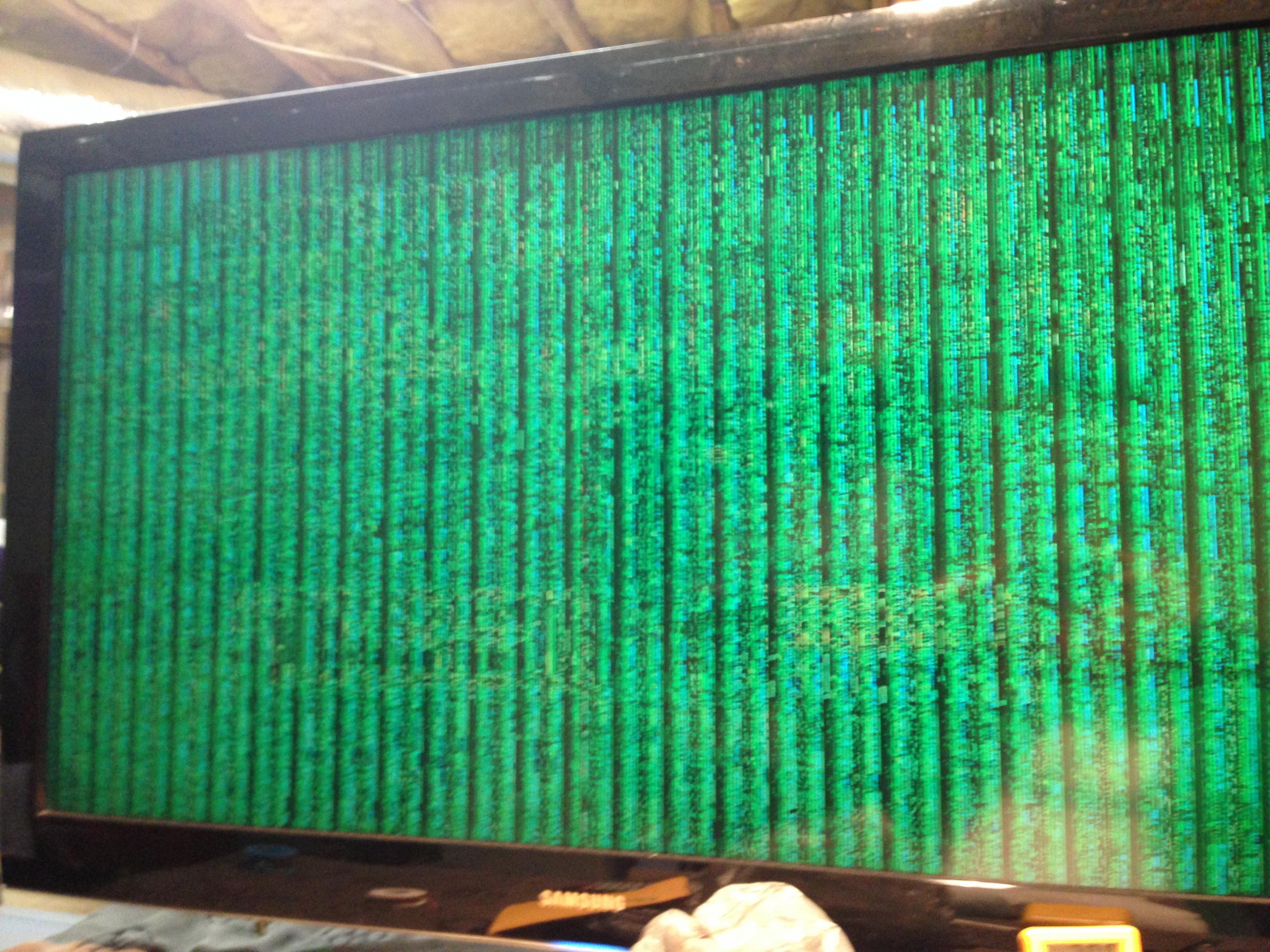

    I am working on a 46" samsung that makes a loud squeal and has a weird raster when you turn it on. You can let is click on and off by its self for about two minutes then after it warms up it plays fine. I resoldered all the transistors on the heat sinks on the main board and replaced all of the electrolytic caps except the two large ones. They were none of the caps bulging. I unplugged the ribbon cables going to the t-con board and the buffer board and it still does the squealing. I suspect it is something on the main PS board but I need help at this point.
    The PS board number is: BN44-00201A. I will attach a photo of the weird raster that has alot of lines with a green screen.

    Re: Samsung LN46A550P3FXZA Squealing, clicking on and off
    I have the 42" Samsung from this era doing exactly the same thing, you can try to reflow the MB but its a bad CPU solider job that needs to be either reballed or the board needs to be replaced.
    Mine if I apply pressure and turn it on it comes right up no issues but if I let go and turn it on before its been warmed up it does what you are describing until it warms up enough to contact.
    try heating up the MB with a hairdryer before you turn it on and see if it fires right up warm vs cold.
    I just live with it as its an extra TV in the workout room and the mainboard at the time was 150+ minimum.

            Heated the CPU and pressed on CPU while powering up and problem never went away. ????

                What is strange after it heats up it plays like a champ. I pressed on all the chips and pressed on the boards and could not get it to fail. It's just at first when you turn it on after cooling down. I might see if I can find some cool spray and and shoot components one at a time and see if I can duplicate the problem. Thanks for the help. I will keep you posted.

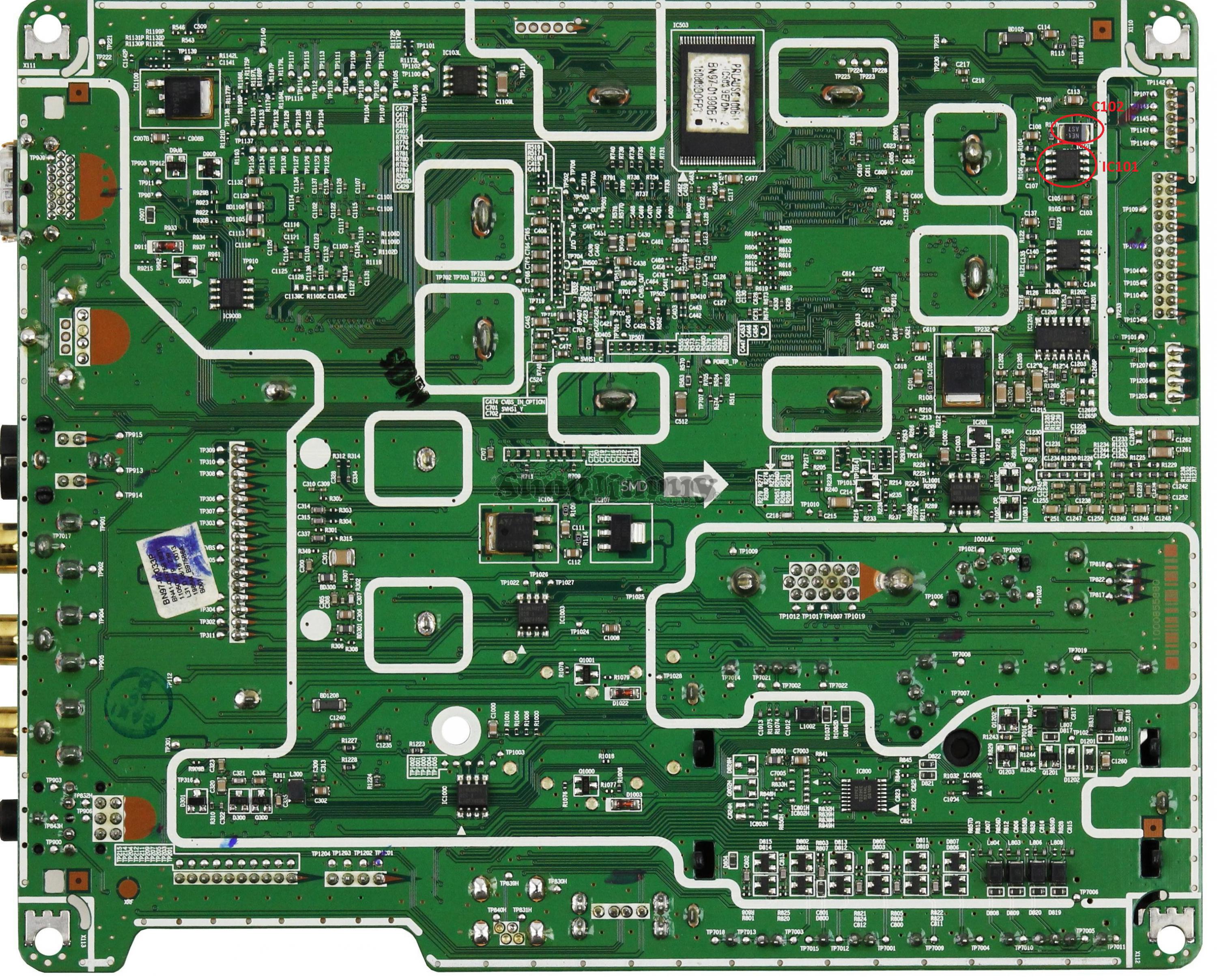

                      The squealing coming from speakers, right? I have one 32" and one 46" that are doing the same right now, SJ has the repair kit for the main board but I cannot figure it out yet what the cause of the problem is yet.

                            If I remember well, somebody found a bad capacitor on these A series boards.
                            • tibimakai
                              • Jan 2012
                              • 3680
                              Shopjimmy has a picture with that capacitor:
                              http://www.shopjimmy.com/samsung-bn9...550p3fxza.htm#
                                Picture shows One cap and two ICs, but description shows 1 cap, 1 IC.
                                http://assets.shopjimmy.com/media/ca...side_2__12.jpg

                                  FIXED !!!! It was a bad solder joint on the cap on the back of the main board. C102 which is right above IC101.Below is the picture. Thanks everyone for your help it pointed me in the right direction.

                                      I did a research on that cap, it is NEC-TOKIN NEOCAPACITOR 47uf 10V (NE AS7). The IC is MP2363DN: http://www.mouser.com/ProductDetail/...jHRp44hg%3D%3D
                                      There are two buck regulator swithching circuit in that section.
                                      I will try that on my board.
                                      Better picture on post 16.
