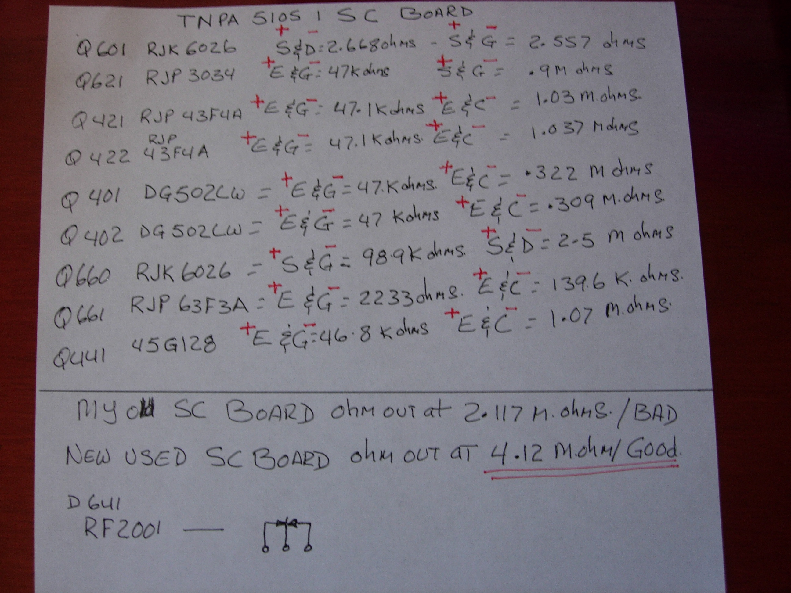

            Ok guys I finally got this tv going I bought a used SC board on line , the board was supposed to be a for parts or repair , After the board arrived I started to check out all the fets and diodes ,they all checked out good, put the board in and start it up , it started right up and been running for the last three days.
            Here are some test results from checking the transistors and fets :-
            + indicates red lead on multitester
            _ indicates black lead on multitester
              #46
                those results from working or not working board? Q601 you have at 2 and bit ohms?
                  #48
                  Re: Panasonic TCP-42S2 6blink
                  Those results are for a working SC board tw2005
