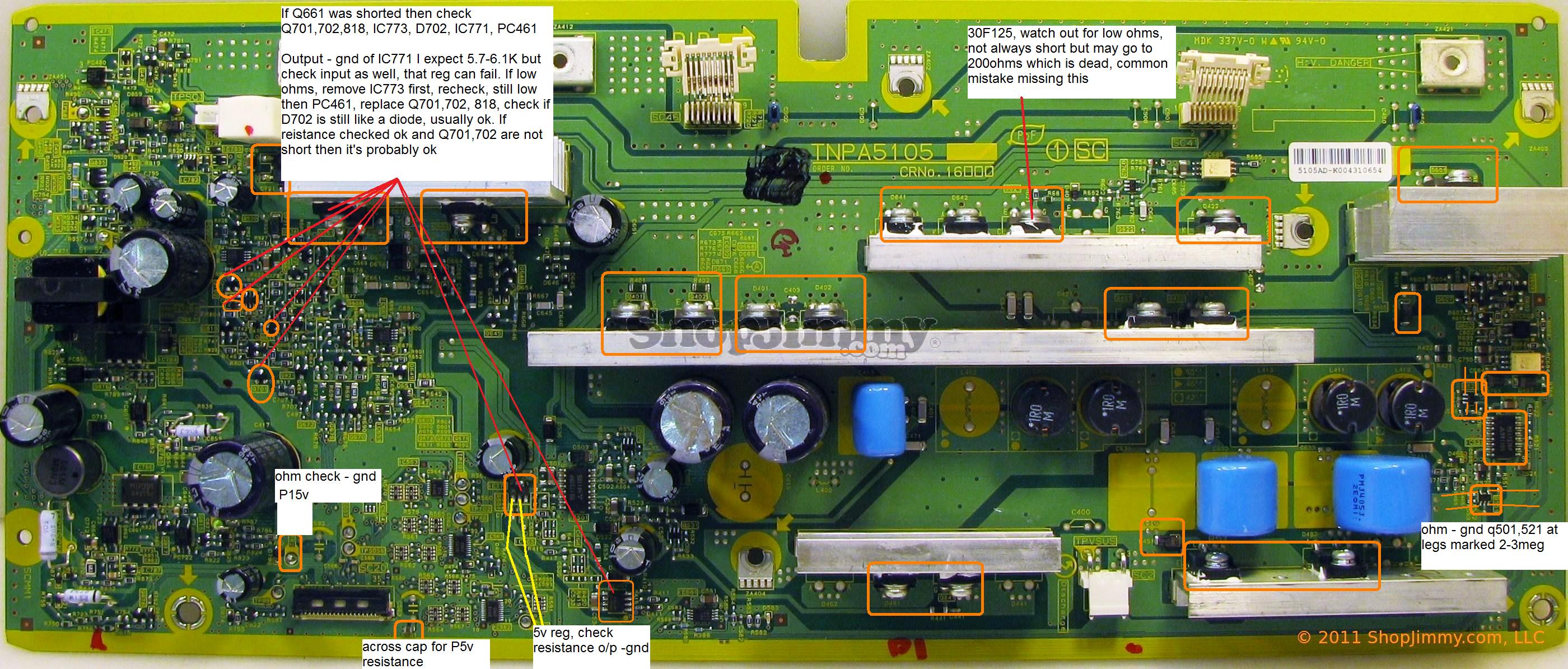

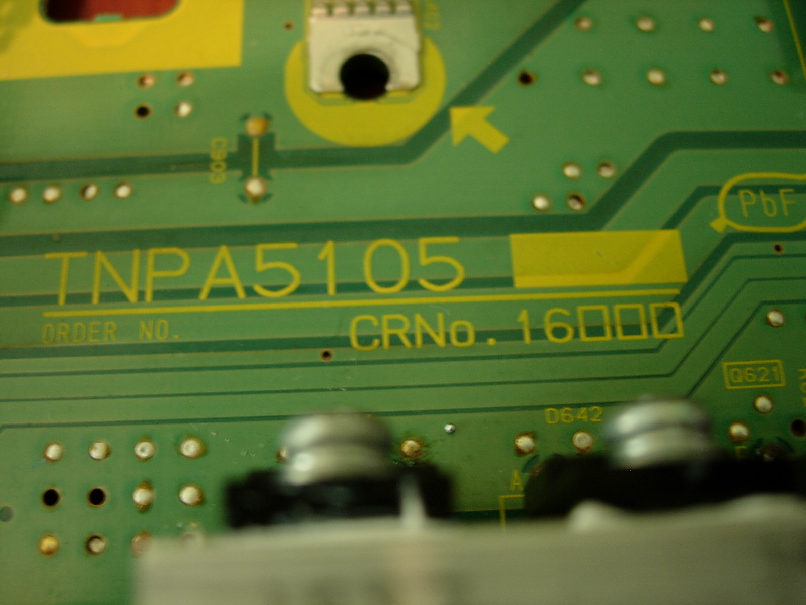

          A 5105 repair should be similar to a 5081 and 5066 Sc board repair. I'd get away from thinking caps.you can search tnpa5081 for some ideas
          I'm thinking on these we're looking at RJP63F3A,RJP43F4A,RJP56F4A,30F125, not sure if these have 45G128 for the IGBTs used, not sure. list what you have replaced pleas + the part number

                          Check D451 for short cct, SMD sits next to Q451. If TOM means the driver ICs, you replaced them , IC 521 and IC 501 M81737FP.

                              Here's a little feedback on a 5105 board. missed D451 (shorted) caused first failed repair attempt. mentions 7 blink
                              https://www.badcaps.net/forum/showthread.php?t=39312
                              I know from experience shorted D451 on a 5081 will cause the screen to very briefly energise and 6 blink. The cct design there is the same

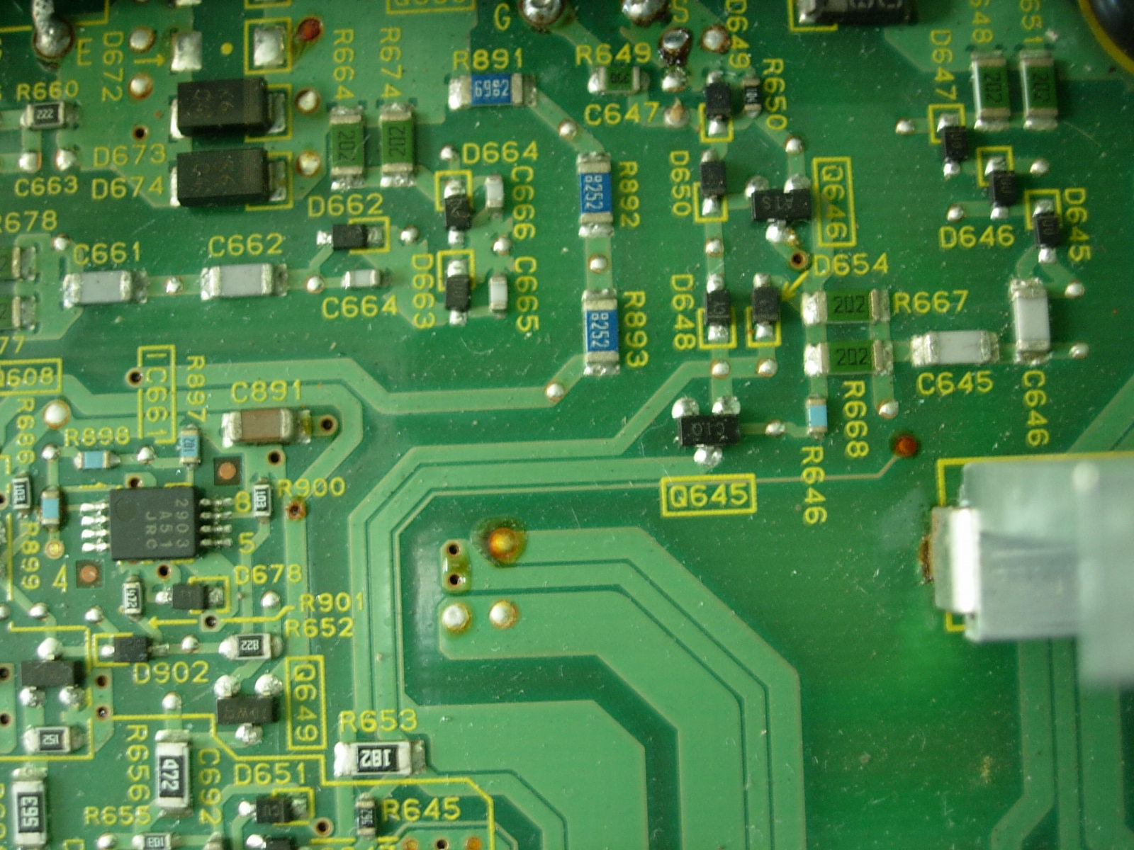

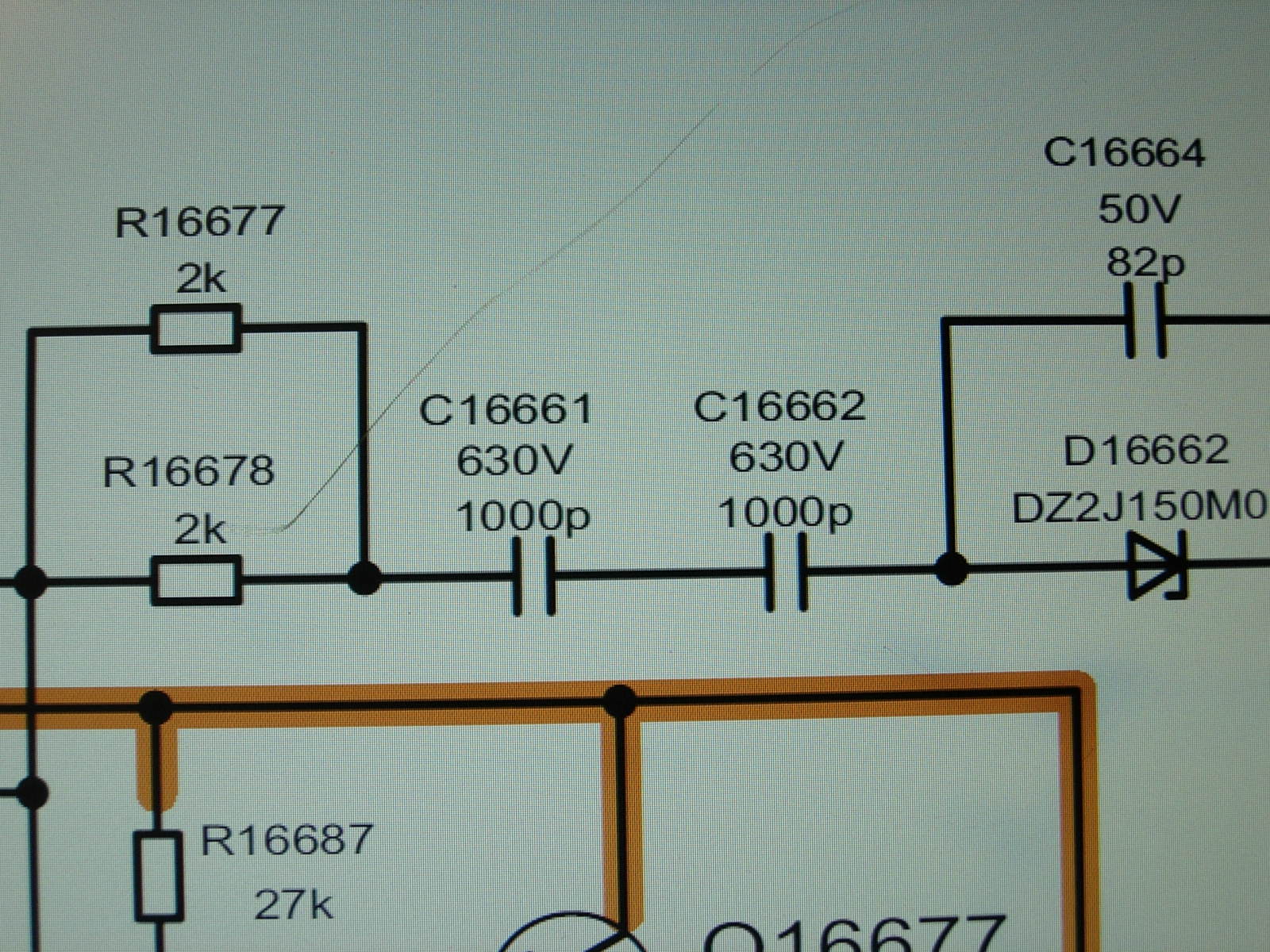

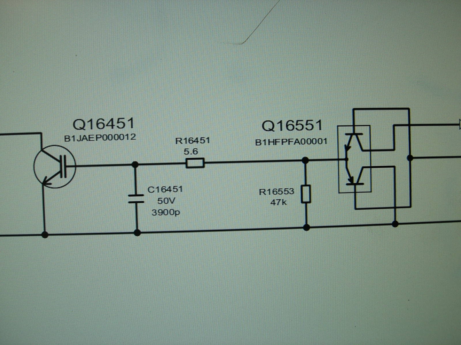

                                  Ok Guys I pulled the Sc board and recheck all the solder joints , I also check all the fets and diodes and found D451 45G128 shorted ,Q401 DG502LW shorted and one Small inverter 5 leg chip Q551, which I borrowed from a scientific Atlanta cable box and it works .
                                  The resistor I replaced is R451= 5.6k replacement is 5.64k .To summerise ,I placed the SC board back on the tv hook all the cables up ,power on and got 6 blink ,waited 5 minutes and I removed the SC20 cable and the tv stay on , Green light on SC & SS board.Time to look into the A board would u say .

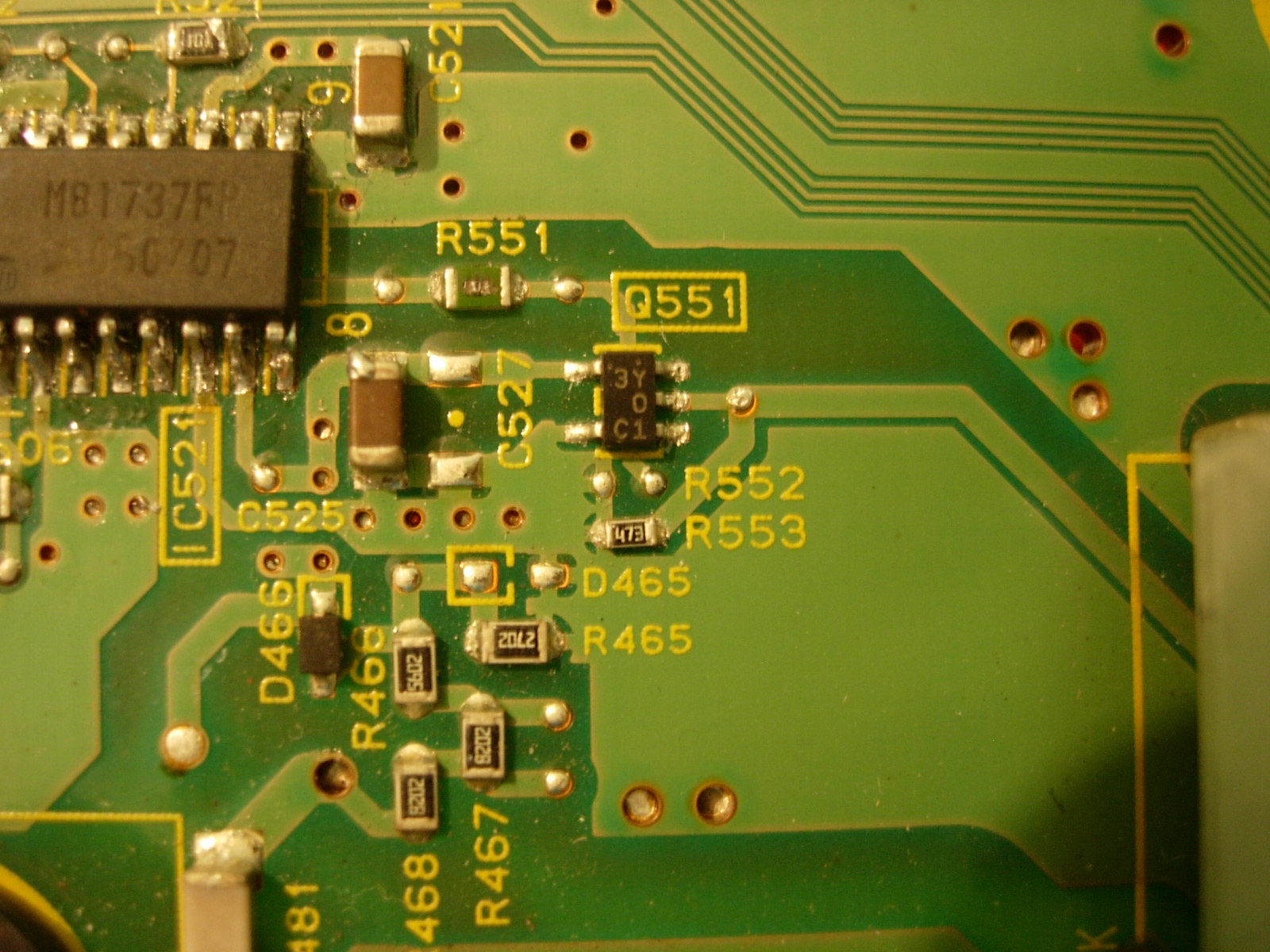

                                    Pic shows where parts replaced and their value.

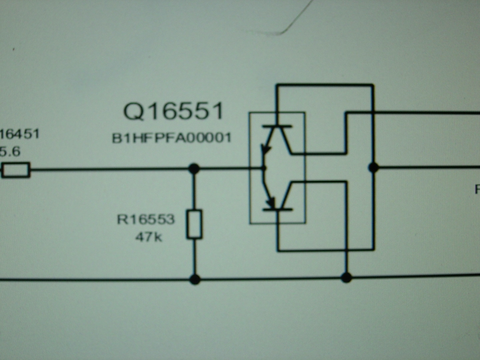

                                      So possibility D451 was originally shorted? the 45G128 is that shorted in or out of cct?
                                      Q551 which you borrowed, what markings are on that? It's not an inverter chip but a PNP / NPN high current switching
                                      Is everything else ok like Q661

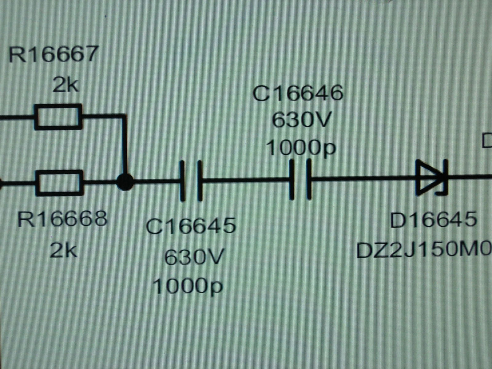

                                        Pic where resistor and cap were replaced
