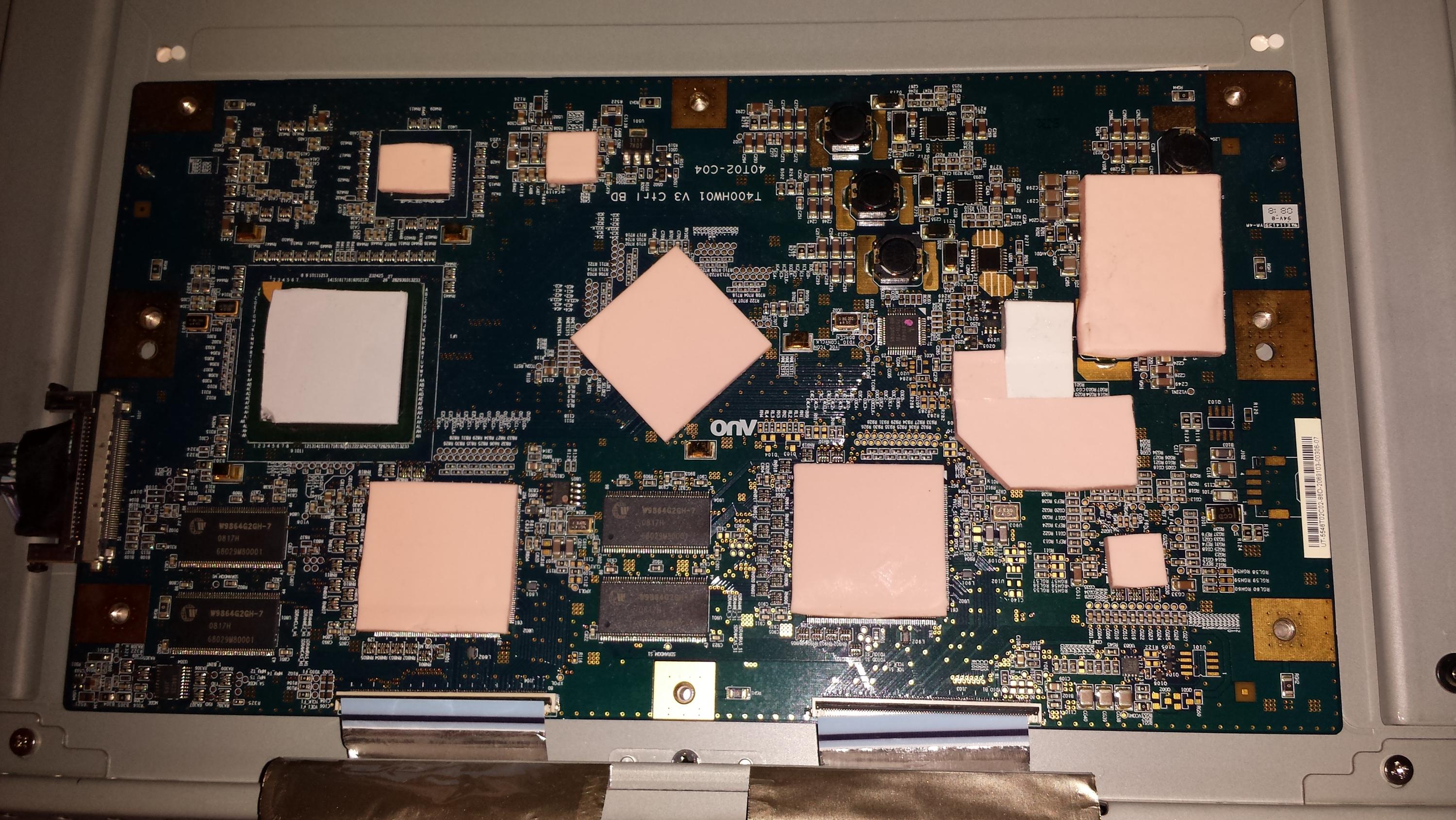

        Pictures of the board?

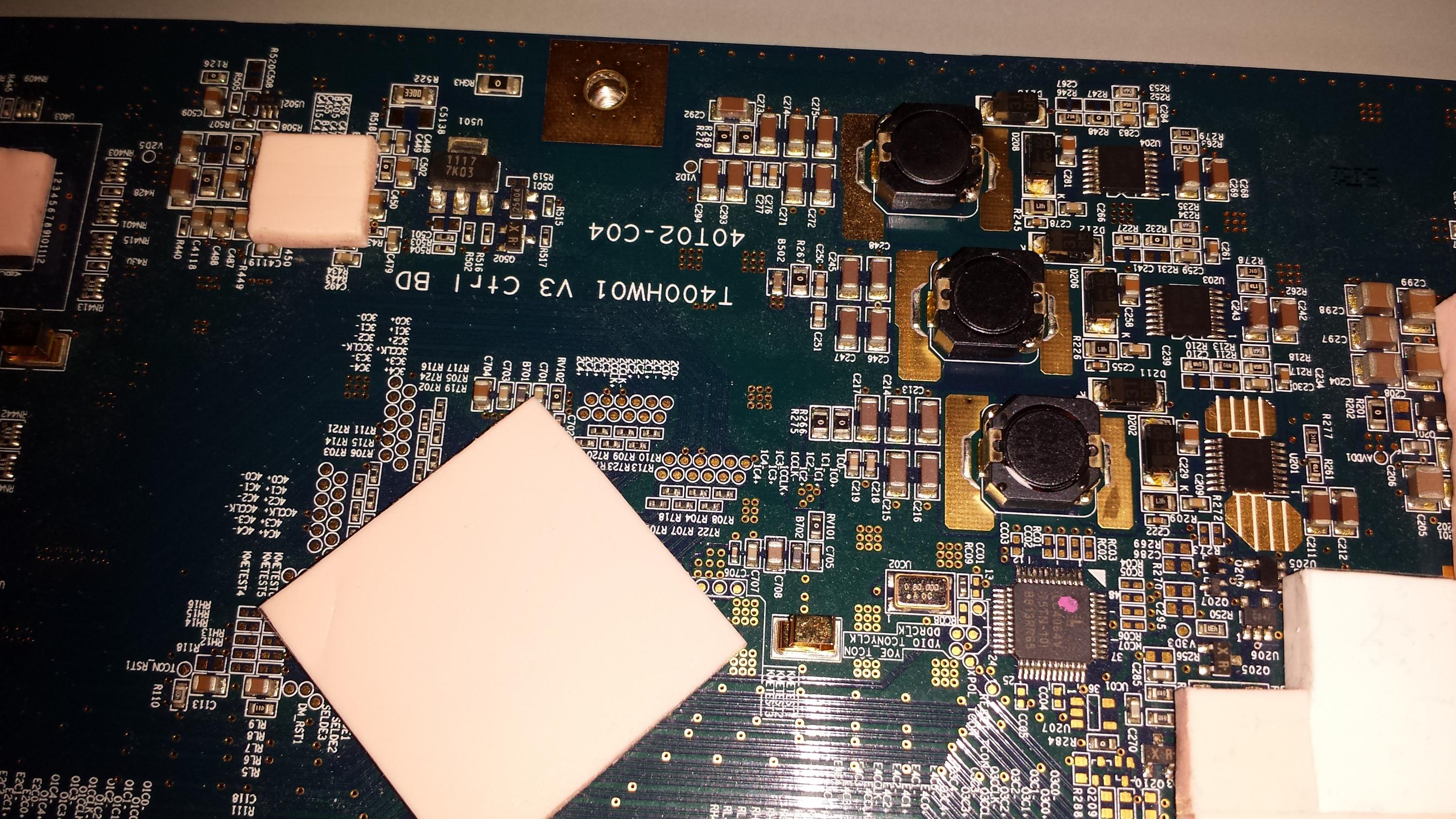

                Here the board and but seem to be getting 1.8 2.5 3.3 12 volts and other various voltages but I have noticed that if you look at the picture the very lowest Coil there's nothing. It would be at the bottom of the board. Sorry the pictures are upside down
                also I noticed if I leave one side the panel unplugged it turns white so obviously its getting voltage of some type
                  Re: sony tcon t400hw01 v3 no picture
                  Those 3 coils are for switching power supplies. There should be VGL (-), VGH (+) test points on the board some where which I do not remember what they should be.
                  You can look up the spec sheet for U201, 202, and 203 to see how they function.

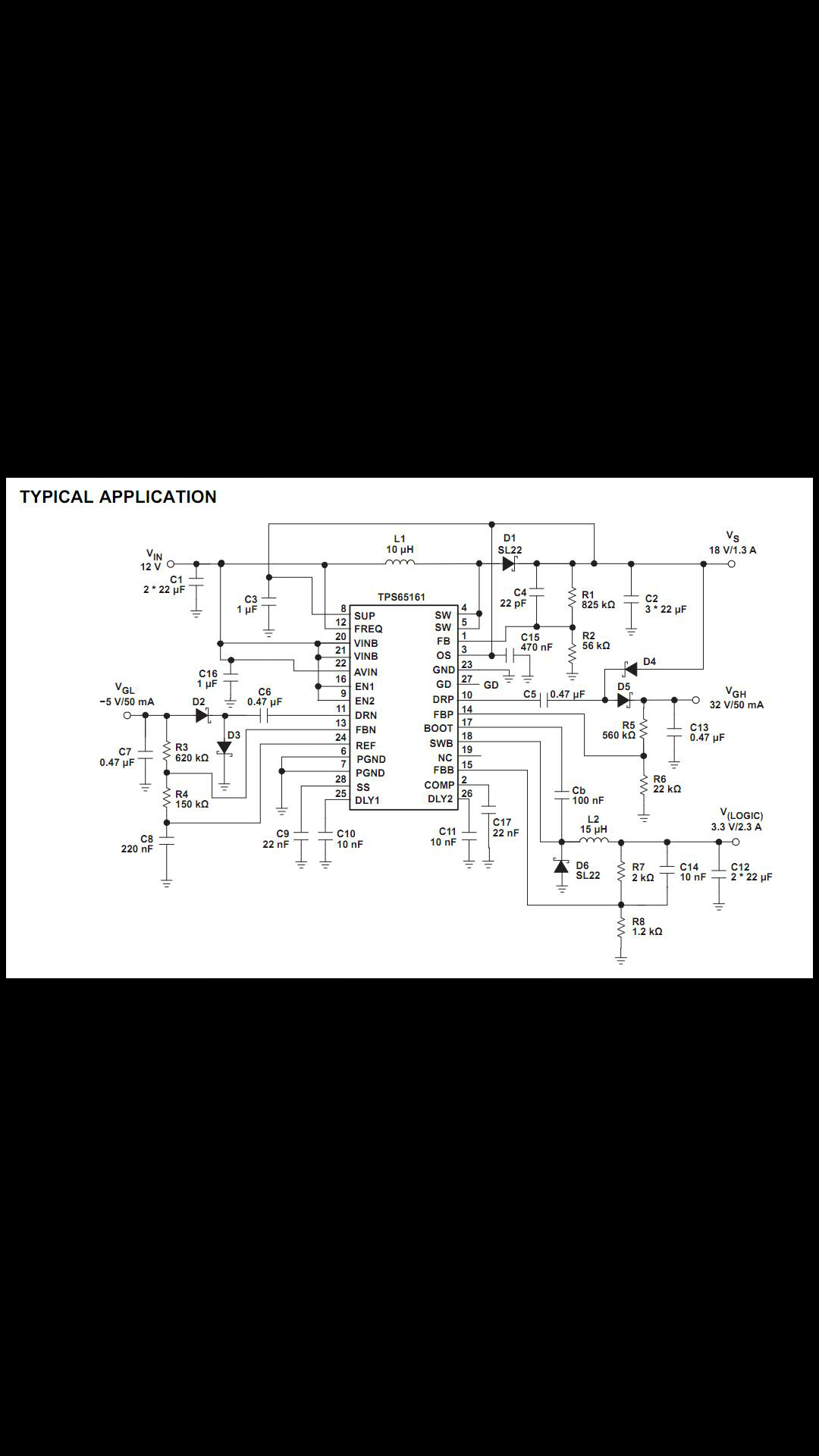

                                      Bud are you talking about u201 u202 and u203? (Seen in first picture in post number 8)
                                        Here's what I got on the IC. Does it make sense to you? I understand is a bias supply voltage ic. Texas instrument Tps65161
