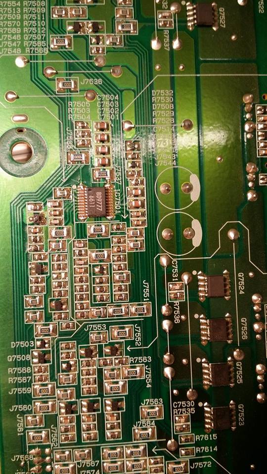

    Does this model have the capacitor c7558 to bridge so I can see the service mode without it shutting the screen off?
    I took a look at the board earlier and couldn't find it, I took a couple of pictures of the board where I thought it would be located if it's of interest to anyone.
    Any help or advice would be appreciated, thanks.

          And just in-case anyone was wanting to see the picture I took, I'll add that here it's where I suspected the capacitor to be, somewhere around IC7501.

            If posting more pictures can you please use manage attachments so they stay with the thread. Threads dont make much sense when the pics disappear
              Re: Sharp LC37GD8E c7558?
              To know which cap you'd need a BD9777 datasheet or schematic for that area or reference schematic for the BD9777.

                    In your picture to the left of BD9777 there is a small switching transistor. In the picture it looks in a bad way compared to the others - is it ok?

                      I think it's just the way the light is hitting it because surely I wouldn't have missed something looking like that, but to be sure I'll take a look at it tomorrow. I'm currently trying to find something that will tell me the which pin is which on the IC

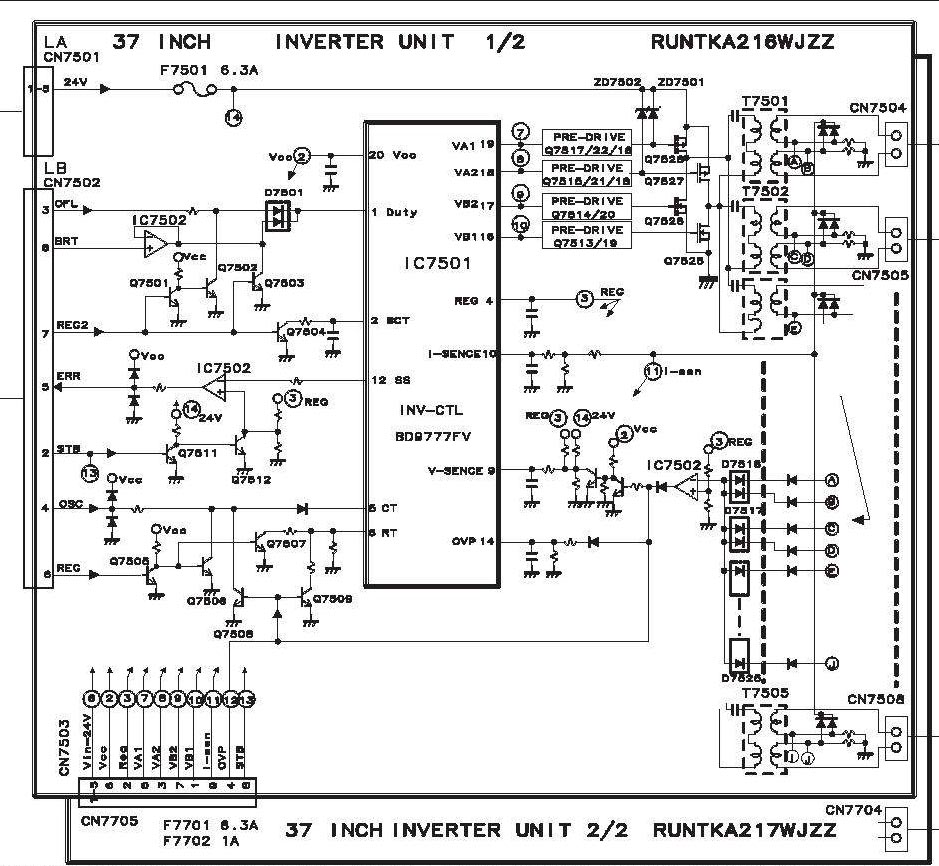

                          Some where in that there is this: http://4put.ru/pictures/max/628/1929897.jpg
                          EDIT I will try and attach that in case it vanishes

                                C7558 is located at pin 1 T7502
                                To bypass the protection OVP in ic BD9777 connect PIN 14 to gnd.
                                The backlight should light, but no service mode.
                                To access service mode hold “VOL-“ and “INPUT” keys at same time that AC cord is connected.
                                Next, hold down the “VOL (-)” and “P ( ▼ )” keys on the set at once.
                                Using keys (UP/DOWN), go to [LAMP ERROR RESET], using keys (LEFT/RIGHT)
                                go to [LAMP ERROR RESET]. Finally, press “OK” to pass Lamp errors counter to “0”.
