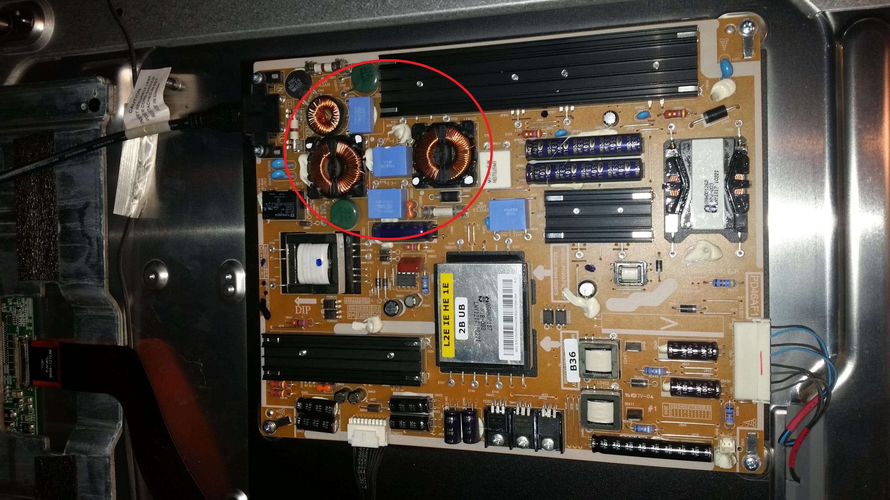

            Re: Samsung ue46c6530
            main board disconnected 5.3v rail is 0.00 volts
            main 450 volt caps are 0.00
            picture attached showing where clicking noise is coming from

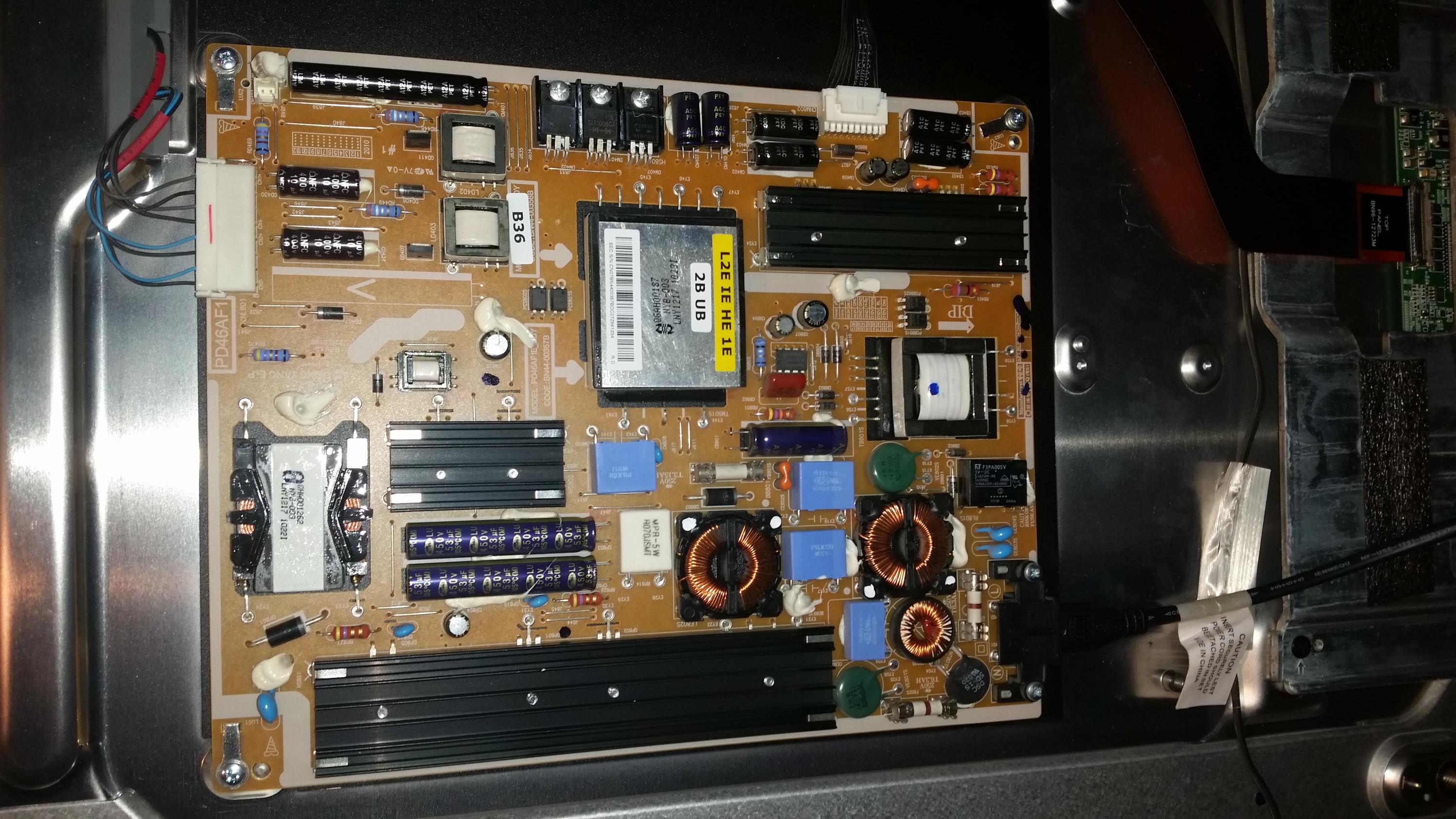

              More likely the black box at the end of the board just outside the red circle - looks like a relay? On the end of the heatsink looks like a 4 legged component - is that the bridge rectifier. The two outer pins should be around 300 vDC and the two inner pins 240vAC
              can you test there?
                yes its the bridge rectifier
                inner pins 83 volts AC
                outer pins 0.00 volts

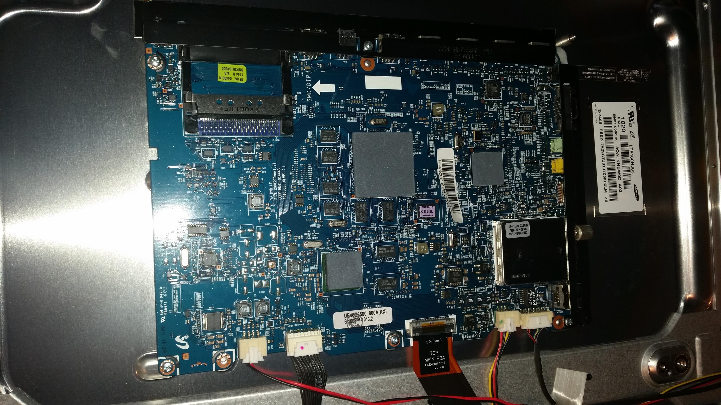

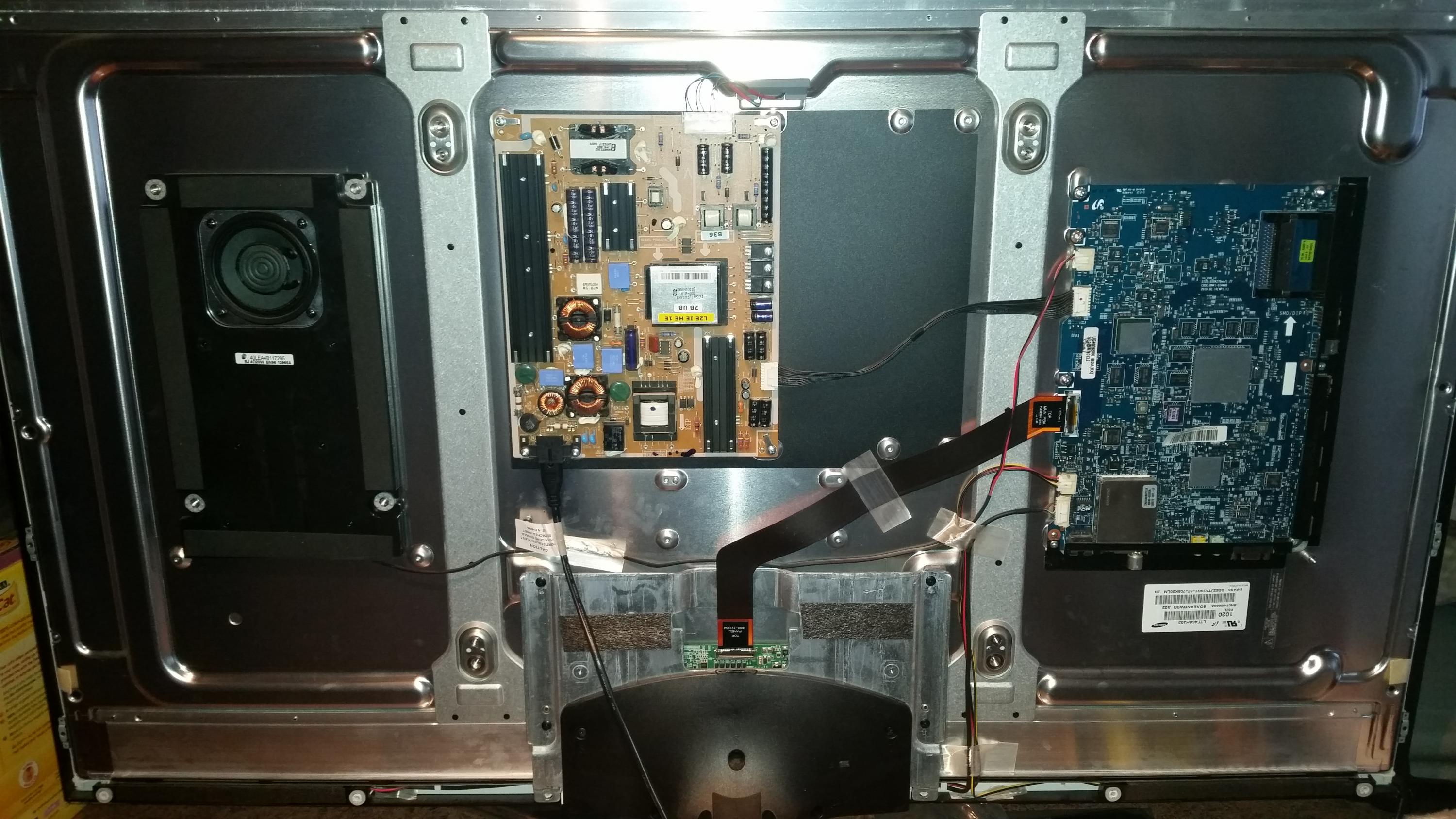

                                      Can you find a pin on any of the sockets marked pson/ pwron/ pwr the board descriptions for the sockets seem to be covered by labels!!
                                      Try to find the voltage regulators on the main board - picture is not really clear enough.
                                      I can make out one on the right hand side of last pic just to the left of the tuner box
                                      has a (backwardC ll) on it and 1117 - there is another ,I think between the two sockets
                                      below that.
