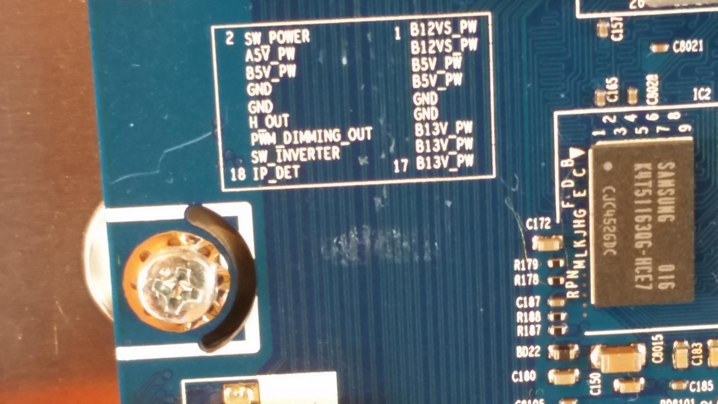

      Re: Samsung ue46c6530
      removed some labels and found these
        Connect SW_POWER to A5V_PWR to turn the power board on. Since the board has a built in resistor you can use a piece of wire.

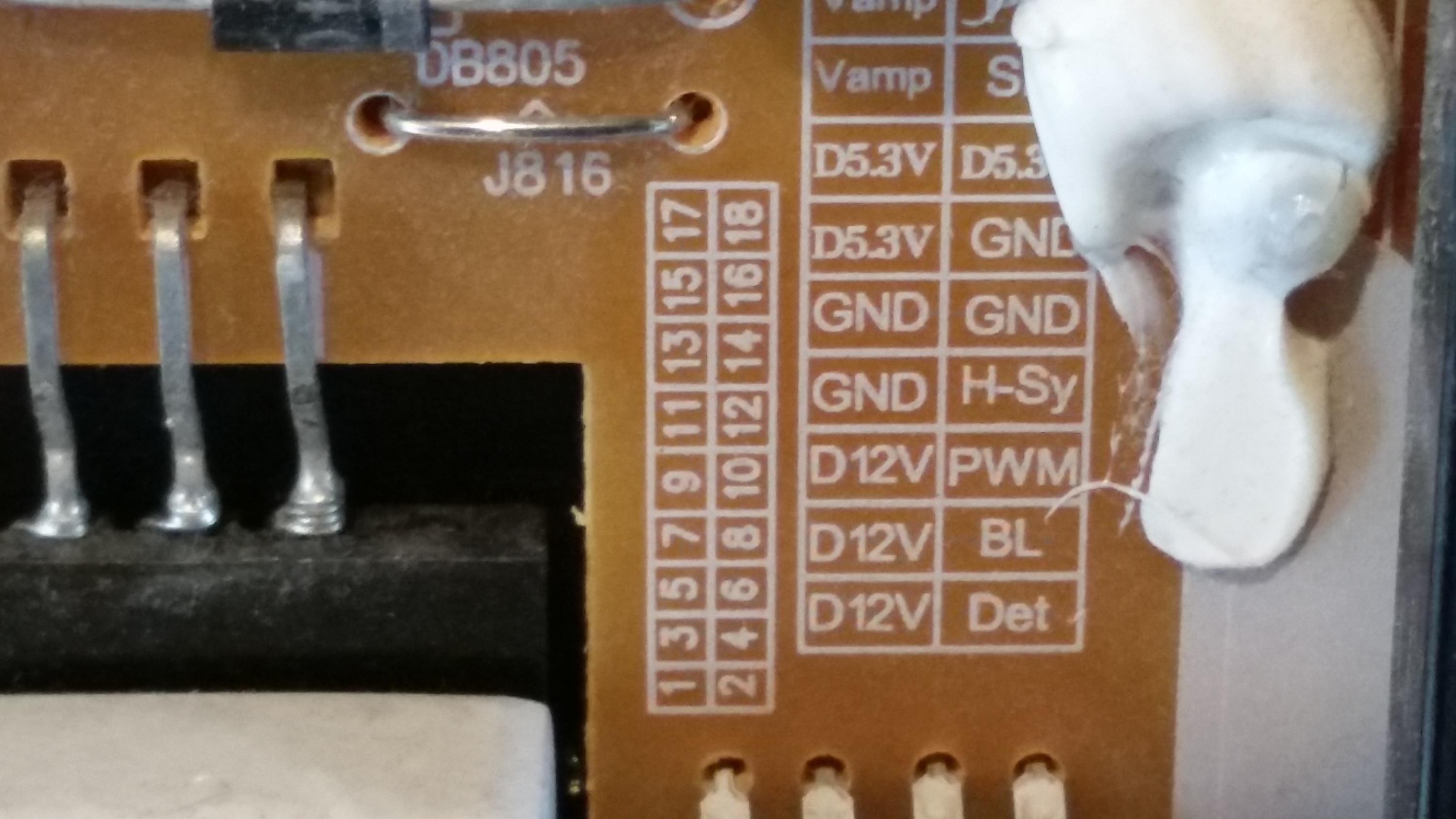

          jumped SW_POWER to A5V_PWR and reading are as follows
          VAMP 0.00 PS 5.3V
          VAMP 0.00 SB 5.3V
          D5.3V 0.00 D5.3V 0.00
          D5.3V 0.00 GND 0.00
          GND 0.00 GND 0.00
          GND 0.00 H-SY 0.00
          12V 0.00 PWM 5V
          12V 0.00 BL 0.00
          12V 0.00 DET 0.00
            Hmm, that does not make much sense, was that using the legend on the power board, or on the main board? as the one on the main board is in reversed order, you should use the power board one.
              i jumped as per picture attached
                You should hear a relay click when the board is plugged in. Do you?

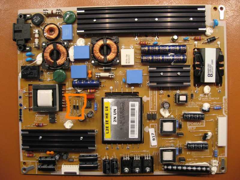

                            ok found this while searching i had to translate from german to english
                            hello
                            After I be a Board member (Hubert Jung) still faulty power supply
                            Samsung BN44-00357B left to determine the cause, here is my
                            Results.
                            problem:
                            Despite exchange of nearly all electrolytics the power supply does not start forever! : angry:
                            solution:
                            Investigation of Stdby power supply.
                            1.the Vcc (operating voltage) of the ICB801 is not always available.
                            this is obtained from an additional winding of the stby transformers.
                            in the investigation of the components turned out that the diode DB804
                            (UF4007) temporarily interrupted.
                            after the exchange of the same start of the power supply was carried still quite
                            rather sporadically, so keep looking.
                            Was 2.jetzt the operating voltage at which the other stages (PFC, operating power supply) are started not always provided.
                            The Stdby power supply was stable!
                            So DB805 (UF4007) examined, same error as in DB804, internal contact failure.
                            When resolder the components of the Stdby power supply, in the end, I contracted a capacitor (CB803) as refracted out.
                            This result I do not consider representative.
                            For me 3 Defective components in a stage are a little much.
                            This, however, it is 2 diodes of the same type speaks
                            not for their manufacturers.
                            At this stage, there were two additional installed but no defects
                            had (but I had expected).
                            For problems with this power supply, after unsuccessful Elko exchange this troubleshooting process may, however, at least not hurt (two measurements)!
                            The tensions in Stby should amount to about Vcc 12V and 45V M_Vcc approx.
                            • sordids999
                              • May 2013
                              • 2158
                              • uk

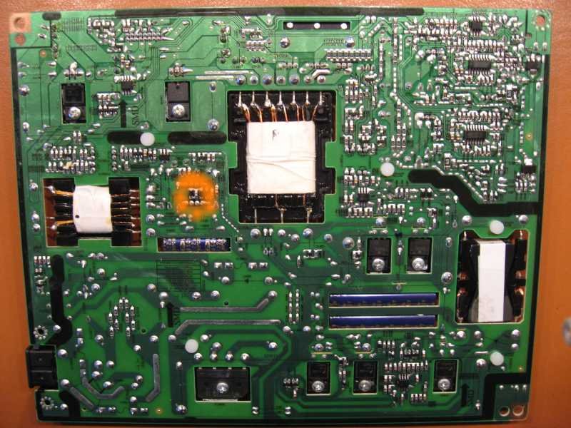

                              #34

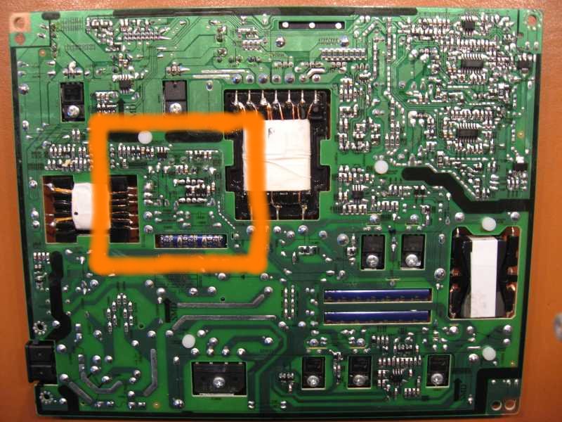

                              the capacitor is a SMD.
                              sits between the diode under the ic.
                              area circled in the picture.
                                11,13,14 should all be the same, not different.
                                You should use this legend, to avoid confusion:
                                https://www.badcaps.net/forum/attach...5&d=1416653794
                                That issue is worth investigating, it would seem like the main power supply rails do not turn on when you jumper the lead across.

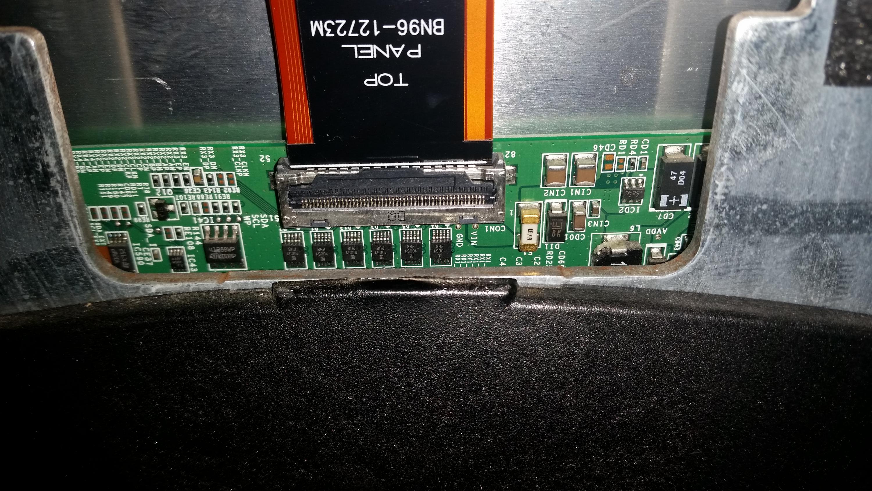

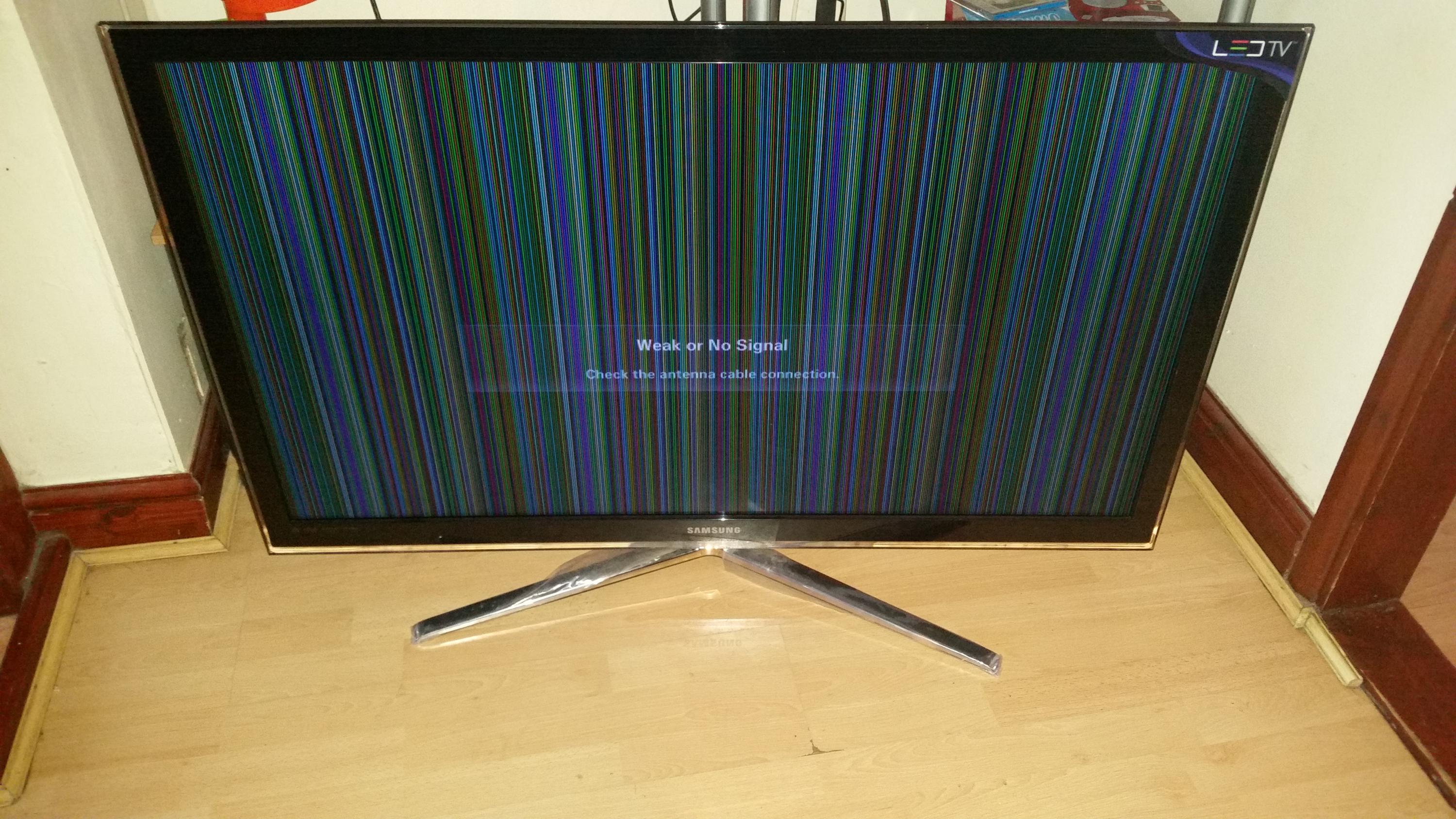

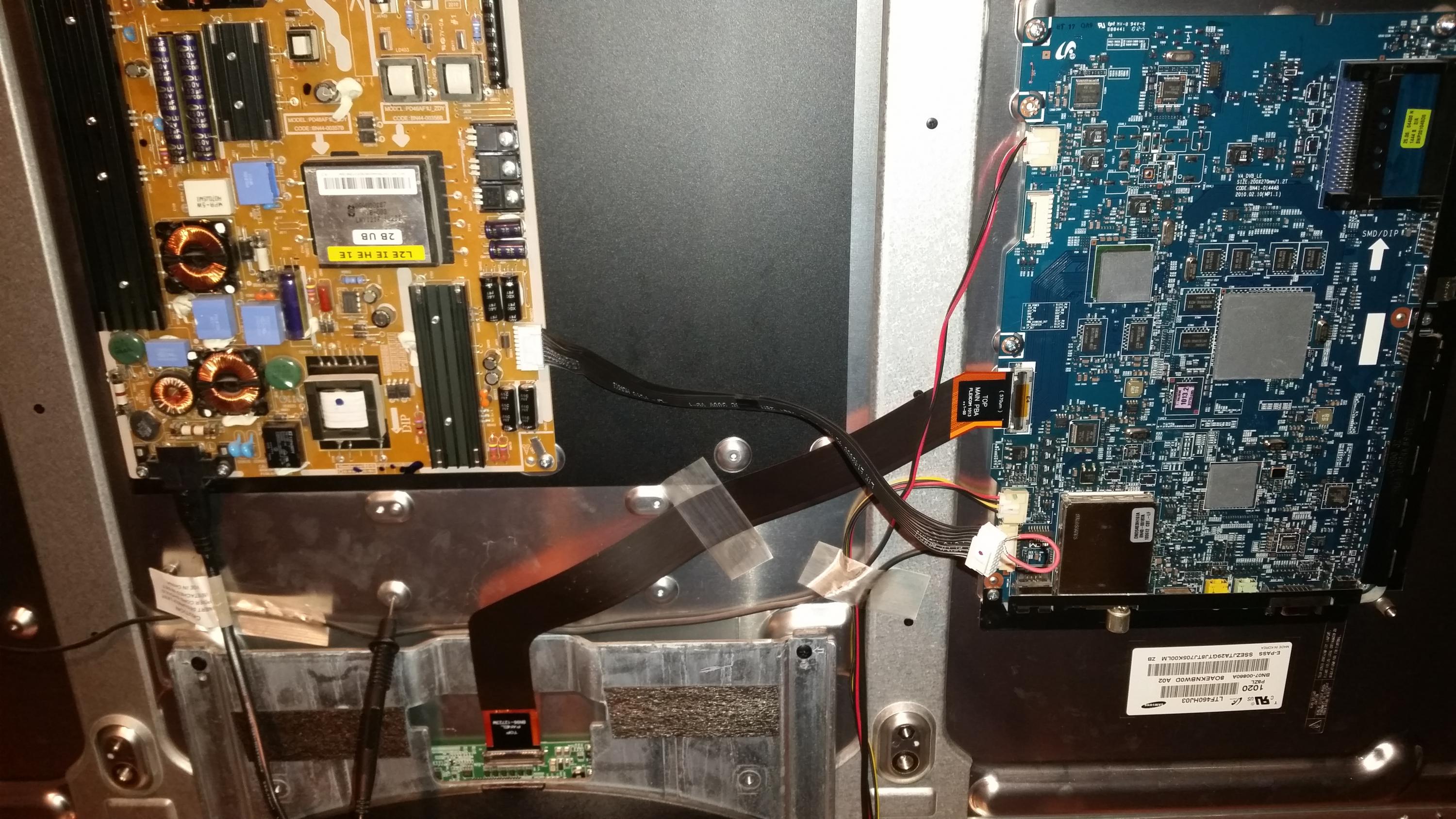

                                        update :
                                        Psu repaired but on turning on the tv im getting this picture that i have uploaded you can see a picture but with lines,i have tested the tcon fuse but im not getting 12v across the fuse so any advice tcon,main board,panel ?
                                        thanks
                                          #40
                                          You should get 12V on both ends of the fuse, and nearly 0V across the fuse (it's essentially a piece of wire in a box, so you don't expect much drop across it!)
                                          Hard to tell. I'd be tempted to say panel, but I always say that. Not typical for panel fault. So there's a change!
                                          Try this:
                                          - On remote: enter service menu using Info Menu Mute Power (must be done from standby)
                                          - Select "SVC" from menu
                                          - Select "Test Patterns"
                                          - Try Genoa-P/Napoli/or others if available, use enter then left/right to choose patterns
                                          Those are from US model, there's a chance your set is different
