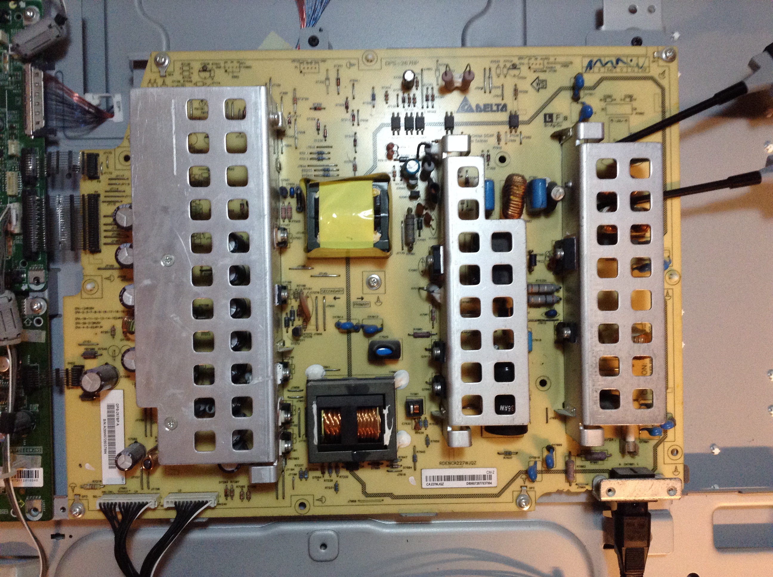

      Please upload the pictures of the boards and the whole backside of the TV.

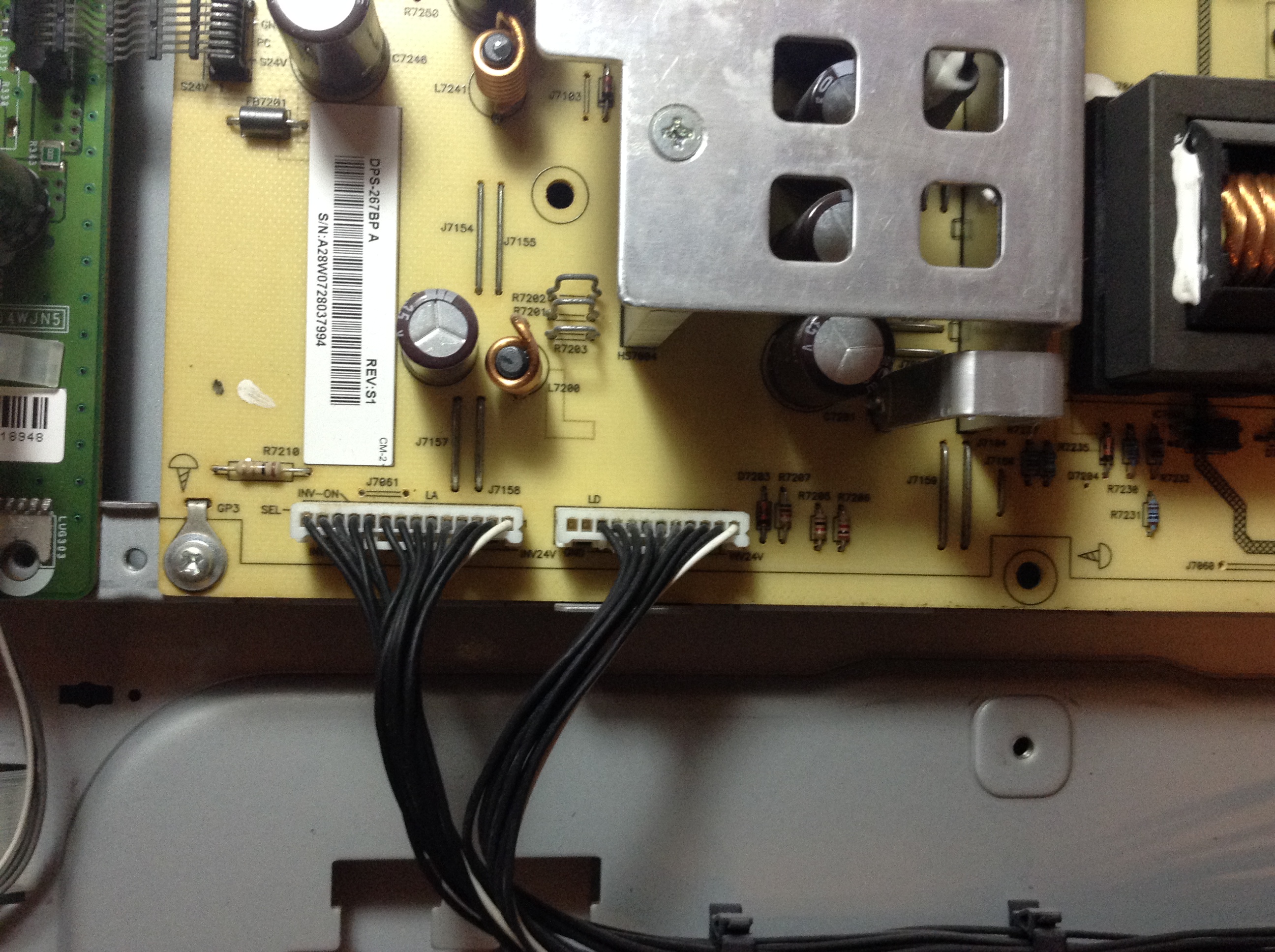

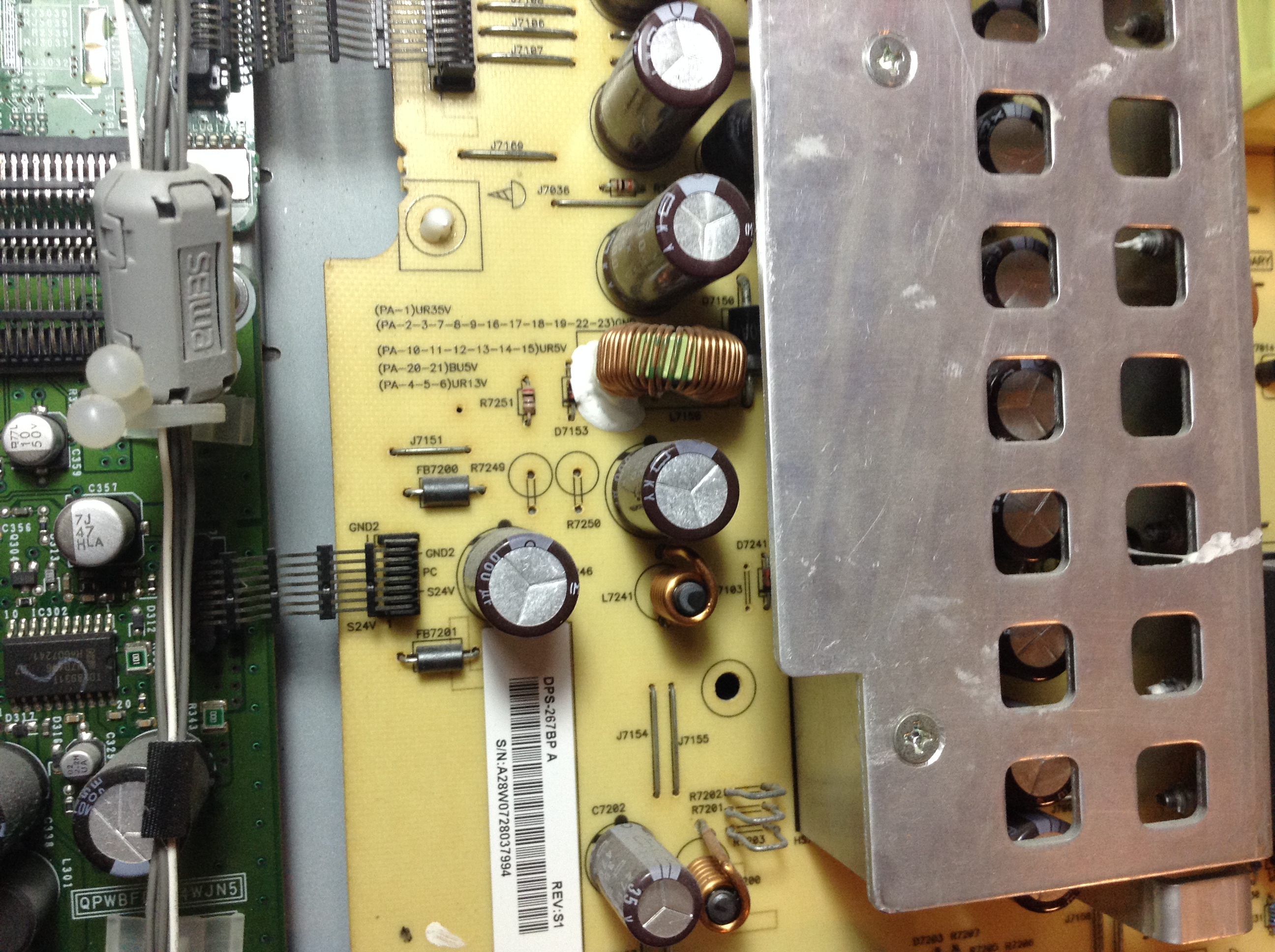

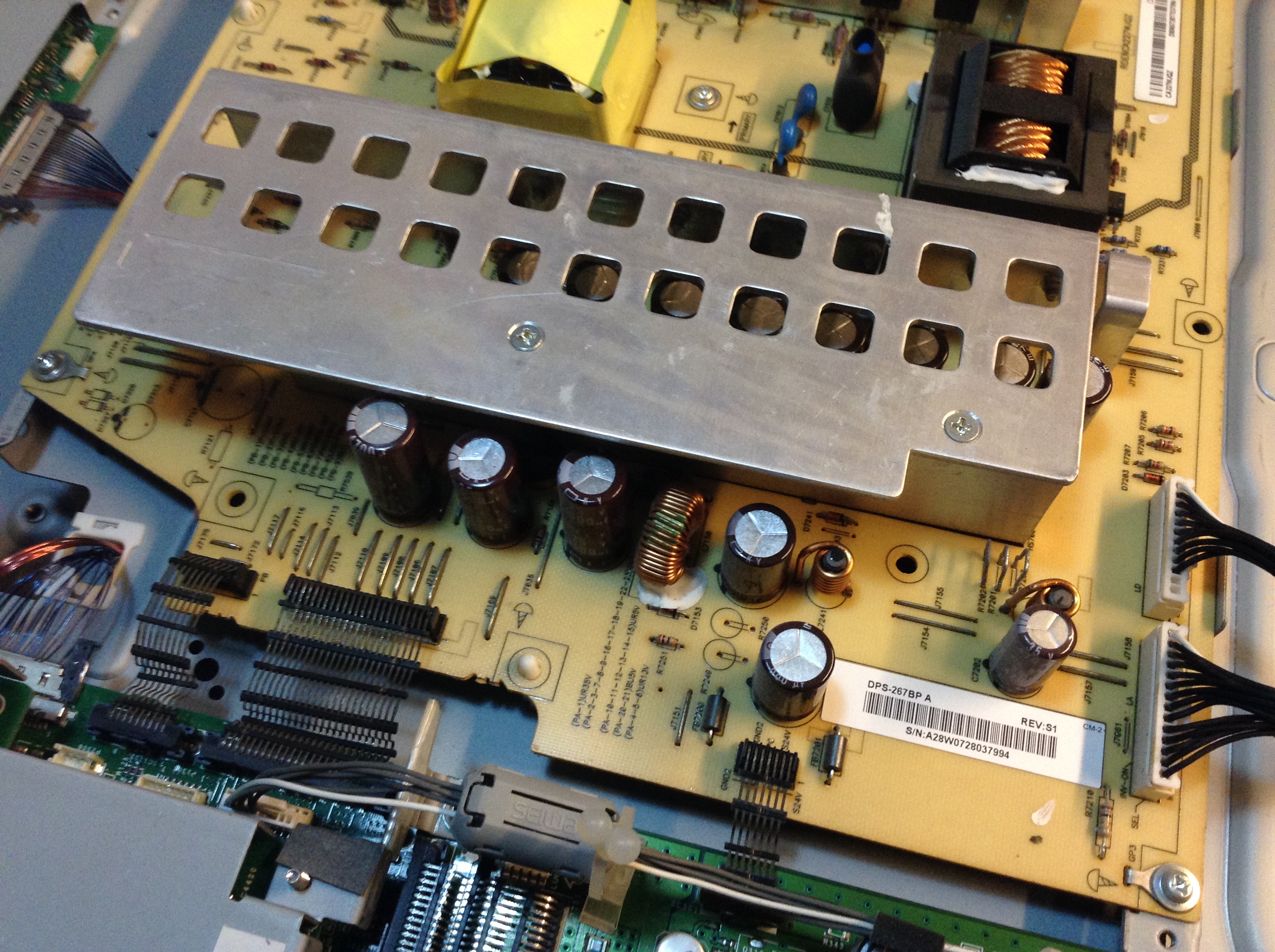

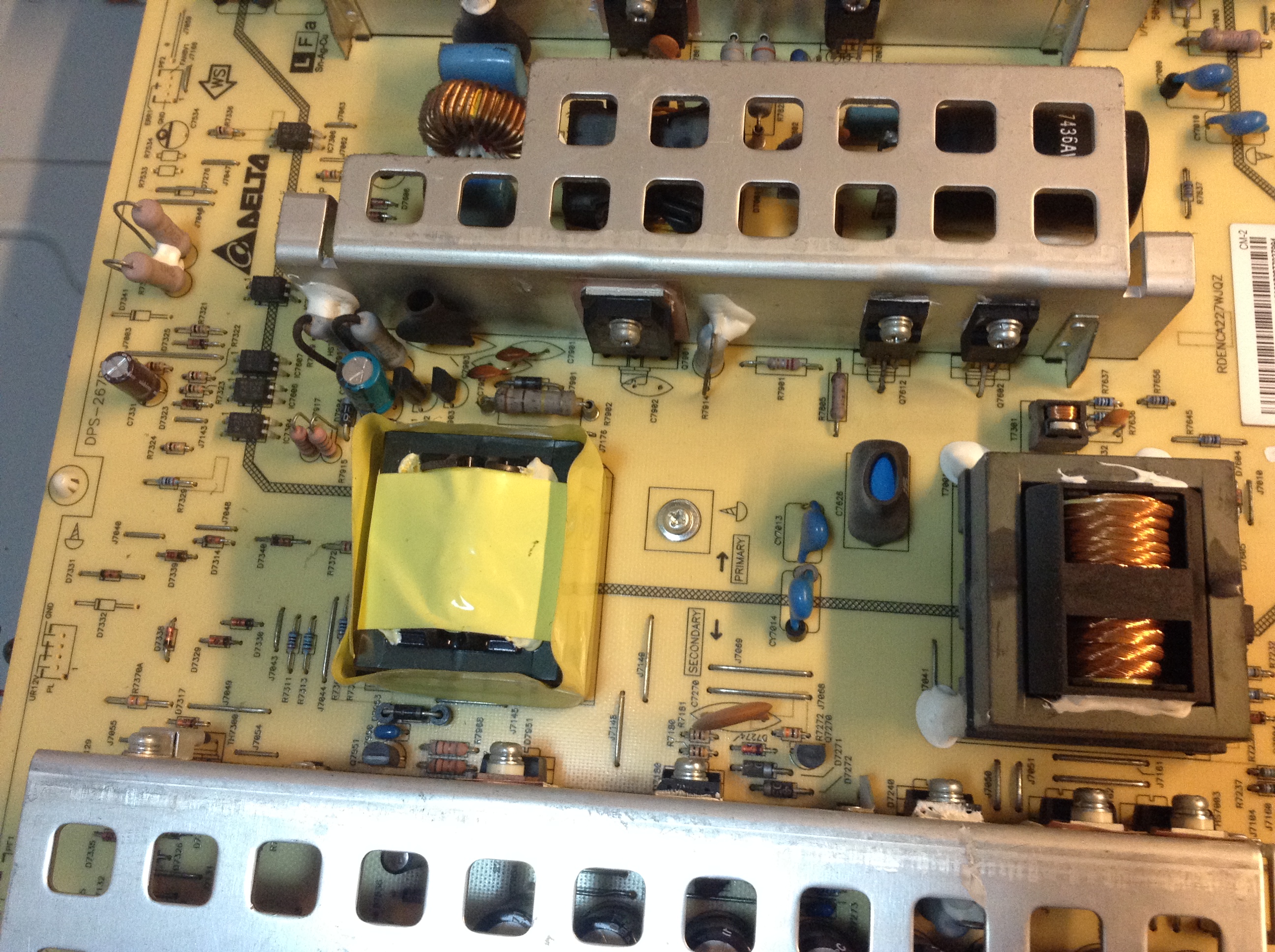

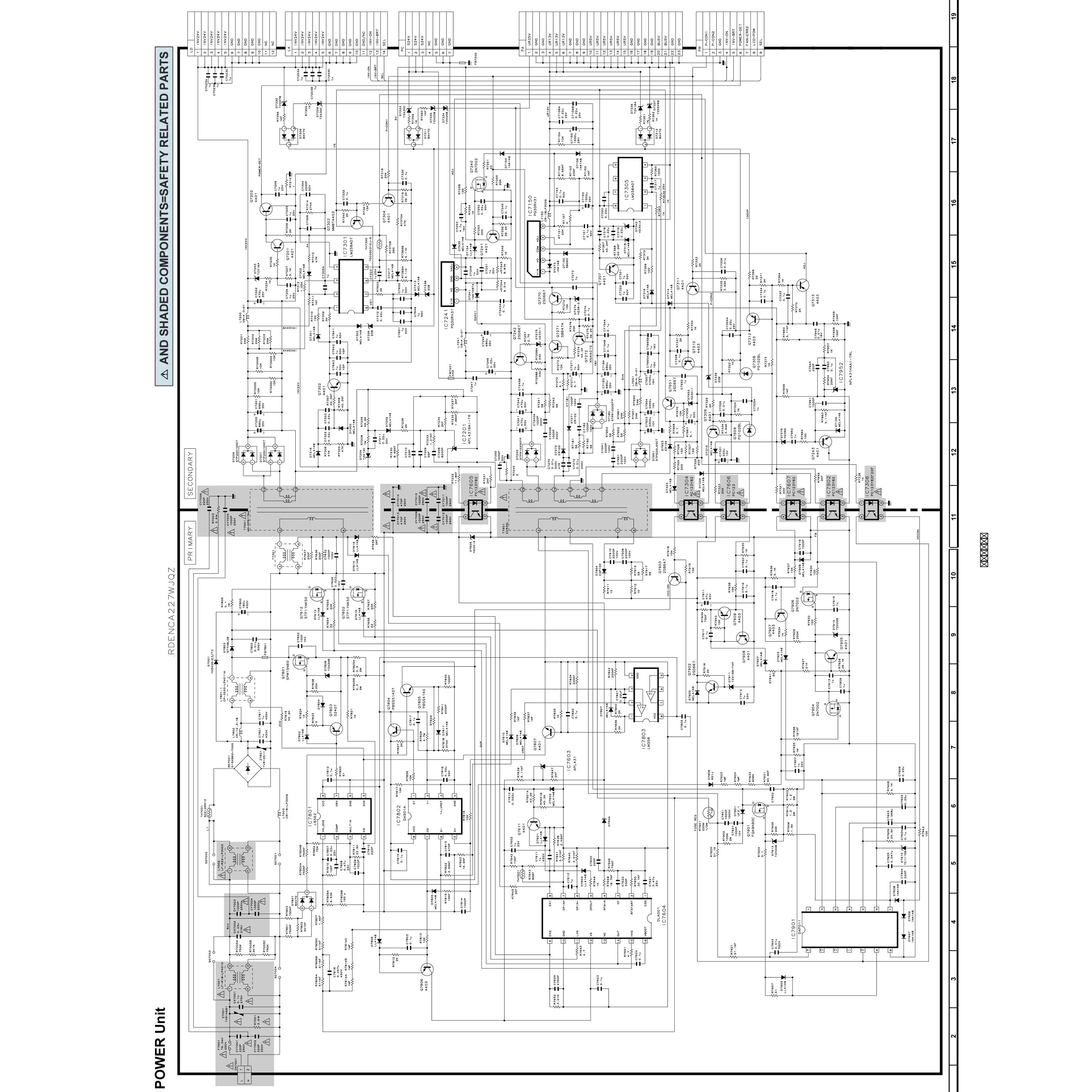

        Well here are the photos and some schematics I'm using. If you need more detail photos tell me please.
        Thanks a lot.

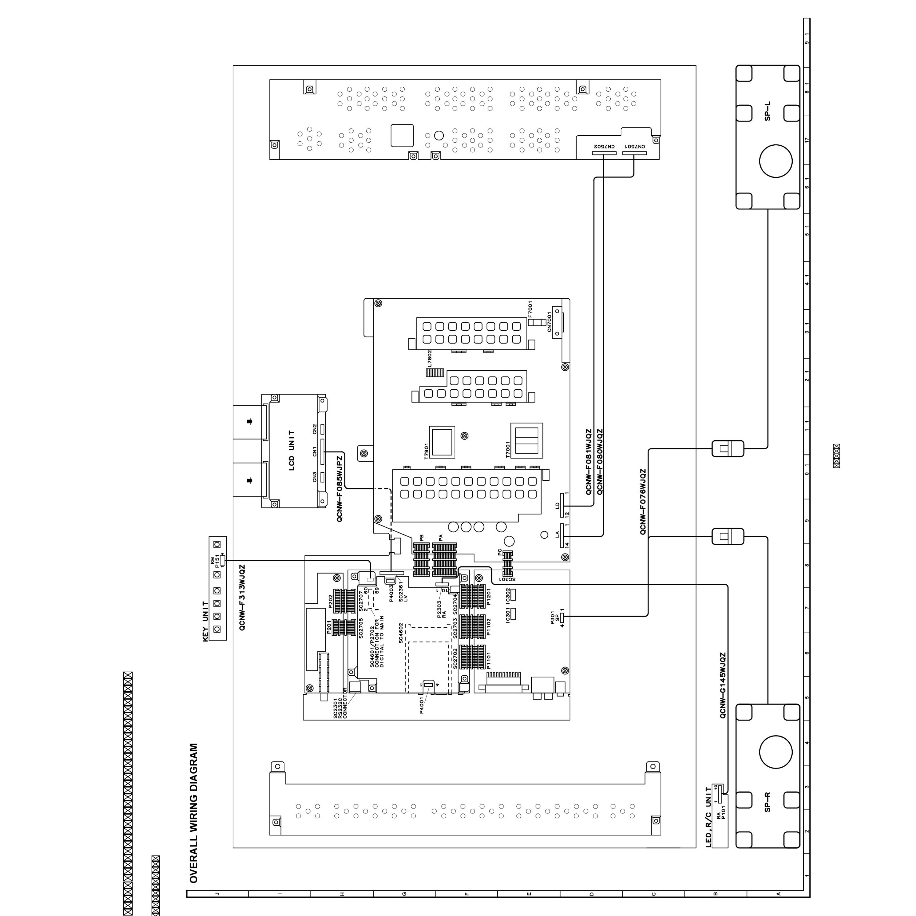

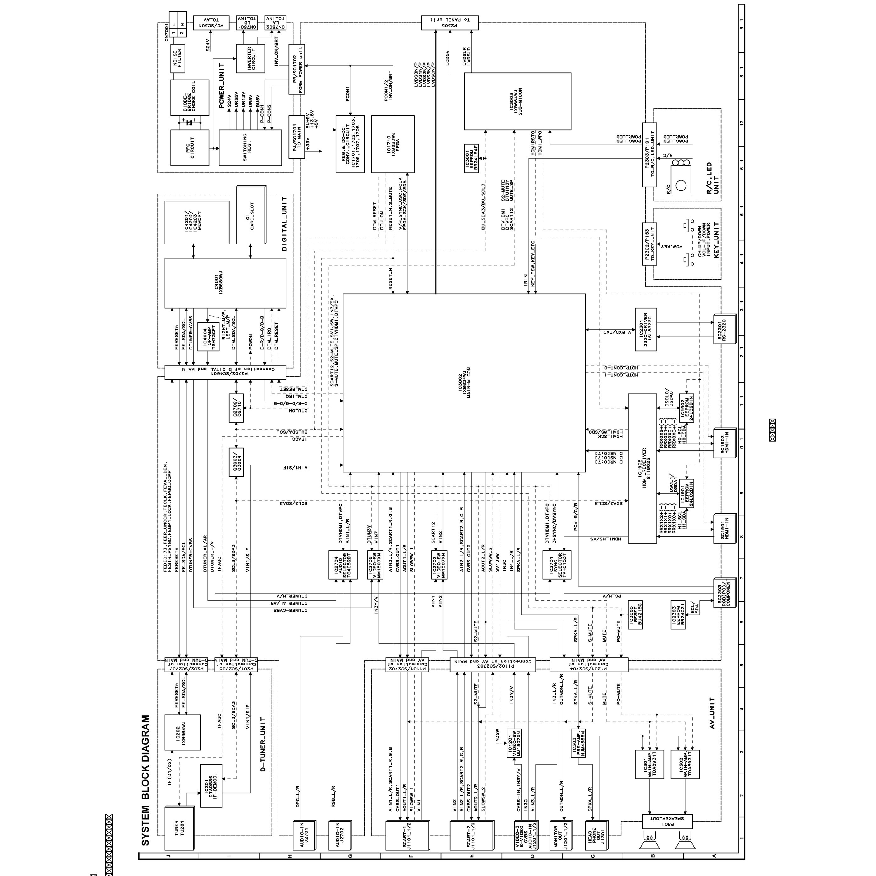

          And here are some of the schematics that I'm using
          Today I'm gonna try to disconnect the TCON and take some hi res photos.
            Re: sharp lc-42ad5e-bk No power No standby led
            "In case that It doesn't work. How can I force the psu? Should I short Pcon1,Pcon2,Inv_on, to 3.3V or 5v?" I would use two 100~500 Ohms between the 5V and the PCON 1, 5V and PCON2 to force on the power supply, as you can see you just need to turn on those two transistors which will turn on the two opto-isolators.
            So force the power supply and see if you do get the 24V to run the inverter, then you can use another resistor to force on the Inverter, do not force on the power supply and the inverter on at the same time, you must turn on the power supply first and then turn on the inverter.
                    First of all, Thanks so much for your help!!!!
                    Here is the story, I hope someone helps it.

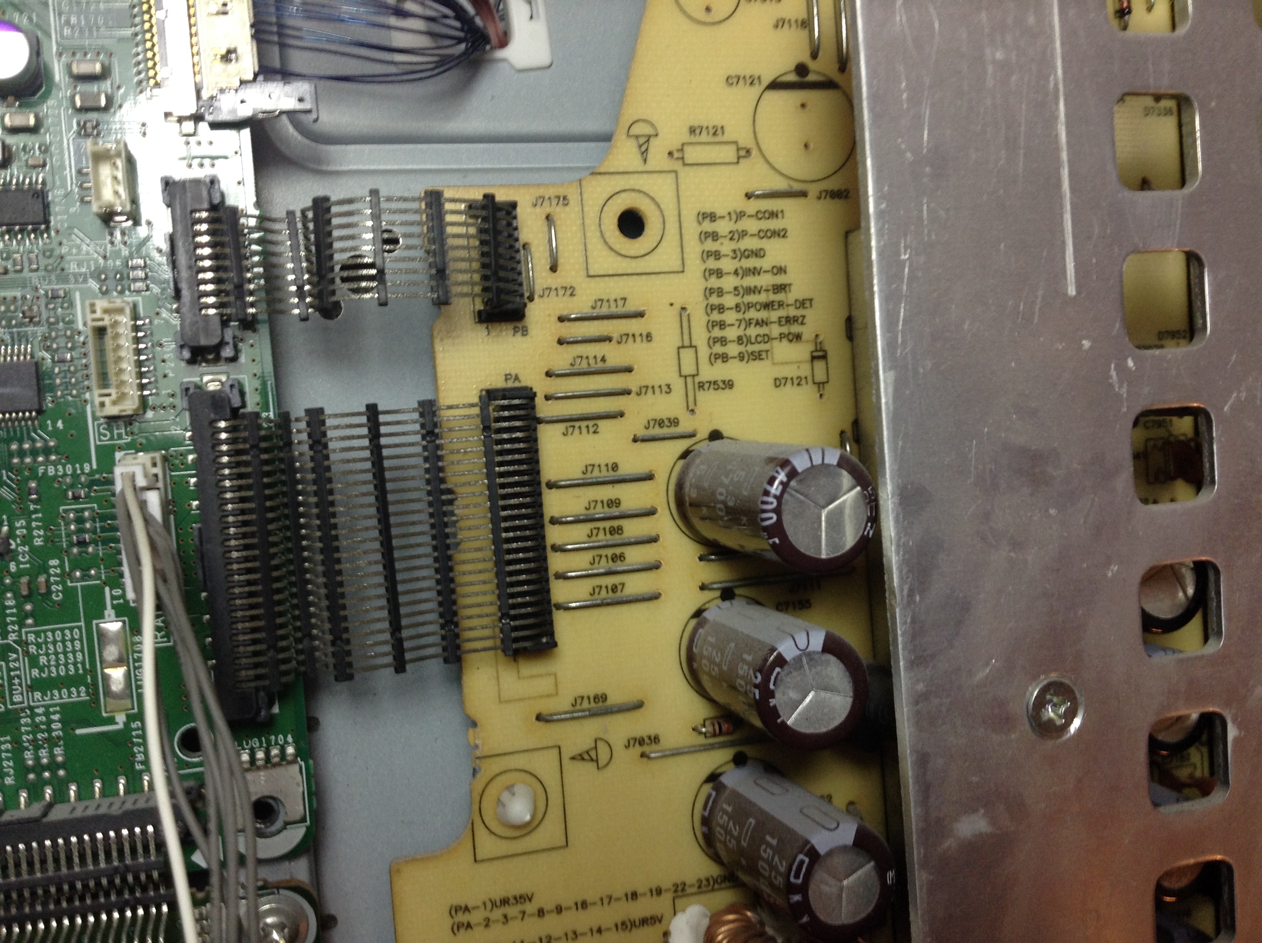

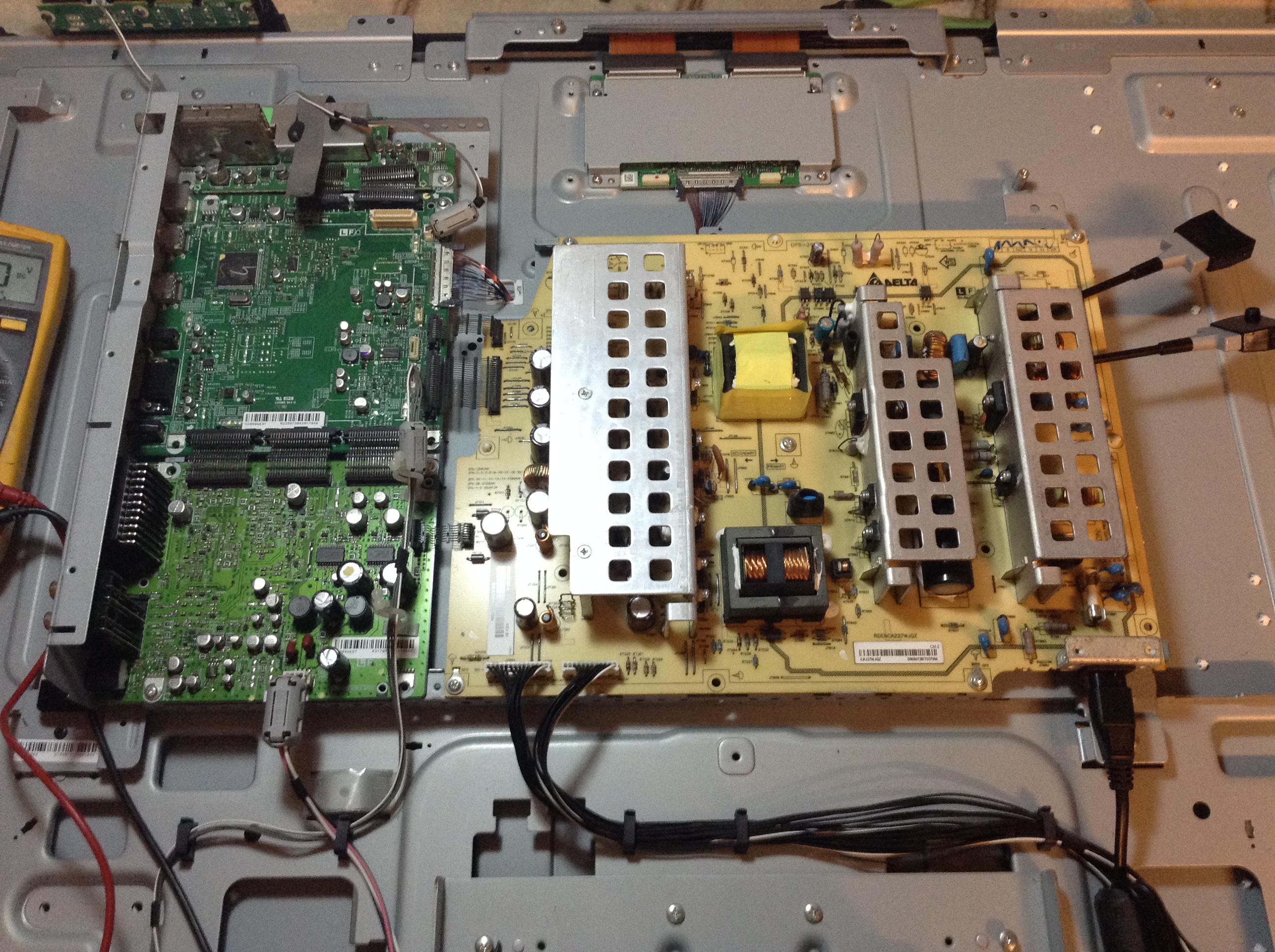

                    Yesterday I test to disconnect the T-CON board then, I plug the mains cable and I tried to power it , I realize the standby led blinks red once C7001=0V.
                    Try again while C7001 was discharging and no blink.
                    I waited until C7001=0V an tried again, power and no blink, I tested the voltages and no change, so I moved on and tried to force the psu like you said.
                    I disconnected all the main board connections.
                    I used three 220 ohm resistor for each signal P-CON1, PCON-2 and INV_ON; I soldered them to 5V and left one lead for shorting INV_ON later.
                    Time to start to pray.........
                    Plug de mains cord and...........It powered on!!!!!!! , all the ccfl and without touching the INV_ON ( Is that normal? Should I shorted INV_ON if the ccfl was working?)
                    Here the voltages readings: (without shorting INV_ON)
                    PA:
                    BU5V: 5.08V DC
                    UR5V: 5.1V DC
                    UR13V: 12.2V DC
                    UR35V: 32.5V DC
                    LA:
                    INV24V: 19VAC
                    Note: I think this Is the hardest part due this aren't cable conectors, are exposed ones, and it has corrosion on it so a lot of false readings, and also due it are exposed ones is very easily to make a short; indeed I made one between UR35V and GND and I was using the thinnest probe that I have with a shrinking tube exposing only the tip. Well I inmeddiatly swith it off and later on, and continues working. It's possibly that I burned something? Some tech tip to make measuremnt in that kind of cables?
                    So....... It seems that I have to change my mainboard. Isn't it? Any advice about it? Or only I have to buy one with the same serial numebr and plug-it?
                    I'll upload some photos of the process, so maybe It helps someone.

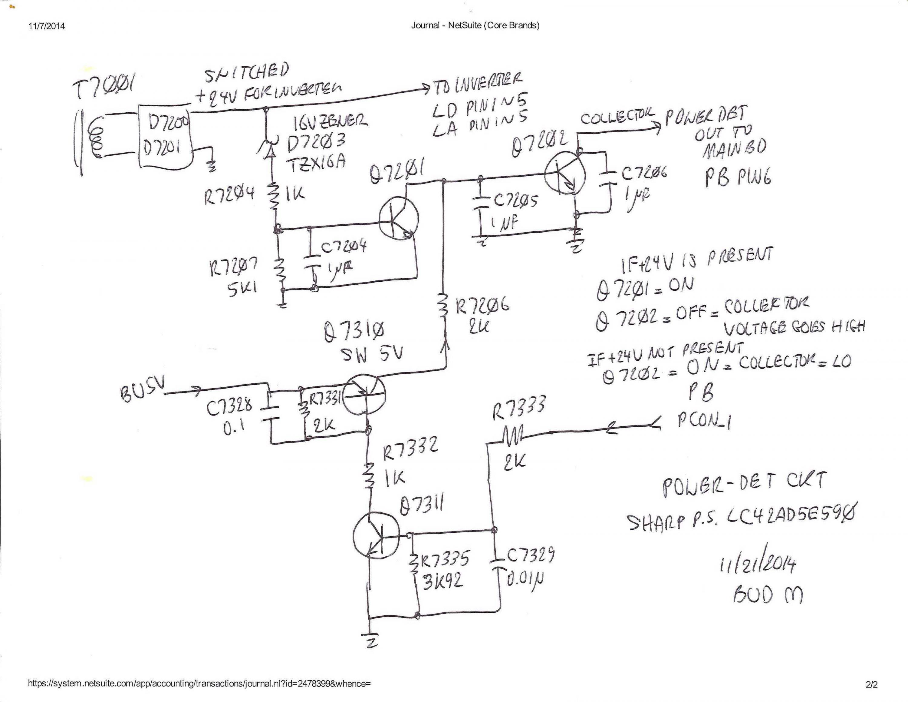

                        At this point we know for sure that the main board is not sending the PCOns command to turn on the power supply.
                        You should monitor the PCON1 and 2 with the meter to see if they spike up for seconds or not when the power switch is activated.
                        "INV24V: 19VAC" are you sure it is 19VAC?
                        Here is the simplified POWER-DET circuit, it is made to see if the switched +24V for the inverter circuit is working or not (or if the Voltage is below 16V).
                        When Pcon1 is HIGH (PCON2 is also HIGH) Q7311, Q7310, Q7202 (Notes: the pull up resistor to the Collector of Q7202 is on the main board) are on, when the 24V power supply comes on, Q7201 will turn on which will turn OFF Q7202 and causes Collector Voltage of Q7202 to be HIGH (normal condition), if the 24V fail to come on the POWER-DET signal will be LO then the main board will shutdown and reports the fault.

                          I'm going right now and check PCON1 and PCON2, so I have to disconnect the resistors and plug in all connector and check if is there any spikeup. Isn't It?
                          About the INV24V I'm not sure 100% I'll will check it too.
                          About the Power-det circuit, I think I forgot a lot of the electronics that I have learnt some year ago , thanks so much for the effort, I'll study it. So Have I to monitor de POWER_DET circuit too? or Are the schematics you made only for help me out with the understand the function?
                            "I'm going right now and check PCON1 and PCON2, so I have to disconnect the resistors and plug in all connector and check if is there any spikeup. Isn't It?" that is correct.
                            So Have I to monitor de POWER_DET circuit too? yes, but the main key is that the 24V must be there otherwise the POWER-DET fault will kick in.
