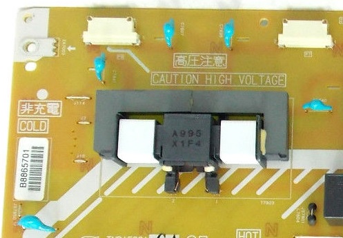

    Panasonic Inverter Transformer
    I've pretty much diagnosed that I have a shorted turn output in a dual coil inverter transformer. (See post: https://www.badcaps.net/forum/showthread.php?t=41593) Panasonic 32 inch LCD.
    The transformer has a code on it of A995 followed by four alpha-numeric code that seems to change when I look at spare boards on the net. I assume these suffix digits are batch codes or something similar.
    Try as I might I can't locate these transformers on the net. Can anyone provide advice/guidance?
    Similarly, I was wondering how specific these transformers are to the model of TV? Would a double output tranny that was used for a similar sized panel do the job?
    (The cost of landing into Australia a second-hand power supply which incorporates the inverters makes it an uneconomical repair, but as always I'm loathe to junk a set that I know I could probably get going if I can get the CCFLs to stay on!)

    Re: Panasonic Inverter Transformer
    Show foto the transformer
      Photograph of the actual inverter transformer.
        Just to complete the story of this repair, I did find a supplier of the inverter transformer in China who wanted about $100 for the part. Obviously I terminated that conversation. So I bit the bullet and got a complete second-hand power supply imported from USA via Flea-bay. Of course all works fine now and it has become one of our main TVs in the house.
        I've kept the U/S board for parts, so if anyone needs this inverter transformer in their repair I have one.
