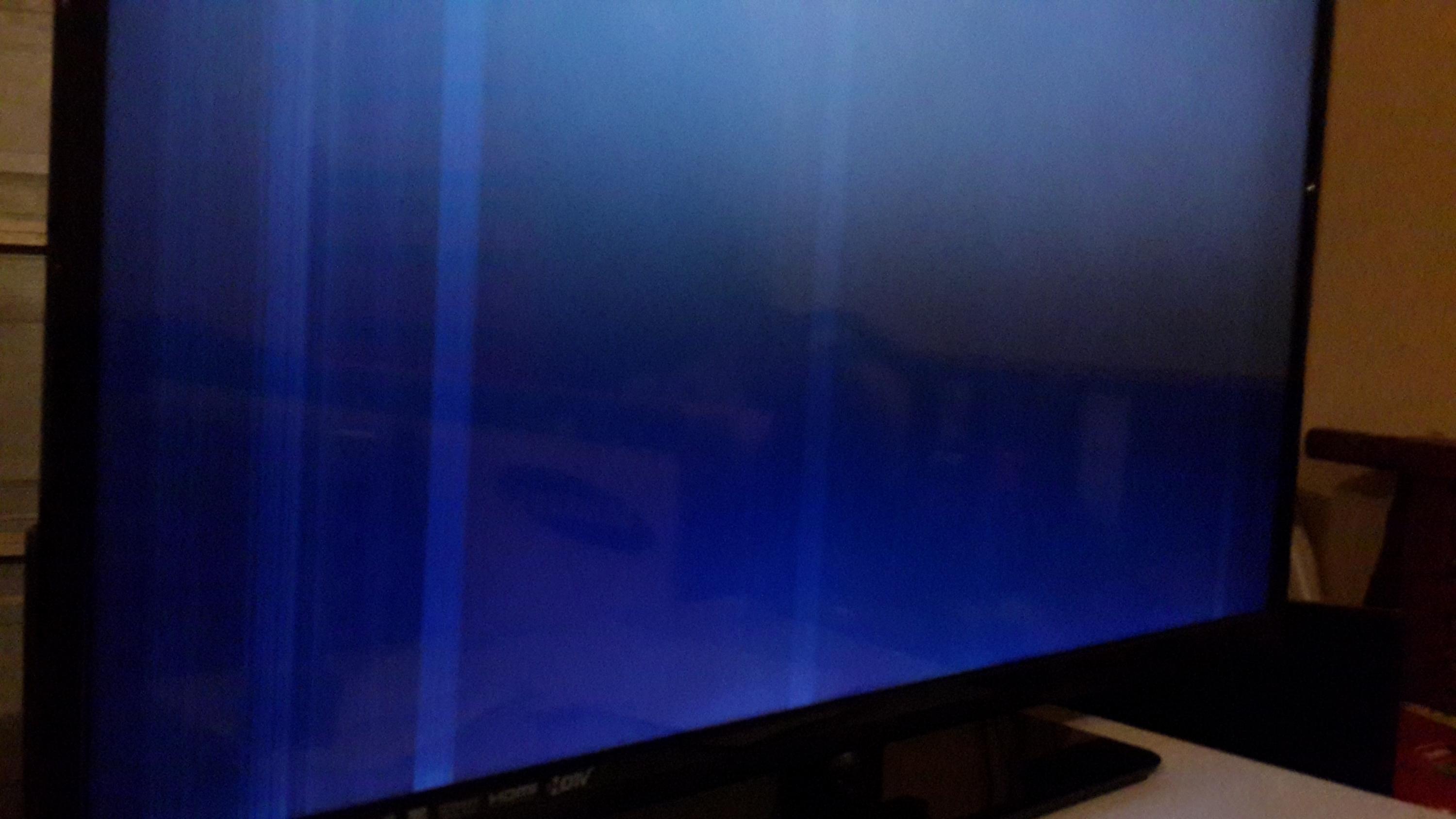

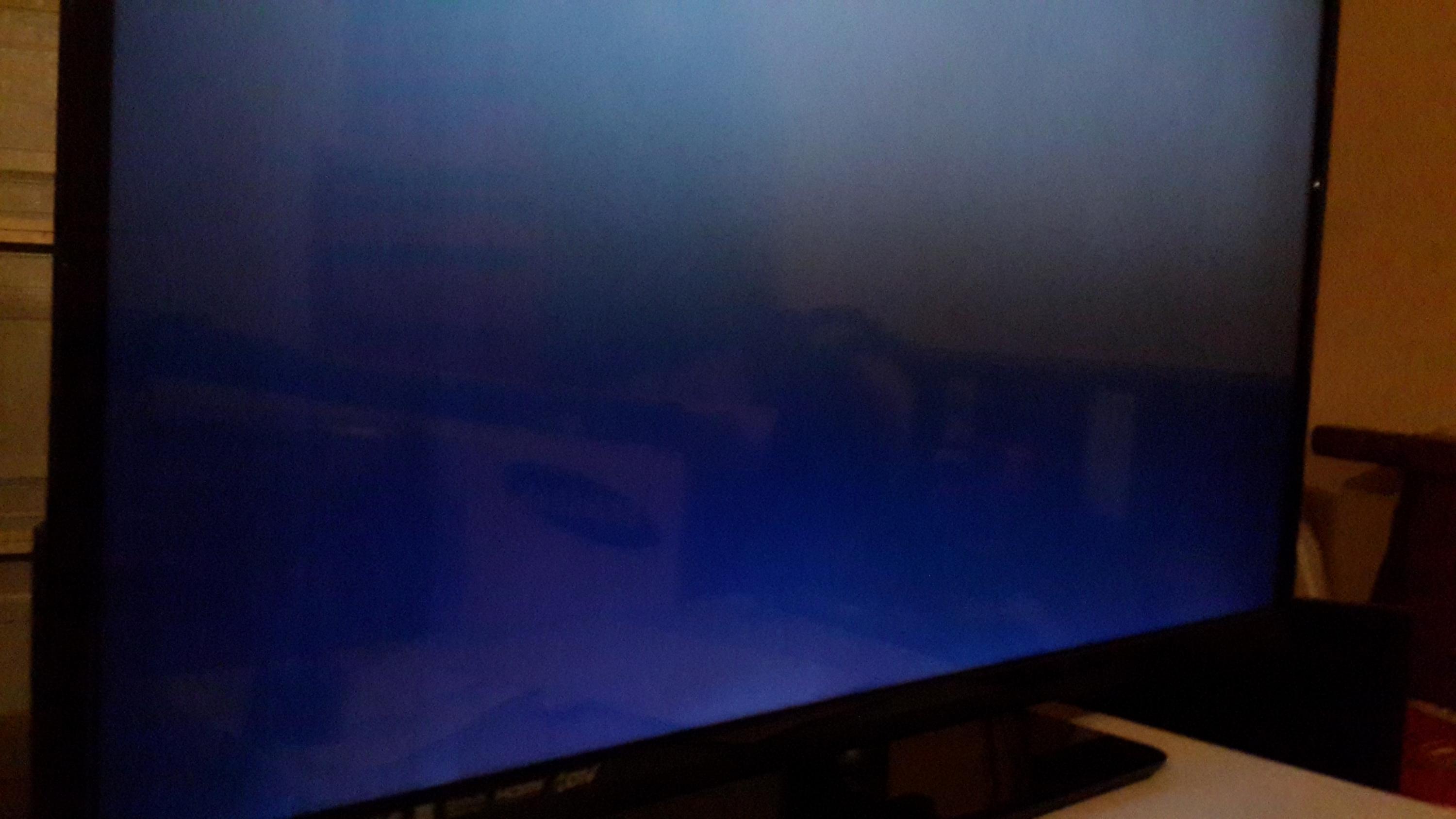

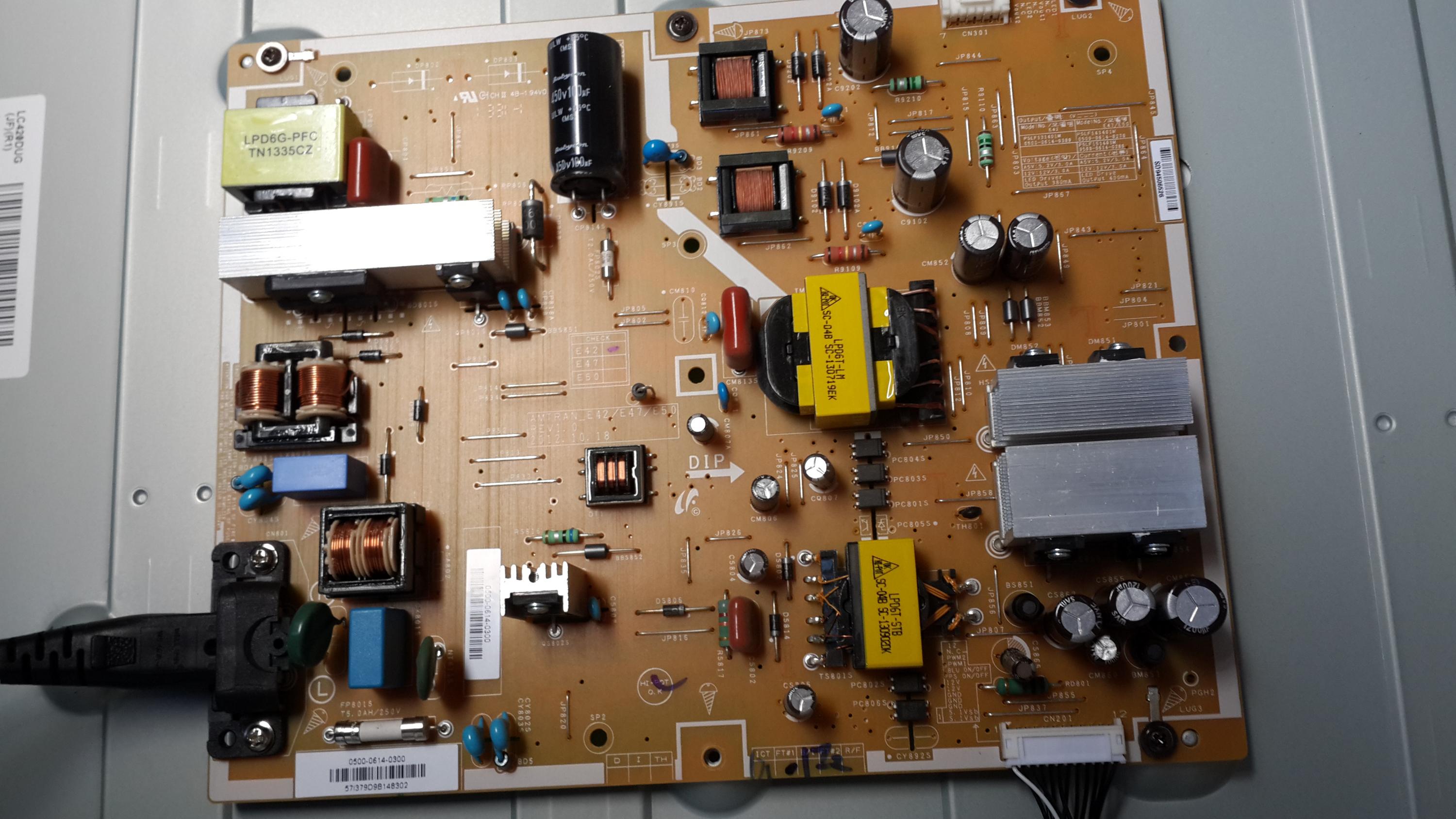

                • brucetv
                  • May 2015
                  • 281
                  • united states
                  Re: Vizio e420i-a0 main board problems??
                  I have a Vizio E420i-AO that upon plugging in has a solid blue light that fades to off, and when you hit power backlights come on and then a flash of vertical faint lines on panel, and then back to backlit panel, no picture, no sound. Power supply voltages are
                  Pin 1&2 5.2v
                  3,4,5 Ground
                  6 0
                  7 .002
                  8 0
                  9 0
                  PWM 1 3.2
                  PWM 2 0
                  I will include pics of ps and panel flash with vertical lines at start up. It's the vertical line flash that concerns me regarding possibly a bad panel as well as needing to replace the ps.
                  • johnboy1313
                    • Nov 2012
                    • 1959
                    Disconnect the ribbons, one at a time, between the tcon and the panel and see if the tv will power on and show a half picture. I suspect you have a failed panel.
                    • brucetv
                      • May 2015
                      • 281
                      • united states
                      Thanks for the quick reply johnboy. I disconnected the ribbon on the left and the left side of the panel is white and I can now see the Vizio logo on the right. I reconnected the left side and disconnected the right and all I get is the backlit panel like picture 3. Bad panel or bad Main since the tcon is on the main on this model. I didn't ever see the Vizio logo when both ribbons were connected.
                      • johnboy1313
                        • Nov 2012
                        • 1959
                        Unfortunately, bad panel.
                          Originally posted by johnboy1313
                          unfortunately, bad panel.
                          +1
                          • brucetv
                            • May 2015
                            • 281
                            • united states
                            Thanks guys. Now I know how to help diagnose a possible bad panel. We repair gadgets like cell phone, tablets, laptops, ect. but we are learning more and more about Tv's and this forum is the best way to learn from people with years of experience. Thanks again from all us newbies.

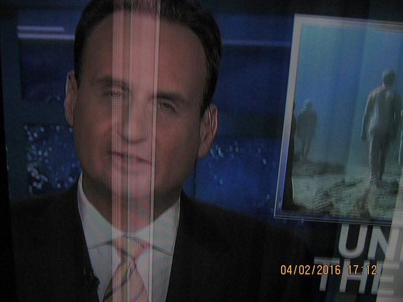

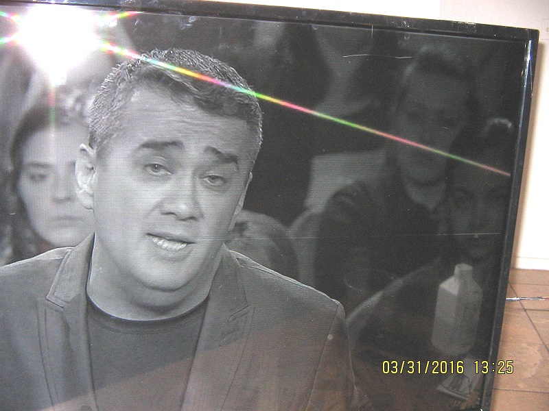

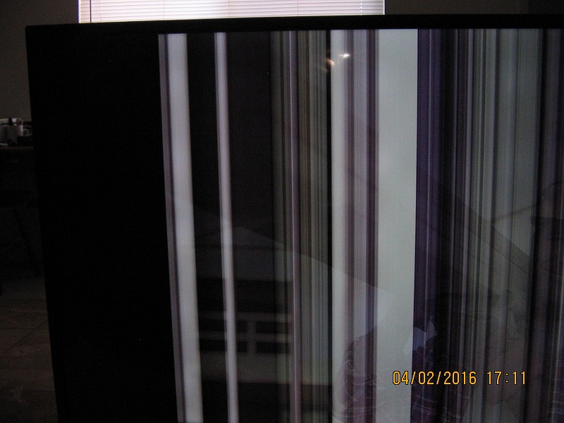

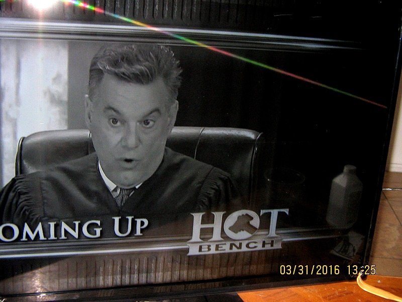

                            • Ron.M
                              • Aug 2012
                              • 27
                              brucetv;....
                              I'm a retired analog TV repair tech..
                              I HOPE I'm NOT too late to give my Tech advice...
                              I have the SAME model TV as yours...
                              Be advised that the Main board in this model TV does some strange things...
                              Attached are 4 pix that are from the SAME TV & SAME Main board , MINE !!!..
                              ALL 4 pix are from the SAME board !!!..
                              Since there are ONLY 2 boards in this TV , it would be prudent to get a GOOD Main board to try first BEFORE the LED panel is wantonly condemned !!!
                              PLEASE note that the symptom in the pix on the far left side (Vertical lines) was used by another so-called LED expert to condemn my TV when the problem was IDd by ANOTHER Tech as a MAIN board problem & NOT the LED PANEL !!!..
                              A second opinion saved this TV & hopefully I'm right & your TV may have the same problem..
                              Keep in mind that the Main board puts out video for BOTH sides of the LED panel...
                              IF you get video on one side only , there's a chance that the Main board is NOT putting out video for the other side , hence a blank or blue screen..
                              FYI;...
                              A bad LED panel will NOT kill the sound...
                              Bad LED backlights WILL !!!
                              Have a GREAT day & weekend...
                              Later...Ron.M... ...
                                "I disconnected the ribbon on the left and the left side of the panel is white and I can now see the Vizio logo on the right." He gets pictures when only one ribbon is connected, when both ribbons are connected then no longer have pictures on the screen.
