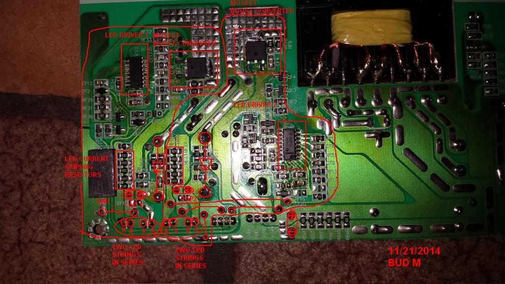

                OK, I look at the pictures of the bottom side of the board around the LED Driver boost converter power supplies.
                There are 2 pairs LED strings, each pair has two LED strings connected in series and driven by its own boost converter power supply.
                As you can see, there are two rectifier for each filter cap to supply the + Voltage to the ANODE of the string. Those two cap should have the same Voltage reading when the TV is turned on. You can also see two SMD IC, can you get the P/N?
                So the diode may have been damaged when the Anode is shorted to ground which can also damage the MOSFET, that is why you need to check the DC Voltage at the Cathode of both diode to see if they put out the same voltage.

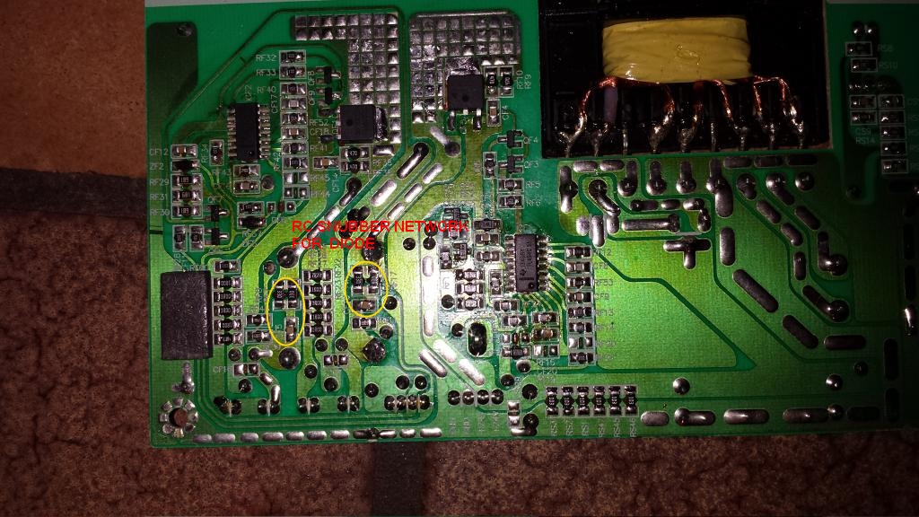

                  hi bud. Yes I have checked the anodes of both diodes and I'm getting roughly 38 volts on each side so it looks like the booster circuits are working properly however if you look at the picture I know it's hard to see but right out of the anode side of the diode right before it there is a small SMD resistor and a SMD capacitor the SMD resistor is a 160 k. the resistor was open on the diode side that blew so I replaced it. The SMD caps however seem to test ok in circuit. What I'm curious about is I hooked up the LED strips to a completely repaired power supply and I'm curious to think if something else had gone bad although the MOSFETs for the booster circuits are testing okay still of course I have no way to test the LED driver IC
                    #49
                    Re: haier le42b1380 power supply issue
                    Are you talking about these caps and resistors?

                        Yes on the cap but the resistor is the one before the cap right off the anode side of the diode . they are labeled 1603. I know it's hard to see though.

                          They are RC snubber for the diode, the circuit will still function without them in place. The two 160K are connected in parallel to give 80K resistance. https://cdn.badcaps-static.com/pdfs/...bf1cc12e6f.pdf
