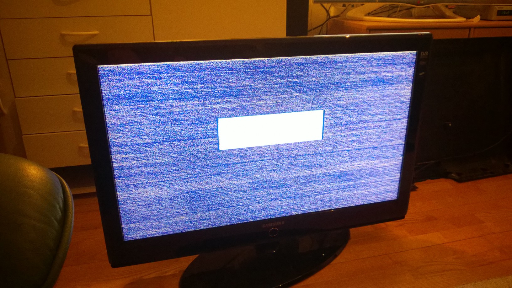

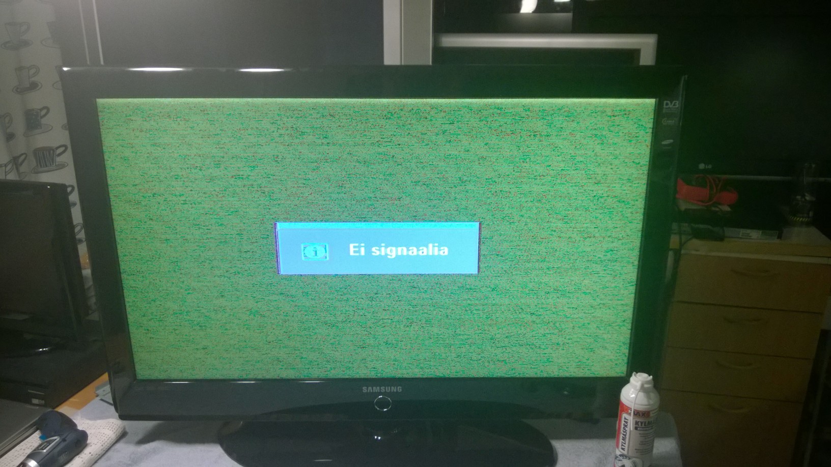

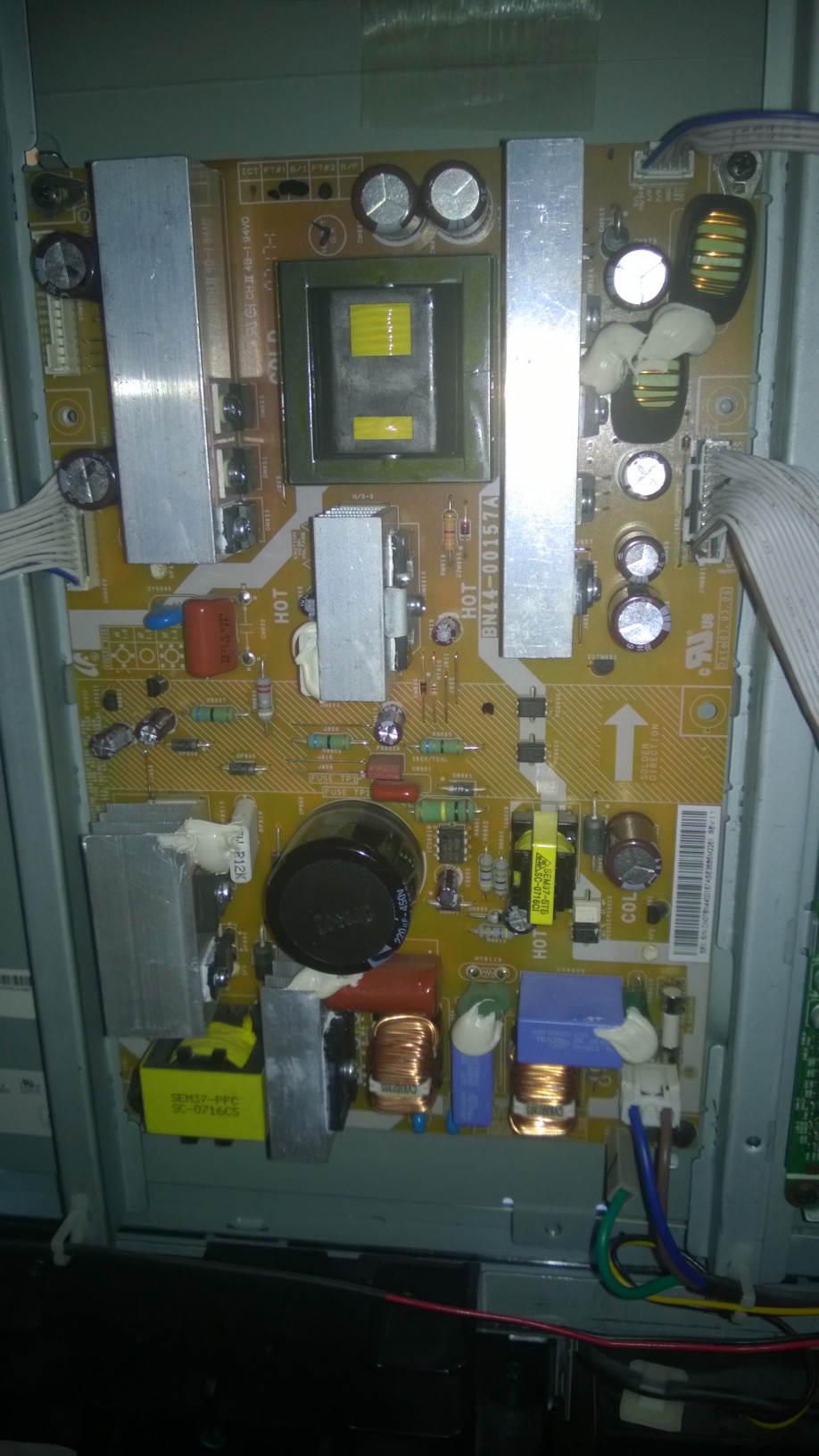

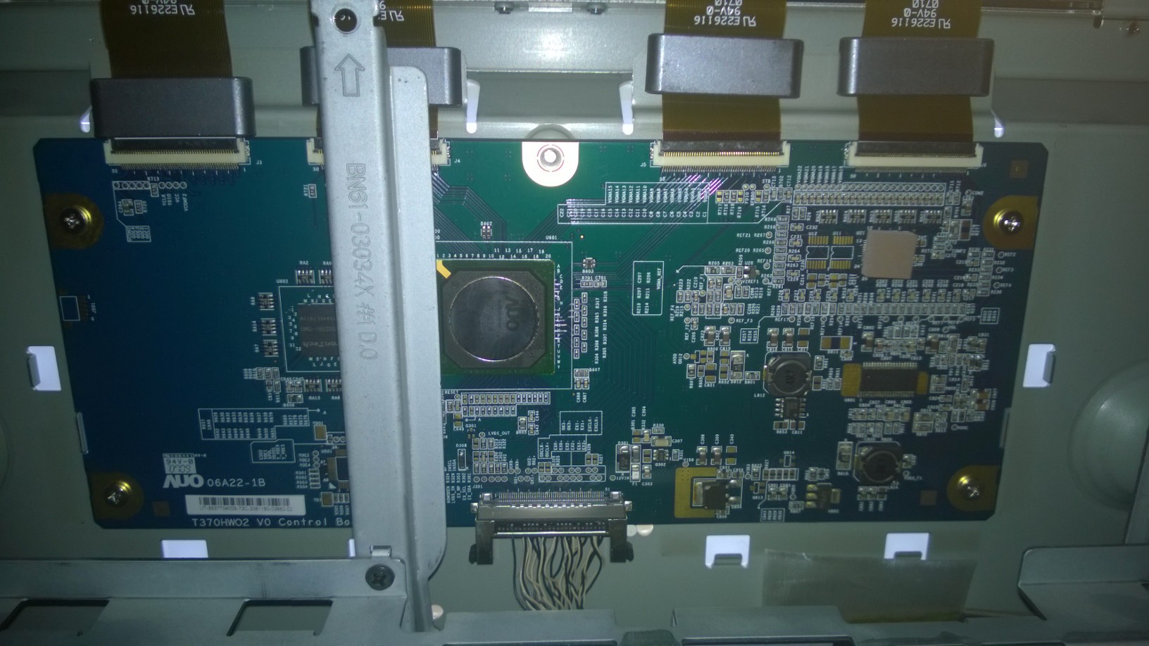

    Hi, I'm currently repairing this Samsung 37" LCD, which has flickering artifacts on screen. The PSU had several bad caps, so maybe the faulty PSU has broken something else, but what?
    I tried freeze spraying the mainboard and TCON with no change at all
    Any ideas?

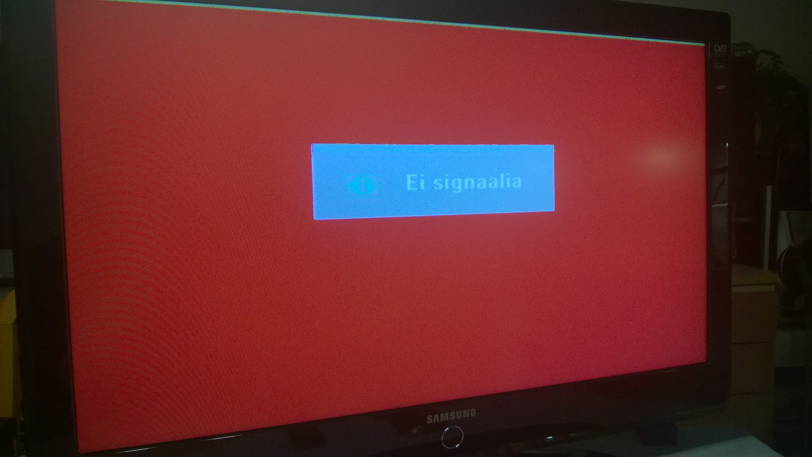

      That did not sadly fix it even temporarily, but it made the artifacts different color, when in movie mode they are red, and in cold picture mode they are black.

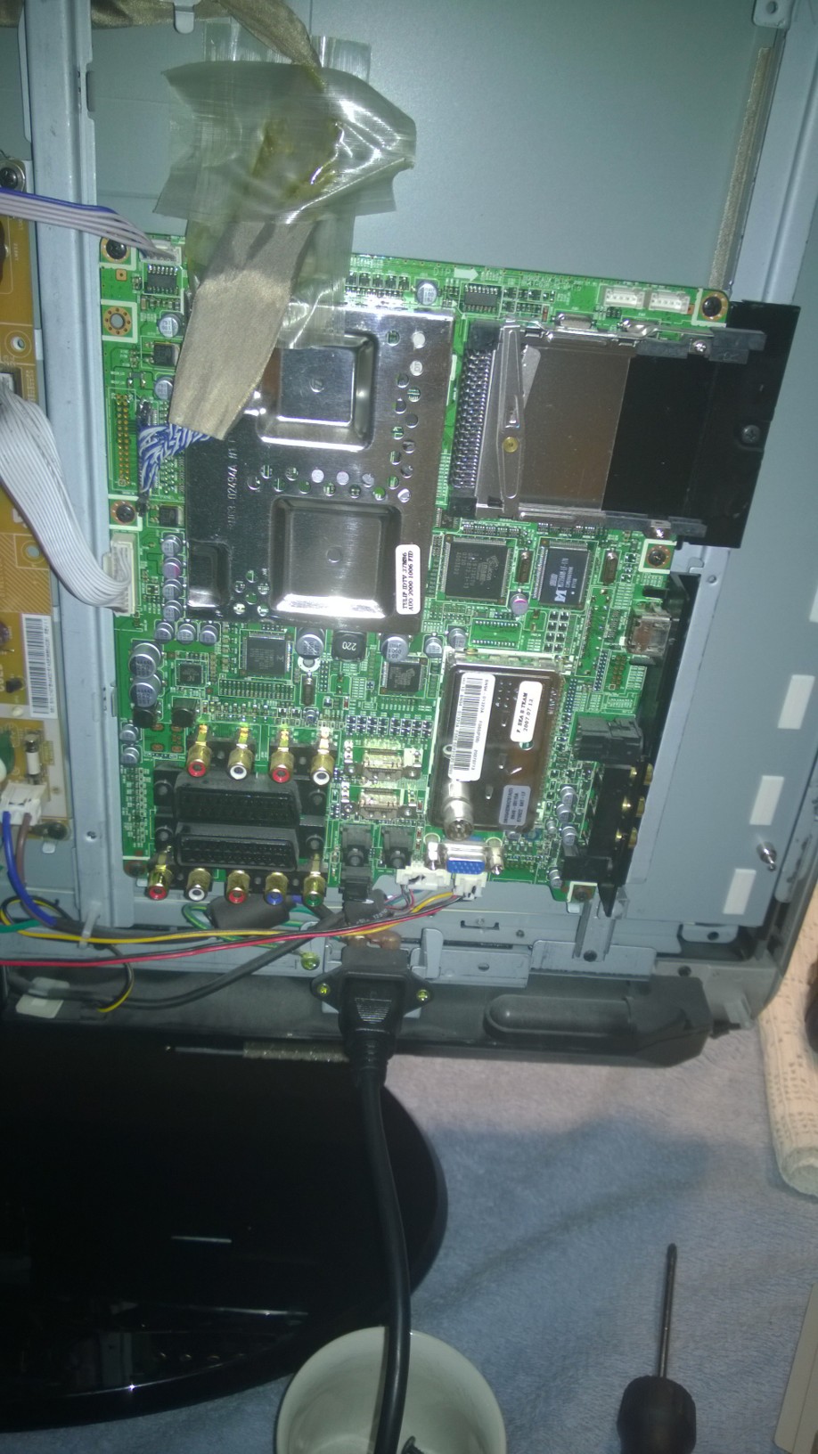

                Re: Samsung LE37M86 - Flickering green artifacts on screen

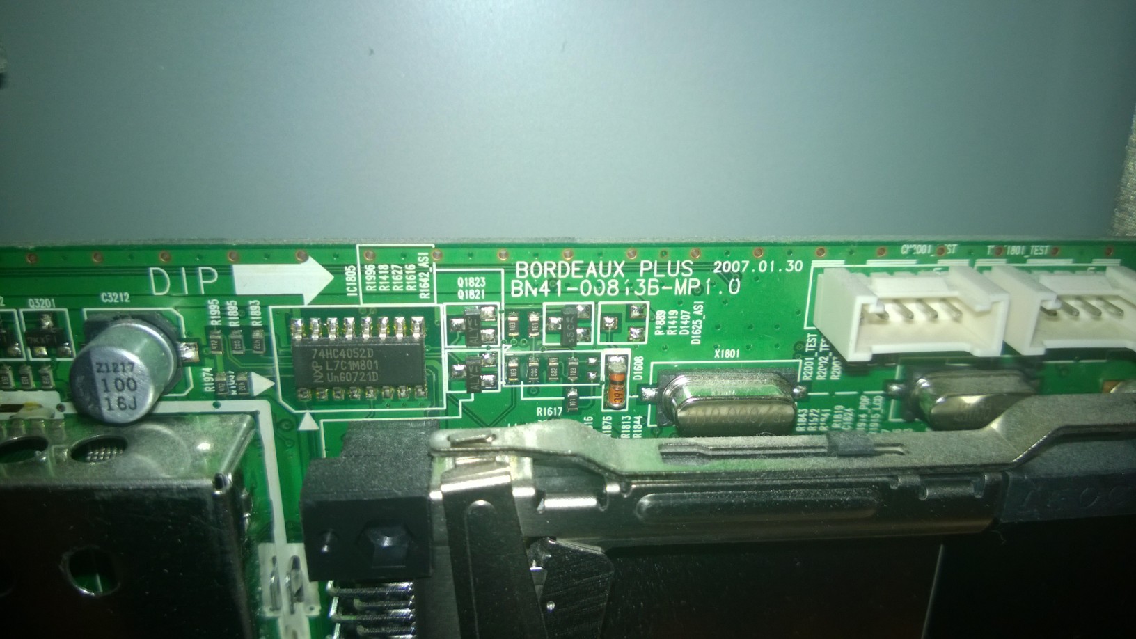

                That's the same mainboard im replacing on a Sammy, LE40M87BDX, those green lines was the same effect I got when heated a certain part of the mainboard.
                It was causing the set to cut out & resetting. Cant give a accurate part location on the board at the moment, I have a look later.
                https://www.badcaps.net/forum/attach...3&d=1415827767
                That chip in the center slightly to the right, inline with the writing Tulip 40 dtv. check what components on the opposite side of the board in same location also.

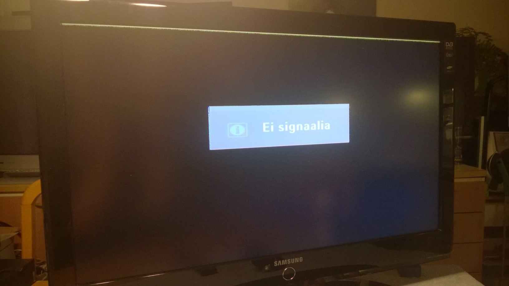

                  Heating or cooling that chip didn't do anything...
                  I also tried to replace the EEPROM chip, but the problem is still there.
                  Might have to replace the mainboard as well, sadly there didn't seem to be any fairly priced ones available... or could it be the TCON?

                    Looking at that, I would check out the TCON on-board regulator and the multiple voltage generator. I would suspect a large ripple voltage is in there somewhere.

                      Have you verified all voltage rails and secondary regulators are in spec and stable?
