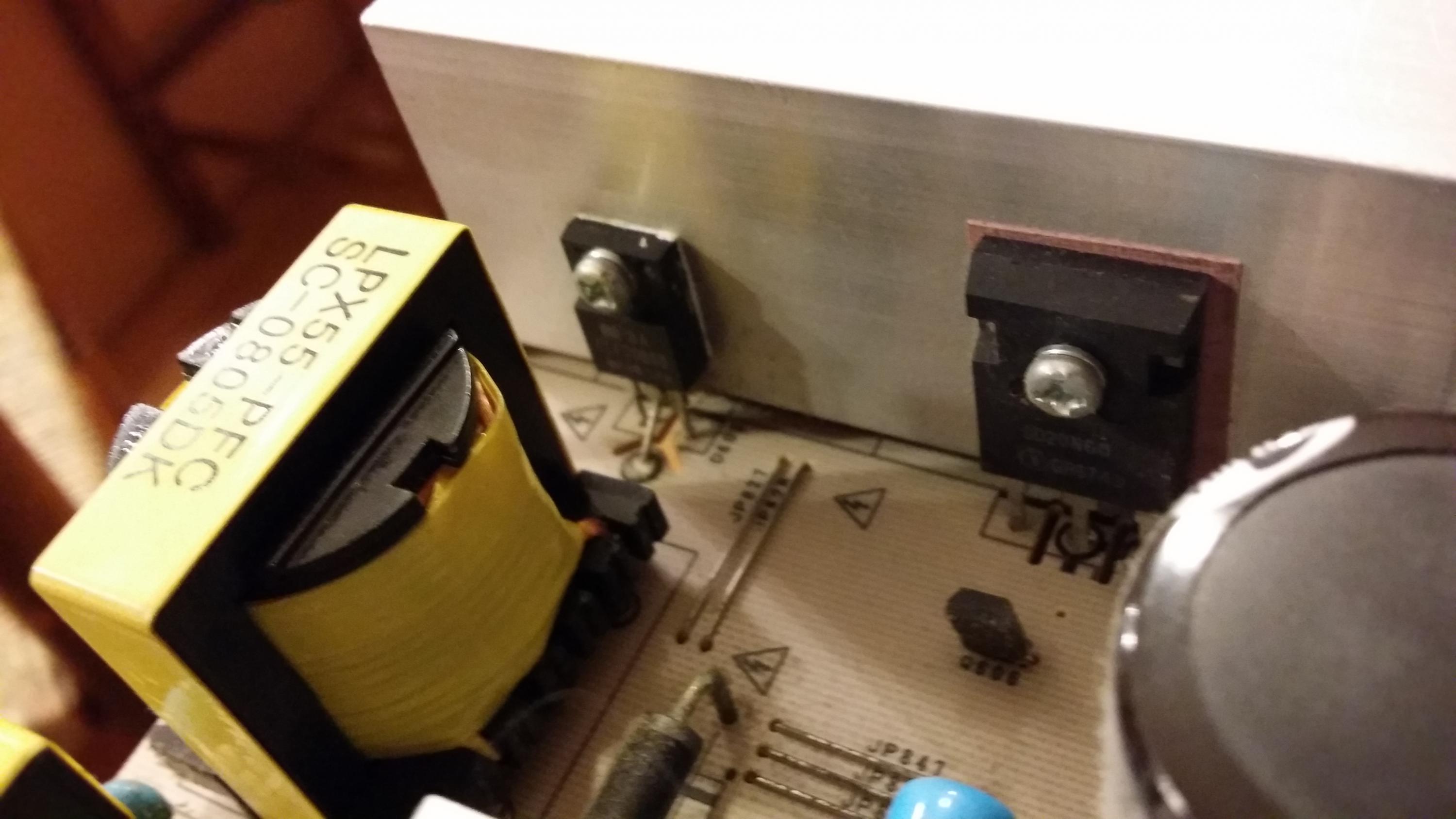

                Re: LG 50PG20 plasma no power issue
                ok thank you for that explanation!!
                on most I am getting 0 but on some when it registers 0 it flashes 125 or 65 first then 0.
                going from left to right on power supply board the second heat sink (?) registers 0 or close to 0.
                the middle one registers all above 0

                  Ok, would you read off the part number of each of those devices so I can check if those readings make sense. It will be printed on the front of it, maybe quite faint so use a light if necessary.
                    #29
                    sd20ng(or 6)0
                    grs749
                    this is the only on I can read with out removing parts.
                    this number is printed on the left face of the center 3 prong devise on heat sink #2 or second from right
                      #30
                      They are probably SD20N60
                      http://images.mcmanager.co.uk/ebayfi...-SD20N60-1.jpg
                      You would need to replace both of these, and the driver IC responsible for them.
                                      I had a TV repair place look over board and agreed with me, 1 bad fuse and D603 on heatsink #2 is bad. Finding fuse is no problem, D603 is harder to find.
                                      fcf20b0 i think is part number
                                        #39
                                        this is the part i cant find, marked as d603
                                          #40
                                          in the picture it is the middle one with a triangle peg pattern.
