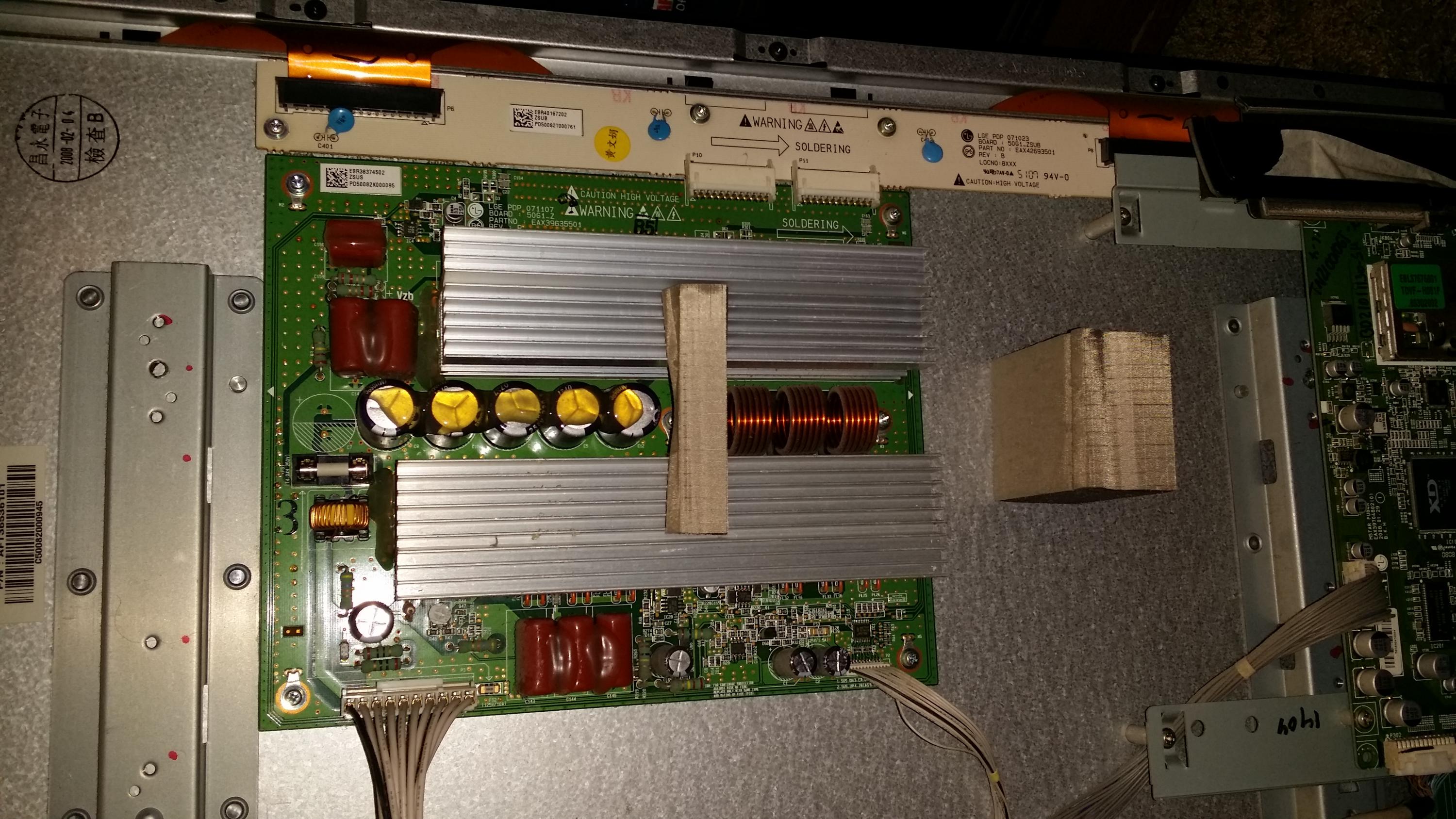

    got this tv free and wanted to tinker to see if I can fix it. When pluged in no power at all. no red dot nothing. When I try pushing power button no sound at all.
    what can I do to see if i can fix this or do I trash it?

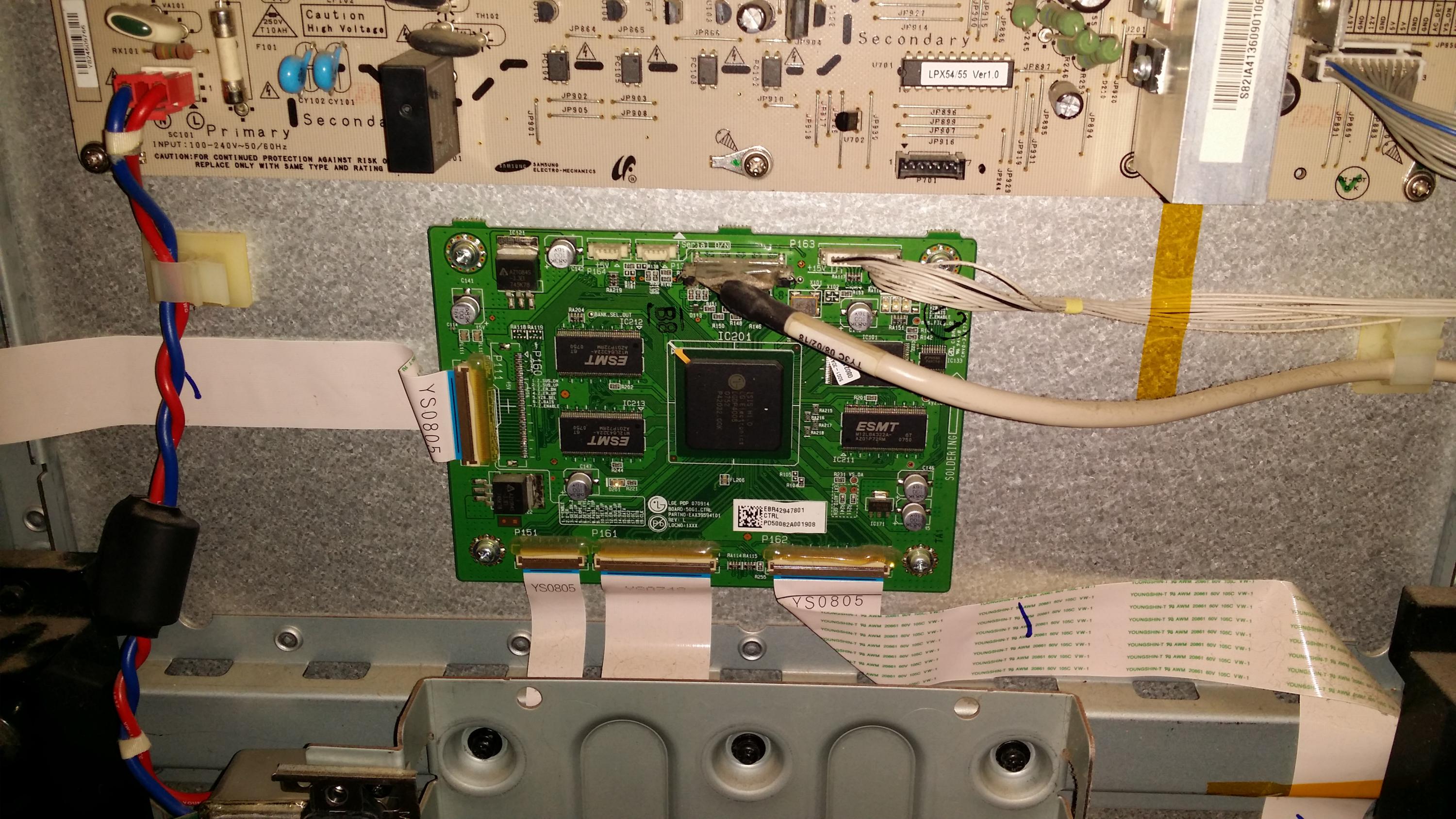

            Re: LG 50PG20 plasma no power issue
            A good step would be to supply some photos of the chassis and one of each major circuit board, this will help us highlight things for you and understand how it is all connected.

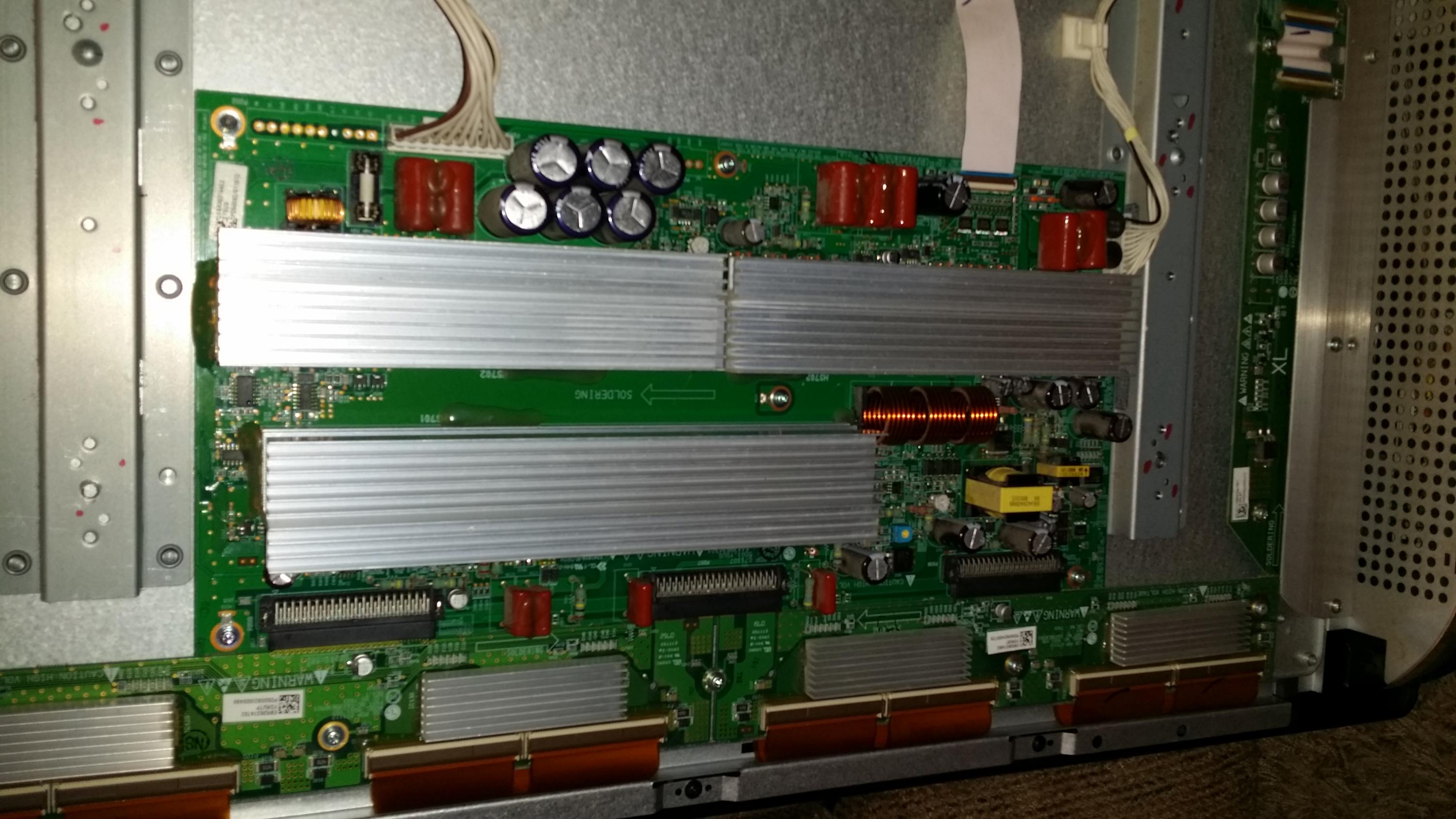

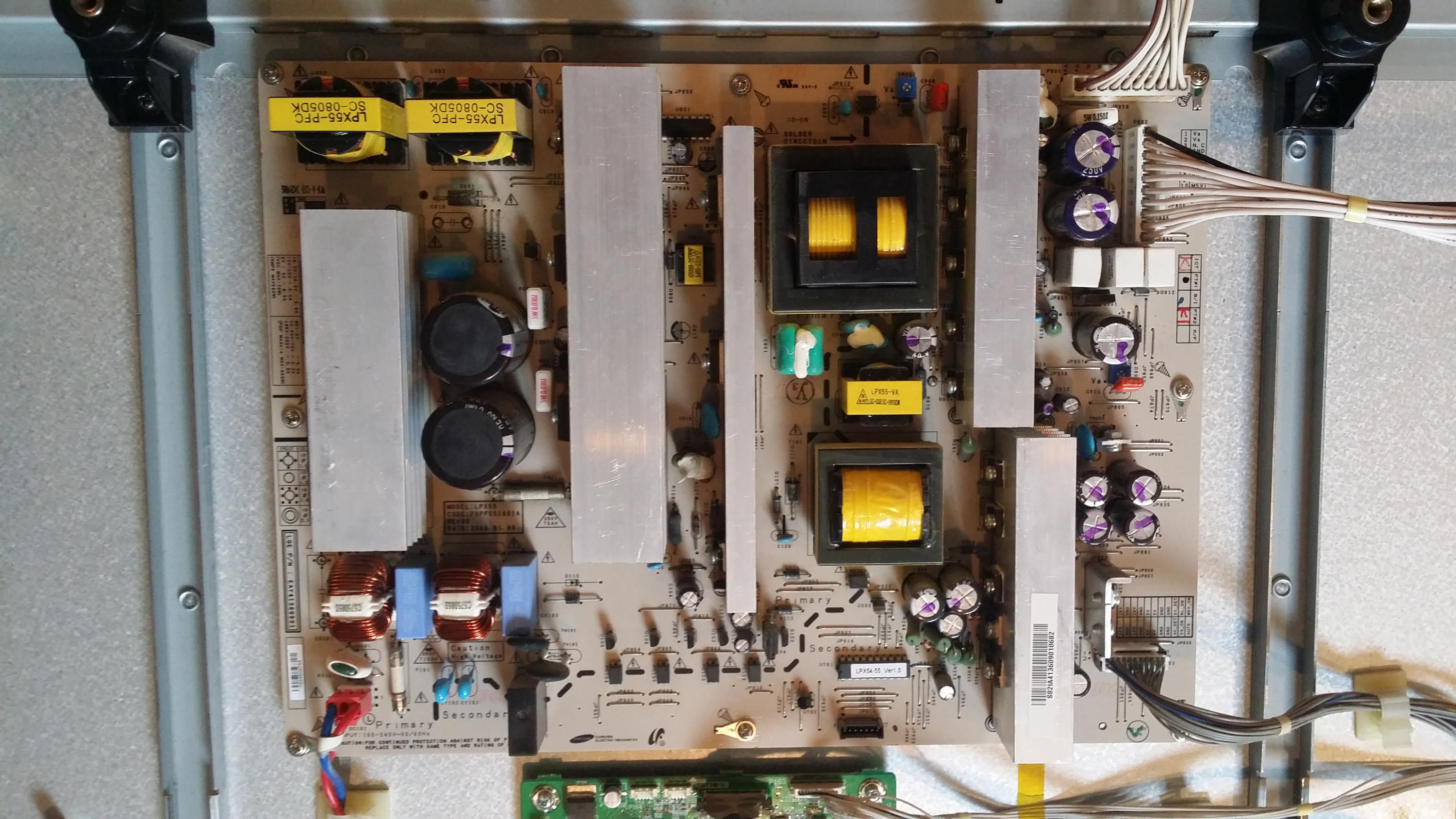

                    here are some pictures.
                    • zell66
                      • Nov 2014
                      • 35
                      • usa

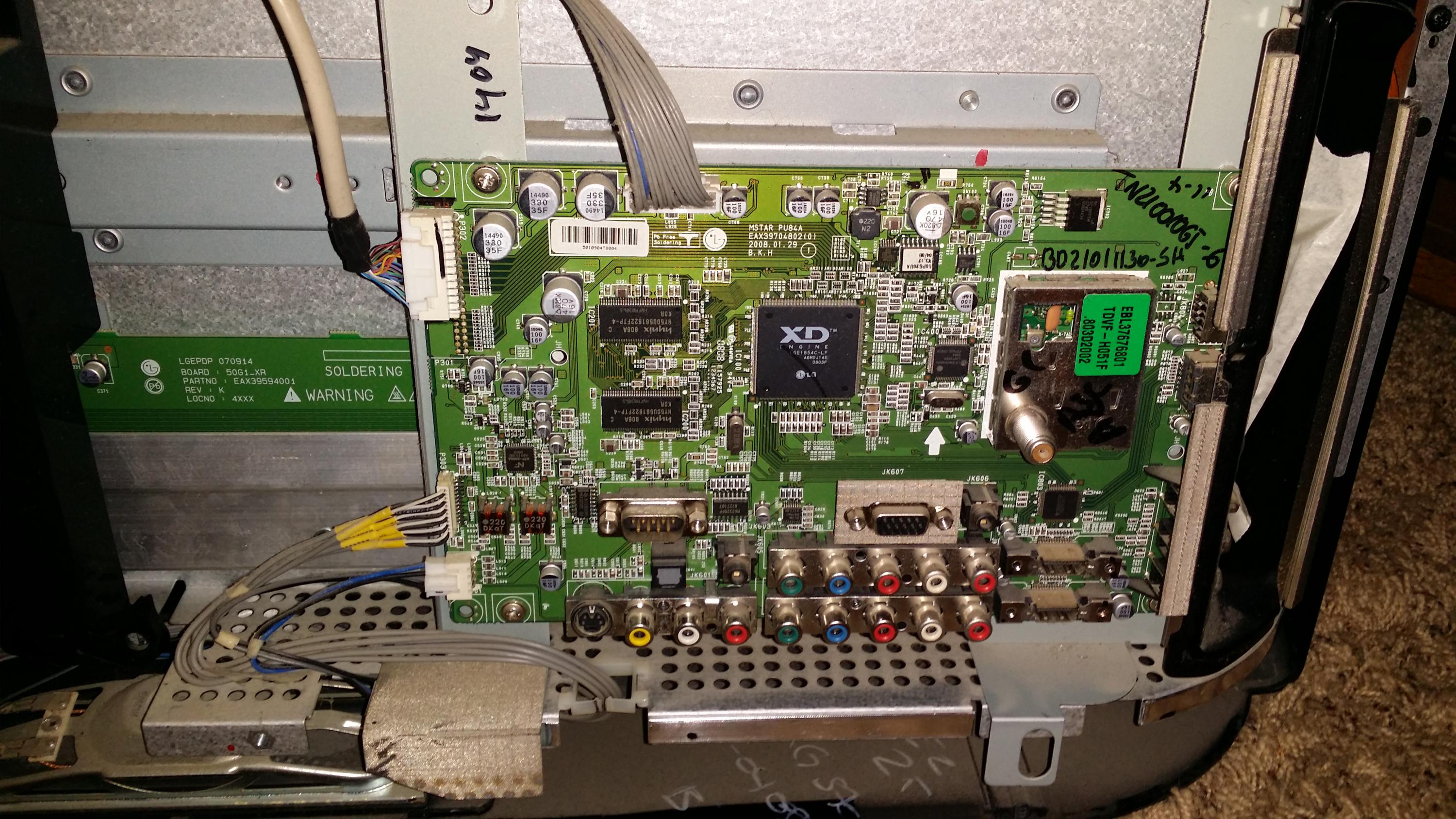

                      here are the other Circuit boards.

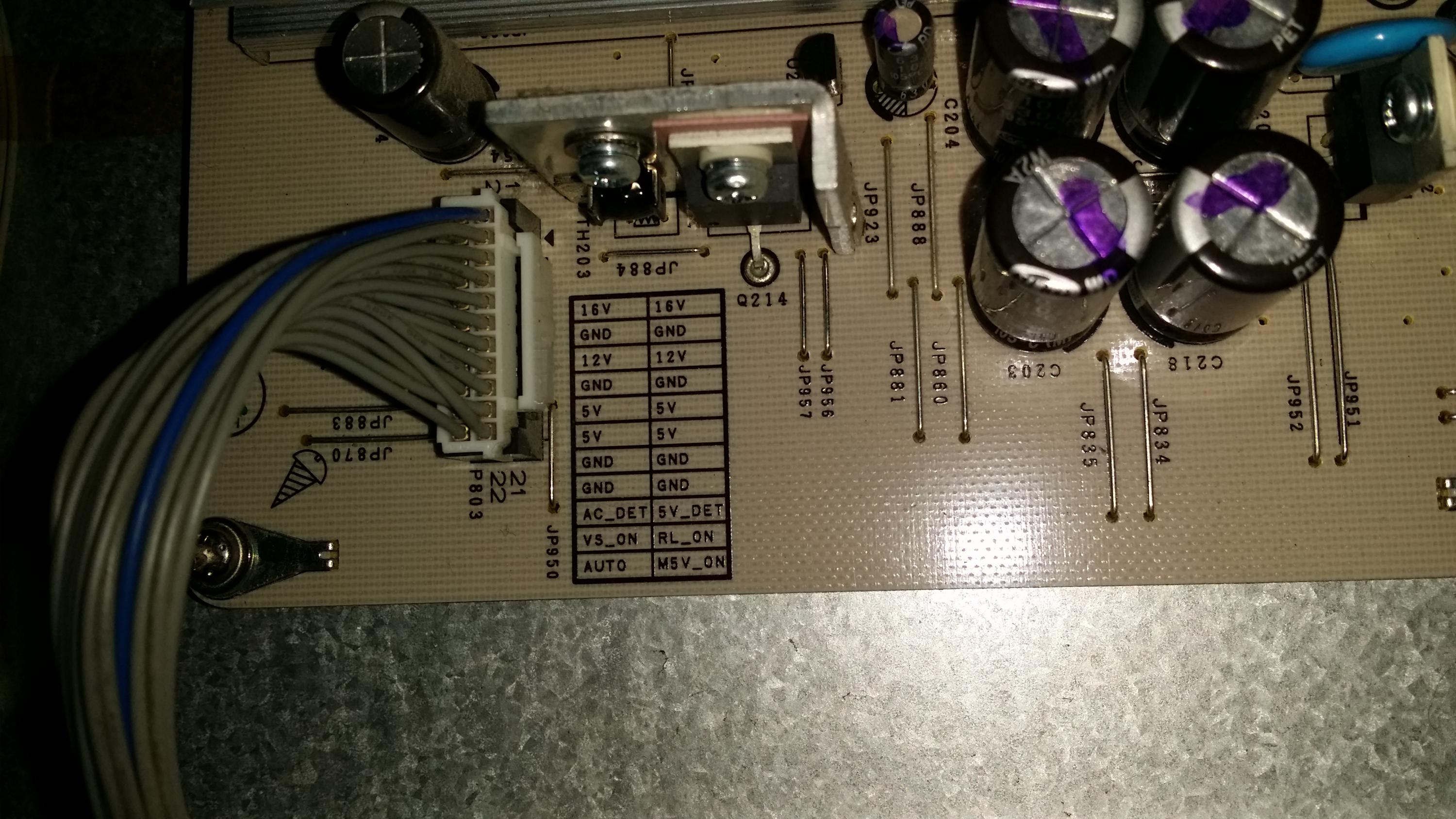

                          This is the power board:
                          https://www.badcaps.net/forum/attach...2&d=1415654055
                          Bottom right corner of the board - there's a connector with a legend next to it (indicating voltages and signals like RL_ON, VS_ON, M_ON, etc.), can you get a close up picture of it, OR list what it says?
                            tom is this what your looking for?
                              Yes thanks.
                              - Get your meter and set it to the 20V DC range. Do not use the AC range marked with ~
                              - Put the black probe in an exposed part of the metal chassis of the TV e.g. the wall mount brackets or screw hole works well.
                              - Plug in the TV. Careful, the chassis is now live, do not touch anything on the power board or sustain boards (left and right of the display panel.)
                              - Press the red probe against the pin marked "5V" - refer to the legend.
                              - What do you measure?
                                0.00
                                I used the ground for the power supply and tried to measure the pins marked 5v. I removed the plug in the lower right corner to access the pins.
