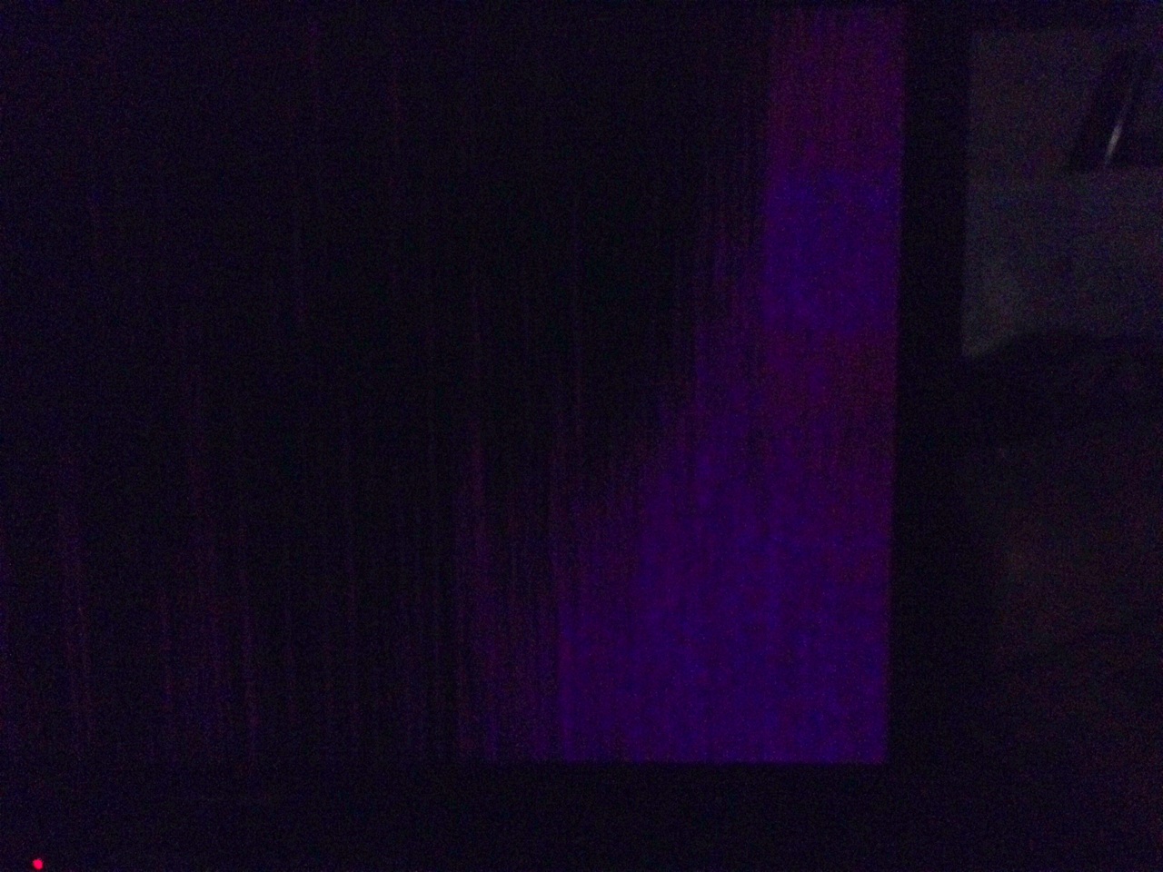

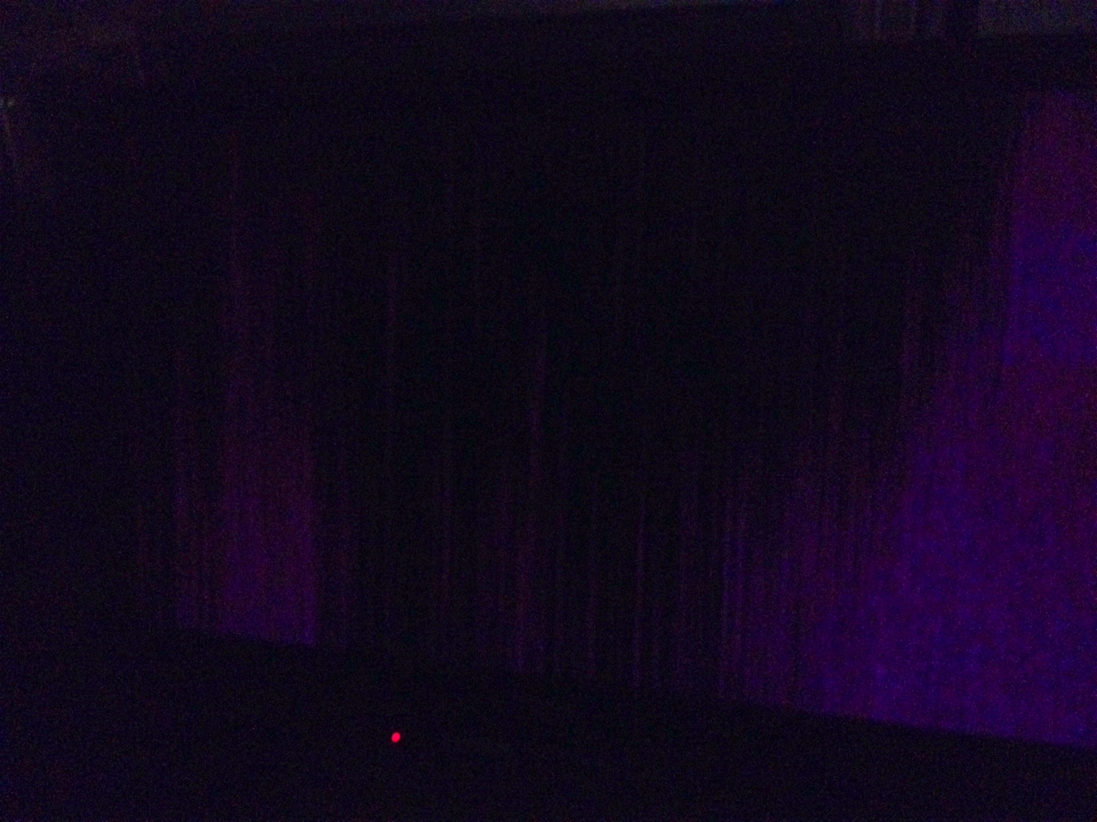

    I am troubleshooting a Panasonic TH-50PX80U with the 8 Blink error. I finally got the TV to turn on by unhooking the SS23 Cable. The TV comes on but has a very very dim vertical scrolling grain image. Do I need to replace the lower buffer boards to fix this problem? Review pictures below for the images I am getting.

    8 blinks is SS board, usually. On the SS and SC boards there are small LEDs, do you see either glow when you turn the set on with all boards connected?

      Tom, I am pretty sure when everything is connected the SS & SC do not light up. But when I unhook the SS23 Cable, from the lower buffer board they do light up.

        Sounds like you may have a short on the lower X-address board.
        Full SM:
        Check pins 1,2,12 for shorts to ground, and DC voltage when connected (expect: 75V / 75V / 5V)

          I finally got back to this TV pins 1 & 2 have 75v, but pin 12 does no have 5v. So this means I need a SS Board correct?

            It can mean your C board or panel is failed - best to verify if the 5V is shorted. (5V short should cause 5 blink code though...)
