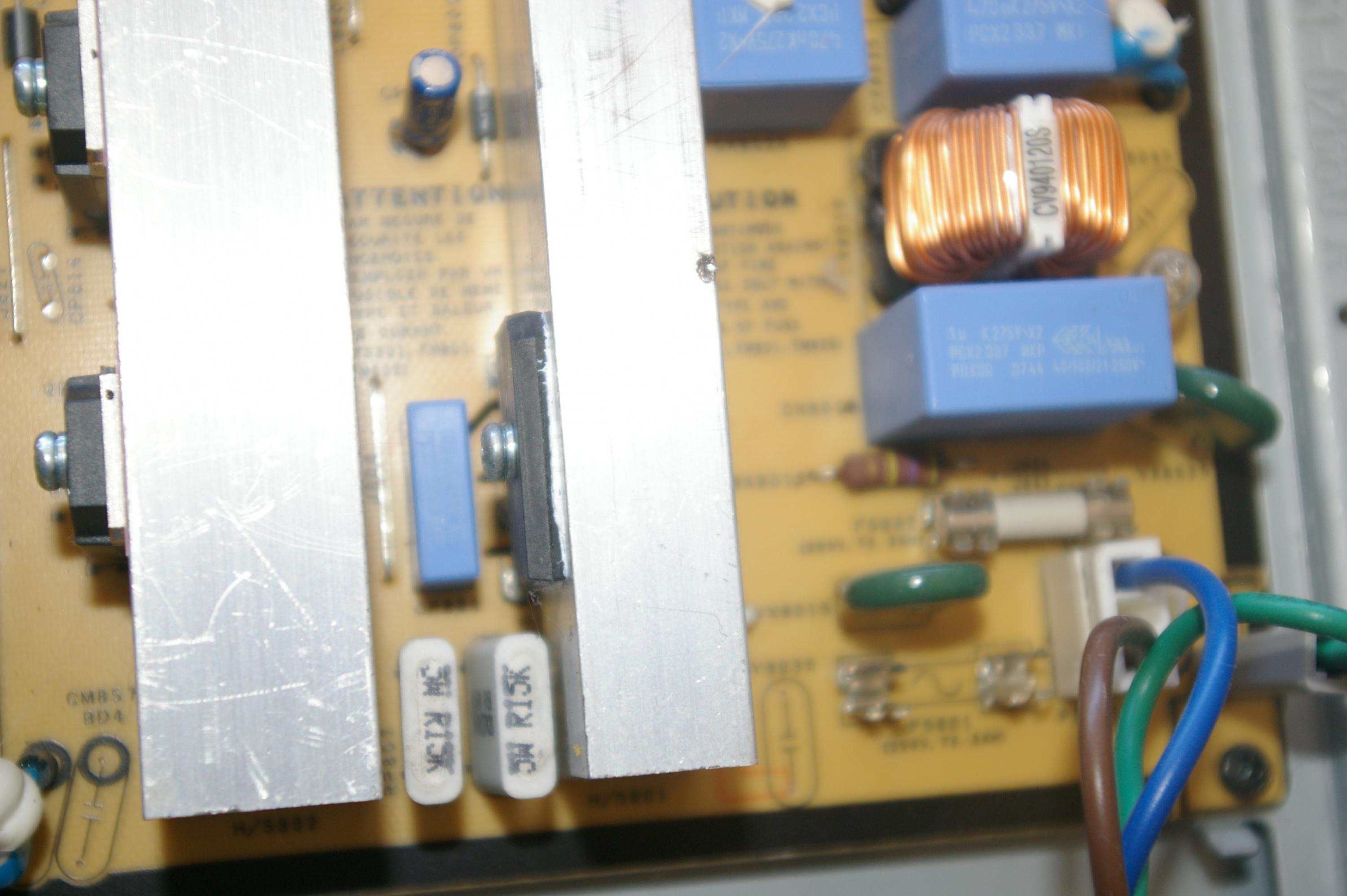

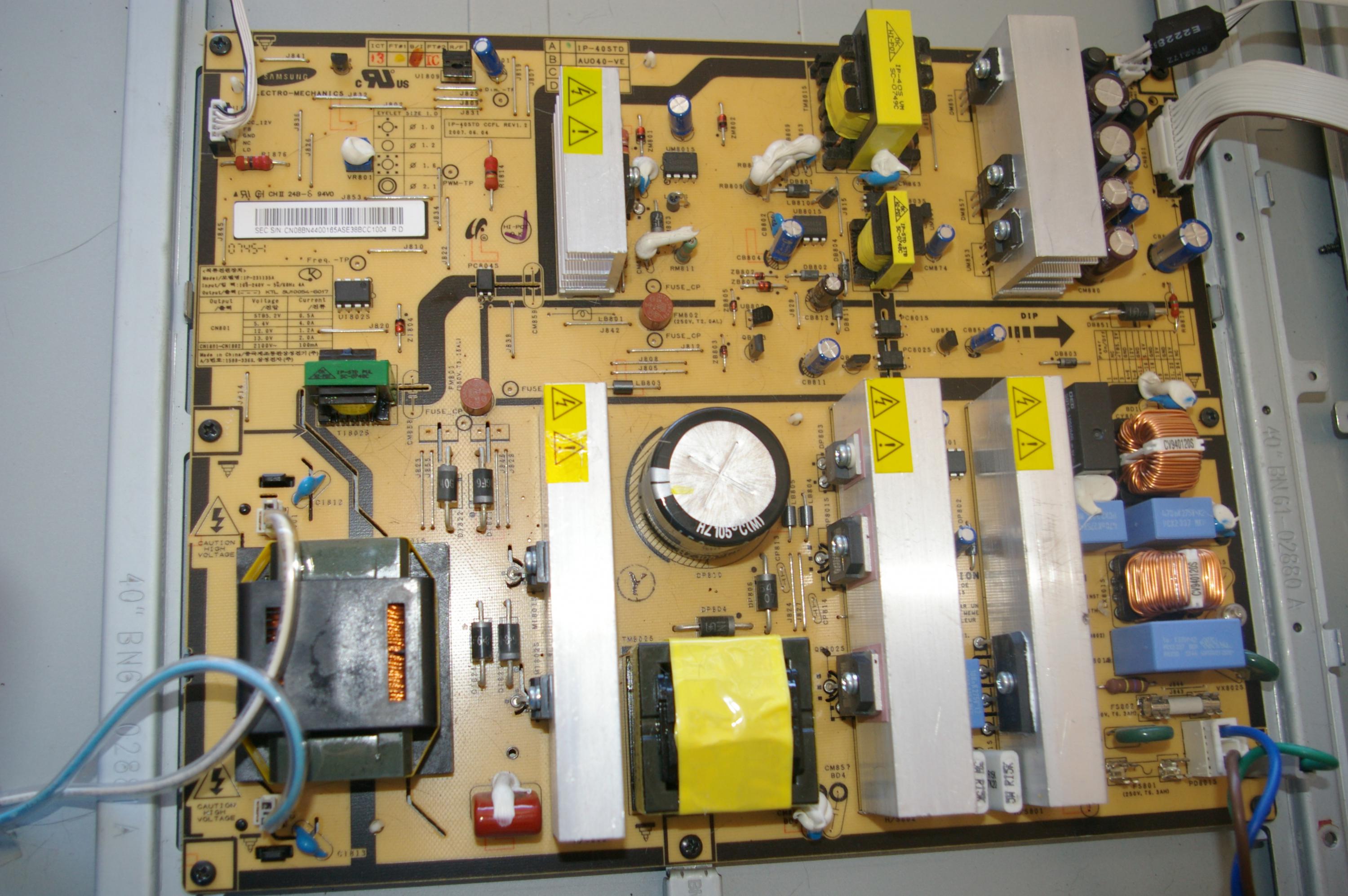

                            Re: Samsung LNT4061FX LCD - Black Screen?
                            thanks bud. is the set able to power on with the t-con completely disconnected? the t-con for this set is kinda pricey, and i'm thinking about just salvaging parts if I can. Of course, now I'm not sure what I have, so I'll need to test more.
                            I'm not entirely sure I understand everything you said, but I think you are saying it's safe to assume the t-con is otherwise "fried", or was fried before I started?
                            Here is picture of the PSU, and the area by those fuses (first one that blew is removed). I think you can see the burn mark from the arc that happened.
                            [/ATTACH]
                              its probably blown the bridge rectifier as a guess, i will let budm explane how to run a test i hate trying to explane things.
                                OK, it did touch the HOTSIDE HEATSINK.
                                At least now we know that the T-CON is bad for sure did to the blown SMD fuse.
                                Now we need to fix the power supply board, so here is the diagram, the bad news is that when the T-CON touched the HOT HEATSINK, the fault current flow through the Ground wires of the LVDS cables then to the chassis safety ground so there may be some damage on the main board also which is not good.
                                There are two fuses, one is for the MAIN AC fuse, the second one is for the backlights inverter circuit. If the one for the inverter circuits is blown, then you have even more problem.
                                You are going to have to check the MOSFETs in the inverter section, the bridge, the MOSFETs in the power supply section.
