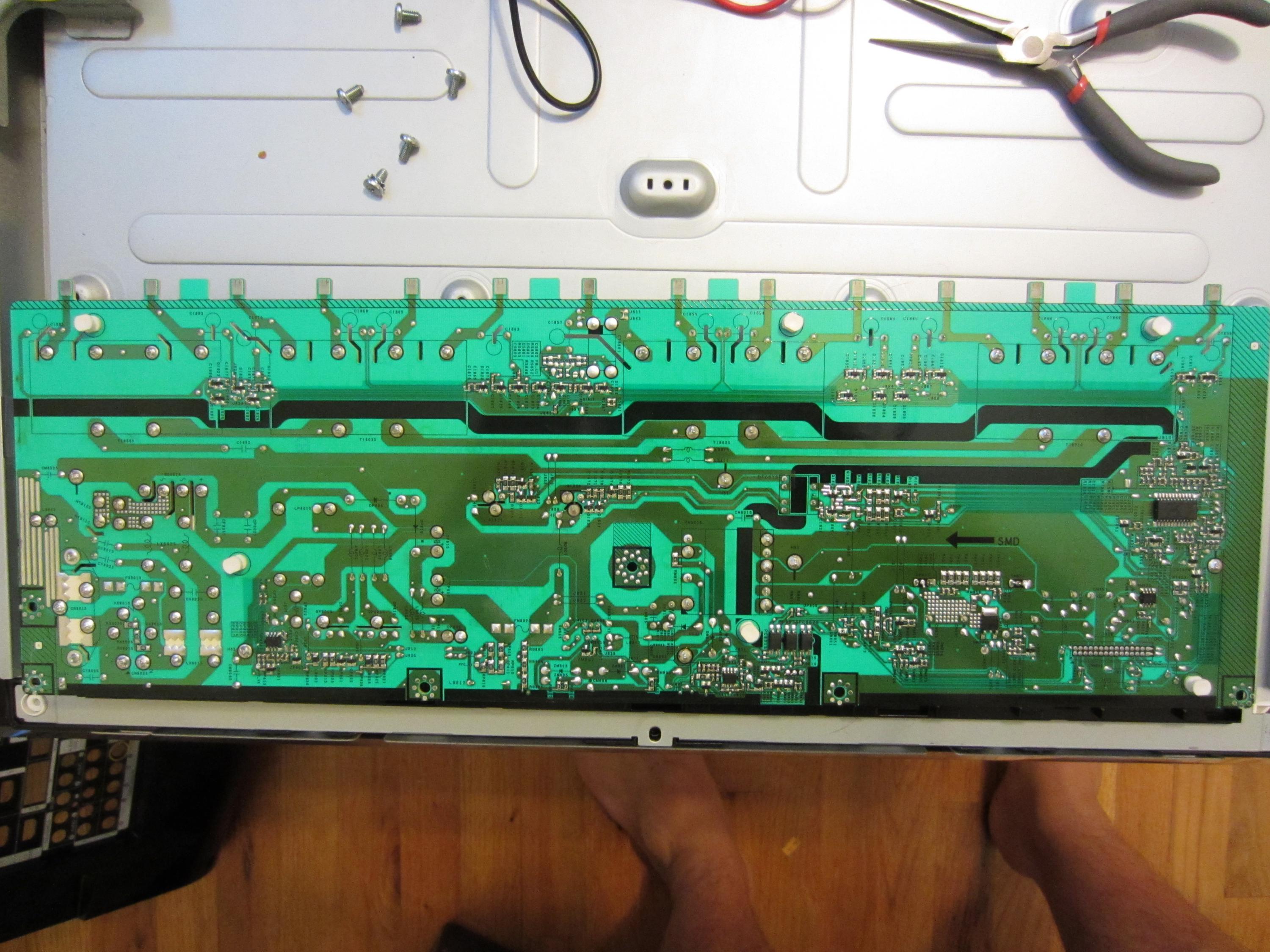

    Hello folks. Found a Samsung LN40B630N1FXZA. Brought it home, trying to fix.
    Symptoms:
    Started it up, got the startup melody, screen comes up, then 15 seconds after that, turned off, no response to buttons. Unplugging and re-plugging it, no response unless I leave the TV unplugged for a long time (more than a few hours), where I get the same routine, startup melody 10-15 seconds, screen off.
    Opened it up. Has a BN44-00264A power board. Unplugging the main board and attempting to power it up, get the backlight to come up for a second or so, then screen goes out. From the little I know, that seems to indicate a bad power board?
    Trying to troubleshoot a little more, learn, and hopefully avoid the cost of a full new board.
    No bulging or leaking caps that I can tell. Took board out, turned around, nothing totally evident. Pictures attached.
    Have searched the forum, but unfortunately it seems the stuff that I can understand have not pointed me somewhere. Looked at the schematic but cannot figure it out too much.
    Multimeter shows big caps jumping for a sec to 400V, or a little less at startup, then dropping to 166V. Fuses look good, measure fine on continuity.
    Cannot get any readings at the CNM802 plug, not sure if I am doing something wrong to not get anything there.
    CM806 shows 166V, CM805 shows 0V. All the caps on the right side of the board (closer to CNM802 plug) that I can measure appear to show 0V.
    My soldering, desoldering skills are not that great, so I am trying to avoid taking unnecessary components off to test them.
    Any pointers as to next steps to troubleshoot would be greatly appreciated.

    Re: Samsung LN40B630N1FXZA Power Board Troubleshooting
    Power Supply PFC circuit is shutting down. What about your 5vdc standby?

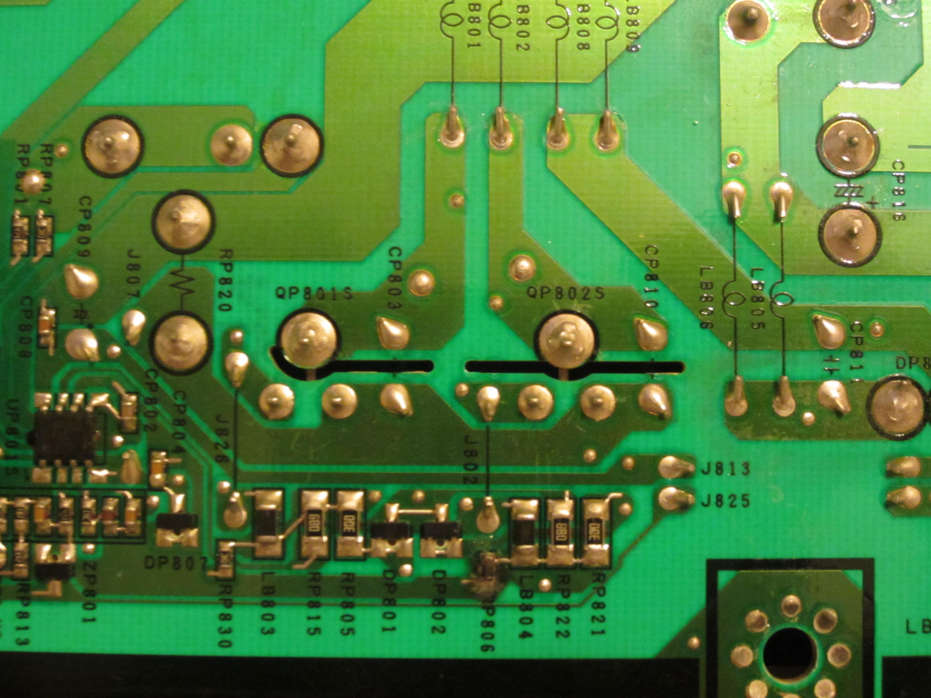

                    Ok folks, a bit delayed because I managed to blow a fuse by applying power while the board was not connected to the bulbs and had to run to radioshack to buy replacements.
                    So I basically get 0V anywhere on the cold side of the board within a second of putting in the power cord.
                    Let me go through the events for tonight.
                    Plug in TV, startup melody (given it was unplugged for quite a few hours). CP815, CP816 measured at 390V+. Unfortunately did not have a chance to measure anything else with screen on. Screen turns off promptly 5 seconds after it comes on. CP815, CP816 fall to 170V.
                    Once this happens, subsequent connections of the power cable will not bring TV up unless I leave TV for more than at least an hour. If I disconnect the main board, I may see the backlight flash on for less than a sec (depends on how long I have left the TV off the cord, longer off, more likely to happen).
                    At one point I think I was able to catch standby blip to 4V or so before draining down again.
                    Measurements on the hot side with ground ref being the negative side of CP815:
                    CP815: 170V
                    CP816: 170V
                    CM806: 170V
                    CM805: Both sides show 170V (?)
                    CM808: ranges between 9 and 13V.
                    Then I started measuring resistances on the between drain and source on my FETS (QI820, QI821, QP801S, QP802S).
                    All of them seemed to be infinite and then I started second guessing myself (at this point the post takes a darker turn) and thinking 'should I be plugged in for this'? So the answer is of course NO....
                    But the result is that I got some nice sparks, and I think I killed RP806. I am getting a resistance of 1.2 Mohms on it now, not sure what the spec is. Photo is attached.
                    So I guess I am feeling pretty discouraged right now... Did I kill off my board or is there still hope for it with some fine soldering skills (that I do not possess)?
                    I know I can buy a new power board and most likely get a TV for $70, which will probably save me a few nights, but still, damaging something more than what it was is a disappointment to my dreams of reviving my electrical skills.
                    • Neelix
                      • Oct 2013
                      • 145
                      • South Africa
                      Photo is blurry and so it difficult to see if the pads got damaged, but RP806 is definitely killed. According to diagram, it's resistance value should be 10Kohms. Measuring resistances in a circuit with live voltages can also damage your meter. What or where did you measure when RP806 got killed and you saw the sparks?
                        RP820 and the QP801/QP802 could be bad.
