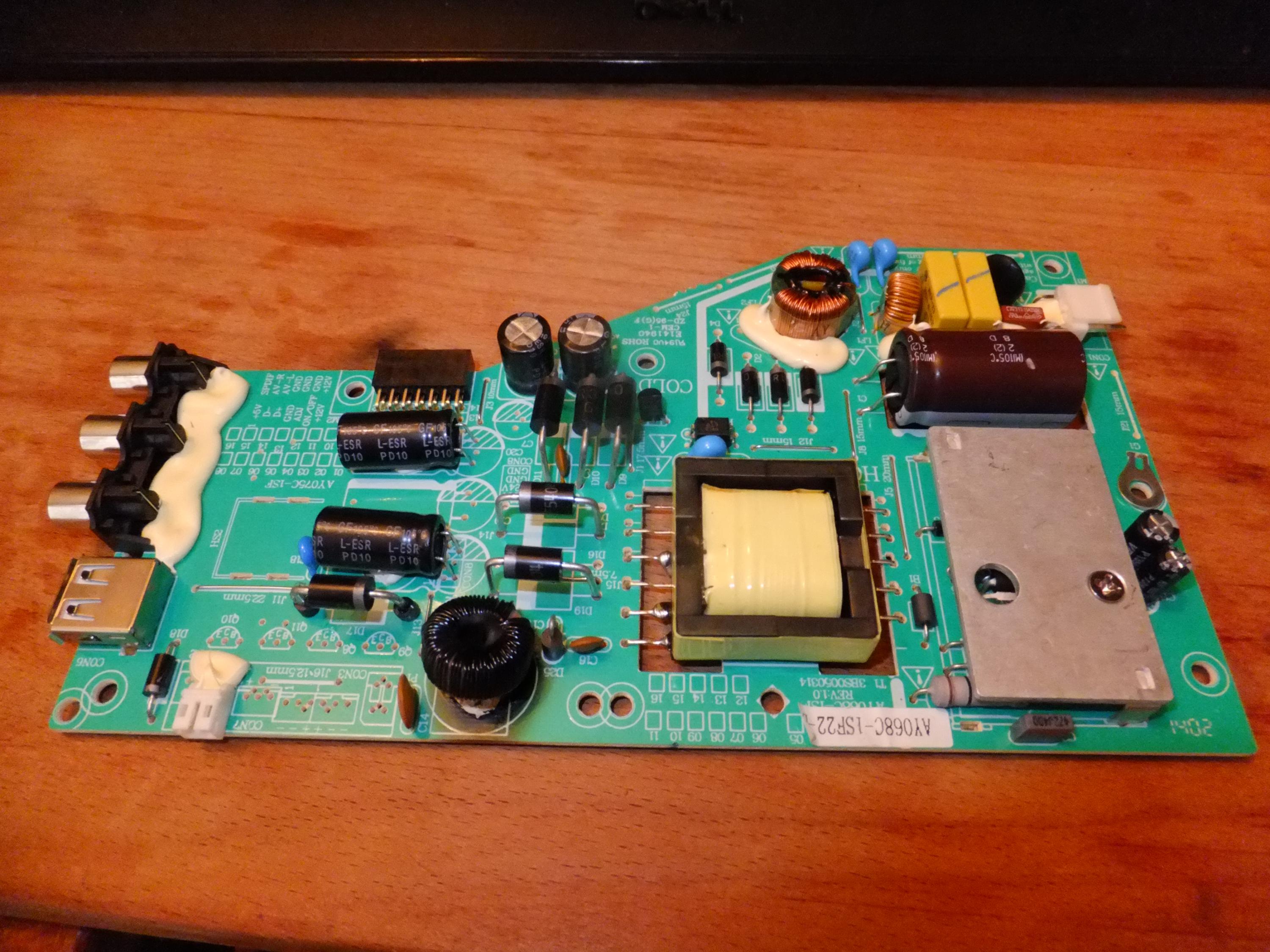

          Just as a note I received a couple of RCA rldedv3988-A and in 2 of them there is a board AY075C-1SF14-080 that is identical to the AY068C-1SF22 i tried it in the TV and it works great the L1 inductor is a different kind its horizontal and if i look on ebay its called radial. It is the only part in the board that is different so I guess Curtis knows it was a problem and upgraded the boards accordingly. If anyone knows where i could get either board please let me know.

              this tv has same boards as well, only difference i can see from pictures is cx1 on the board is missing from the ay068c-1sf22-b

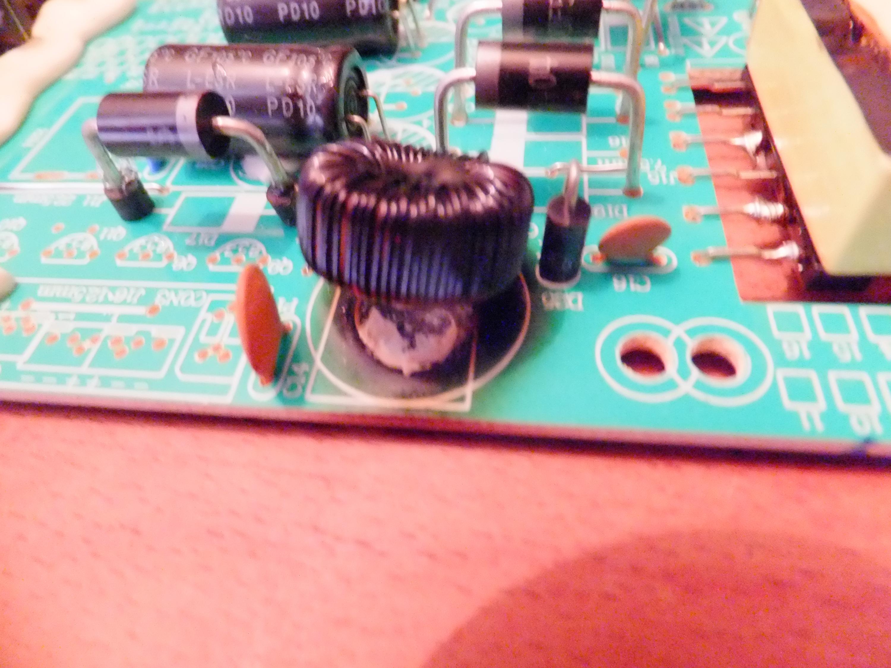

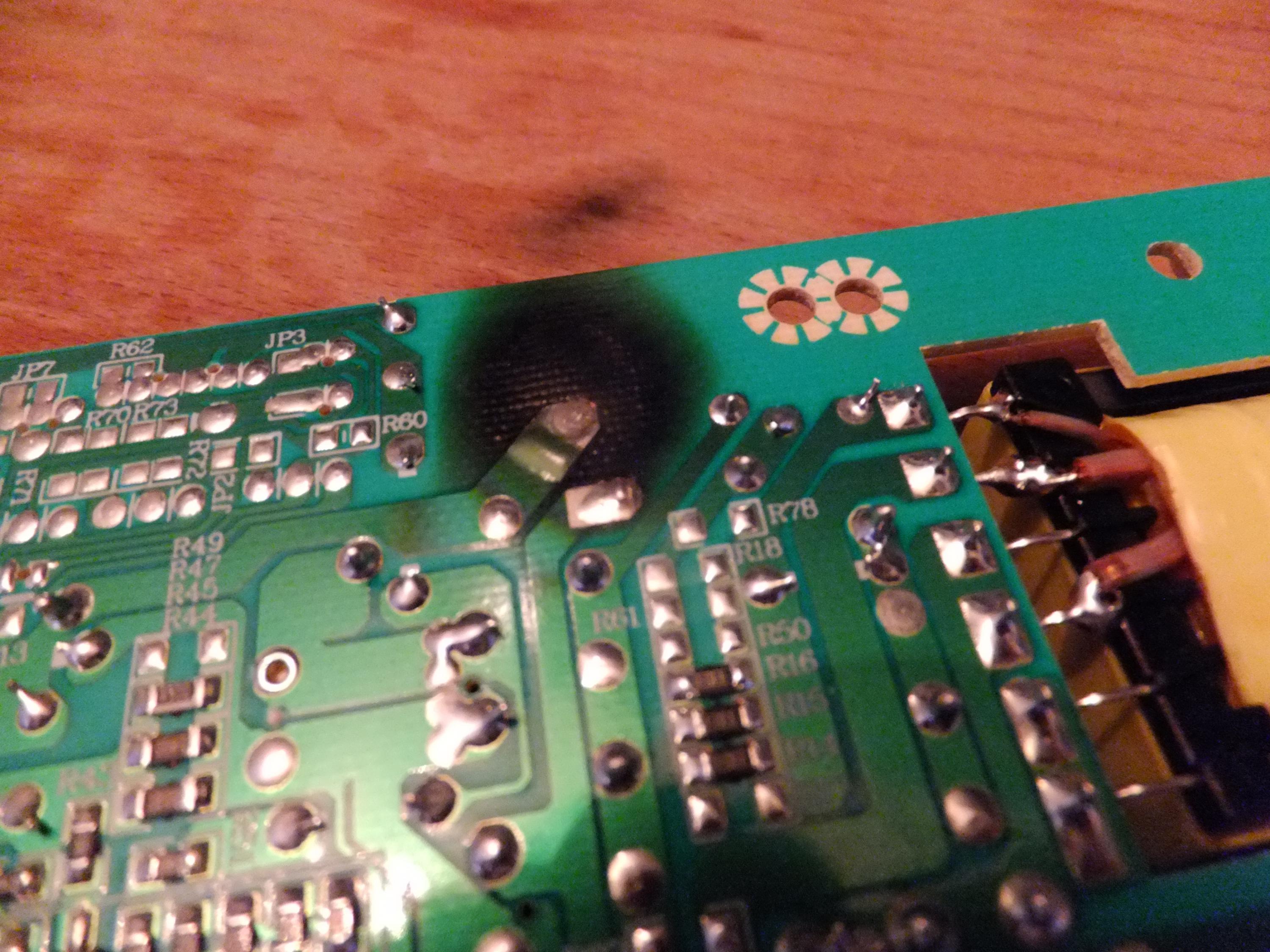

                  OK, so I got this TV with the burnt coil. I do not have any way to test a coil so I need some help. Does it really matter what size coil I use? I was thinking a thicker wire with the same amount of wraps but I guess you have to add wraps if you have a thicker wire. It seems everything else is good, just the coil desoldered from the board. It is toasted. Black and the board is burnt. I added some pictures.
                  If someone can post a link to the correct coil. If I don't find one soon I may buy the kit from eBay.
                  Also should I add some resistors to lower the current?
