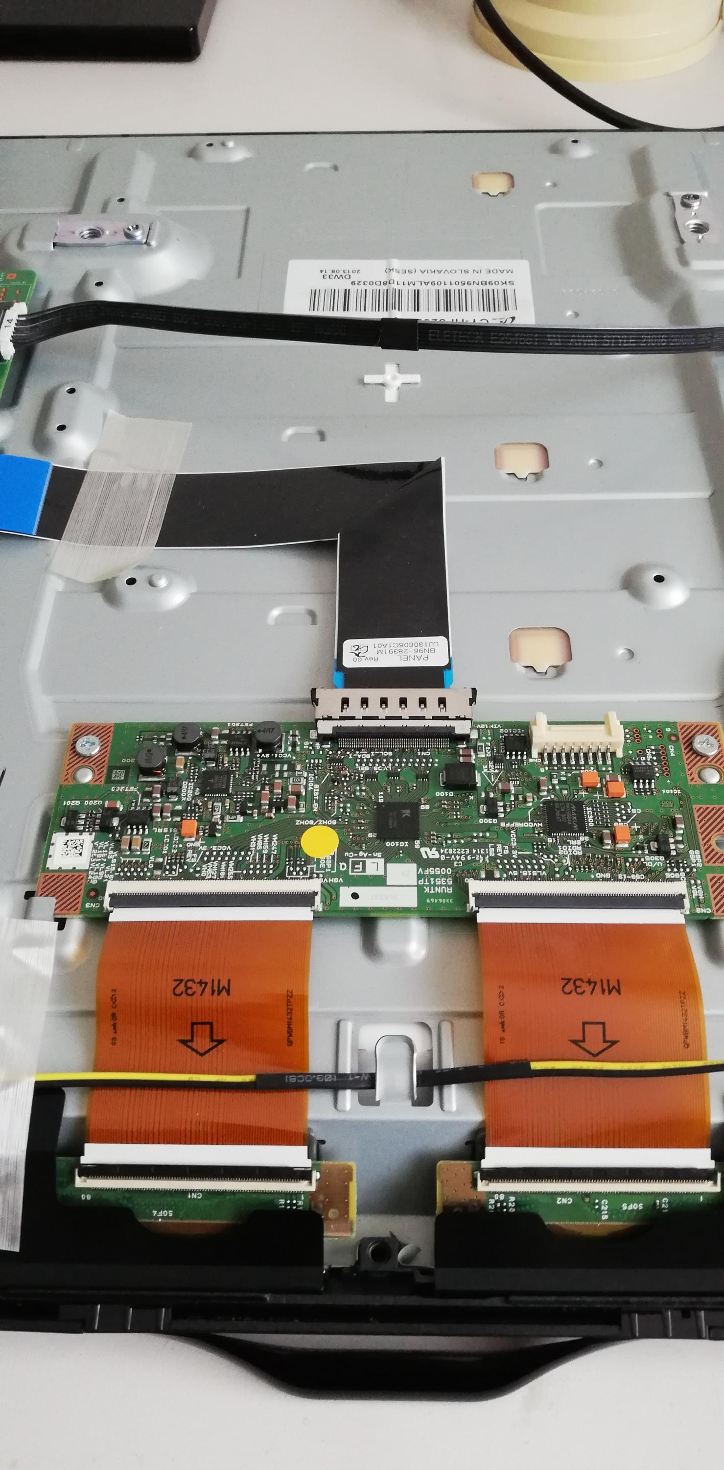

    Do you get 12VDC at both ends of the SMD fuse on the T-CON.
    Pictures of your TV will also help.

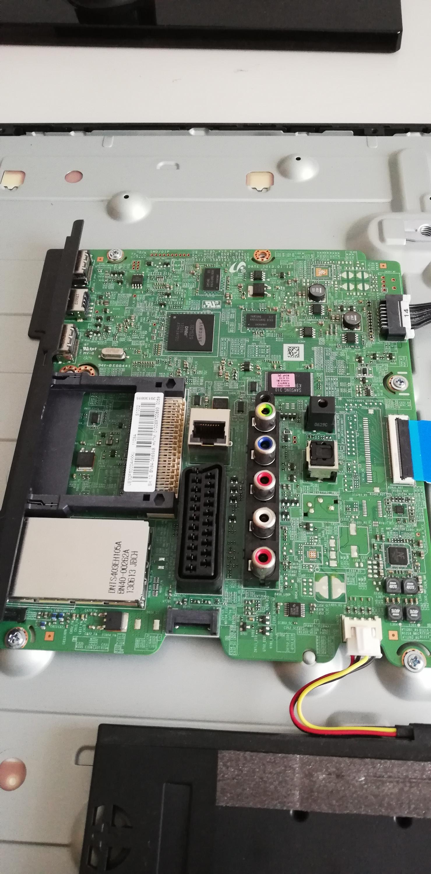

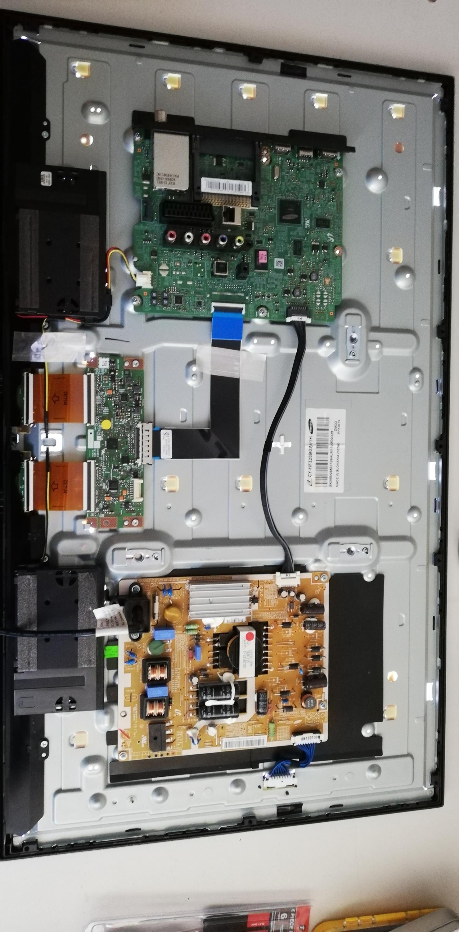

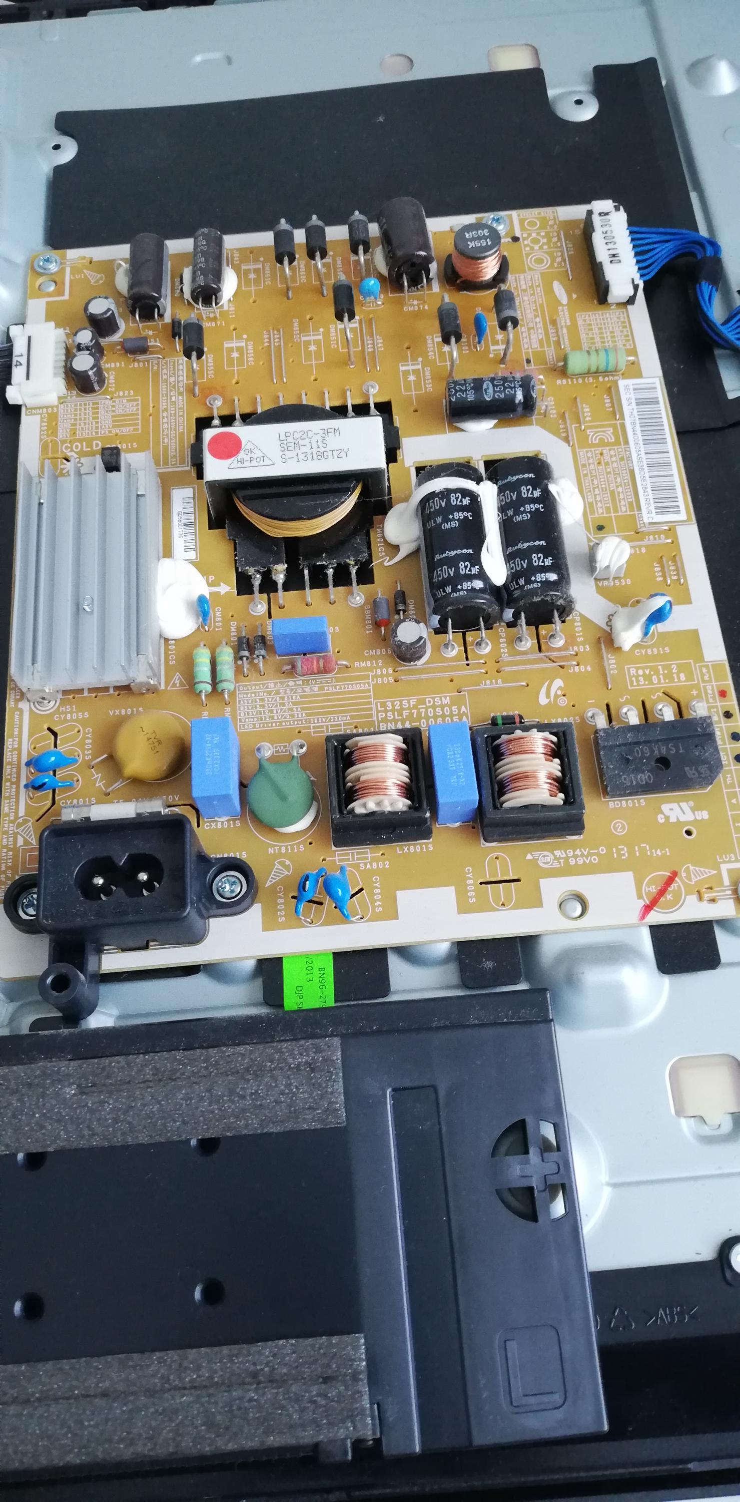

      Hi, yes I get both end's 12VDC on t-con. Here some photos of the TV.
