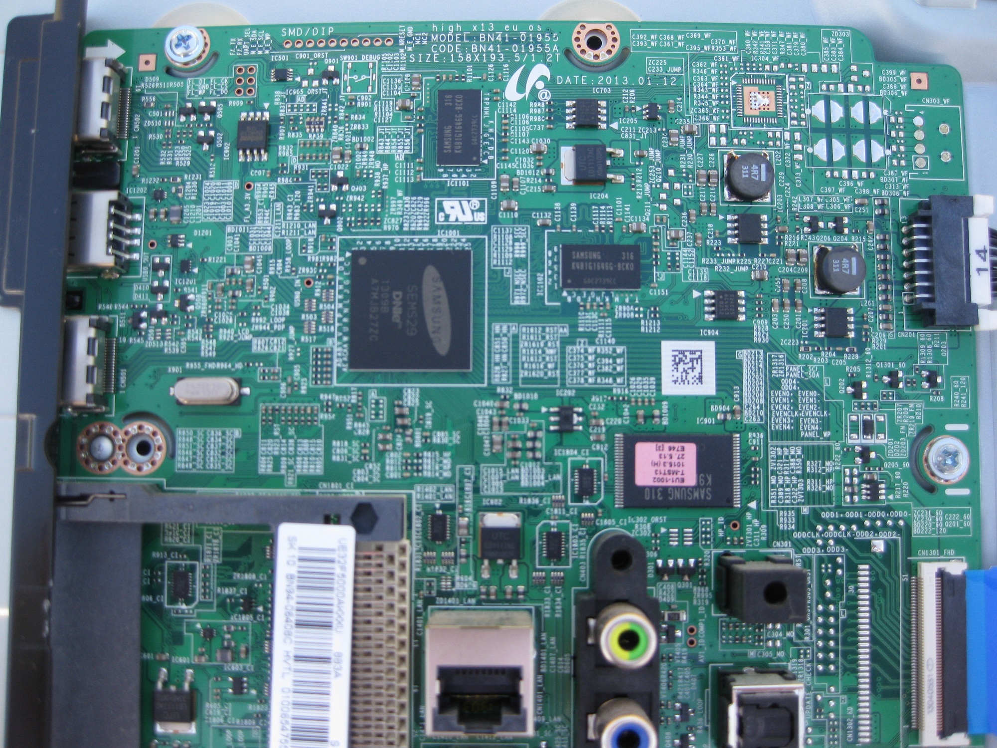

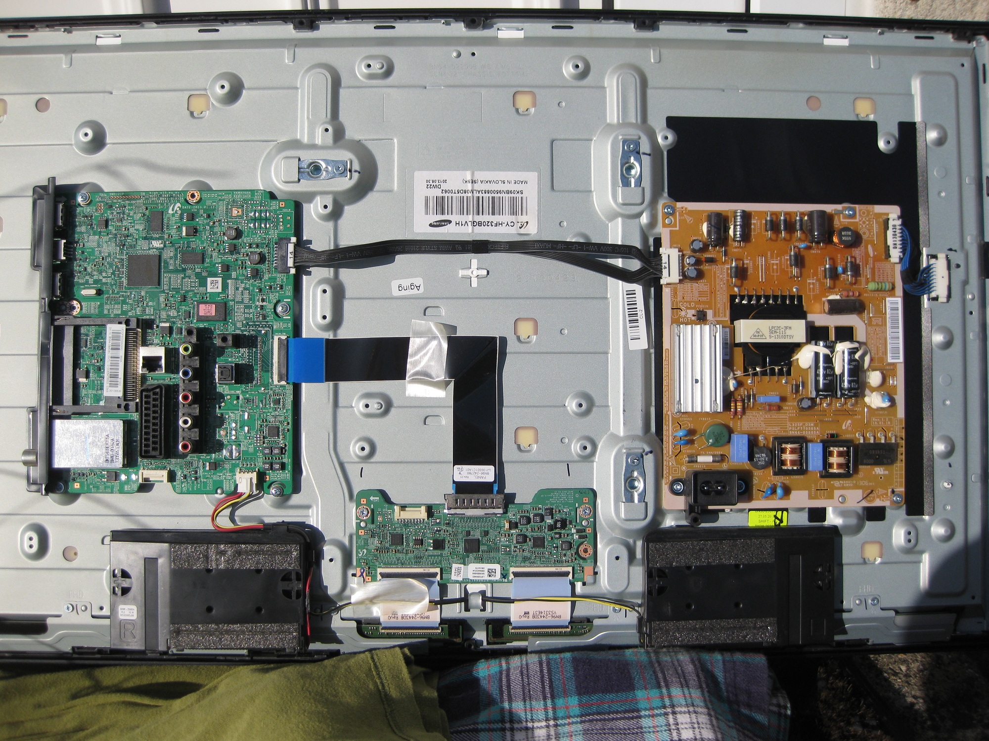

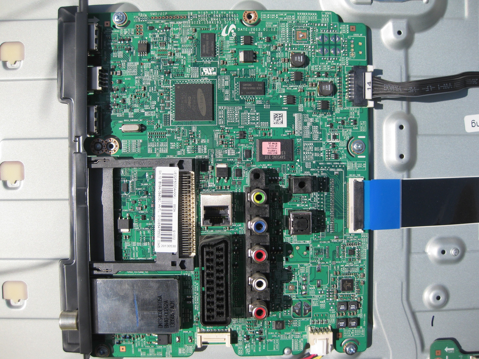

            Re: Samsung UE32F5000AK sound ok, no picture.
            Hi Tom,

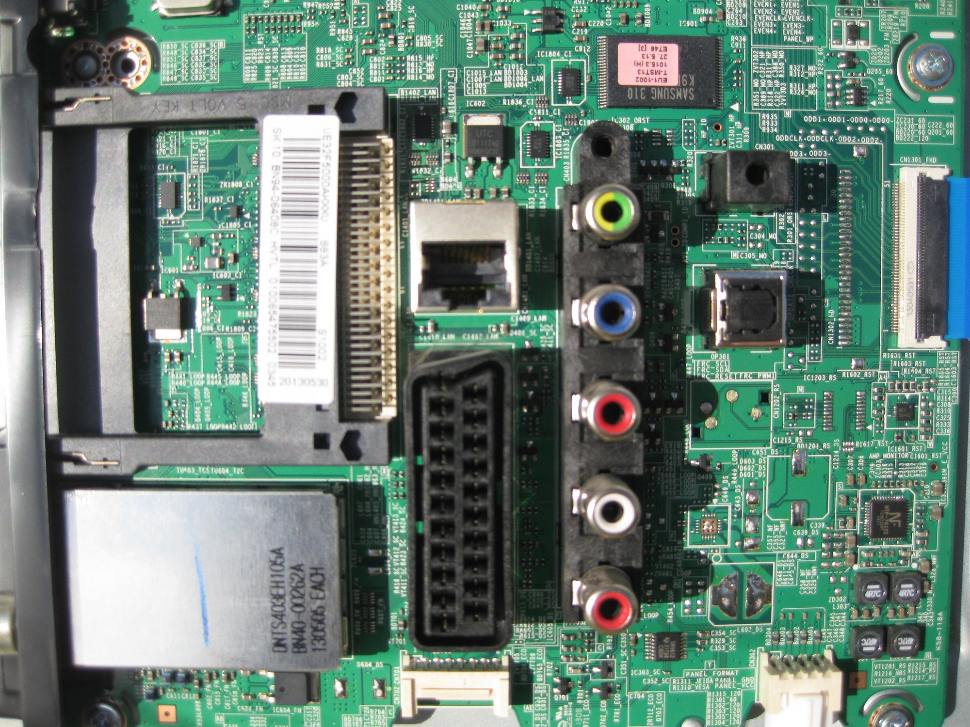

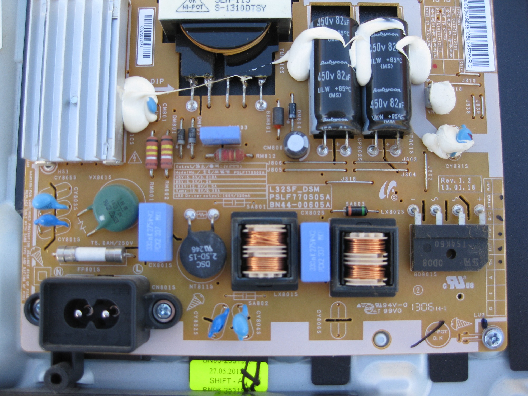

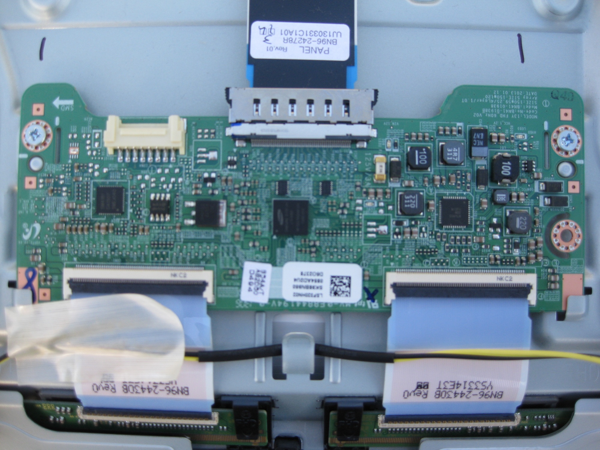

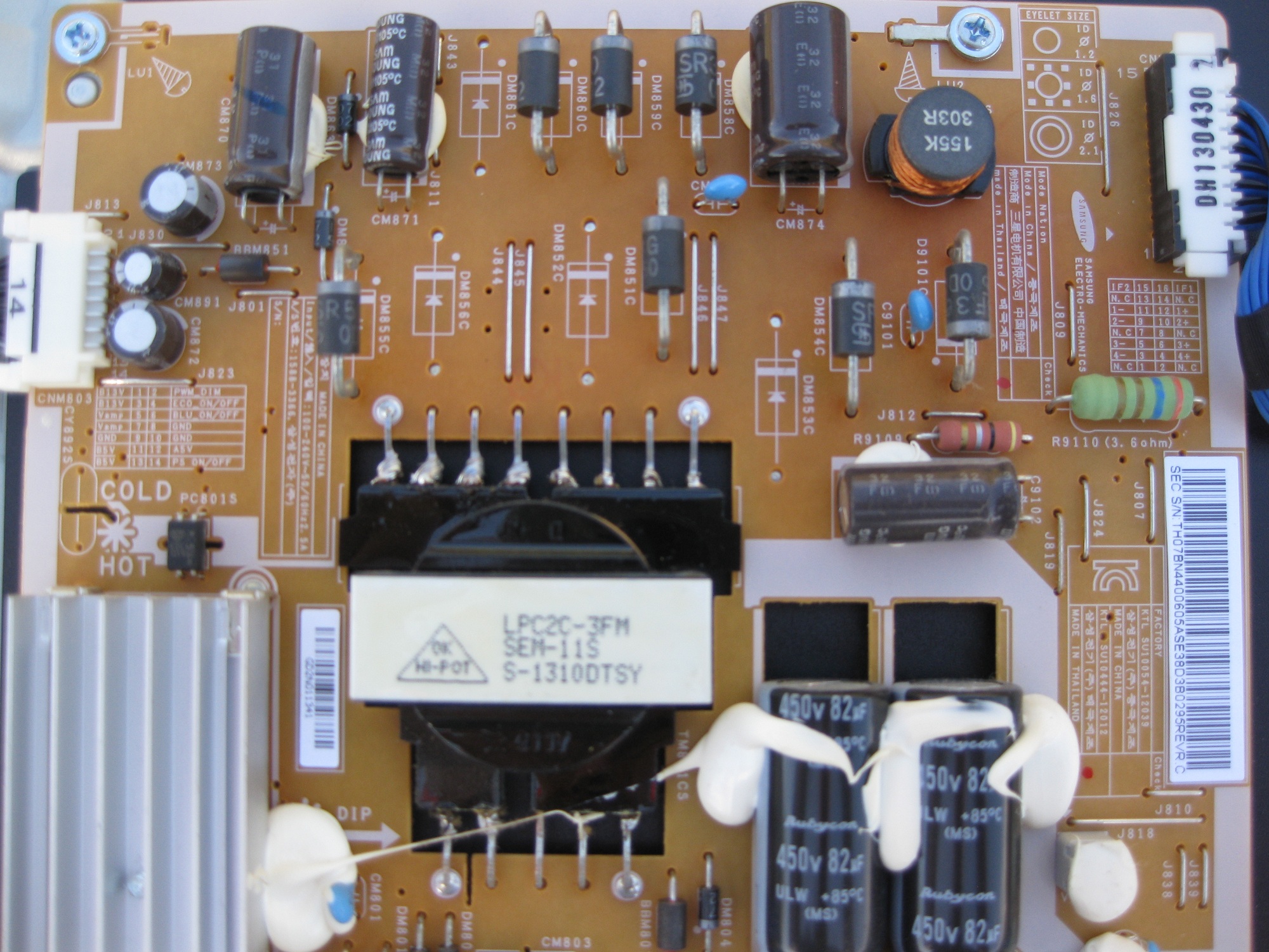

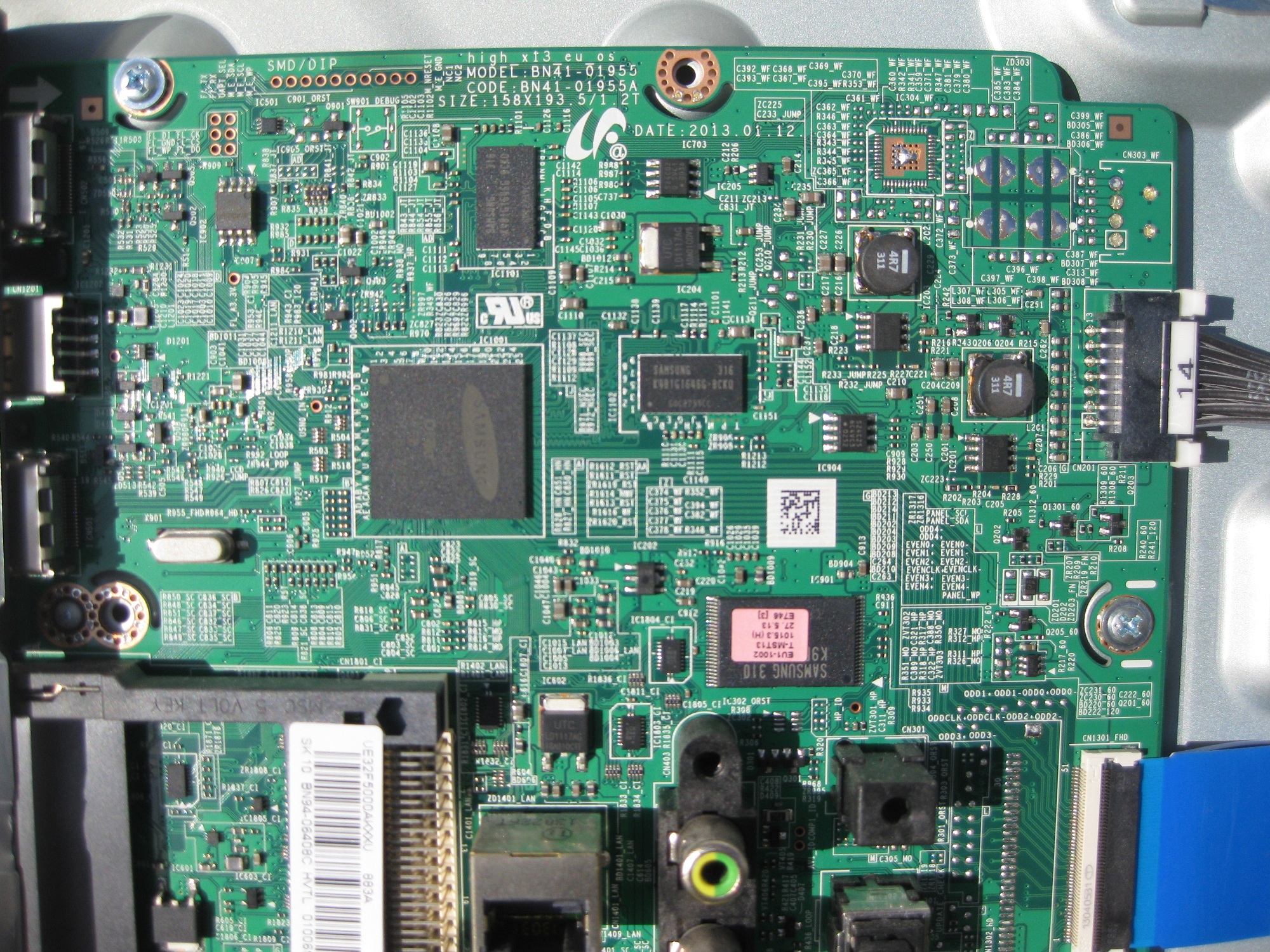

            Please see attached photos, I'll take a good look at the boards tonight using a big magnifying glass to see if anything looks kaput or blown.
            When the set has power there are 3 blue led lit on the middle bottom board.
            Kind regards
            Mac

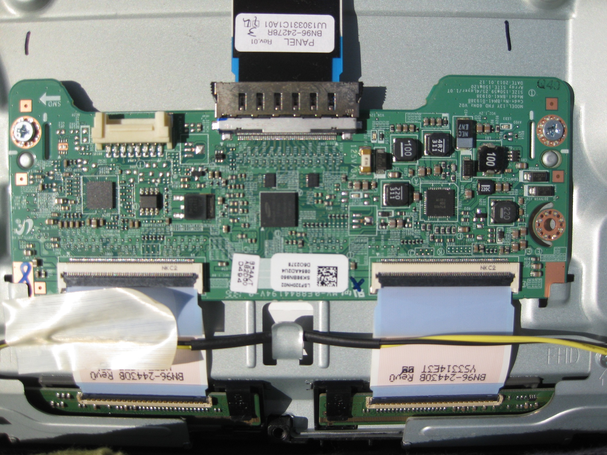

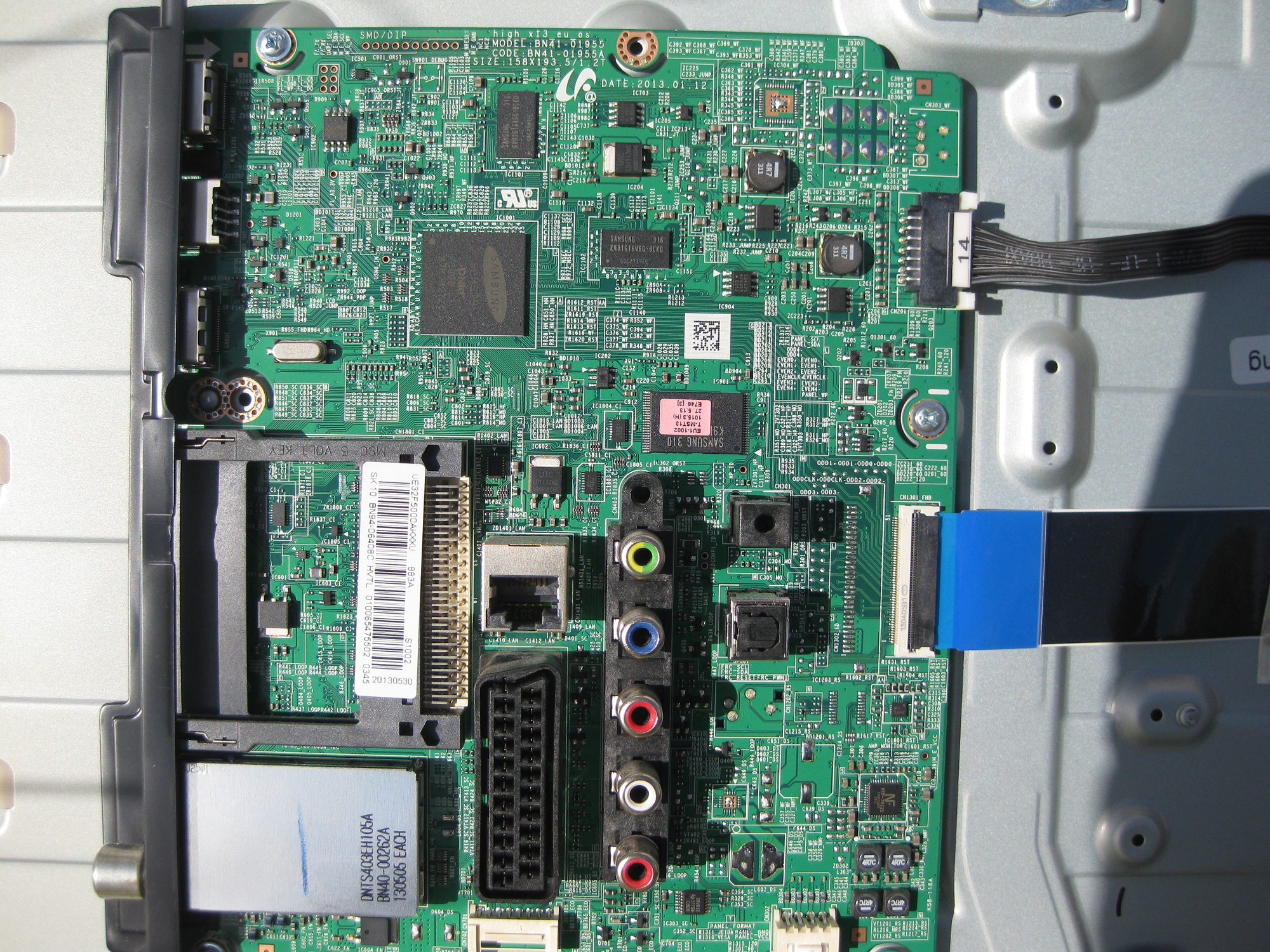

            • macwireworld
              • Nov 2014
              • 17
              • United Kingdom

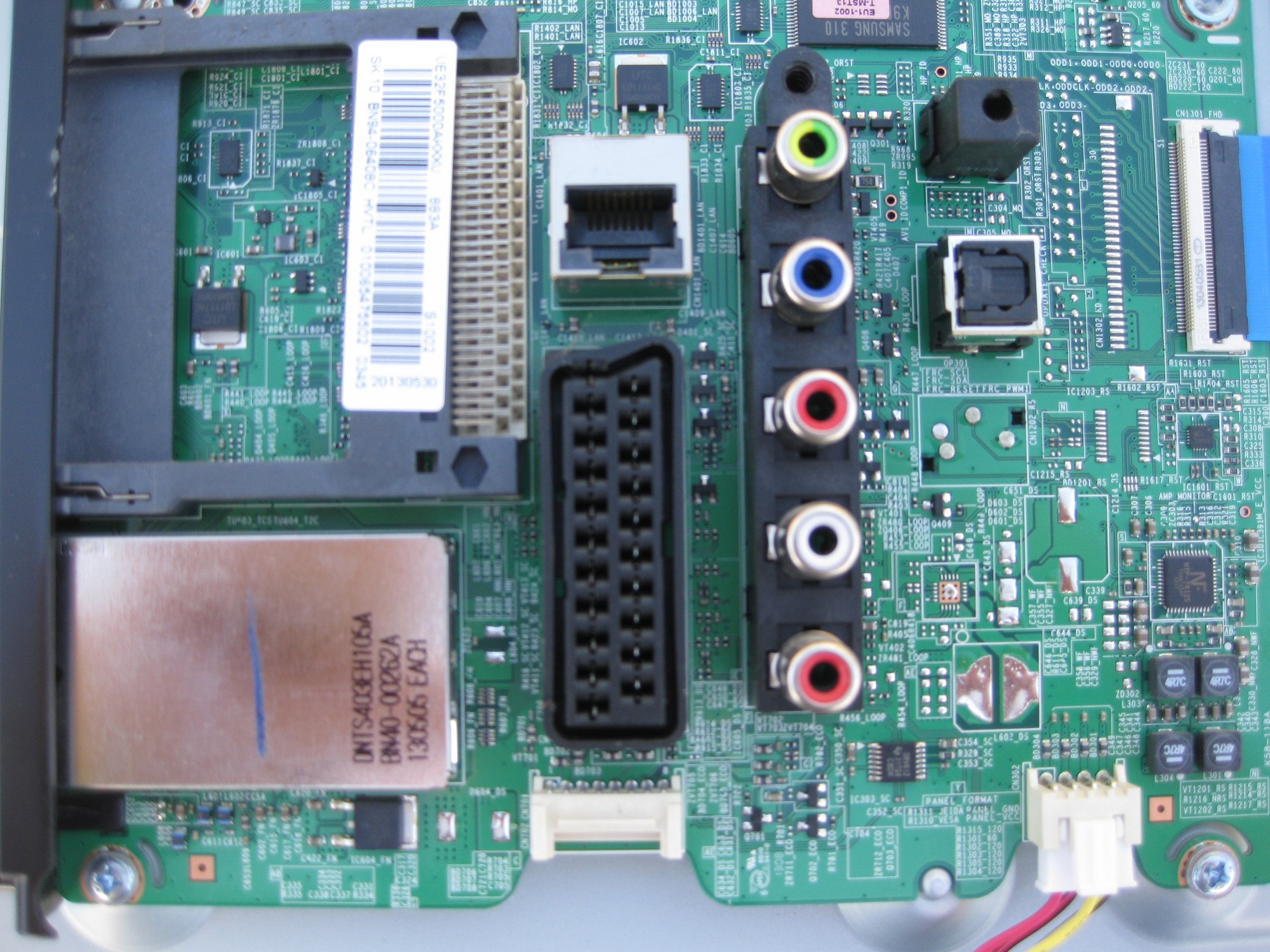

              and a few more...
              • macwireworld
                • Nov 2014
                • 17
                • United Kingdom
                Bugger! No sign of anything obvious on first inspection, all looks ok...

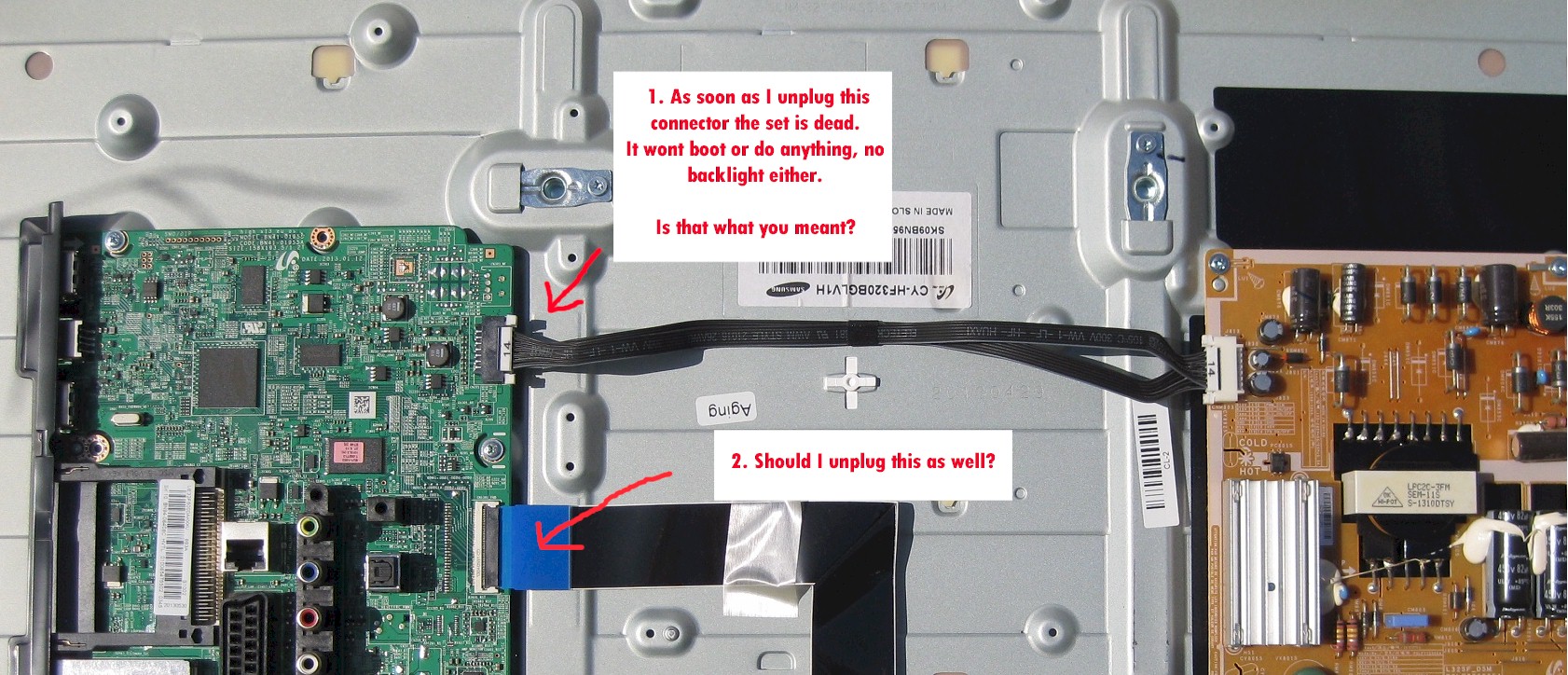

                  Unplug the mainboard harness from the Powersupply and see if the backlights kick on. Unplug the unit from power, then unplug the main from the PS then plug the unit back in.
                  • macwireworld
                    • Nov 2014
                    • 17
                    • United Kingdom

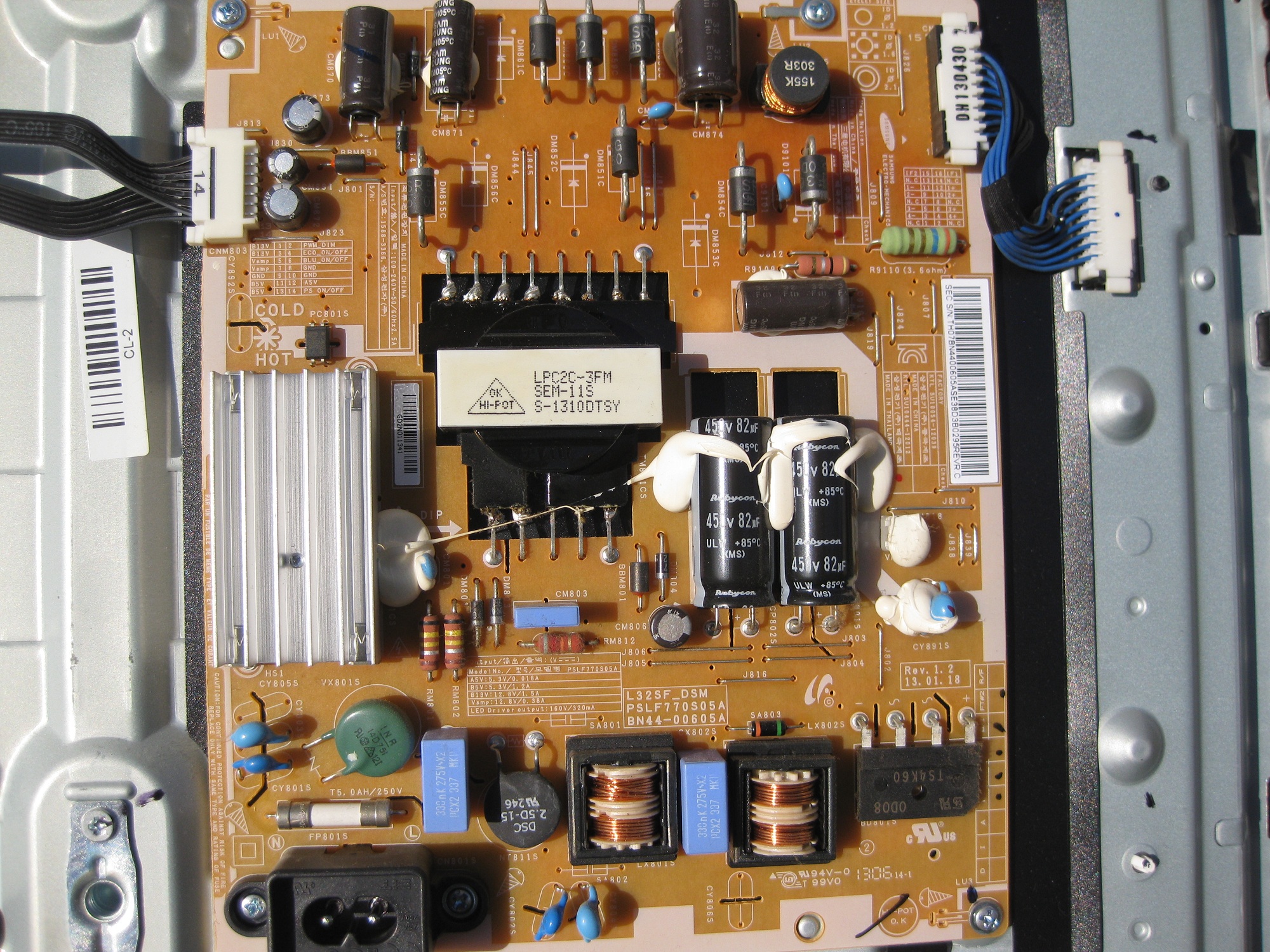

                    Hi Shinju, please take a look at the photo to see if I got it right.
                    Many thanks
                    • Shinju
                      • Mar 2014
                      • 1239
                      The top cable is the correct one, so you get nothing? The flat ribbon cable is the LVDS cable to the T-Con.
                      So try disconnecting the LVDS cable (leave the mainboard/power supply cable intact) and then try turning on the unit.
                      • macwireworld
                        • Nov 2014
                        • 17
                        • United Kingdom
                        With the top cable disconnected, the whole set powers off, cant use the remote, no led's lit on the T-Con... this set doesn't have a on/off button at all, it's dead.
                        With the LVDS cable disconnected and the set powered on with the top power cable connected, exactly the same as before, six blinks of the standby red LED and nothing just a blank, dead screen.
                        • Shinju
                          • Mar 2014
                          • 1239
                          Sounds like you have a short in a LED strip or a problem with the PS like Tom66 had suggested.

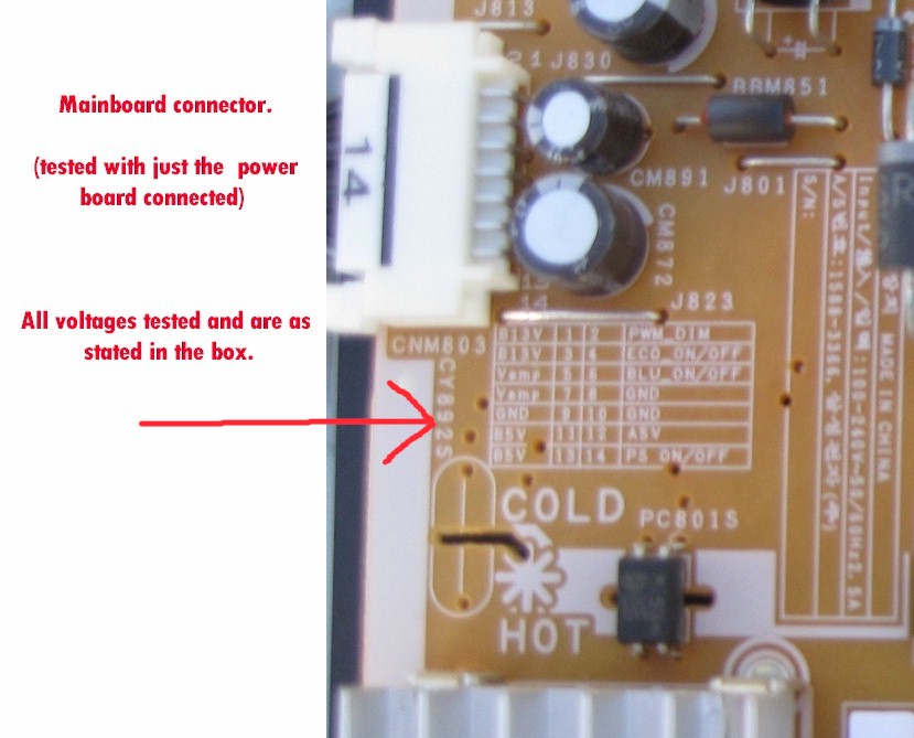

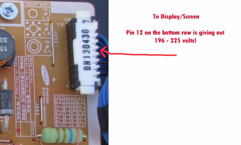

                              I've just tested the voltages from the power board to the main board and I think they look ok, (Picture1).
                              What I did find weird was the power board to screen (picture2) has one pin with 196 - 225 volts (keeps dropping and climbing) running from it... is that right? I thought the cold part of the power board was low voltage.
                                From what I can see from the pictures, you have 4 strings of LEDs (+/1, +/-2, +/-3, and +/-4, + is the Anode side of the led string, - is the Cathode side of the string)
                                So check the Voltage on each pair of the connector and see which one gives you the highest Voltage reading, that will be the one with open LED/LEDs on that string.
                                So it looks like string #1 has open circuit.
                                This is what I use to find out which string has open circuit (RED LED will not flash on).
                                https://www.badcaps.net/forum/showpo...&postcount=107
                                I am sure if this one has one of those training manual on how to force on each LED string or not, I saw that some where in the thread.

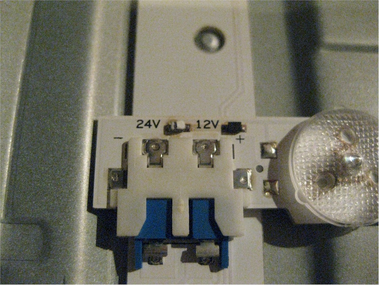

                                  Thanks for the reply, bit the bullet and stripped down the screen and found the problem!!!
                                  Looks like a component (see pic) has blown on one strip, all the other strips look fine. Any advice on how to fix or do I need to buy a new strip? I'm not sure what you call the broken bit

                                    I cannot tell what that is, but since you have other strip, can you test and see how they are measured in Ohms, and trace out how they are connected to the + and -?
                                    It must be connected in series withe LEDs and that is why it acts like open LED string symptom.

                                      I'm going to try to bridge the connection with solder, the resistor has turned to a white powder as seen it the pic above, when I touched it it crumbled away, all I have there now is a gap where the resistor was and it looks ok to solder.
                                      Do you think I'll damage anything if I try this?

                                        It could be a fuse - doing so could damage something else. I think you should think about why it failed rather than just bridging it. Resistors rarely fail for no obvious reason.
