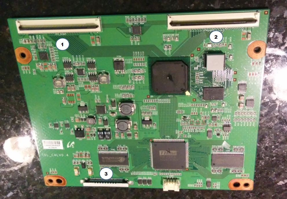

        Re: Sony Bravia KDL-55EX713 - No picture
        Here's the tcon board from my TV.
        Where can i find the fuse?

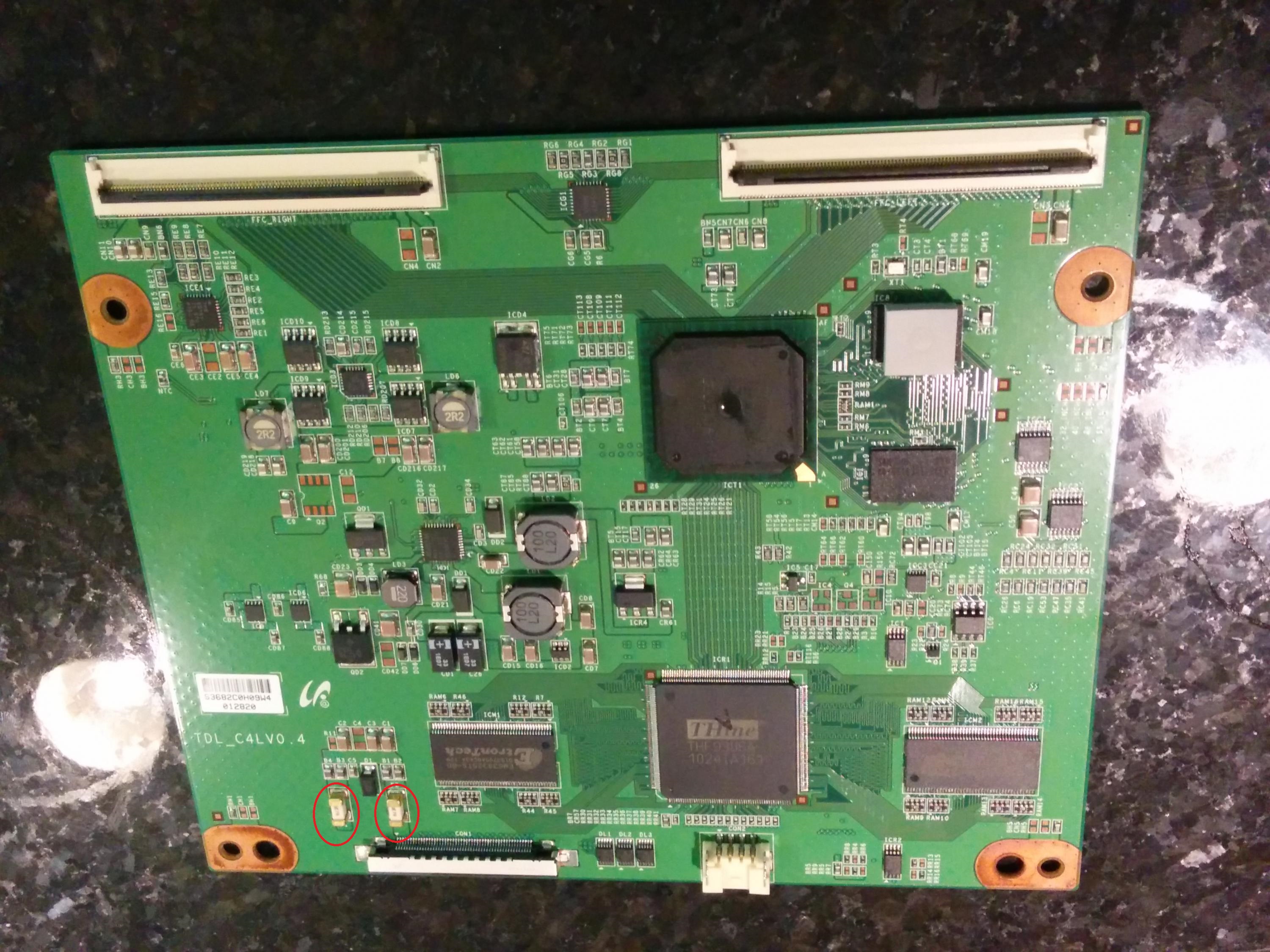

        • sordids999
          • May 2013
          • 2161
          • uk
          Thats your fuses circled in red

                        Completed some checks
                        1) All fuses have continuity, no concerns
                        2) All fuses have +12~vdc at fuses
                        Now i noticed when i turned it on there's a clicking coming from the tcon board
                        Im assuming this isnt normal ?
                          It is down to either bad panel or bad T-CON. There are flat cables between the panel and the T-CON board, you can have them connected one at a time to see what you will get on the screen.

                            Checked with 1 connected at a time. Basically gives me horizontal lines on either left or right side with one connected.
                            What would "click" on the Tcon board constantly?
                            Sorry but whats a bad panel? If its a bad panel is the tv pretty much scrap?

                                Im not sure what the cables exactly do?
                                What do cables 1,2,3 exactly do ?
                                  1 & 2 goes to drive the ICs on the flexible between the glass panel and the PCB where the tab bonding are made. #3 is the LVDS cable where the LVDS are from the main board, it also supplies the power to the T-CON board.
