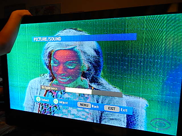

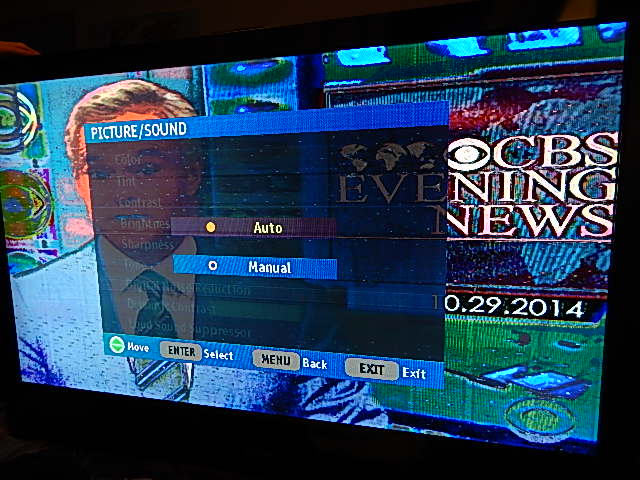

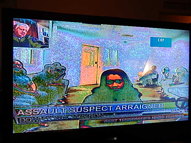

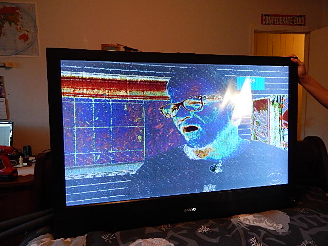

        Re: Sanyo dp46848 half screen dark and lagging

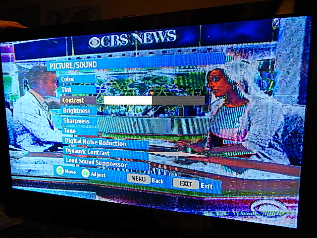

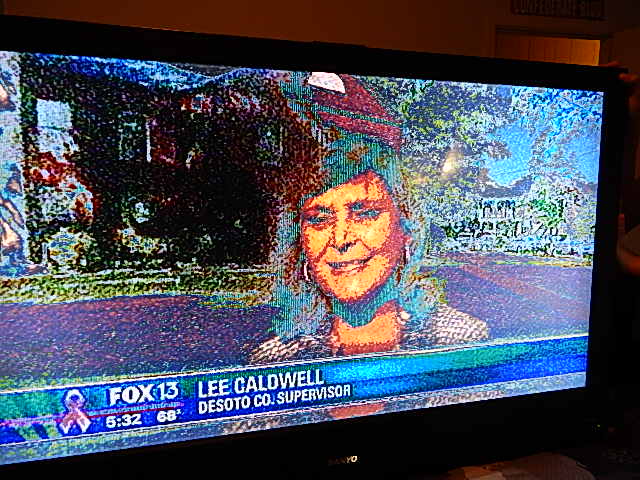

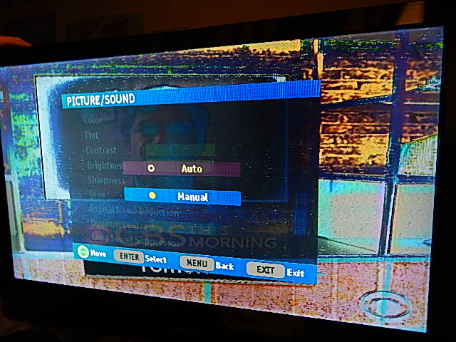

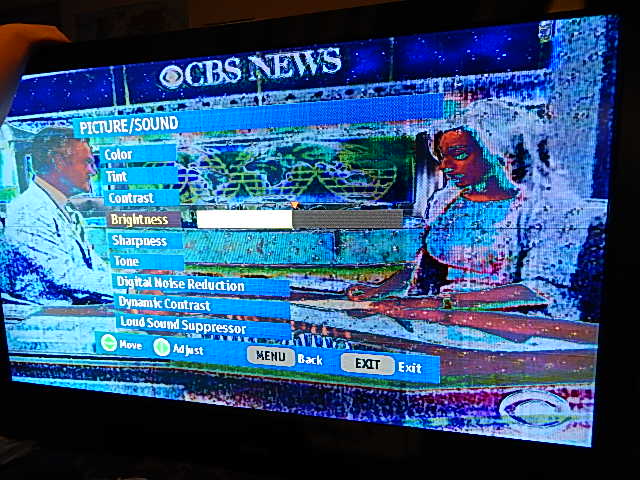

        I have a Sanyo Model #DP46848.
        My problem is a color and ghosting, or imprinting of the last words. Not fading or lines not unless you have the menu on, then you can see fading of lines.
        I have taken pictures of the symptoms but I am new to this website.
        • twe2011
          • Oct 2014
          • 3
          See my note from earlier.
          When turning on at first, it had flickering to normal color but only for a second. Then after it had completely warmed up, it remain with these issues.
          The TV sat in our bedroom, not used often. Bought it in 2010.
            I seen this problem before that twe2011 pictures are showing. I replaced the main board and the problem was fixed.
