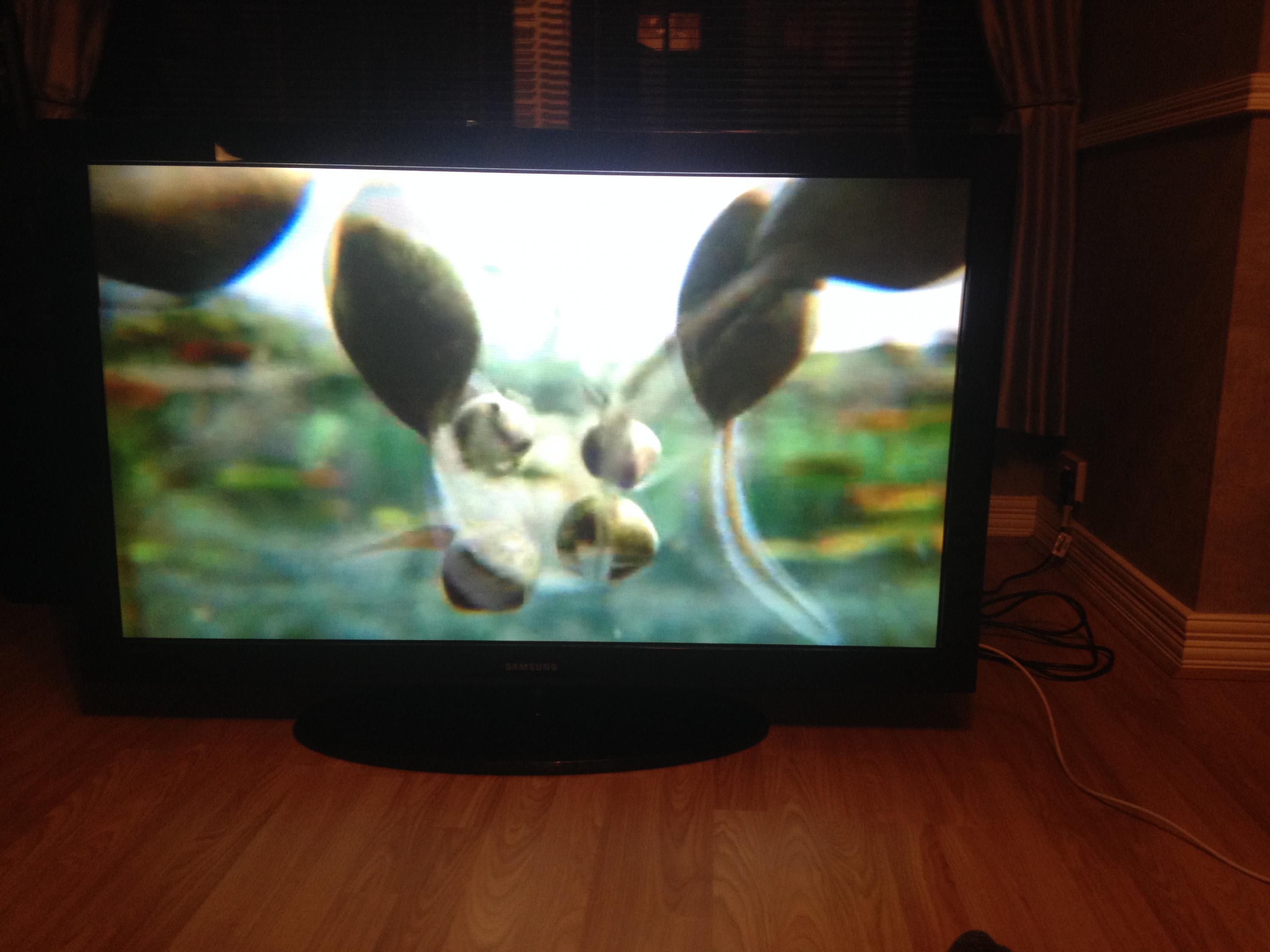

    hi guys
    thinking of buying this tv, what do you think the problem is,

    Re: samsung 50 inch lines on screen
    Prob control-board....
    TELEFIX
      agreed.

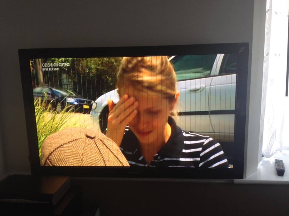

        these line come and go, just found out, but still waiting for model number,
        thank you
          Loose contact? When its cold these lines show and when it gets warm/hot they dissapear?
            ok, got it, PS50B451B2W, i'll let you know when ive got it open and had a look
              had the back off, checked and reseated the ribbon cables, just in case, but still the same.
              the t-con has a led flashing and is a stable flash,
              flash on, then off for a second, then flash on again, is this correct?
              ive ordered another t-con anyway, i should have it buy the end of the week
                This is OK.
                You could rule the T-con in or out by a quick test.
                On the 4 pin connector, jumper pins 3 & 4.
                Unplug LVDS, when you plug TV in it should jump straight to cycling test patterns.
                If test patterns are bad = definitely control board
                If they are not = more likely main board than control board
                • finntricky
                  • Jan 2014
                  • 449
                  • uk
                  yep, tryed that TOM, and still the same lines on screen while running test.
                  so defo t-con at fault
