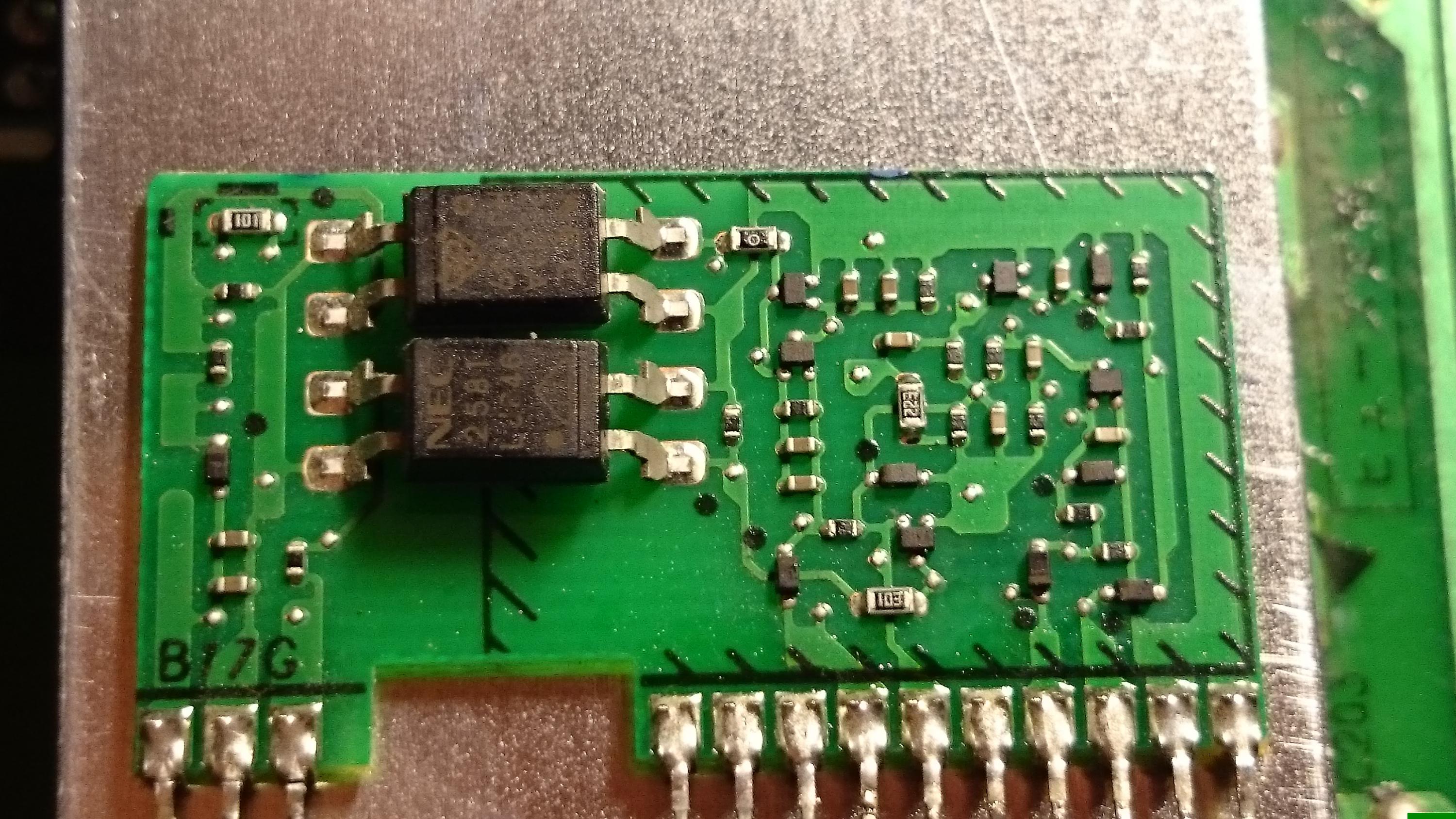

    Anyone know the values of the caps on MC501 board?

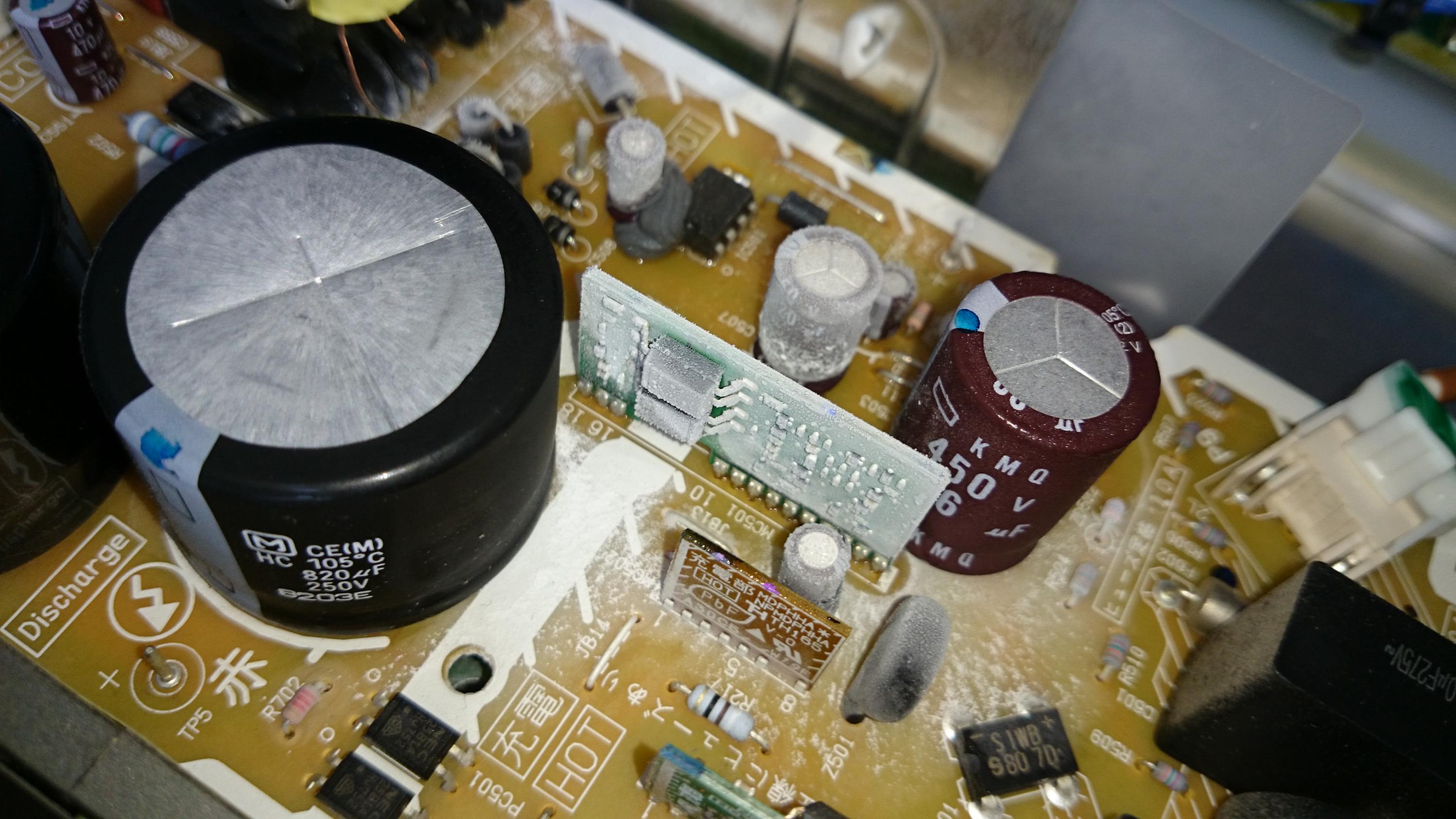

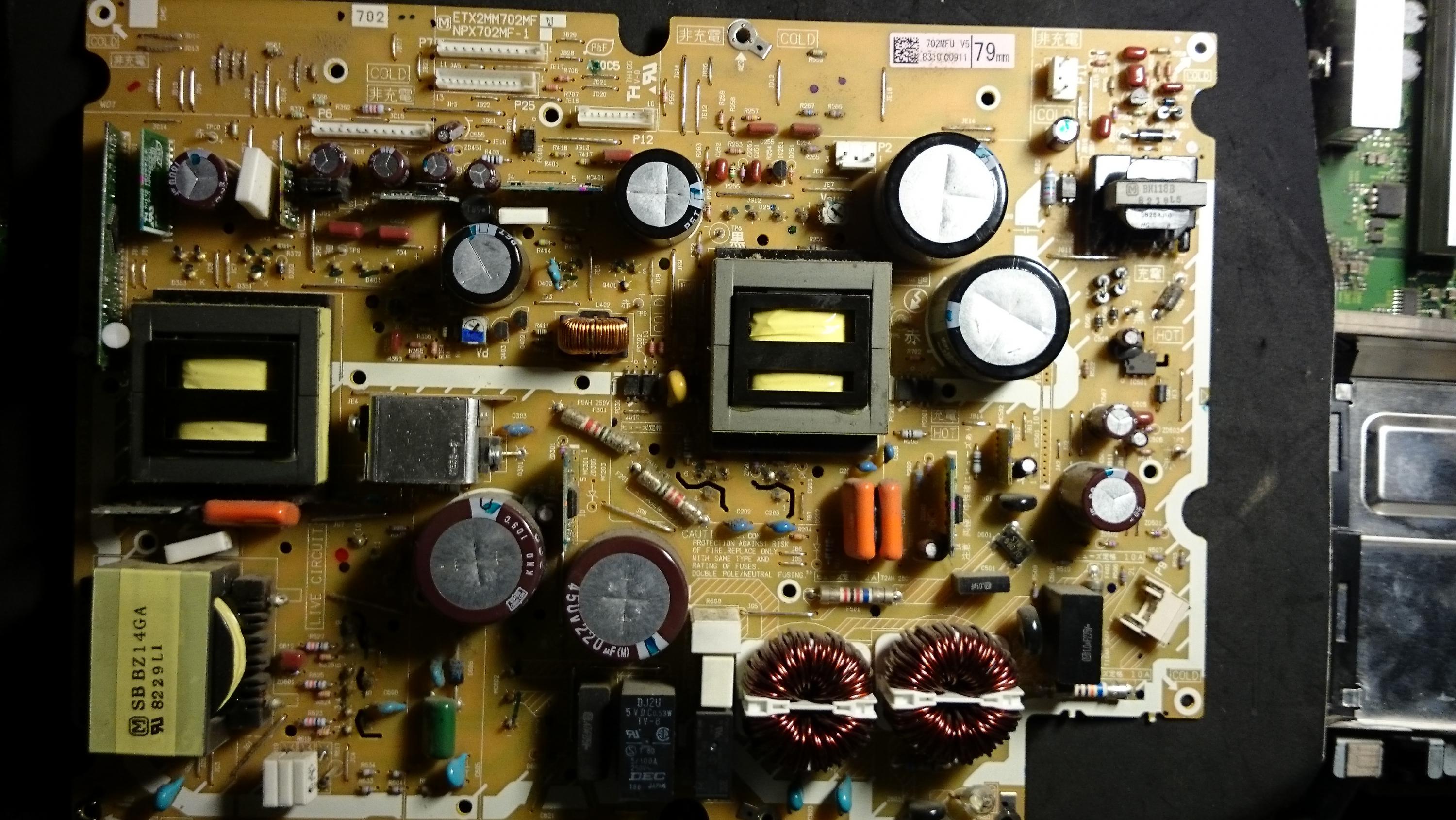

      I attached a picture of the powersupply and the MC501

        I bought some freeze and used it on the mc501. Nothing...

          Here a picture of the mc501 board wich is frozen. It was not possible to freeze just this part only....
