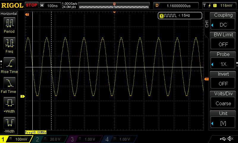

                                #155
                                Re: Panasonic TH-42PZ85E --> Completely dead!
                                I had that one for over a year. It was so intermittent that I gave it to a friend, it worked fine for almost 12 months, I moved it into my room and it stopped working again. Replaced that module and it worked perfectly. It was a strange one.
                                I'll try checking that other pin on my set, on the scope.

                                          #160
                                          PM me, I'll have to check with the post office on the price to Netherlands but it's yours for postage cost.
                                          My set has about 2V at AC_VIN.
                                          I also have a sine clock at bottom outermost (with module installed in board and in TV) of 6 pin silver device on MC701 module. 8MHz. Perhaps worth comparing to yours? This indicates the CPU is running.
