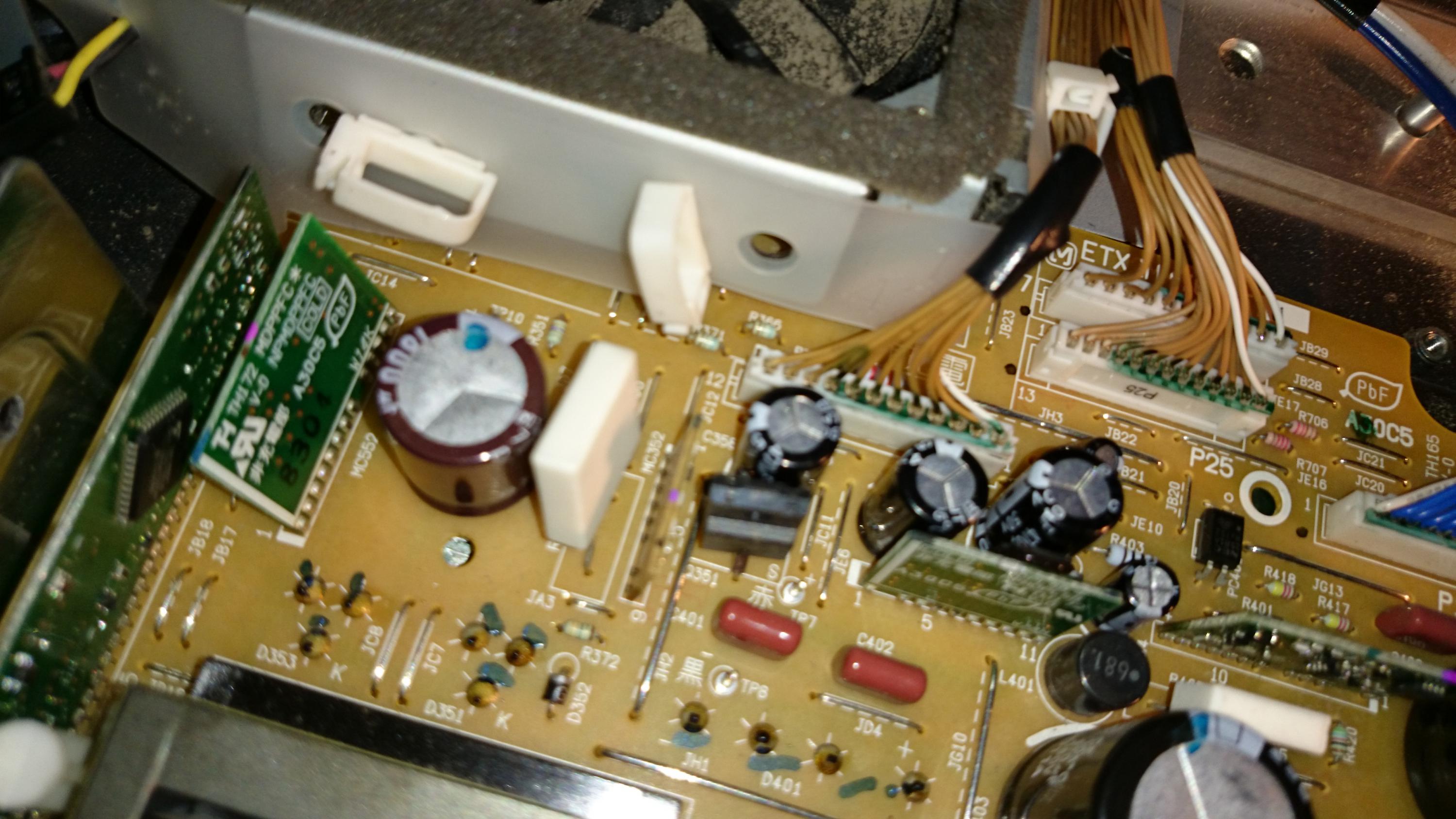

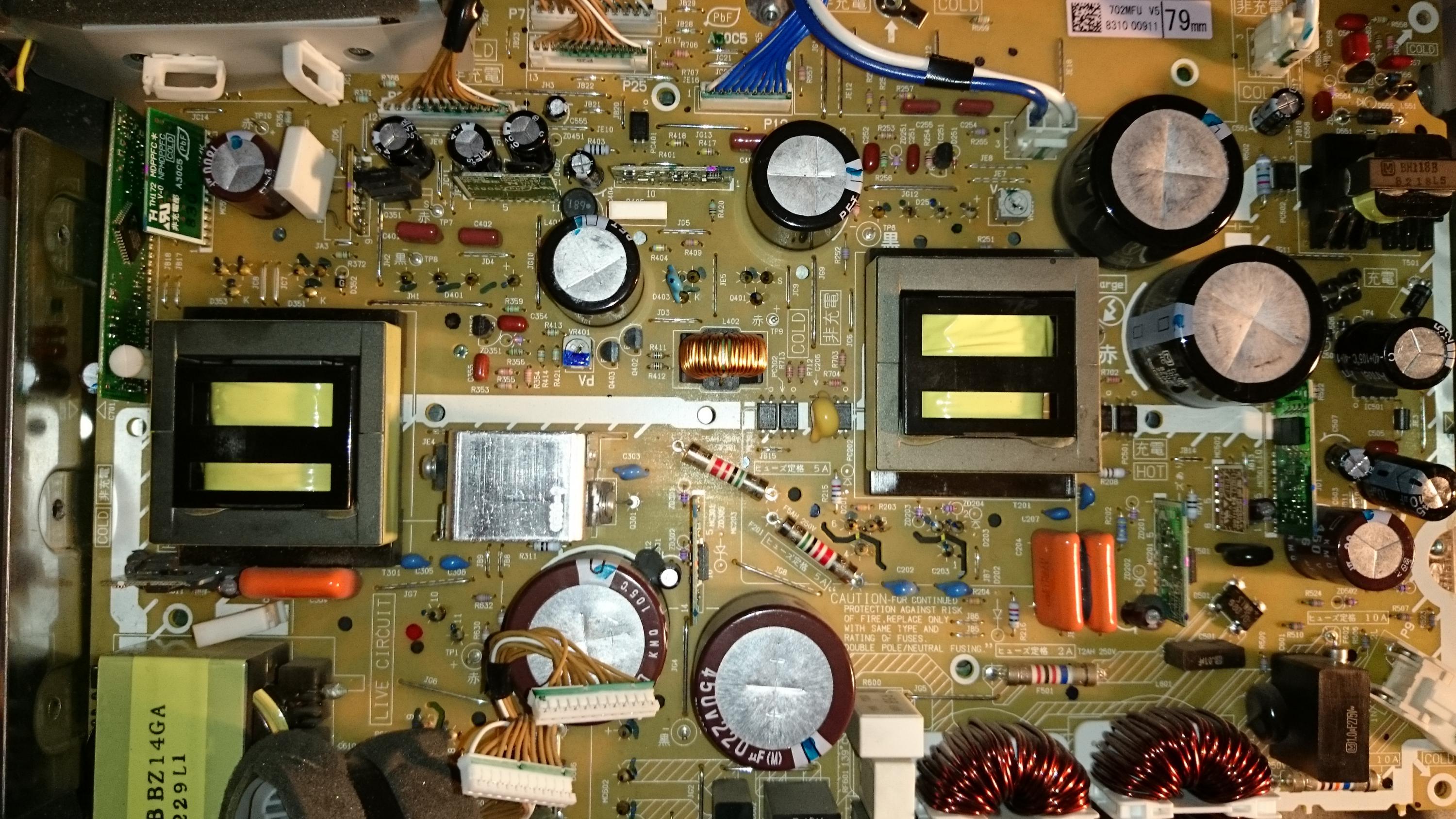

    Well the off values are exactly the same as mine! When i press the power button nothing changes so im missing the 5v OUT from the PS.
    What part is causing this? Can i jump a small wire from pin 12 to pin 9? I dont want to blow up the machine but fix it
      #62
      Re: Panasonic TH-42PZ85E --> Completely dead!
      For some reason your power board CPU is not turning on the output - it is detecting a fault elsewhere.

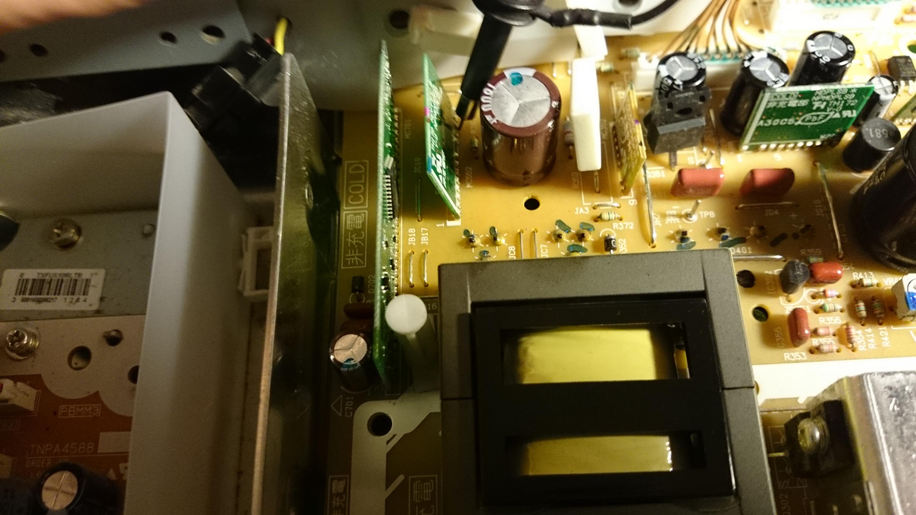

              Yes, that would be useful, get a 1X/10X probe with it, with that you can check AC_DET signal from the MC501 module.

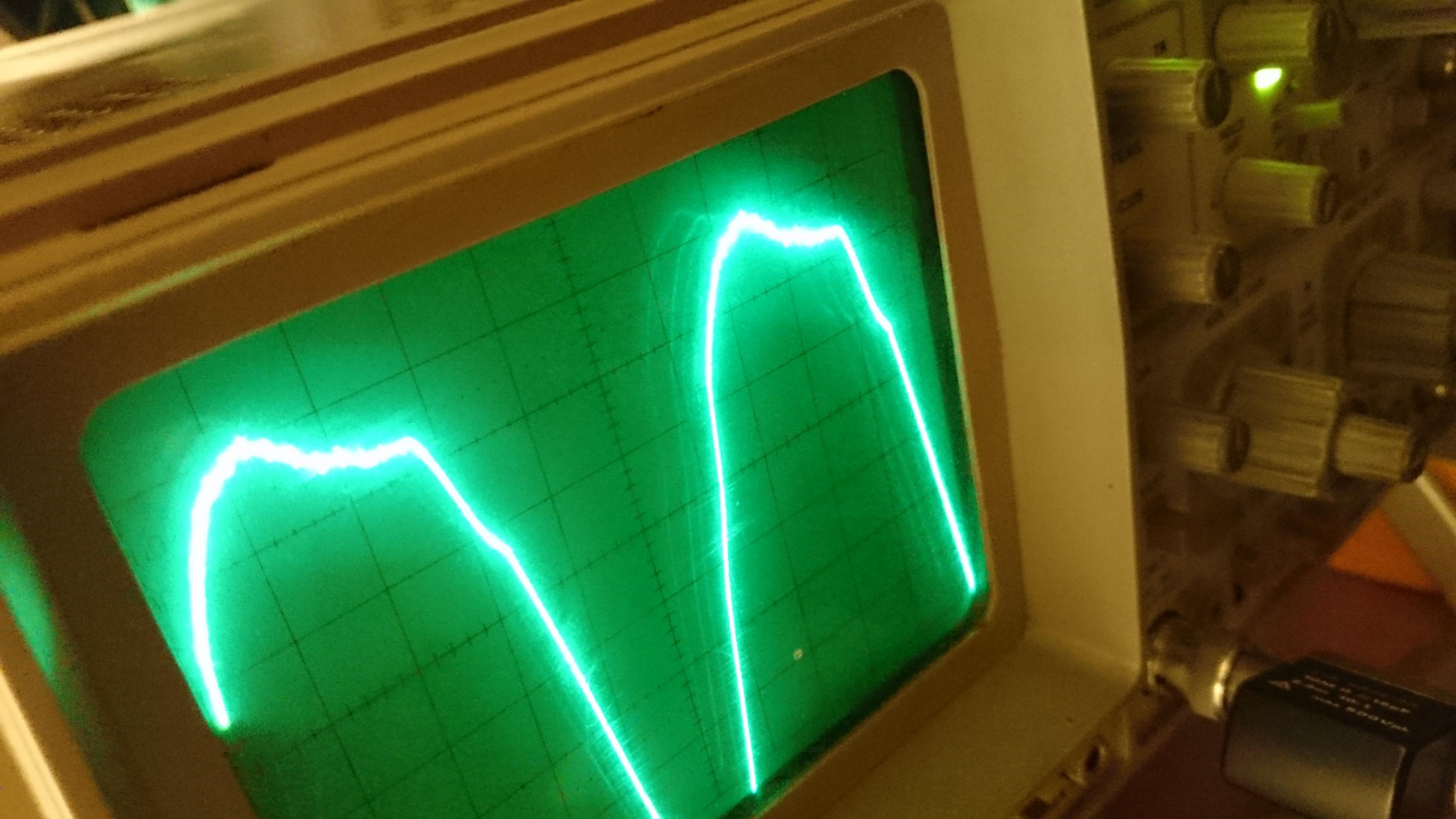

                              Ok i took the hameg scope with me.
                              Nobody uses it so the signal was not that good at first. ( Some static ). Used the pot meters back and forth and the signal is now good.
                              Measured the 2 pins on the front ( 2v / 5v ) and it shows it correctly. I got it now setup that it shows 1v per square.
                              Want me to take some pictures of the power supply + settings scope?

                                Try setting scope to LINE TRIGGER then set timebase to 10ms/div. (Trace will probably start visibly pulsating.)
                                Then probe the AC_DET line from the MC-module... and see what you get

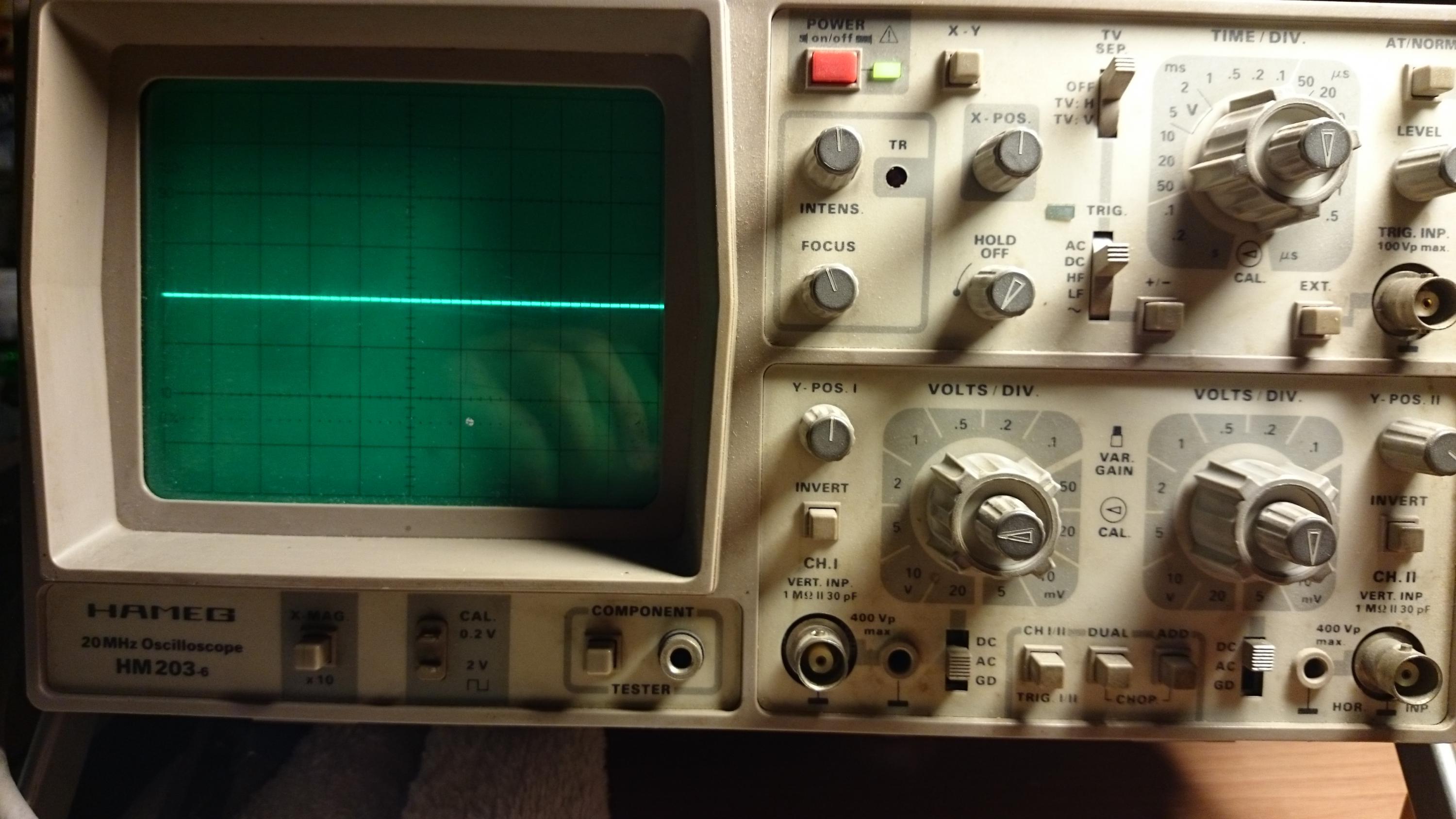

                                    #77
                                    This is the setup, tell me what to do in less technical english haha.

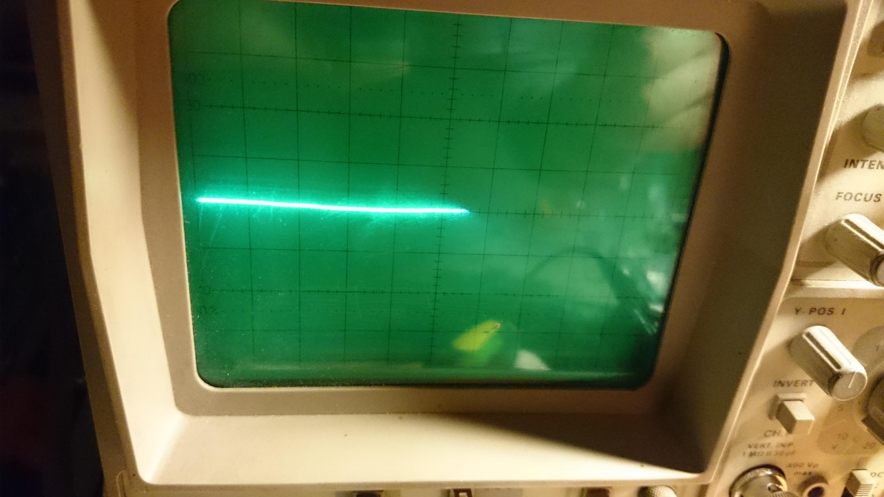

                                      If i have done it right then i get 3 vertical lines on pin 13
                                        #79
                                        Can you get a picture?
                                        • Moreno83
                                          • Jun 2014
                                          • 2008
                                          • The Netherlands
                                          #80
                                          This is how i have set it up.
                                          Picture is on pin 12/13 the same..
                                          Do i need to ground the cable?
