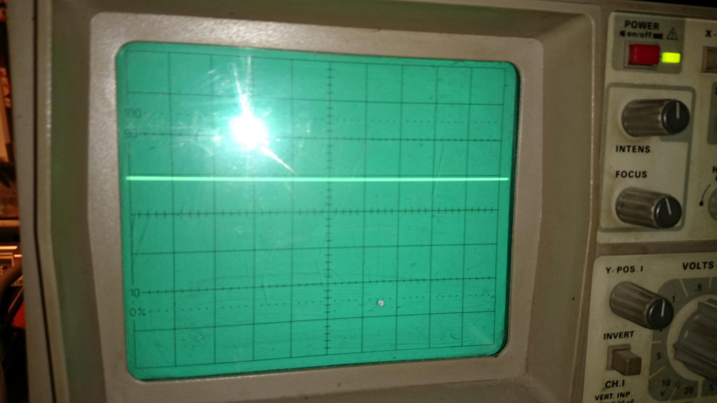

            #85
            Re: Panasonic TH-42PZ85E --> Completely dead!
            The 3rd picture is the default setting when scope is on. LAst pic is when i put the probe to pin 11/12/13

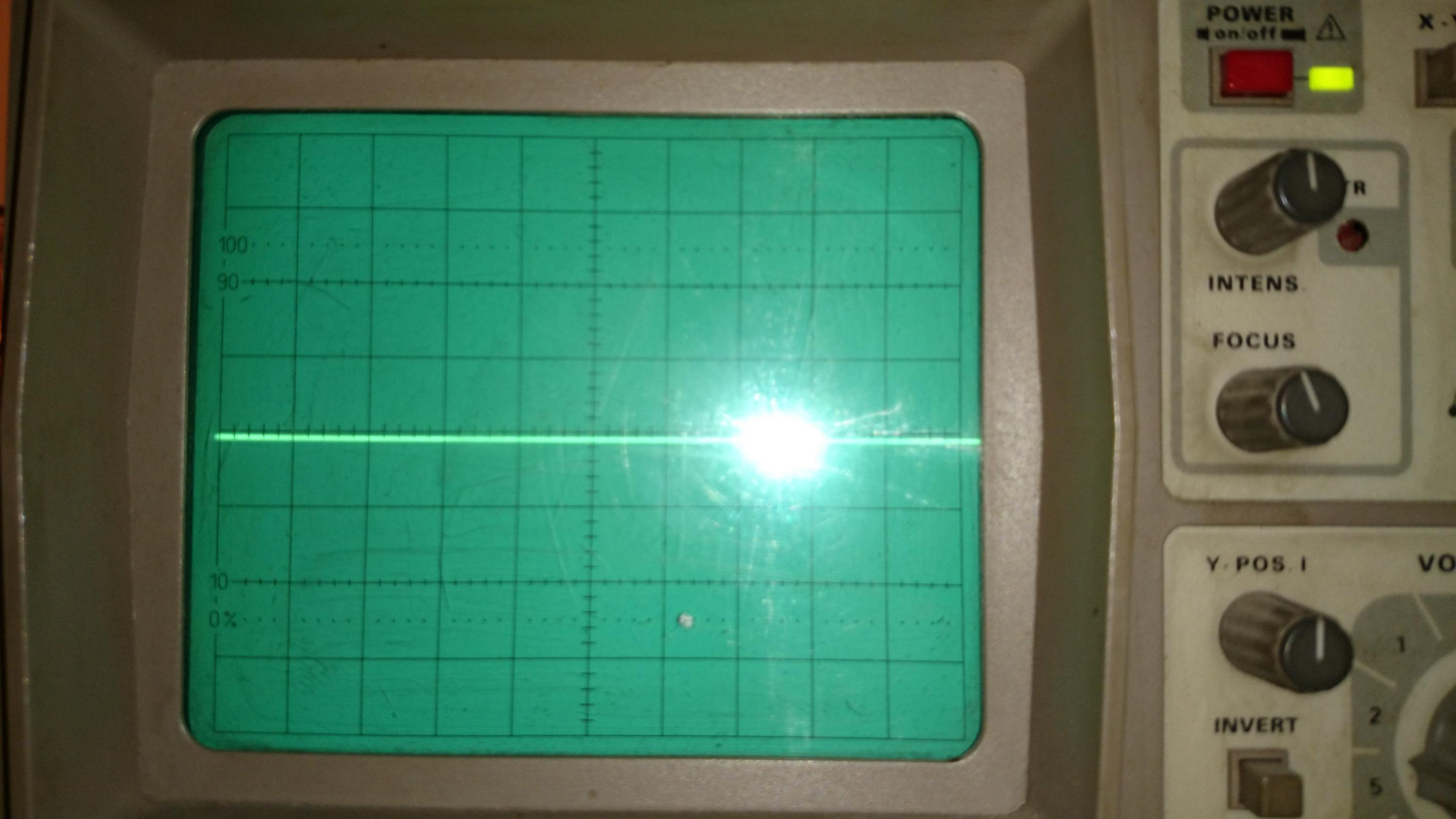

              #86
              Your right, pin 11/13 the line is horizontal but 1 square higher.
              On pin 12 its default horizontal line
                #87
                Is it on 5V/div or 1V/div?
                For 1V/div you may need to move the trace down a little using the V POS control.
                You should now check AC DET signal, MC501.

                  #88
                  Its on 5v/div. I took a picture of the setting so you can see by yourself.
                  First picture of the scope setting is on 1V/div
                  Then you asked me to change it to 5 and thats the last picture. The horizontal line is going 1 square upwards. ( Means 5v right? )

                    #89
                    Again 2 pictures.
                    First is pin 12
                    Second is pin 11/13
                    If i change the time/div it just slows down the signal ( visually).
                    Vpos is set to the middle.

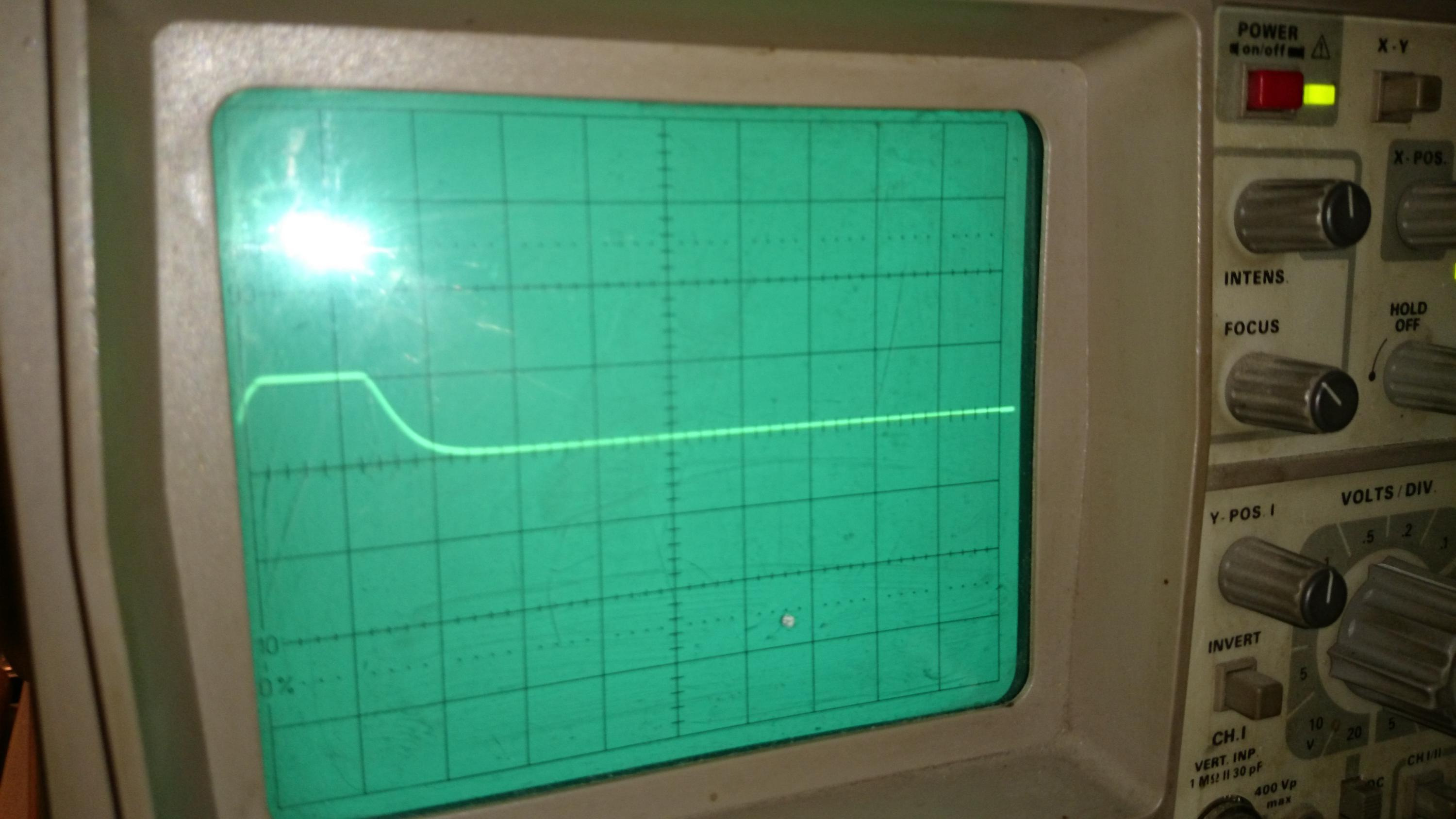

                        #91
                        I searched for ac det but i did not find it sorry.
                        With pin 16 i get this on the scope
                          #92
                          Ok, this means the AC detection is working... So... this is where I draw a blank. Did you try bridging MC552 standby switch?
