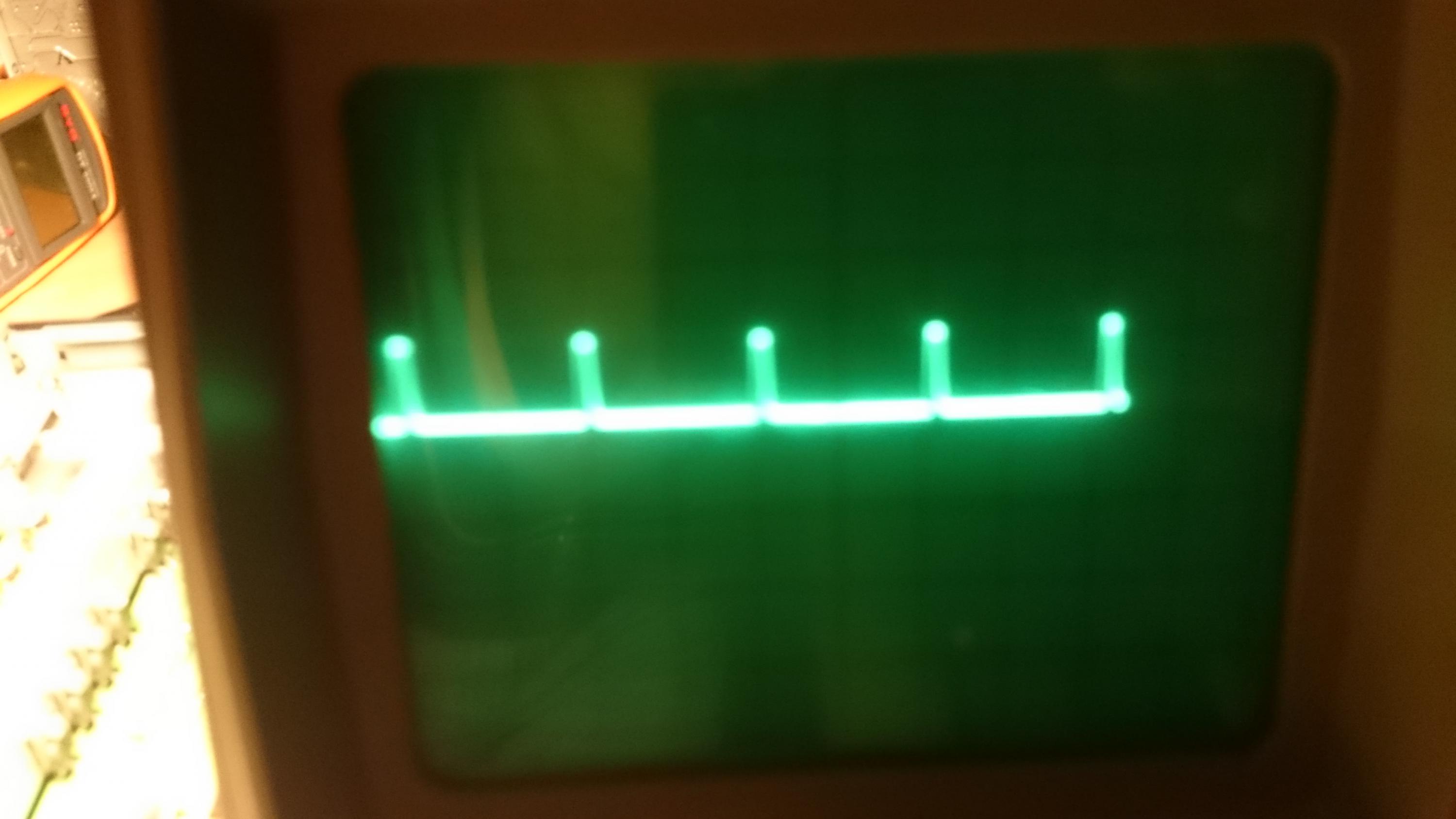

    10ms/div doesn't make any sense if you only got one pulse. That's a pulse only 10Hz, you need 100Hz (one pulse every 10ms)
    No bridges at all, back to the original condition, check AC_DET again.

      Re: Panasonic TH-42PZ85E --> Completely dead!
      Sorry your right. I need to measure it again and make sure that i get 2 pulses so i can measure the HZ

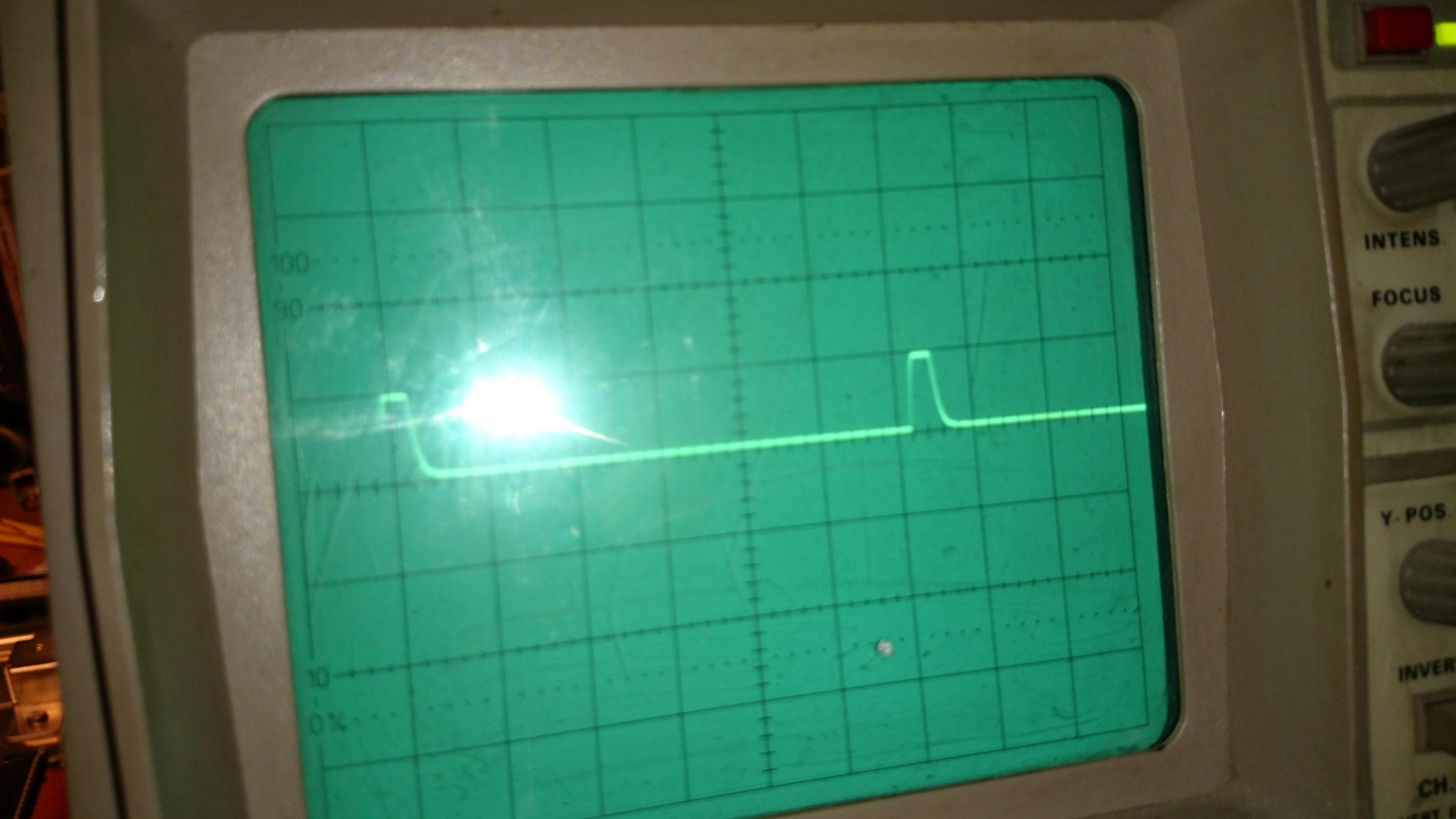

        #123
        So i measured again! Hope i did it right.
        Pin 16 of mc501
        time/div is 5
        volt/div is 5
        Result is in the picture.
        Time div on 2 i only get 1 pulse on these settings.
        If i alter the arrow button i get 2 pulses.

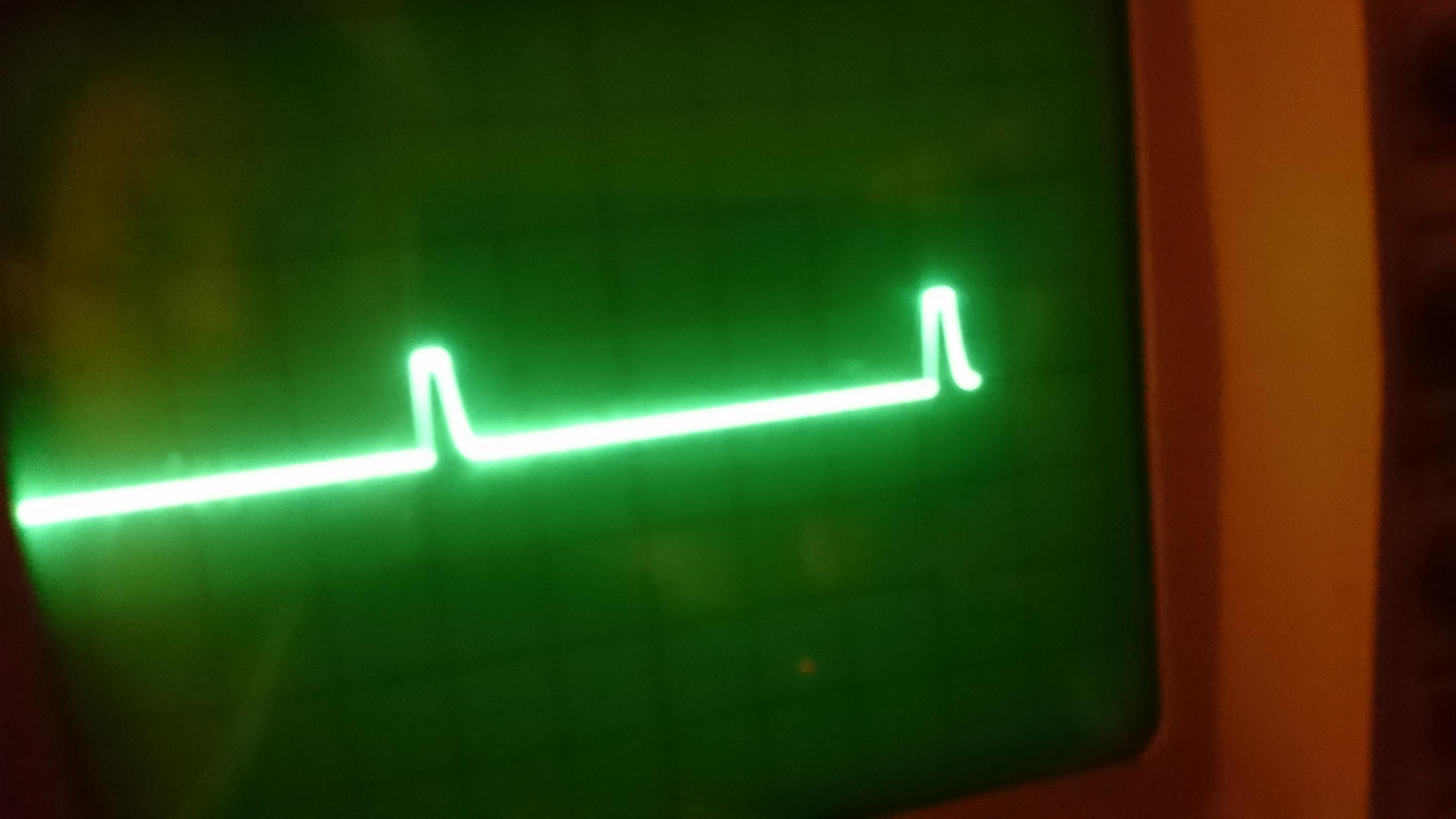

          #124
          This picture is 2ms time div.
          Used the arrow potmeter on time/div to get 2 pulses on the screen.
          Volts div is 5.

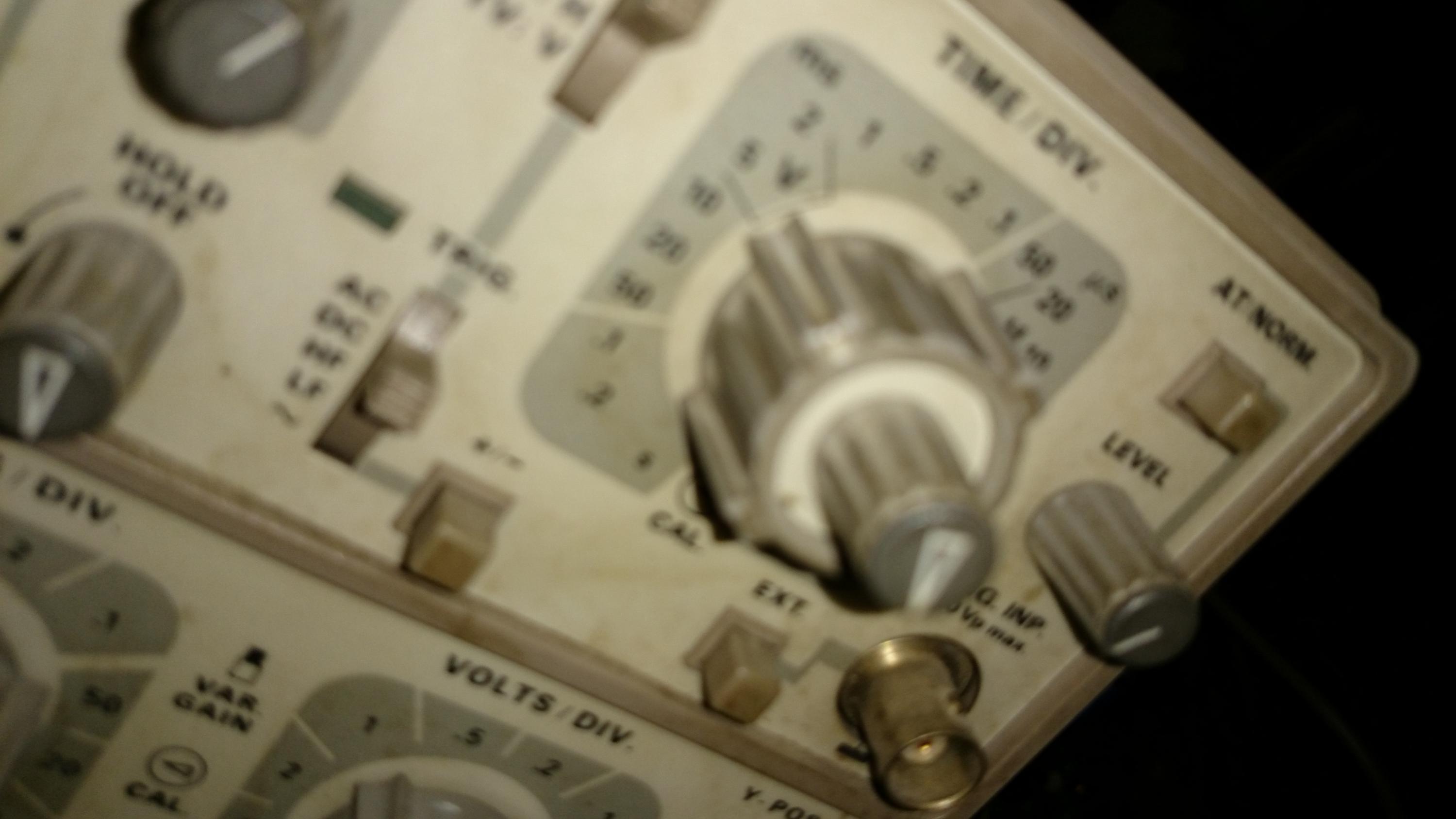

            #125
            Don't use the UNCAL position (the arrow) as it does not tell you the actual timebase. Always switch to a fixed timebase, even if there are more than two pulses and always lock the arrow in the CAL setting.
            (The adjustment is only there for very specific uses requiring a fine timebase and no reference. It is almost never used.)

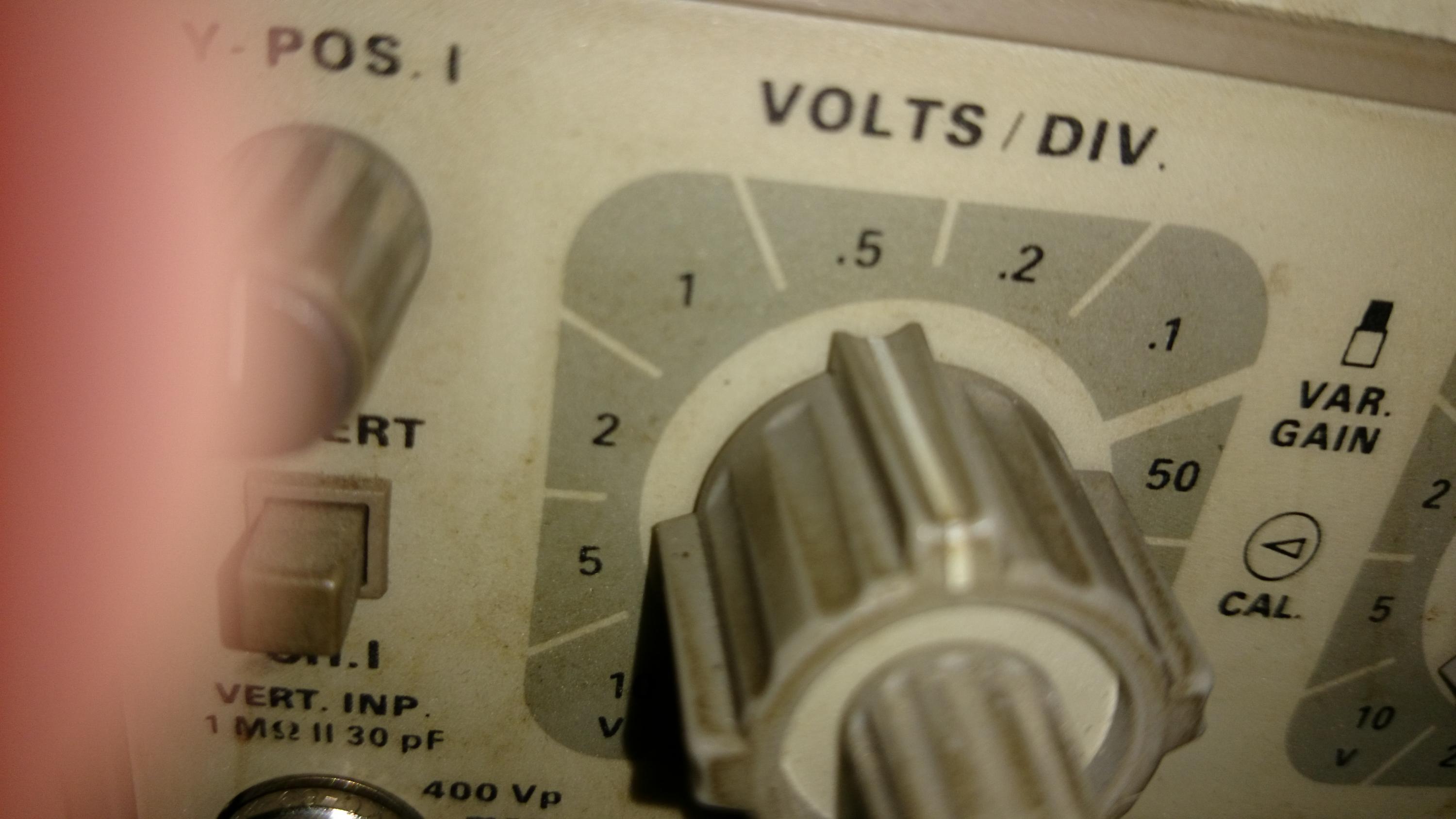

                    #129
                    Ok will measure again! Both arrows in CAL position or only the time/div?
                      #130
                      All adjustable arrows locked in CAL please.

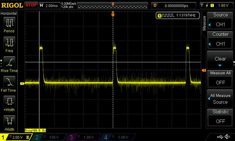

                        Here is what I measured on pin 14 of my set.
                        One pulse every ~10ms or ~100Hz.

                            #133
                            Was that at 5ms/div? So that is 100Hz, as expected.
                            That's annoying, because it eliminates that as a fault.
