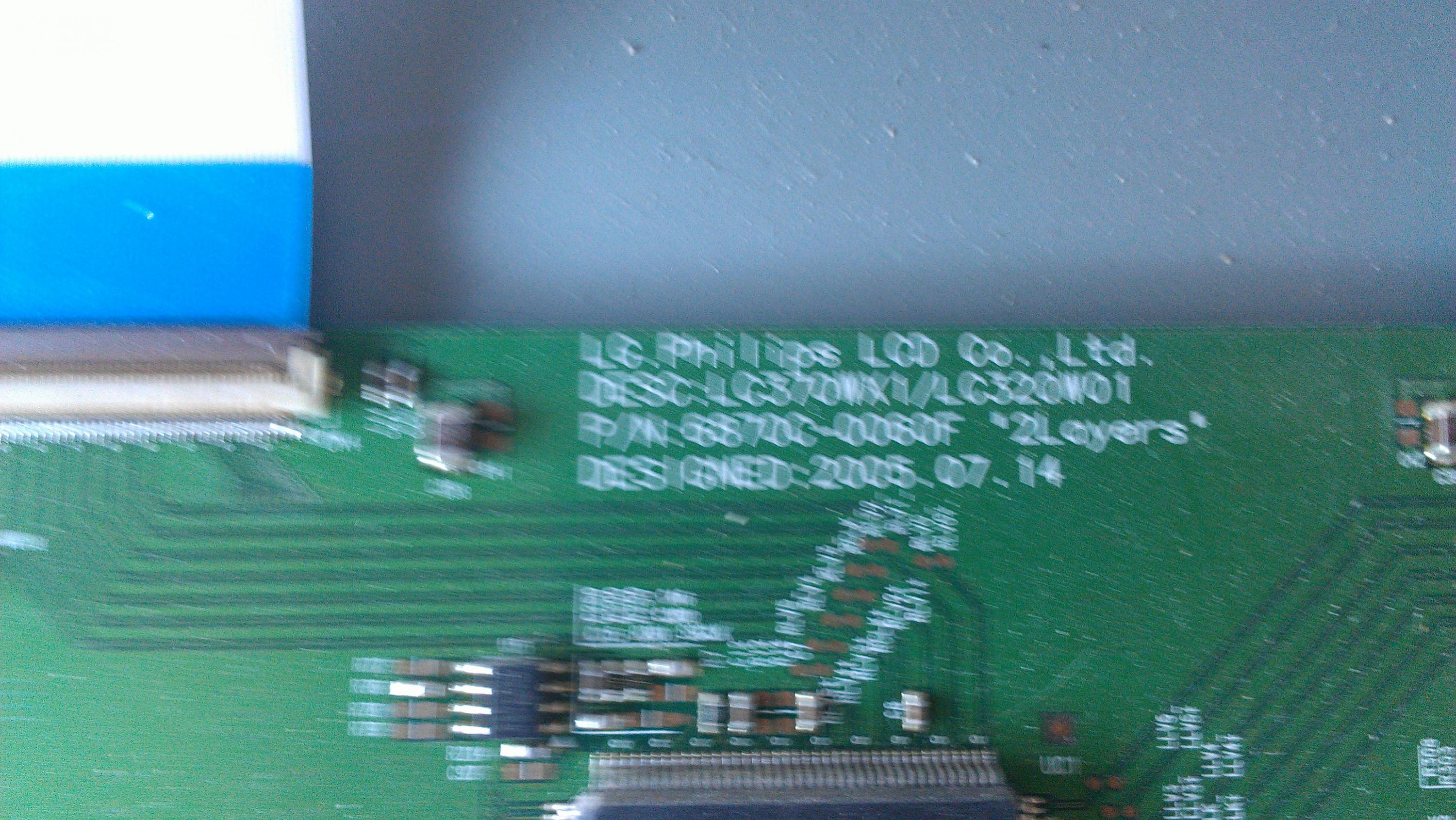

    "Magnavox lc370wx1" are you sure that is the model number of the TV? That numbers are for the LCD Panel model number.

      Re: Philips/Magnavox lc370wx1 (sl) (04)
      thats what is under the cover the actual model number is 37mf33id/37 that i could be and L or a 1

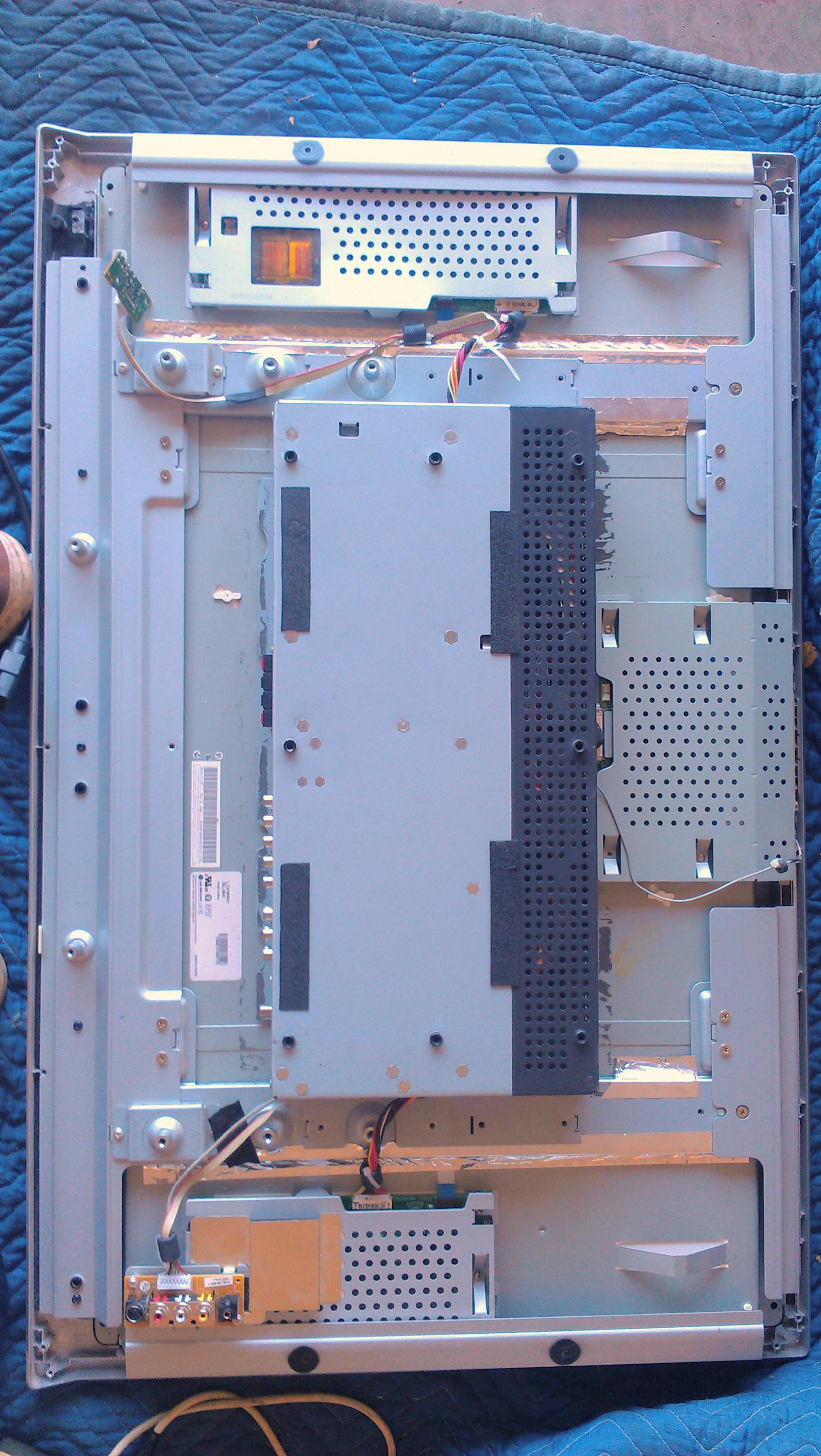

        OK, upload good clear pictures of the back side of the TV so we can see all the boards and how they are all connected together.
          here you go

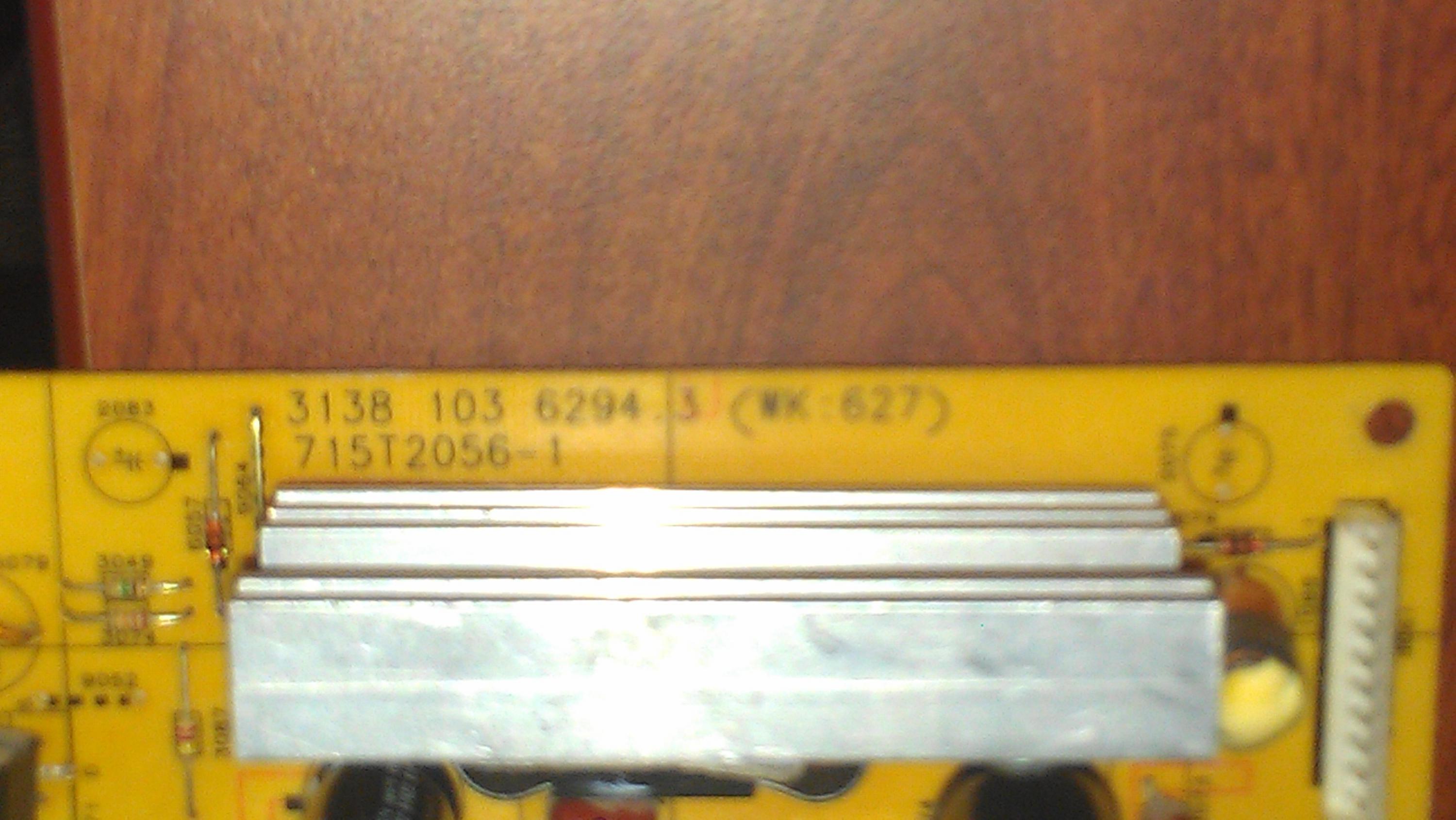

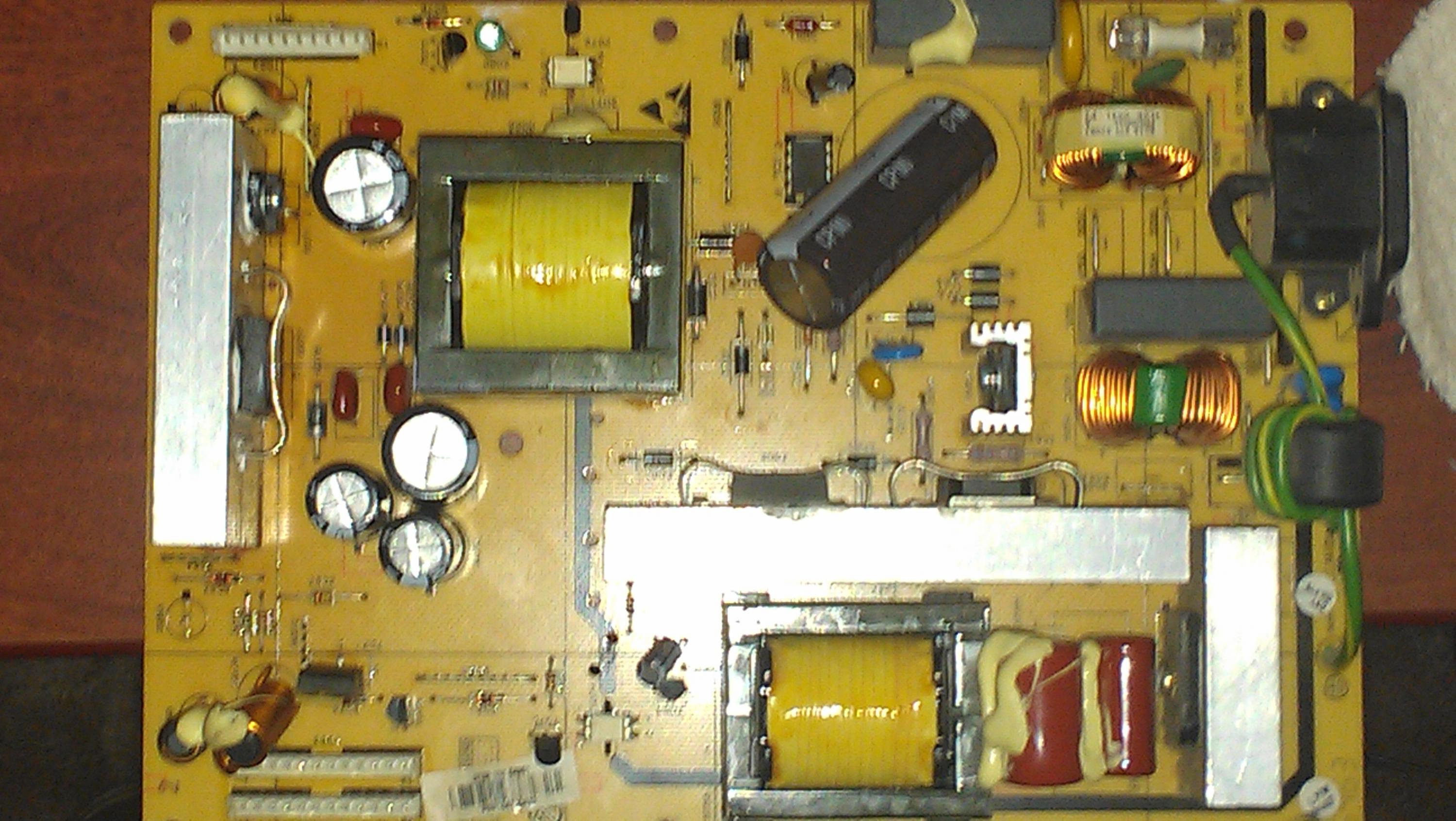

            OK, the picture of the power supply board, please.
            BTW, 45V cap rating does not sound right.
            We need to check the 24V out put and the dimming control line feeding the inverter board to see if they are steady.
              sorry your right the 2.2uf was 50v I couldn't find a fat stubby cap so i replaced it with the long one you see on the board 180uf 450v

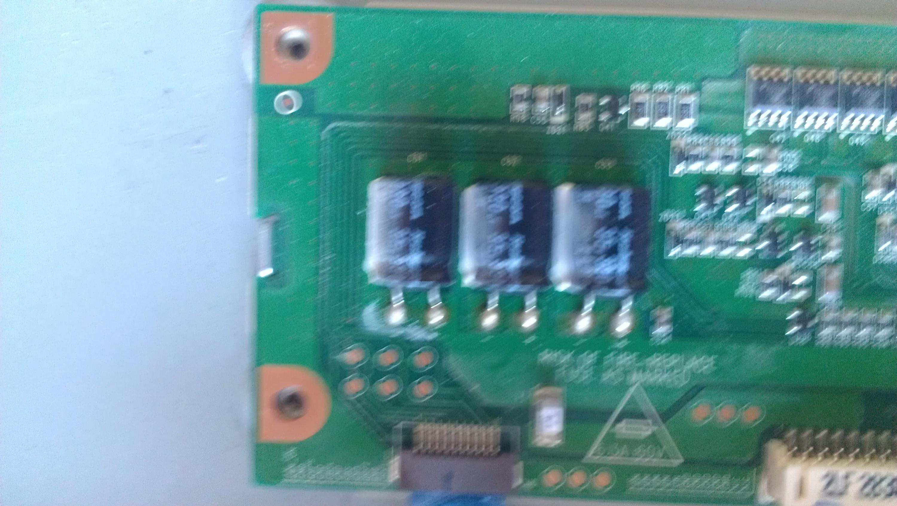

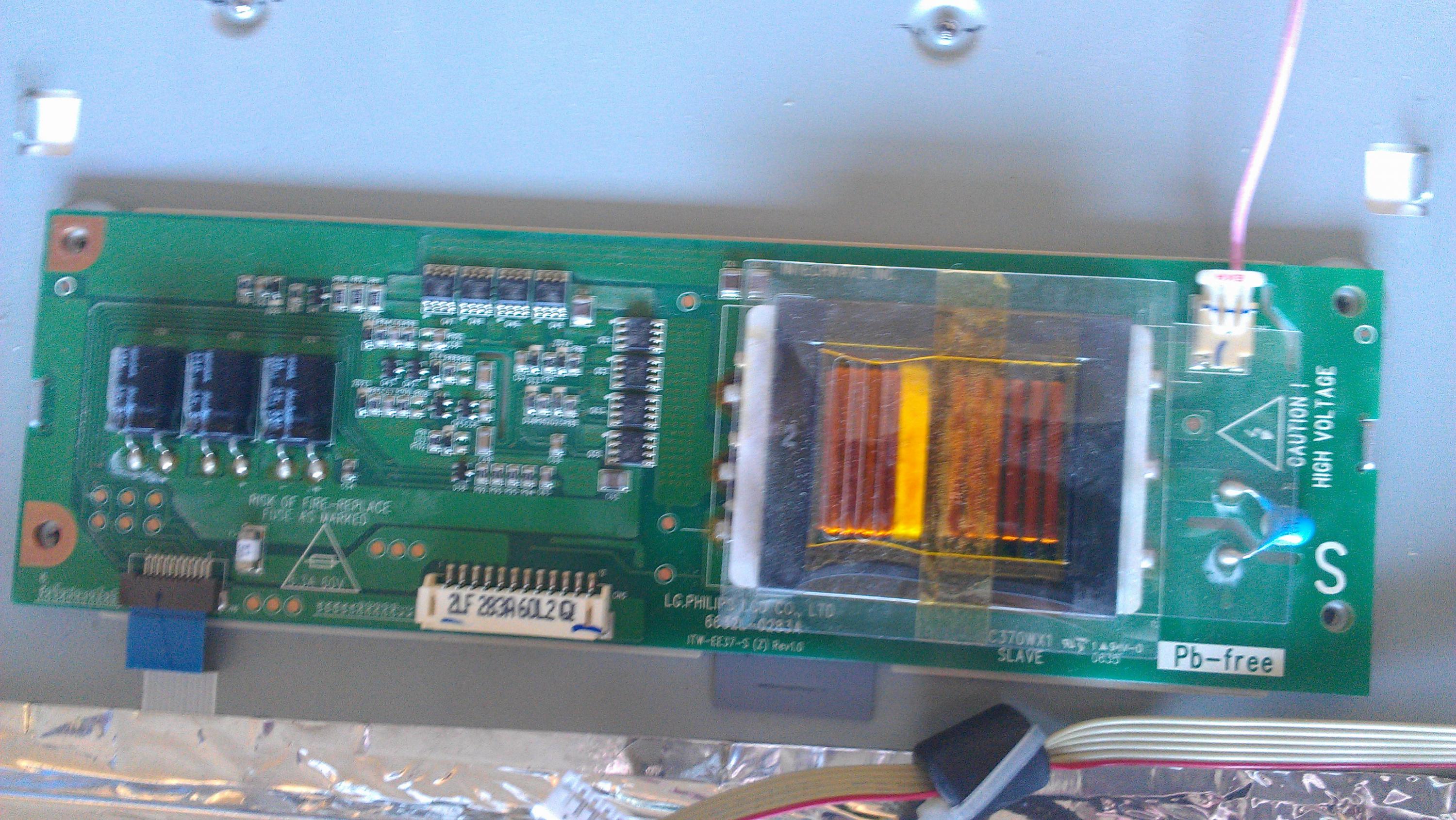

                I forget to ask the pictures of the MASTER and the SLAVE Inverter boards so we can see the pictures of the caps.

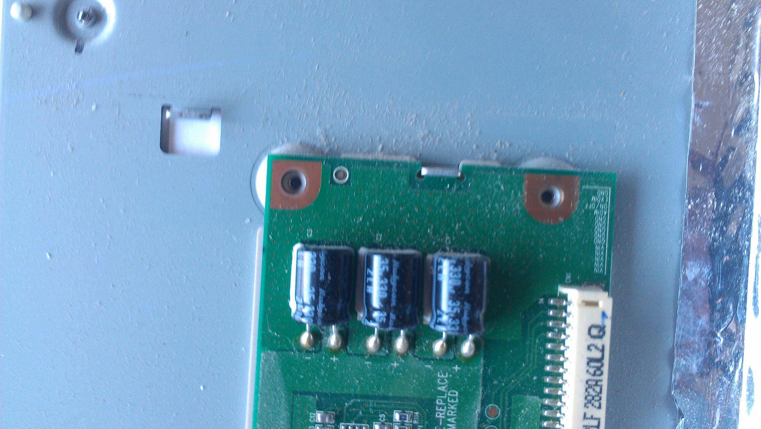

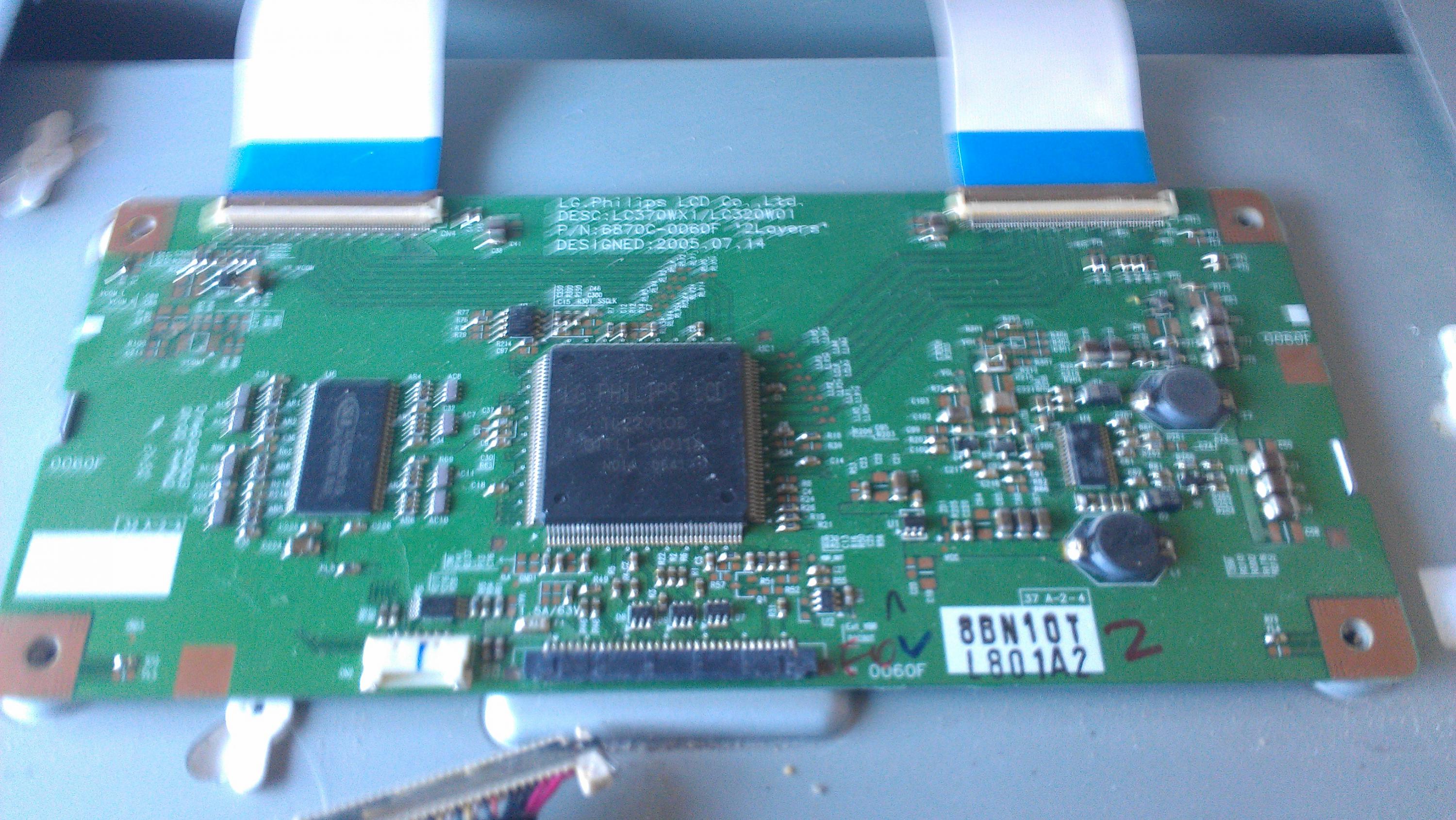

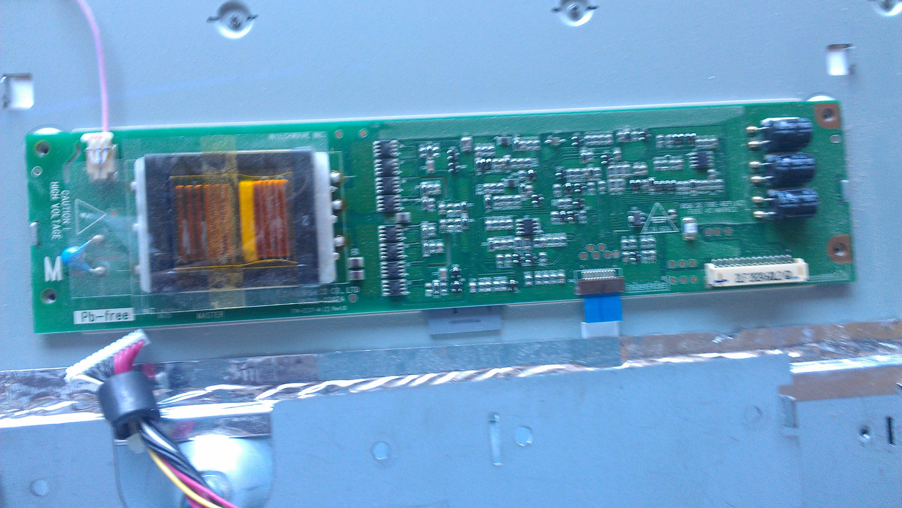

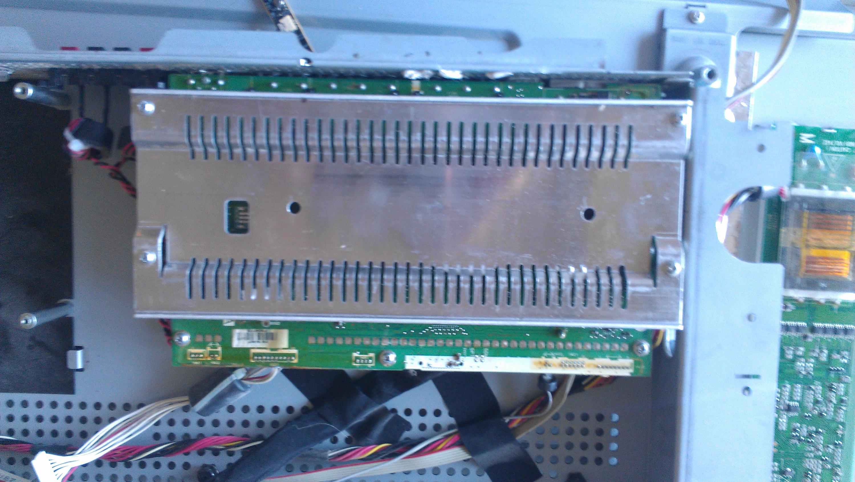

                      first pic is of the master 2nd is the caps 3 is slave 4th is caps 5th is the logic board i believe and 6th the part number and of course 7th is the amp
                              I see 3 caps on each inverter board, you should replace them unless you have ESR meter to verify them.

                                    The blue light on the master inverter flash for a second to blue then goes out at the same time the power button light goes out
                                      OK, that is more than one problem, but I thought you do have backlights but flickering.
                                      I also need the P/N on the inverter board, the pictures of the boards are not clear for me to read numbers, it looks like 662-0283a??
                                      So to get the backlights, we need to find out if it is getting the control signals BL_ON & dim, and 24VDC or not.
