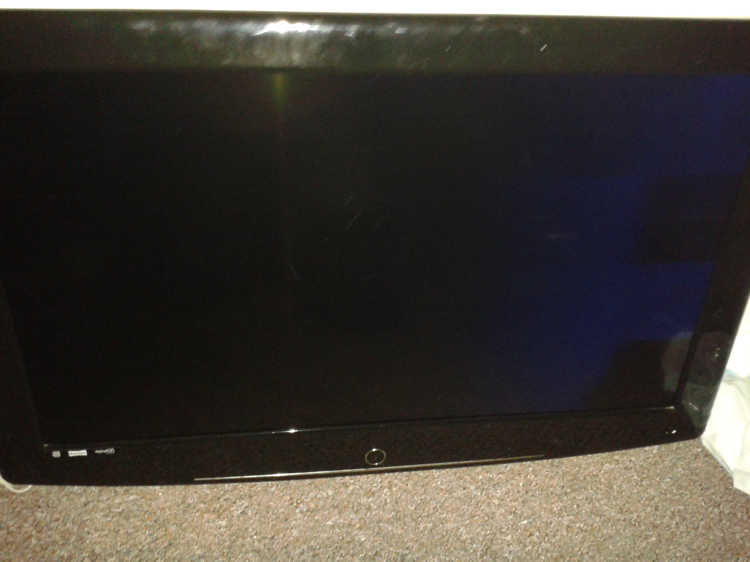

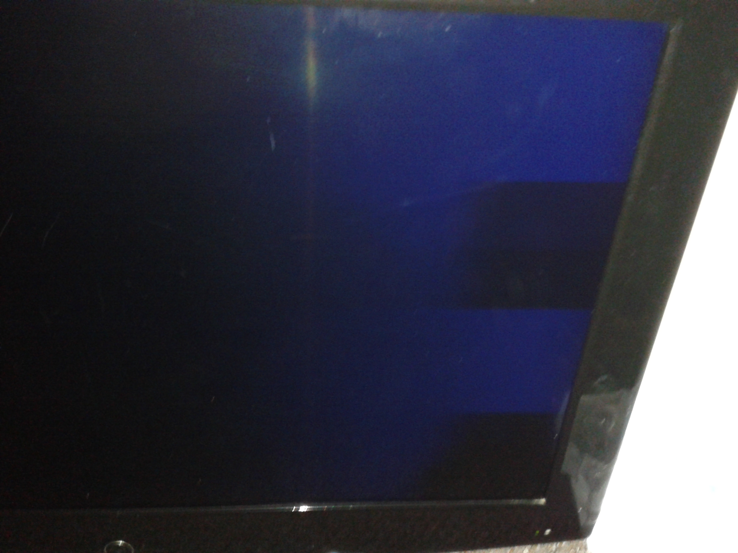

    As you can see from the photos i have attached. The tv comes on fine, but there is only part of the screen visible (the blue bits) and the rest is dark, i can see the channel name (HDMI 1) drifting around the screen so i know its showing but i can work out whats wrong.
    Any ideas?
    Thnaks
    Re: Digitrex CTF4071A - Screen/Backlight problem.

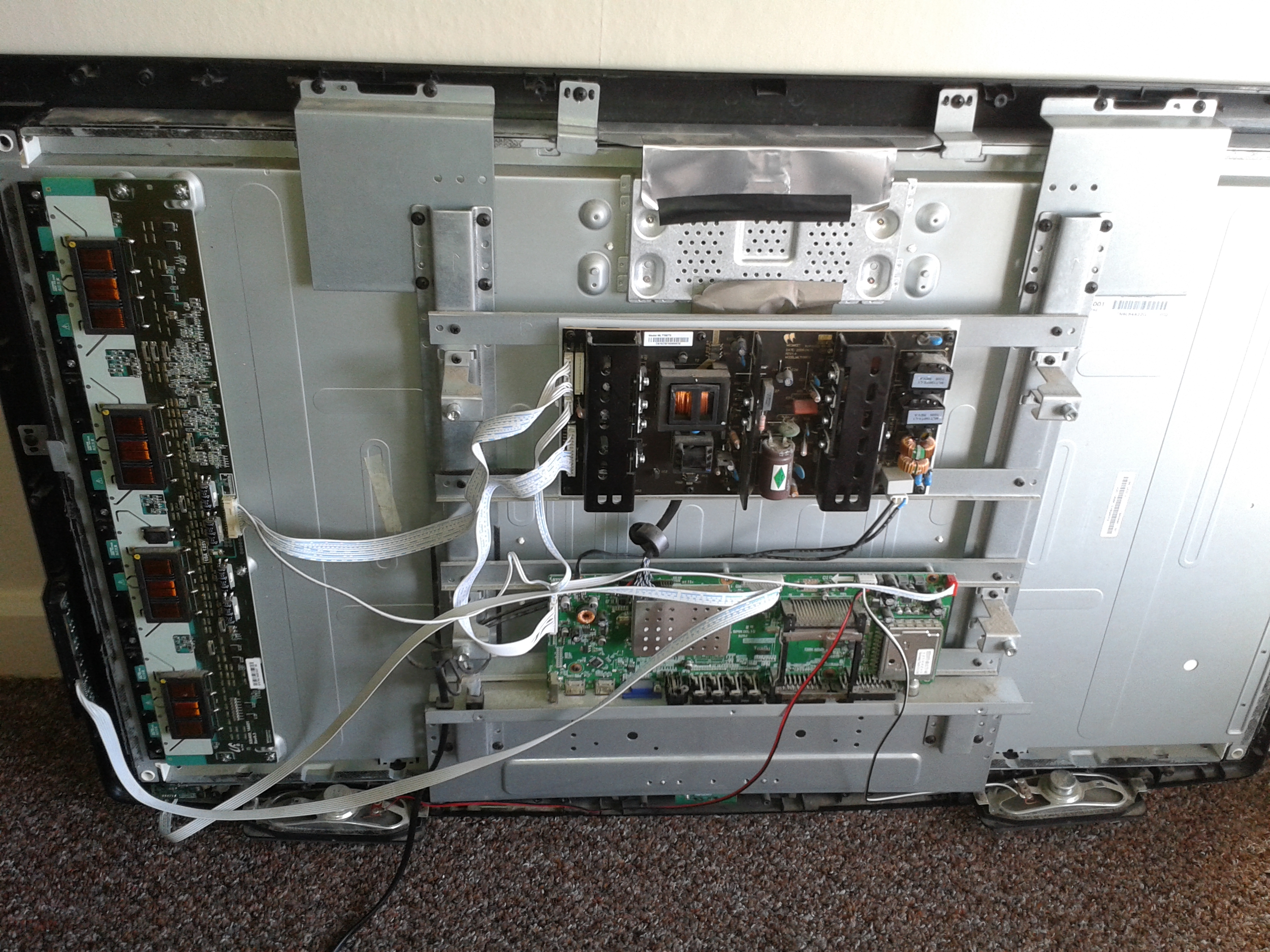

    Possible T-Con fault but also the panel itself suspect.....
    Pictures of the set internally could help....

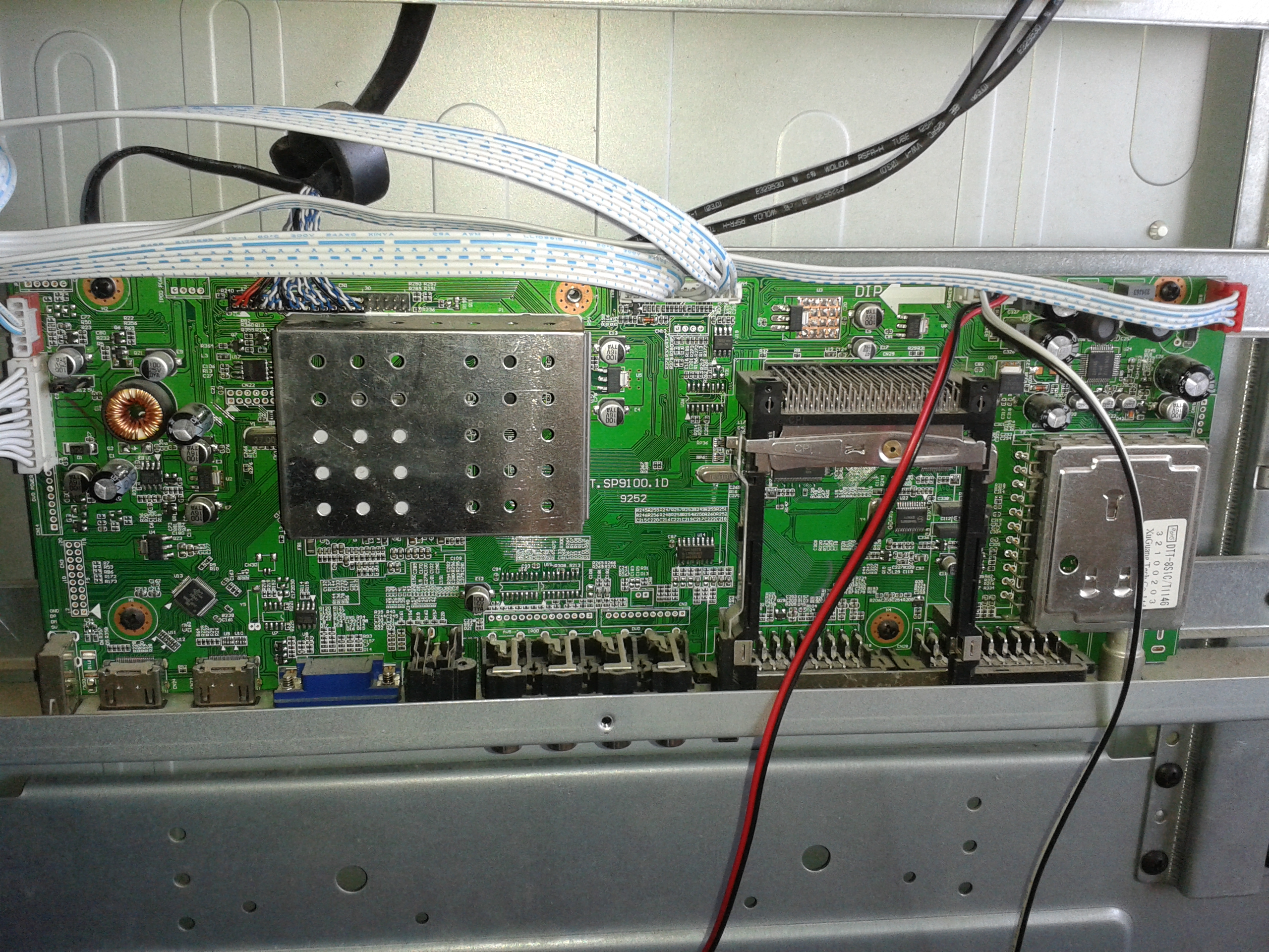

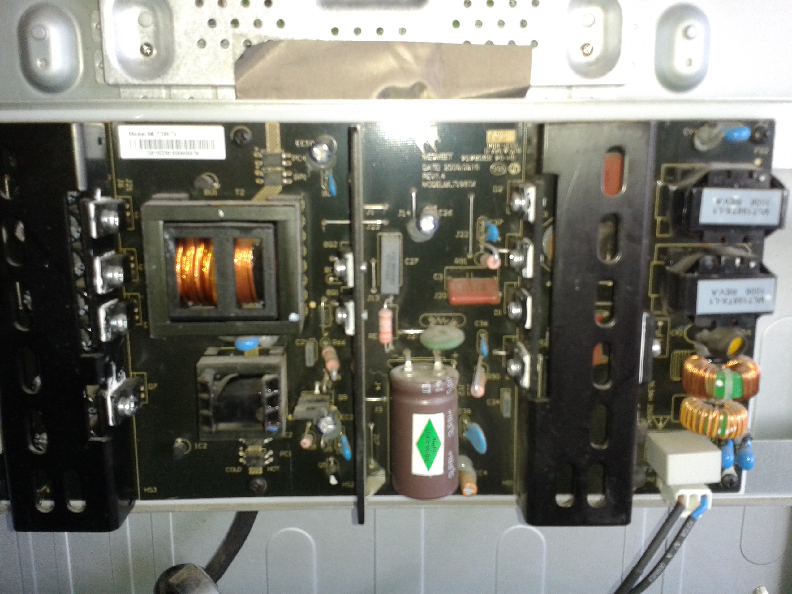

      Here are the t.v's organs. Thanks
        Check in a dark room if the whole panel lights up (backlight)
        I'd say bad panel myself, but hard to be sure.
          Left side does not light up. But shining a torch on the screen shows that the screen is working as i can see the channel number floating around.
            Backlight problem then.
            Check that you have a 24V supply to the backlight board when the set is running.....

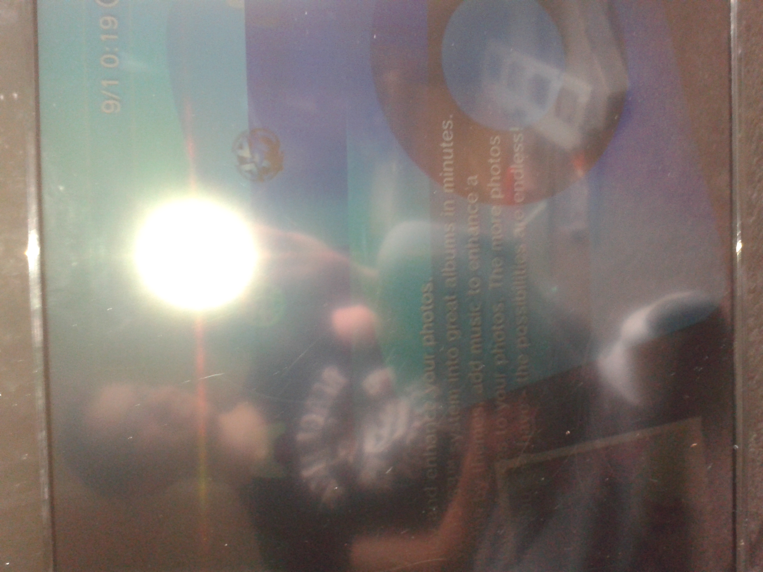

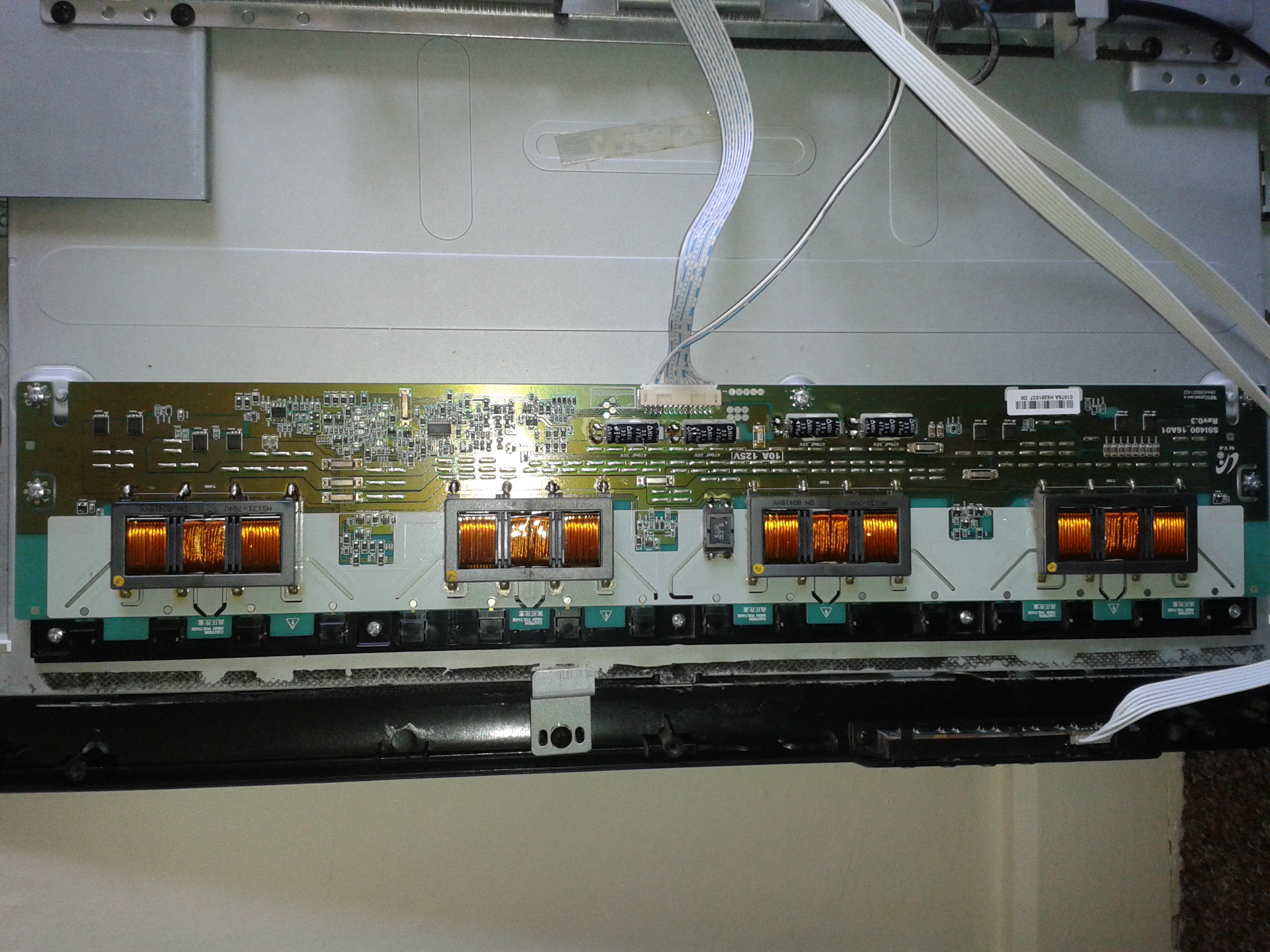

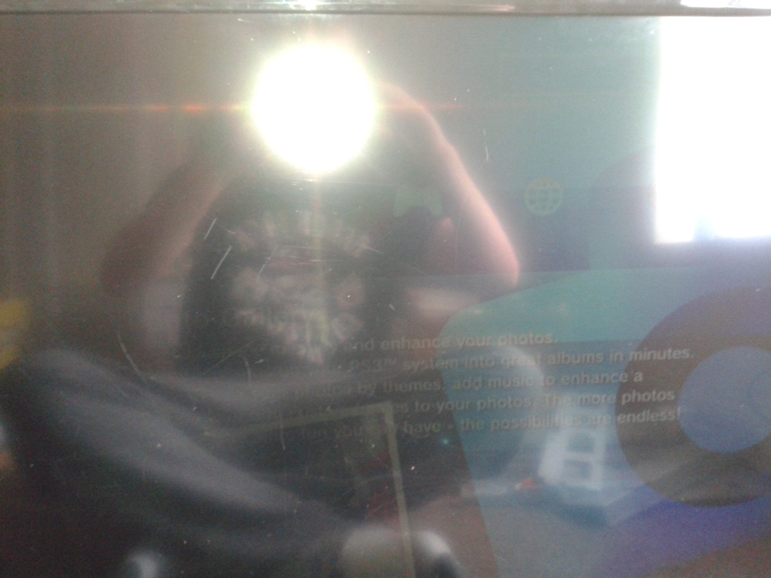

                    Ok. So i checked the 24v and it reads fine, although the 24v/gnd goes to the t-con board? also found out there is no sound, connected the PS3 to the tv to show exactly how much screen was missing, i have attached pics.
                    So like i said, no sound. Dont know if thats the speakers or the board. but regarding the screen/picture/backlight, could it be the Inverter?
                    Would really like to get this tv up and running.
