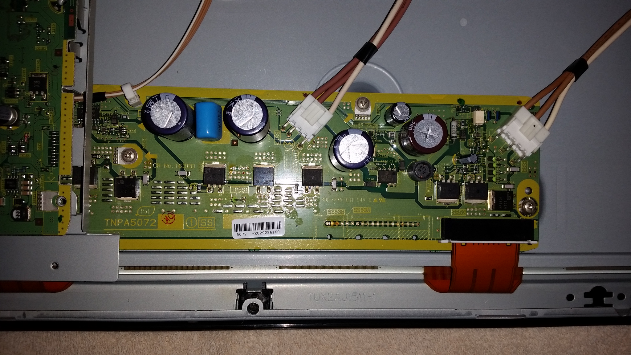

    These also have a common failure on the TNPA5072 SS asthey go dead short and also Sc board, I'd have to do some looking to see what version it is. I have the 42" but it has a SN , combined Sc/sd/su, but also suffers from TNPA5072 failure.

        Before you start tipping money into this, I'd be checking the SS and Sc for short cct at SS11 and SC2,

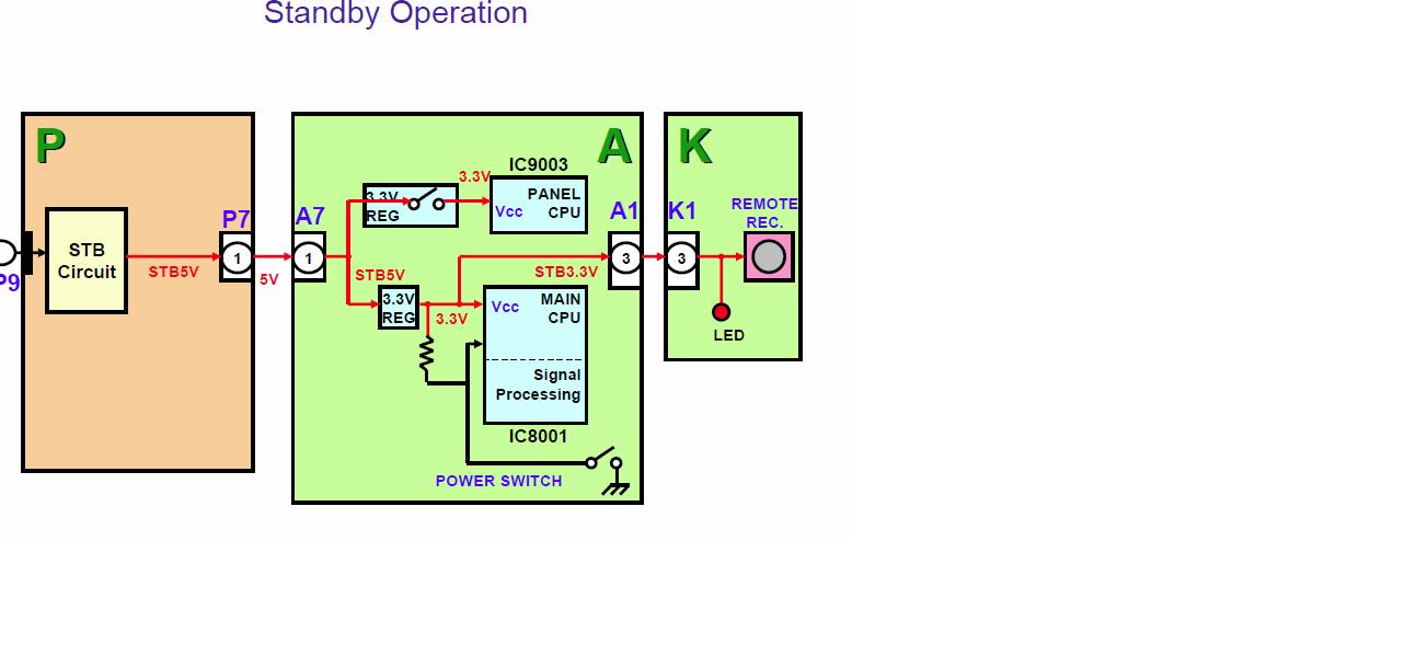

          "When the TV is plugged in:
          AC is applied to the standby circuit in the power supply to produce STB5V.
          The STB5V is provided to the A board via connectors P7 (Pin 1).
          The STB5V from pin1 of connector P7 is applied to a 3.3V regulator to power the Main CPU (IC8001) on the A board. This energizes and prepare the microprocessor (CPU) for program execution.
          The 3.3V from the voltage regulator besides being applied to the CPU, is also applied to the remote control receiver and the power LED on the K board through connector A1/K1 (pin 3).
          If the STB5V is missing, the TV is dead (No power)"
          even if sc or SS were shorted it would not affect this stage, comes into play when the Tv starts, yours is not even able to initialise by the sounds of it.

              If you want , confirm you have 5v at pin 25 of IC9004, confirm no STB3.3v at pin 8, measure resistance pin 8 - gnd.
                I checked and confirmed that 5v is at pin 25 of IC9004. Also, I confirmed that STB3.3v not at pin 8. Lastly, I measured a resistance of 22k ohms across pin 8 and ground. Thanks

                        do you have a way of supplying 3.3v to pin 8 or another spot equivalent in the same cct. maybe pin 8 of eeprom IC9001

                                IC4700, see if 5v stb at pin 7, 3.3v out at pin 8, 1.2v at pin 6
                                  Re: Panasonic TC-P50C2 No Power
                                  I have 3.3v at pin3 on K board going to power LED. I think IC8001 is suspect since it controls the grounding side of the LED.
                                  IC4700 has all good voltages.
                                  IC9004 just doesn't have 3.3v on pin 8, in which is a problem. I applied 3.3v to pin 8 and nothing happened which leads me to believe that IC8001 has a problem as well.

                                    Starting to seem that way, IC8001 does need the 1.2V if that's there yeah that's where I stop, may have to send it in and get repaired

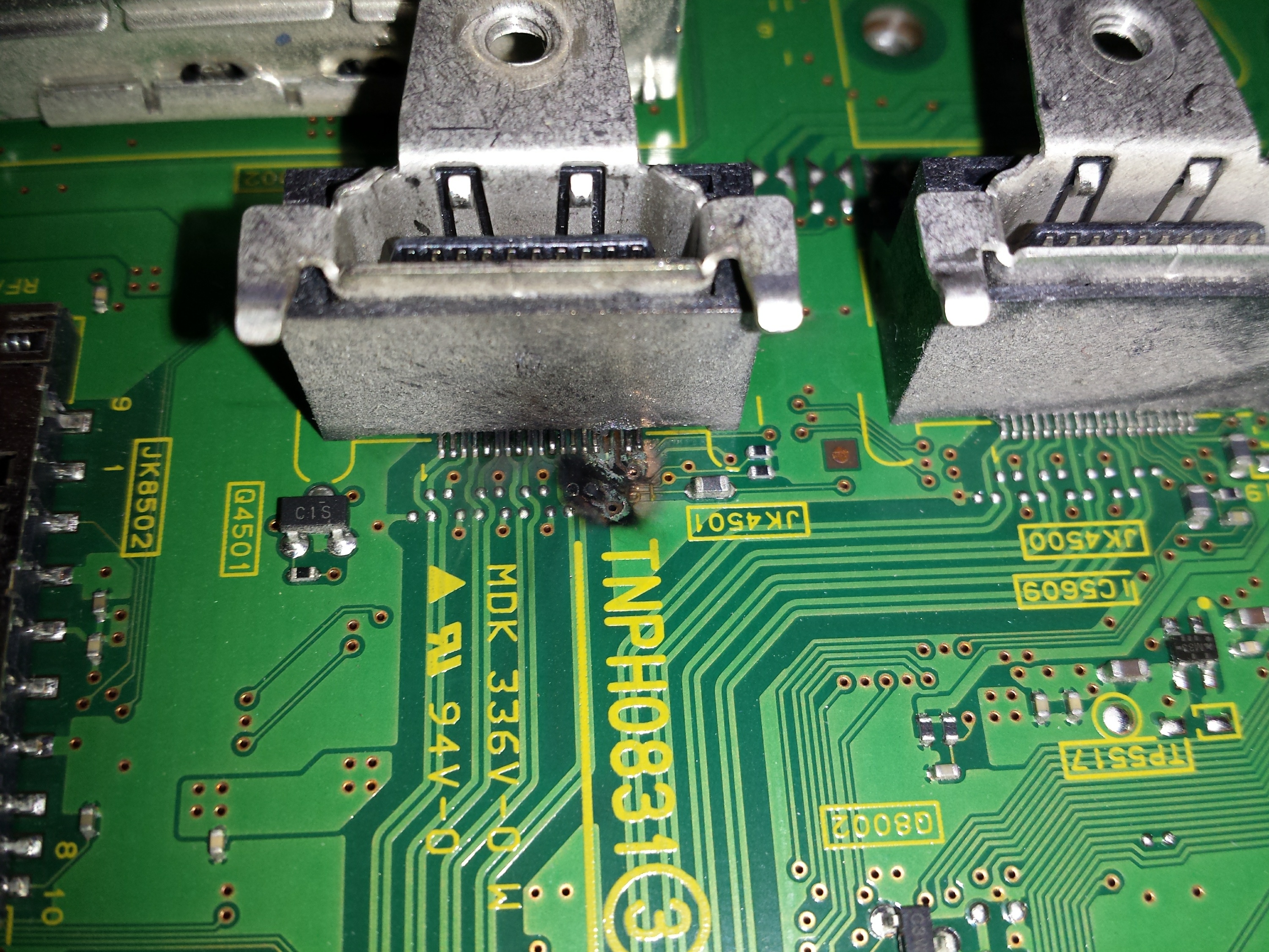

                                        Well, I've identified the problem with mine. Found a burnt spot by one of the HDMI ports. I pulled it and a bunch of pads came up with it. There's so much copper on the board that my iron wouldn't cut it. I ended up using my air wand and the thing just dropped out the bottom, taking the pads with it. Oops. I think the problem was in that big bga chip with the heatsink on it anyway and I have no way to rework bga yet.
