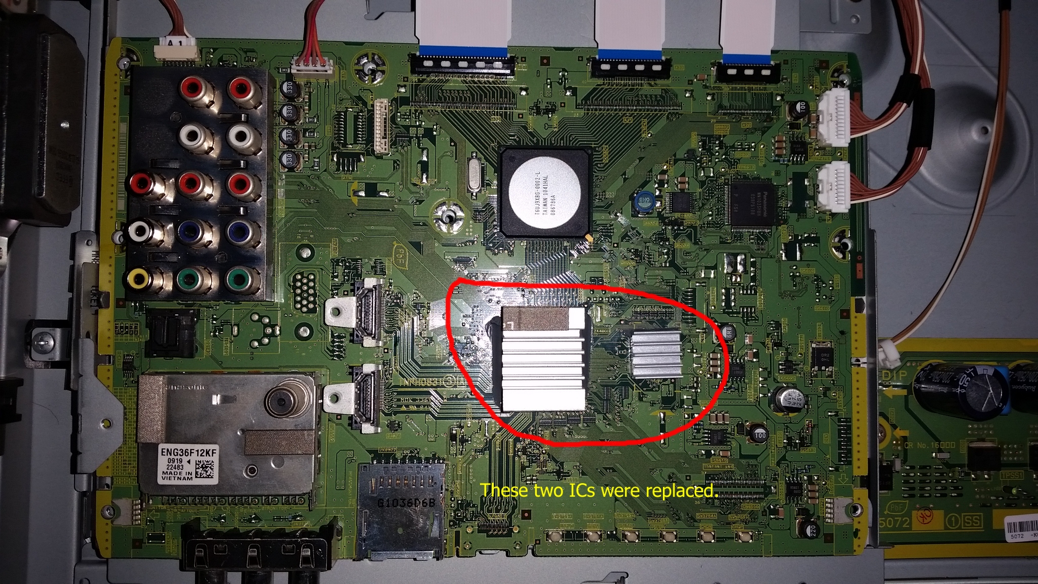

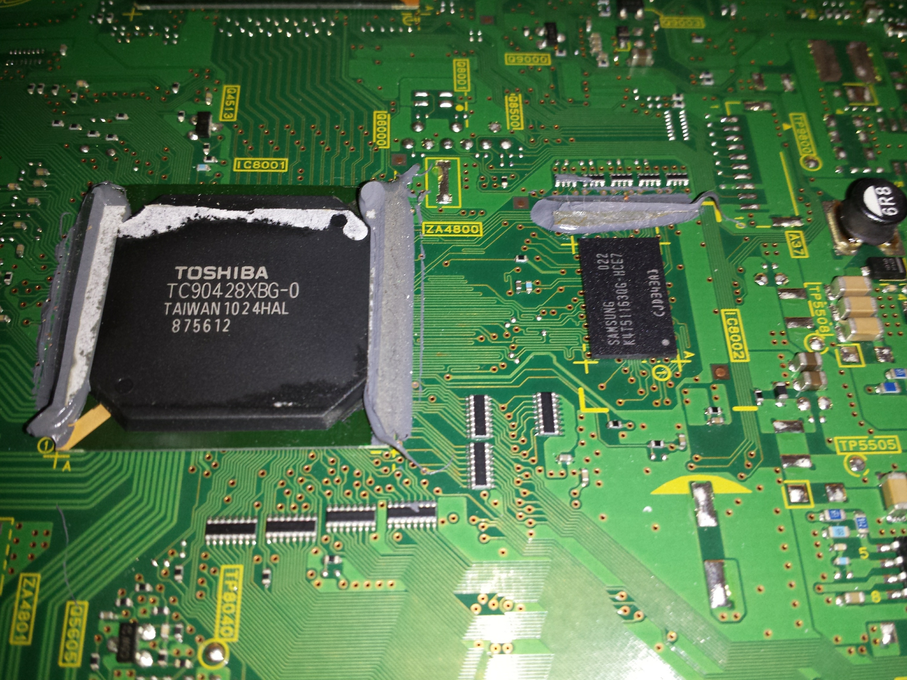

            Re: Panasonic TC-P50C2 No Power
            There were two chips that, I know for sure, were replaced. Look at attached photo.
              Good on you. I think that's where we were heading at a guess it was the main IC in the end.
              Looks a neat job too. What wty do they give?

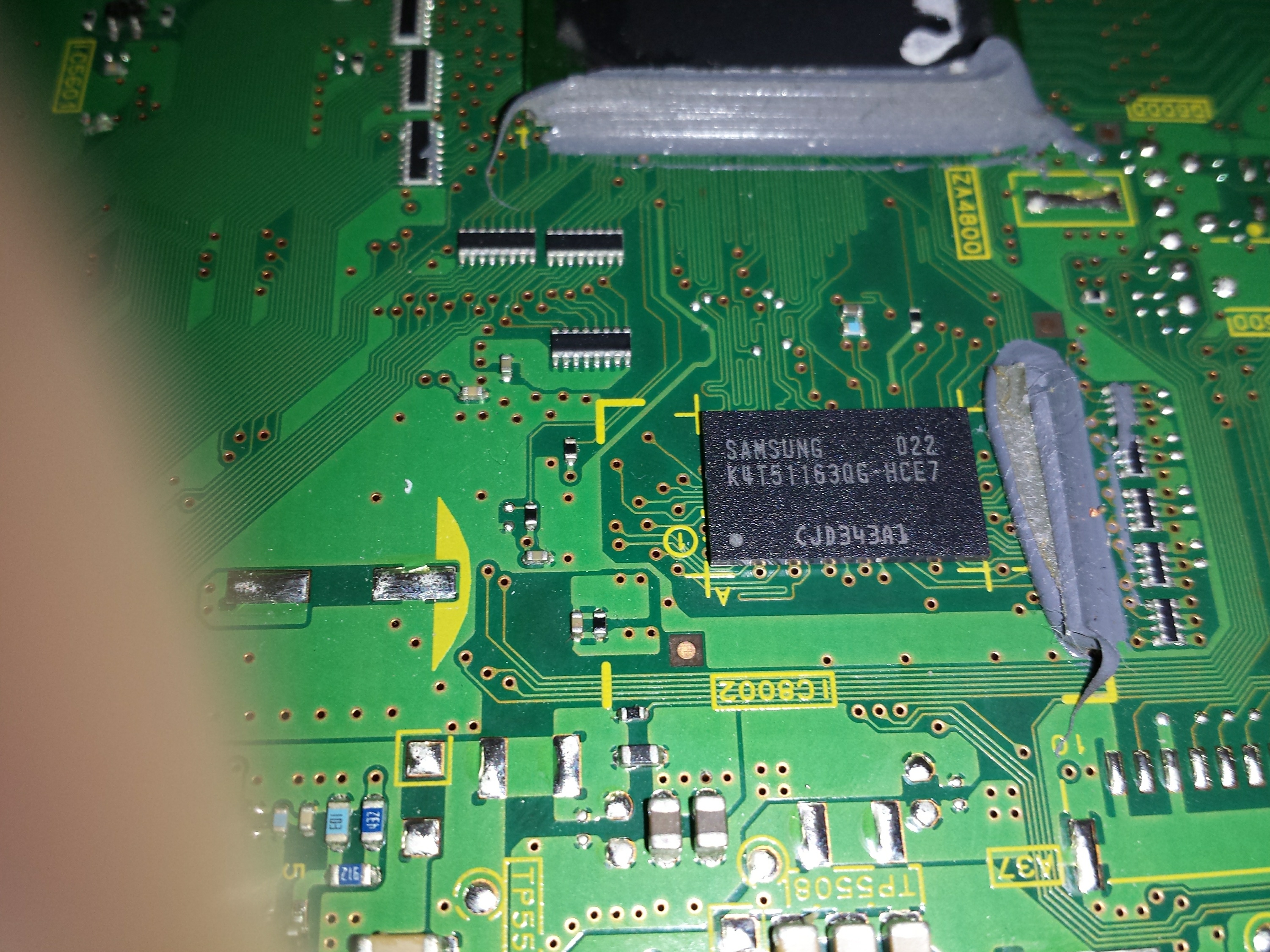

                    I wonder what the part numbers of those are and how much they actually cost? Looks like a real pain replacing them for a DIYer
