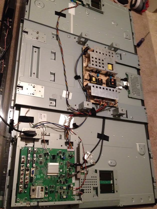

      You need to do some voltage readings first.
      Good clear pictures of the back of the TV so we can see how all the boards are connected will be a good start.

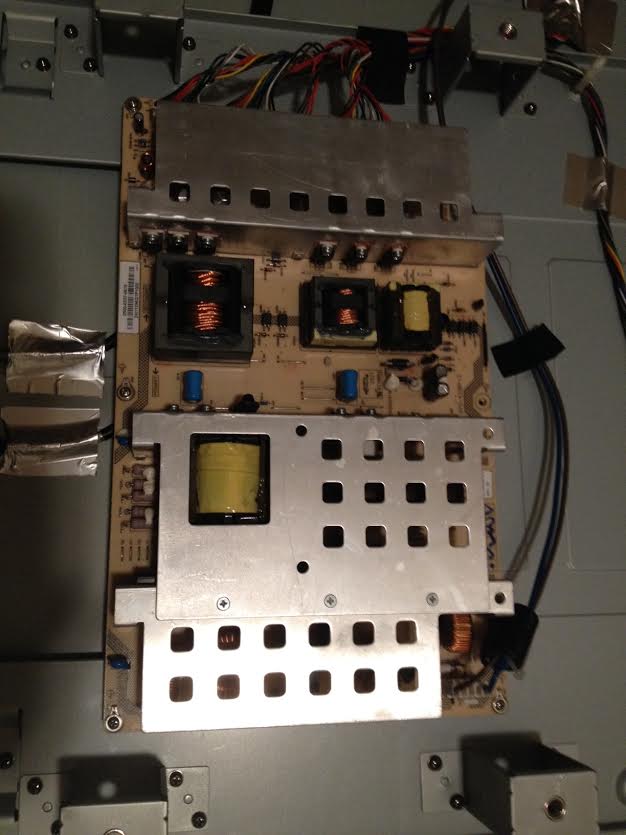

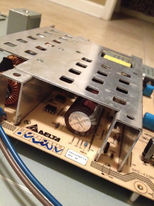

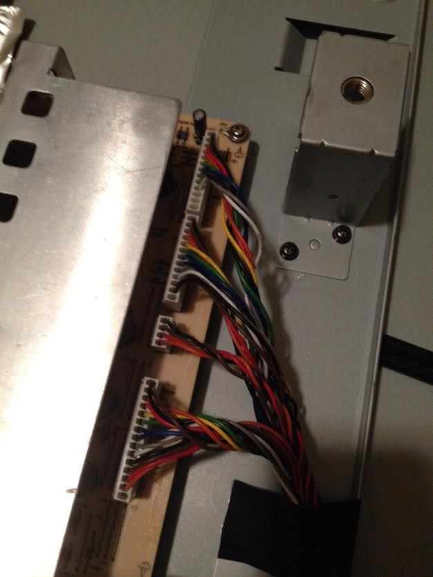

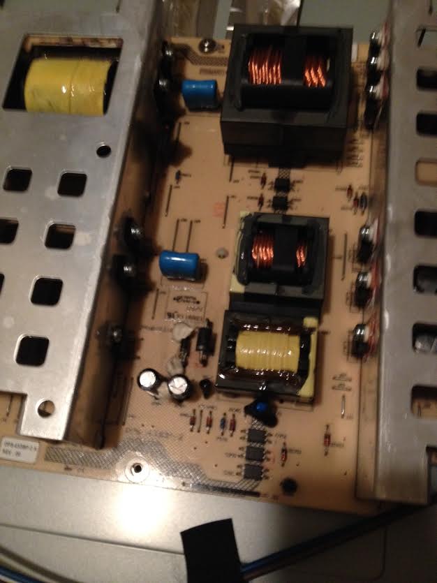

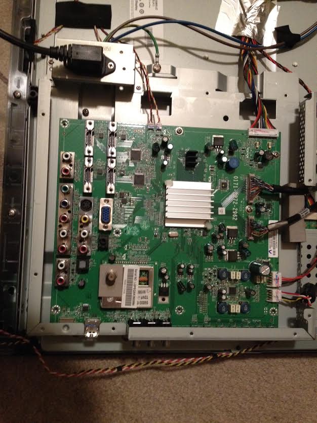

          Okay I got some pictures! Let me know where to poke this thing! (with a meter)

              On the Main board, above the HDMI's on the left, there is 2 black squares, one of them is not hot, the other will burn my finger off, if this means anything. Also, I get STANDBY Voltage of 5.11 coming from the power supply to the main board.
                Re: Vizio VF550M - Standby light only
                "there is 2 black squares, one of them is not hot, the other will burn my finger off," That is not normal. Do you know if this TV was hit by surge or lighting?
                • zdsh07p9
                  • Nov 2013
                  • 155
                  The one on the left is hot, reallllllly hot. (like the description?) I can not confirm whether or not it was hit by lightning. Let me know what you would do from here, or what I need to test boss!
                    There is not much you can do for the bad IC, you will need new main board.
