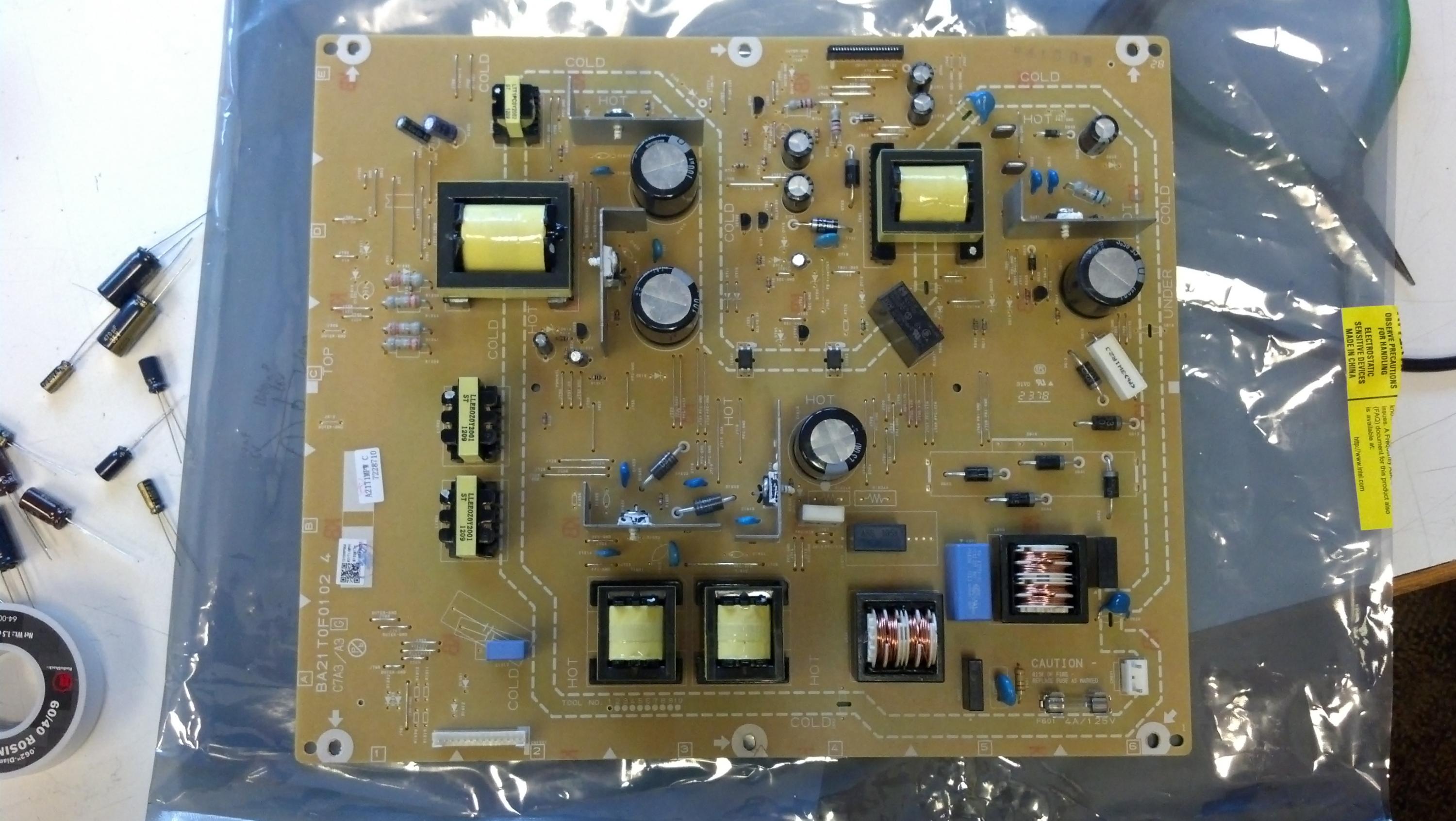

    Tips to making your TV last longer?
    Sadly, new TV's just aren't as reliable as old CRT's. I'll admit, my TV's are pretty cheap (because I figure I could just fix them when they break), my two main sets are an Emerson 39" LCD (Funai) and a Westinghouse with an AUO panel.
    The Emerson gets the most use, which is in my room which I use for things such as browsing the internet, and playing videos for background noise.
    So, what are the best things you can do to prolong the life of an LCD TV?
    As of right now, the Funai set has ~3,500 power on hours with an average running time of 7 hours per power cycle. The longest it's ever been on in one power cycle is 72 hours. Are power cycles what wears them down the most? Besides the summer, I like my room cold so the average ambient temperature is 18C. I turned the backlight to 65%, and brightness to 60% Does this sort of thing increase the life span? I've already replaced all the capacitors (They were all GP 85C caps)
    Attached is the power board in the Emerson before I recapped it. It's definitely poorly designed. The heatsinks could use an upgrade, would something this simple help it out significantly?
    Also, when there is a power rating (in W) on the back of the set such as 153W, is this a "typical" power consumption rating, or the absolute maximum such as full 1080P with full brightness? Thanks for any input

    Certainly changing the 85C caps to quality 105C helps. Try not to mount the TV too close to the wall so some airflow can get in there.
    I personally don't use my TV for Internet browsing. It is all mainly done on a 19 inch or 22 inch monitor.
    The power board looks generic enough and possibly the easiest thing to repair? The t-con and main board will probably be the hardest to repair.

      Yeah the TV seems to actually run pretty cool, and it's away from the wall by 3 feet. I haven't looked at the T-con, but the main board looks well built (At least much better than the power board anyways), and surprisingly uses nichicon polymers.

        Sorry to say that those brands mentioned are poor build and for that matter alone they won't last long and pic Q couldn't be any worse.

                  Yes, in general electronics last longer when cool.
                  That being said, I wouldn't fret. You should try and enjoy your TV. That's what plasmas are for - enjoying great picture quality.
