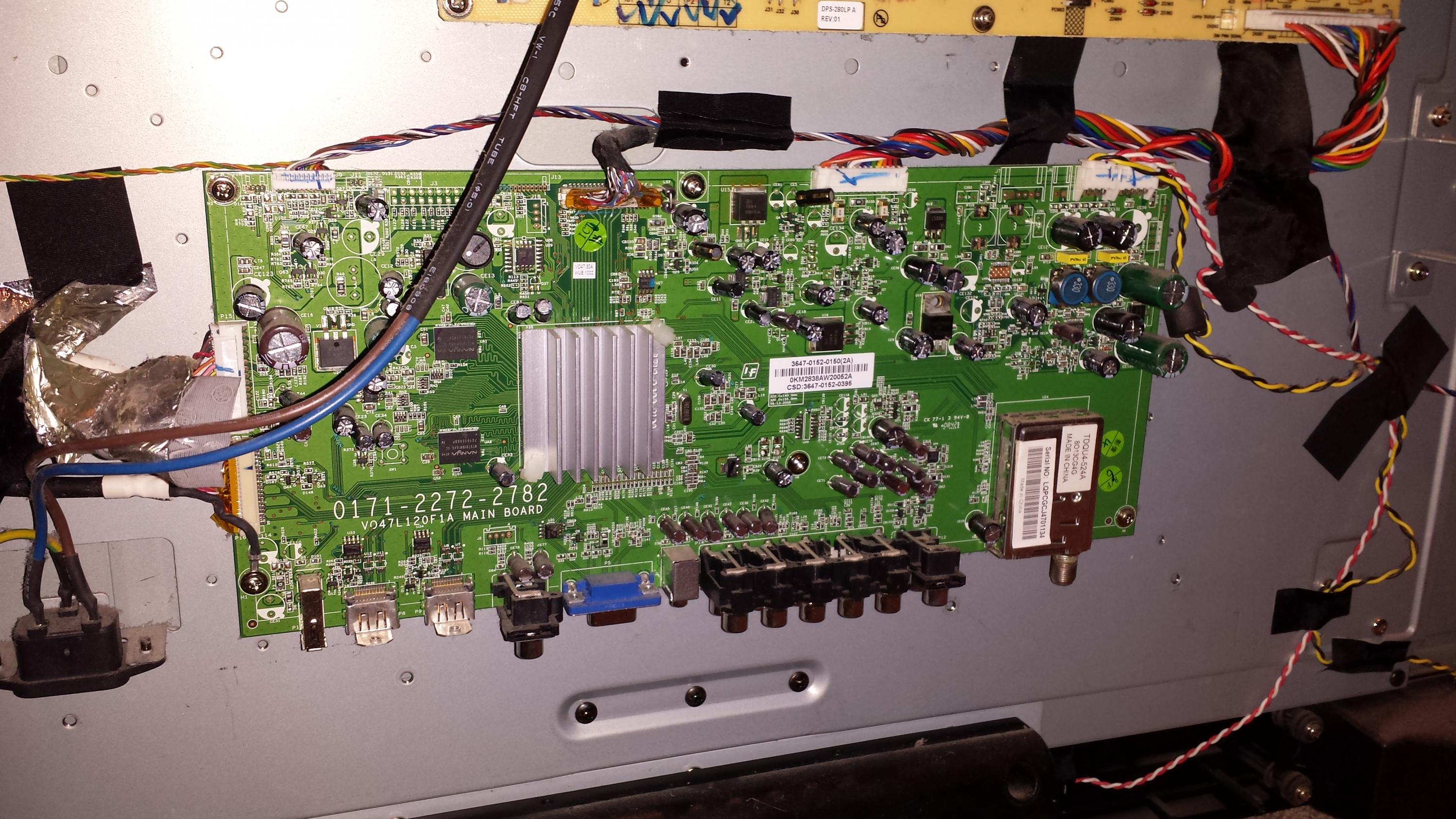

Vizio VO47L FHDTV30A No signal
  • ny_jets_head
    • Apr 2014
    • 70
    • usa
    I can get to all the settings and they display fine but no matter which HDMI input I use it goes to a blue screen saying "no signal"
    I switched to the rf input hoping to see snow and that also says no signal.
    I know its not the source or the cable.
    Any ideas.. mainboard I assume

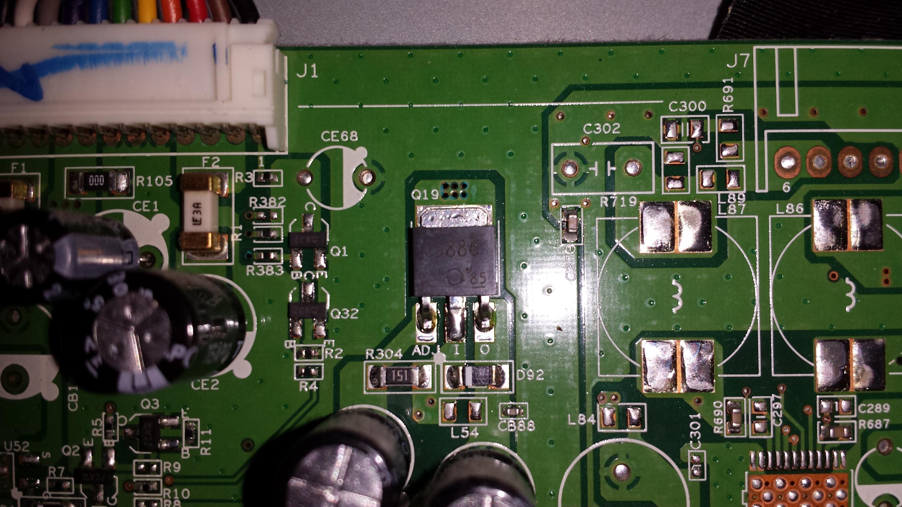

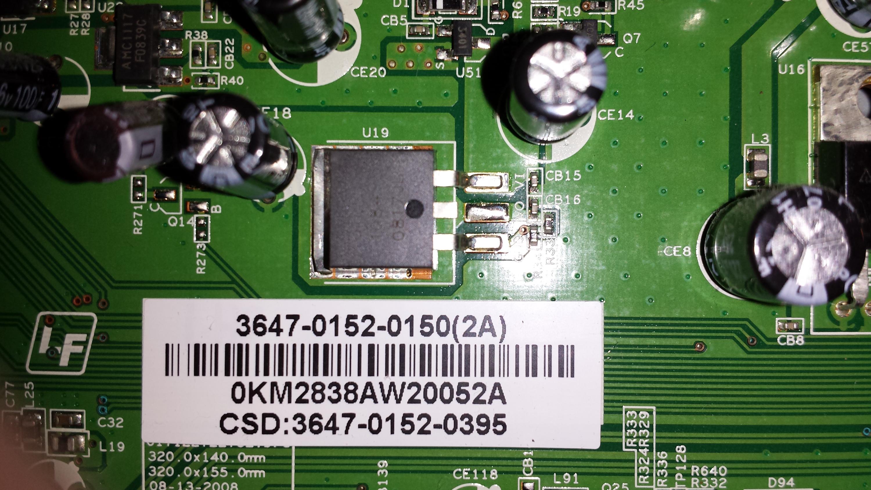

            Re: Vizio VO47L FHDTV30A No signal
            Originally posted by ny_jets_head
            The following are the voltages on the 1084 regulators
            Device In / Out These devices don't have an ADJ voltage
            LM1084 ADJ is set to ground (adjustable type)
            http://www.ti.com/lit/ds/symlink/lm1084.pdf
            Need to find and measure the line resistors to verify the voltages on the line resistors to verify the output voltage is correct
            U20 3.35-----1.82
            U15 4.9------ 3.38
            U19 4.92----- 2.92
            C5886
            Q19 11.87-----11.18 Don't know if this is a Reg. can't find a data sheet for a Reg. it is marked I - O -Adj on the board
            Adj on this one is 11.82 any ideas what this is?
            A1117 (Adjustable type)
            http://pdf.dzsc.com/130319/A1117%20SOT-89.pdf
            Pin 3 Pin2 ADJ
            U17 4.92-----3.35 ---2.09 Looks good.
            U22 5.0-----3.33----2.09 Looks good.
            U21 3.34---1.25-----0 connected to ground also looks good
            Thanks for the info!
            Revised info above.
            Any ideas on Q19 what is it?
              "Any ideas on Q19 what is it?" Can you show me closed up picture of this Q19?
              "U19 4.92----- 2.92" This one has strange output, like you said, more likely to be 3.3V, let me see the picture of this one also.
              • ny_jets_head
                • Apr 2014
                • 70
                • usa
                Attached are the pics of Q and U 19
