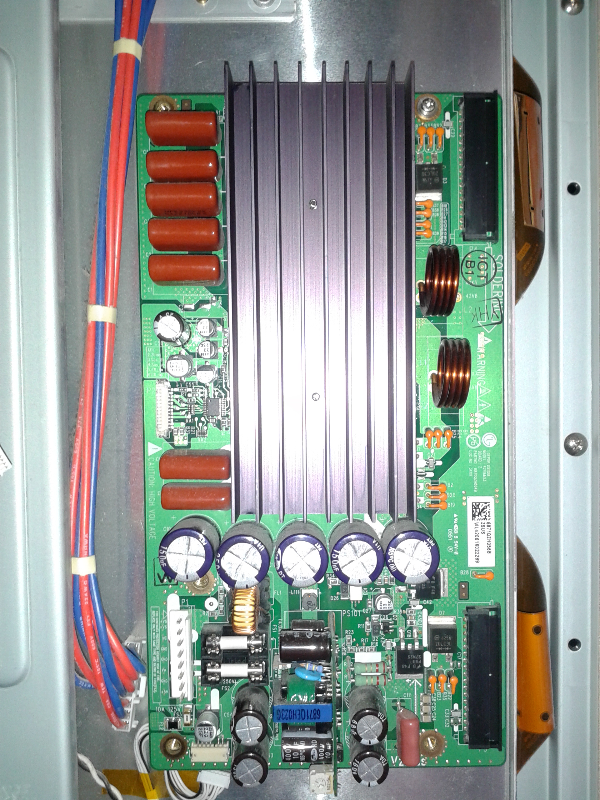

            So I took the back of the TV off and gave it a through visual inspection. No obviously swollen, blown or leaking caps. Pulled the 5 fast-blowing fuses off (that I could find), and they all tested short. Decided that of the 4 major board, the ZSUS looked like it was the easiest to remove, so I pulled it and discovered that the large IC chip (what coppell tv repair calls the " IPM hybrid IC" or "IPM") seems to be leaking something. Took pictures (see attached) and you can see the spread pattern emanates from the large black pad on the chassis, stains the pc board a light brown on the way down and pools at the bottom of the board. Also some grey shreds of the obviously overheated rubber pad are still stuck to the pc board.
            But before I declare victory and pull the board and order a replacement, I'd like some input, because I wonder if the gook might not be from the rubber pad itself deteriorating, and the liquid is the cause of the problem as it might be conductive, or capacitive, or corrosive, or whatever. I'm half-tempted to clean it up and put it back on. And I'm also tempted to desolder the IPM and clean-up behind it, inspect it, etc... because what if there is something underneath that is the cause of the problem, and not the $50 IPM itself?

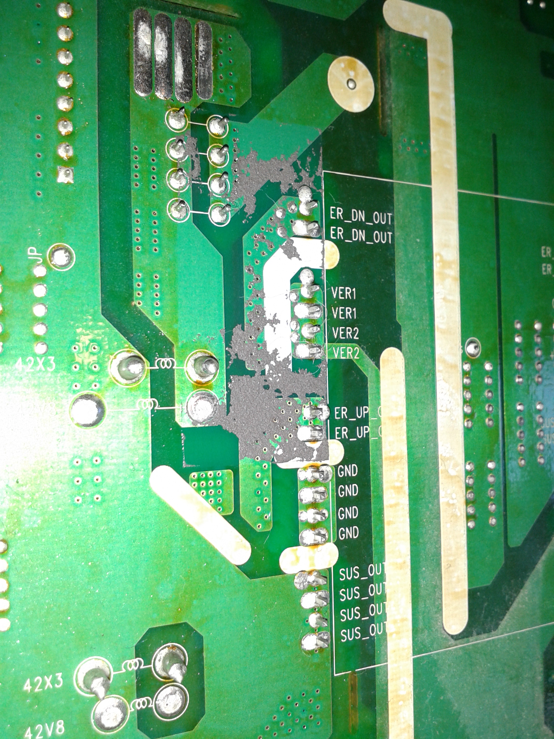

            Also, I wonder how the IPM comes off the board. I see the threaded ends of two screws through the top of the heat sink. Looks to me like it needs to be desoldered off the pc before the heat sink can be removed, and I'm probably going to need to purchase a desolder gun.

                    Also it would be nice if someone could give me good opinions on the leaking stuff on the ZSUS board (see photos) and whether it came from the deteriorating rubber pad (my theory), or a component in the IPM, or what. And also if anything bad will happen if I simply remove that bad and throw it away. Seems to me that the pad's purpose is to prevent shorting against the metal chassis behind the ZSUS board, but it's 1/2" thick, and there is NO WAY that board is going to flex low enough to short to chassis ground. It would break first. So since it's obvious to me that the pad's purpose shouldn't be to prevent shorting, then either it has some other, unknown (to me) purpose, or it's a stupid design and it really serves no function at all. Be nice to know which is most likely.

                      The pad you are speaking of is a thermal pad (heat sink). If you were to remove it, the IPM would overheat almost immediately.
                      I would not mess with the Y-Sustain board at all if I was in your position. If the Y-Sustain was bad, the screen would not light up like yours does. It would either be flickering, or completely dark. IPM on the Z-sustain is definitely my vote.

                        Oh, and the brown stuff on the board is probably from the original manufacturing process. Most of these have at least some on it. Yours is heavy but does not indicate a problem of any sort.

                          Thanks for all that. After I posted about it, I realized some of the brown stuff is different than the wet stuff. The brown stuff is at the top of the board, is crusty and dry, and came off with mechanical action (scrubbing) and alchohol. The wet stuff comes directly from this pad.
                          Is there no way that this pad is the cause of the problem? The rubber/material deteriorates and shorts, or has capacitance, or whatever, and causes the IPM to fail? Is there an "upgrade" for this heat sink? Something metal and with a fan? If the IPM will overheat immediately due to the absence of this POS chunk of rubber, then maybe that's why it went bad to begin with. Do they sell this stuff new as a replacement part? What's it called? Is there something better? This stuff is damp and gooey, like the steering wheel on an old car where the rubber & plastic is deteriorating. How come I've never heard of this gooey, dripping rubber heat sink stuff before? Is it common? Is it a common cause of failure? Can I replace it with something better? How hot does it get in there anyways? Maybe a small fan would help? There's a couple of empty jacks where I could run a small northbridge fan or similar.

                            I realized after my last post that I would have to desolder these IPM's from the board before I could even look at them, and I have to buy a heat gun and a desolder gun before I do that, so... I'm thinking I'm going to just buy two of these and while waiting for them to be delivered, I'll get the tools I need ready.

                              I'm repairing an LG which uses the same or similar zsus boards. I read here somewhere that the two large inductors(?) on the right side of the board suffer from cold solder joints. You can see the joints in the first pic of post#6 to the left of the ipm footprint. Have a close look and reflow with fresh solder if necessary.
                              Your link to newegg doesn't say if those ipm's are new or pulls. I don't see the wisdom in replacing a functioning ipm with a pull as outside the aggravation of replacing it you stand a chance of shortening the lifespan of the board instead of lengthening it.
                              I found a board for $24 stated as good which lo presented the same symptoms. I will have a replacement tomorrow but am not optomistic as this failure seems all too common and with the ipm failing passively sellers believe the board to be good apparently. Good luck.

                                    Yes the orange rings.
                                    My replacement zsus (third if you count the failed one original to the set) is dead also in the same way. Cold ipm heatsink but functioning zbias circuit. Just for fun I ran the set without any zsus board and it looks the same.
                                    Looks like I will be ordering an ipm module.
