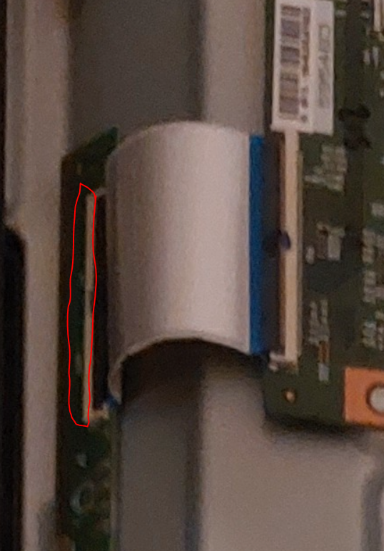

Philips 55PUS6704 no picture, backlight ok

    On these LG T-CONs, in addition to 12v, you also need to supply 3.3v to a specific point on the T-CON or move a specific smd resistor to put it into test mode (color selection), but I don’t know what and how about this T-CON

      No need 3.3V, it had SPI U1 Pin 8 should have 3.3V you can measure it when you supply 12V to F1 as T-CON Panel standalone test... much like Panel VCC at thin film have brocken some where need deep investigated before play with SoC

        I couldn't find any damage on or around the connection of the panel
        I felt like this TV had a million of screws to get to the panel.

          only the Bezel need to remove... however do the test again with 12V and measure U1 PIN8 if there 3.3V

            How is it not necessary? You need to supply these 3.3v, which are converted into T-CON via a jumper, to a specific point and thus the controller goes into test mode!

              no need to feed 3.3V i asked him to measure just in case if T_CON PWM didn't generate it.. we have in this forum same T-CON and it start to do color pattern just with 12V.
              this why i asked him to inspect LCD Glass before going to GPU

                I'm probably gonna get a second TV, exact same model. I will switch parts then and see which one is at fault. So I can repair both of them.
                Thanks for your help and knowledge! I really appreciate it.

                  There have been cases of poor soldering of these connectors on the buffer strips. Inspect carefully with a magnifying glass to see if there are any bad soldering (cracks) between the connector pins and the board.

                    its 0.1% will be soldering crack at ribbon socket at panel or T-COn, but it could be the clip expanded and didn't make enough pressure to hold ribbon in place,,, but this also unlike unless the ribbon contact pins damaged because of the age and heat when user disconnect them many time.
                    still i think need to inspect the corners of the LCD with out Bezel if there damage at glass edge.

                      Hi, the white half screen means you have probably correct gate drivers signal but you have no data, this means probably you don't have source vdd, you have to check the correct points on the strip boards, check wheter on the bigger caps you have near 17v, if you do not have it check the correct point on tcon for same voltage, so check every.bigger cap and see if one has missing volts, the correct one is connected to cathode of a power diode.. inspect strip boards for corrosion..

                        the white part is where the screen is disconnected.
