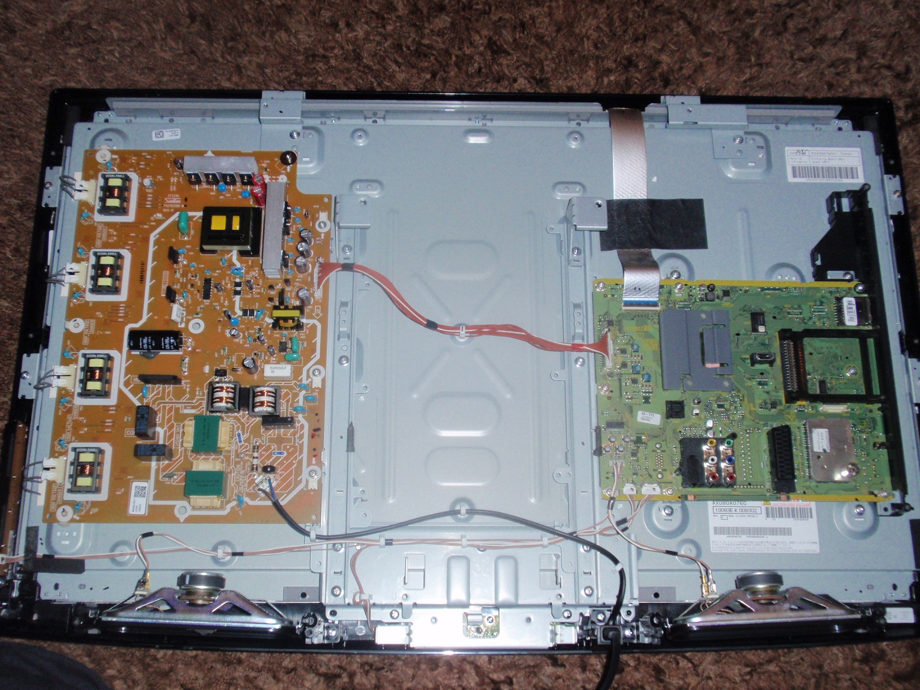

    Hello!
    Big difficulties to troubleshoot this tv!
    Sometimes powers on ok, I can watch tv as much as i want to, but sometimes it wont start, just nothing else but the stand by light.
    Capasitors looks fine, changed the bad ones. Is this a psu problem or what?
    I cannot find any burn components.

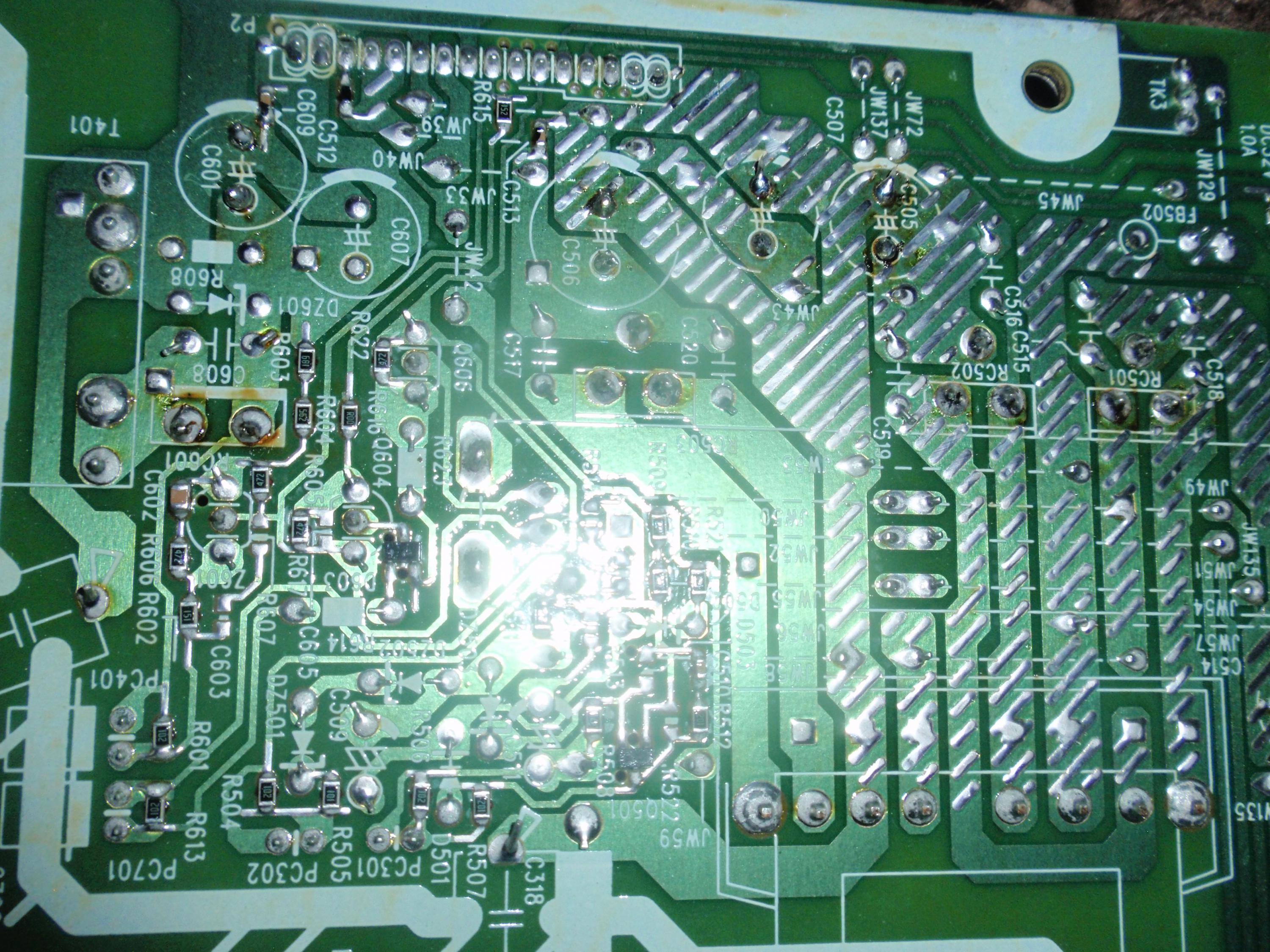

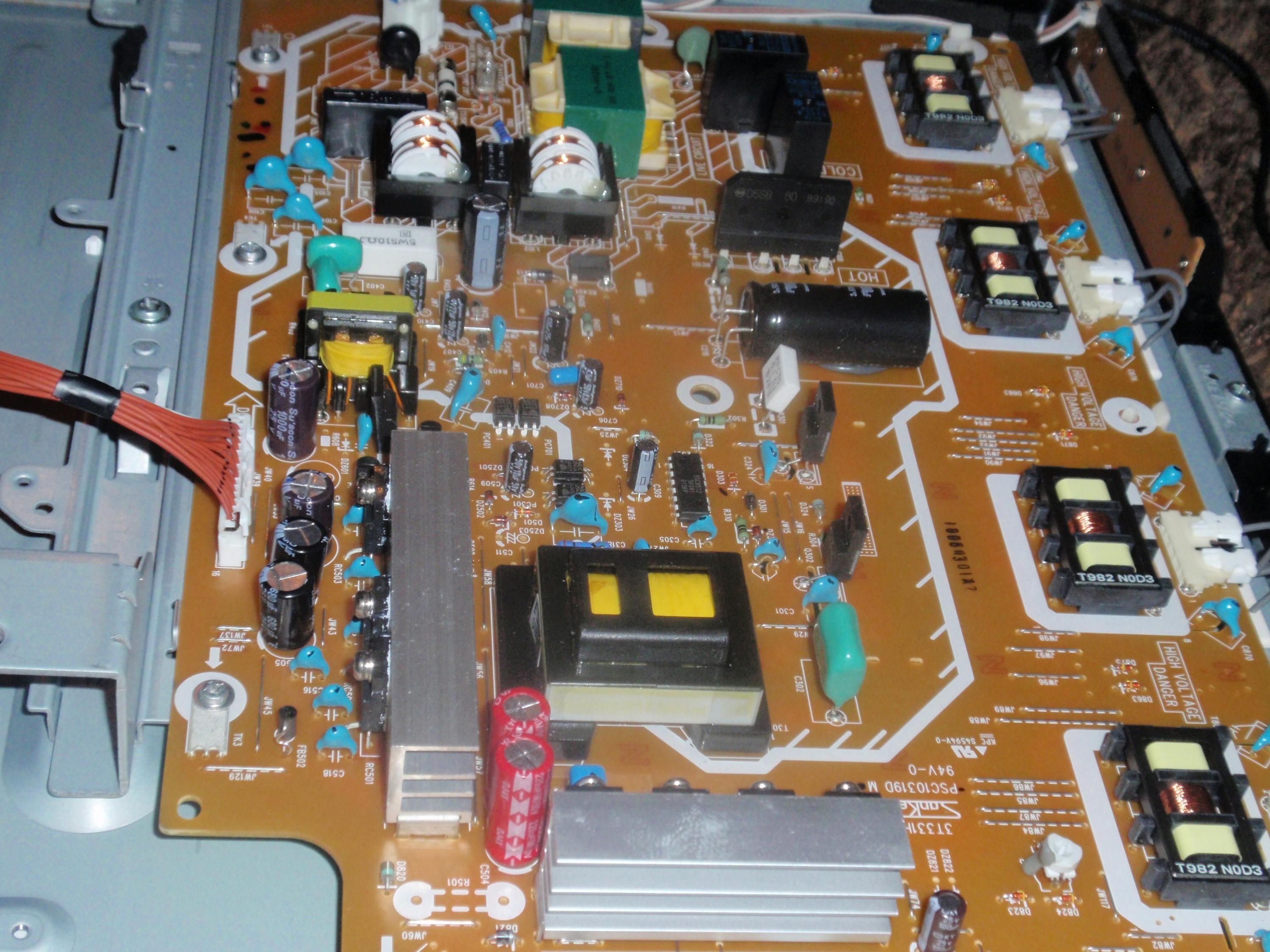

            Re: Panasonic Viera TX-L32C2E

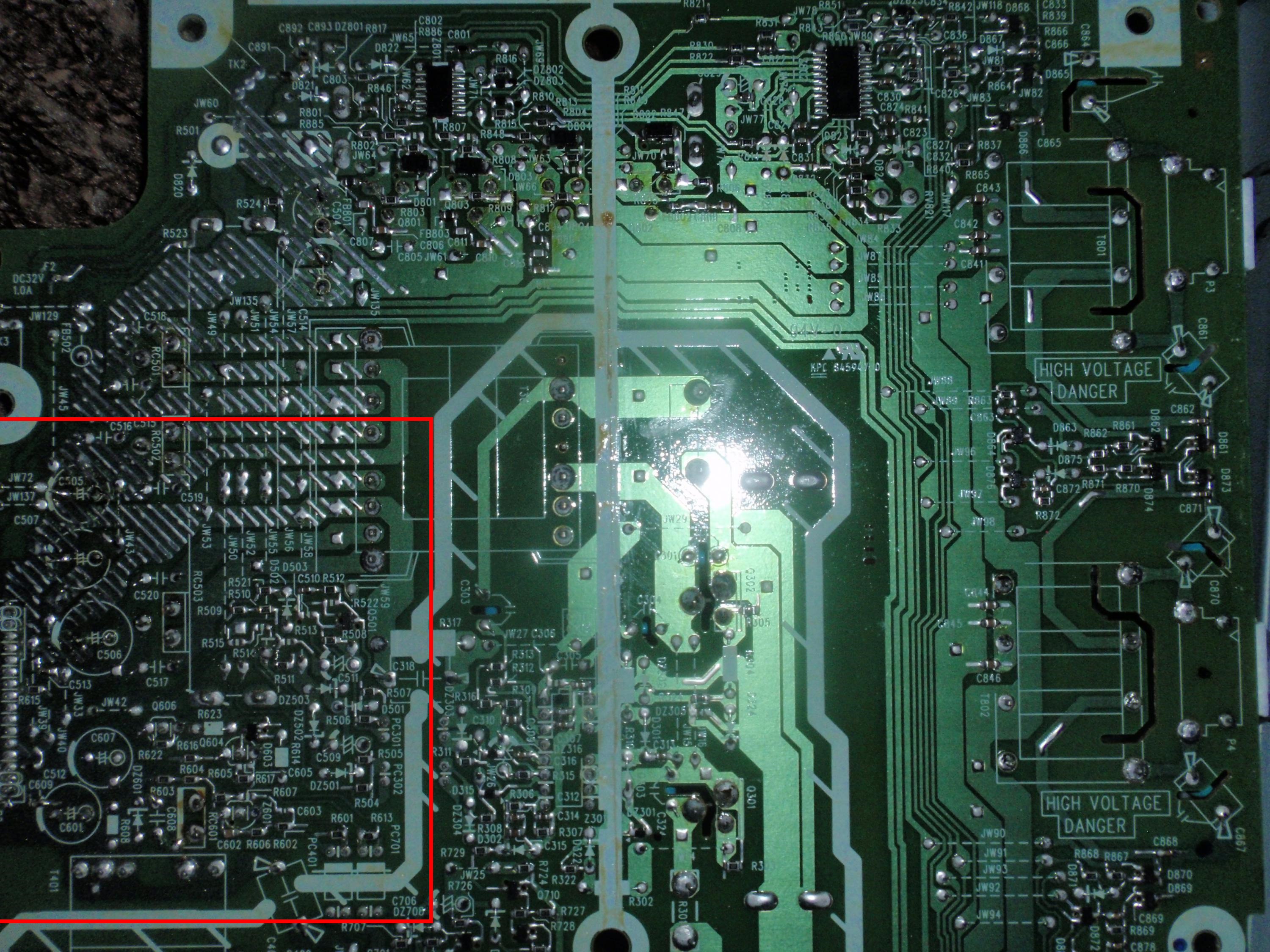

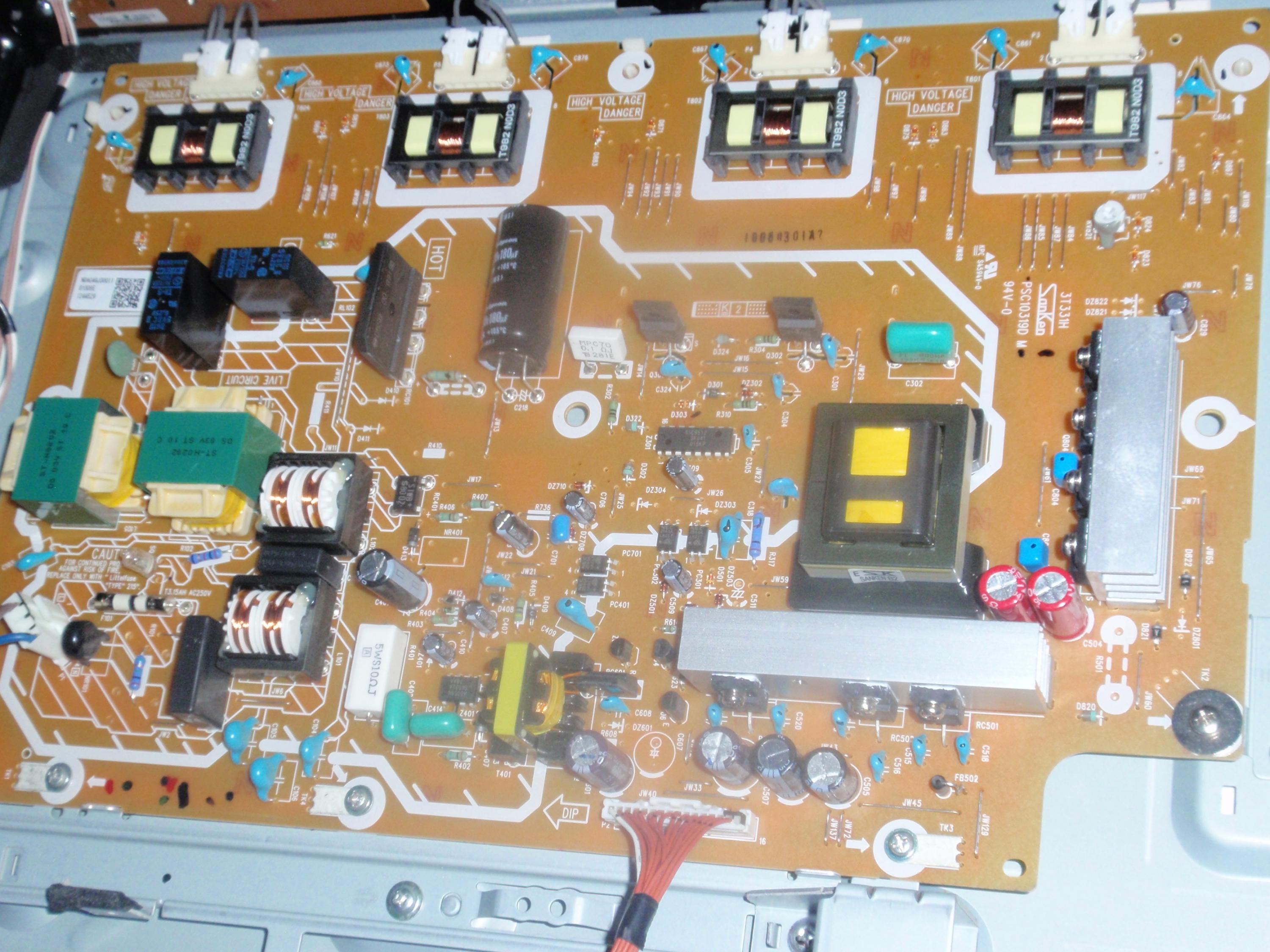

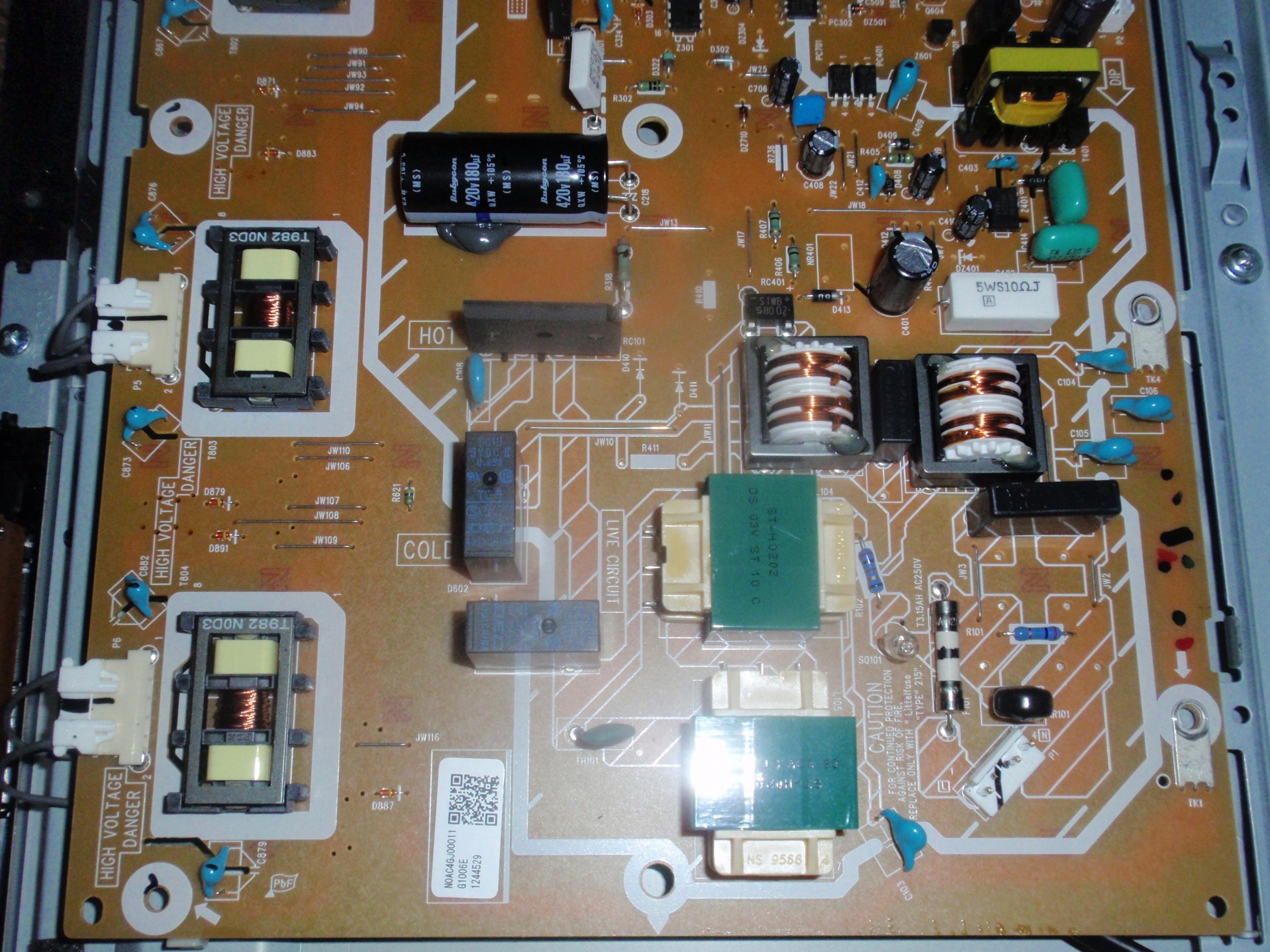

            We need better pictures of the board, both sides. You need to verify that the standby voltage is not fluctuating. I cannot tell from the pictures as to which pin on the white connector is for the STANDBY Voltage.
            • Antti
              • Sep 2014
              • 52
              • Finland
              This board is weird because i cannot find the voltages that should come from the white connector pins...
              Is this normal for panasonic? or am i just failing :O
                That is why I need good clear pictures of both side of the board to trace out the connections.

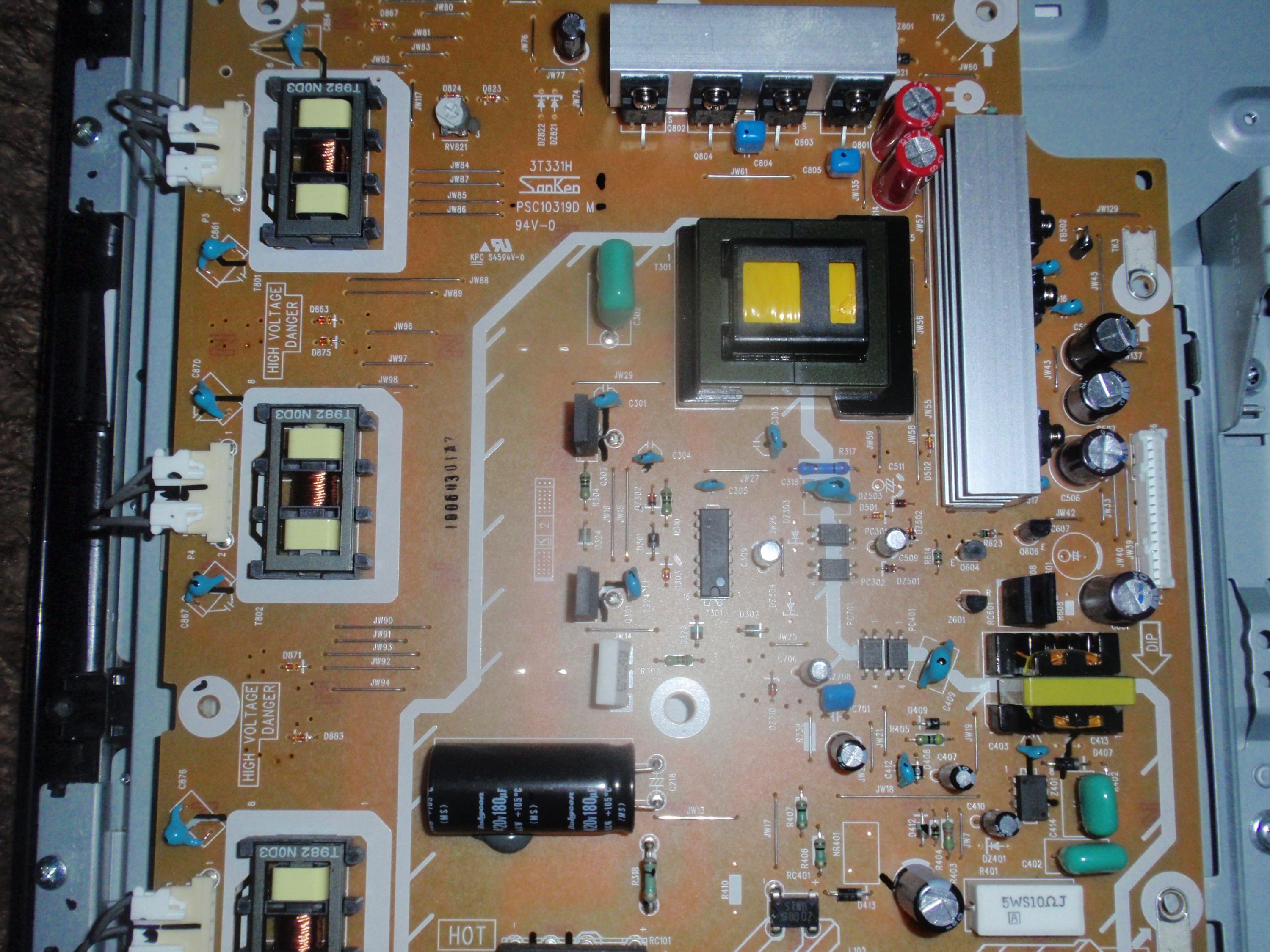

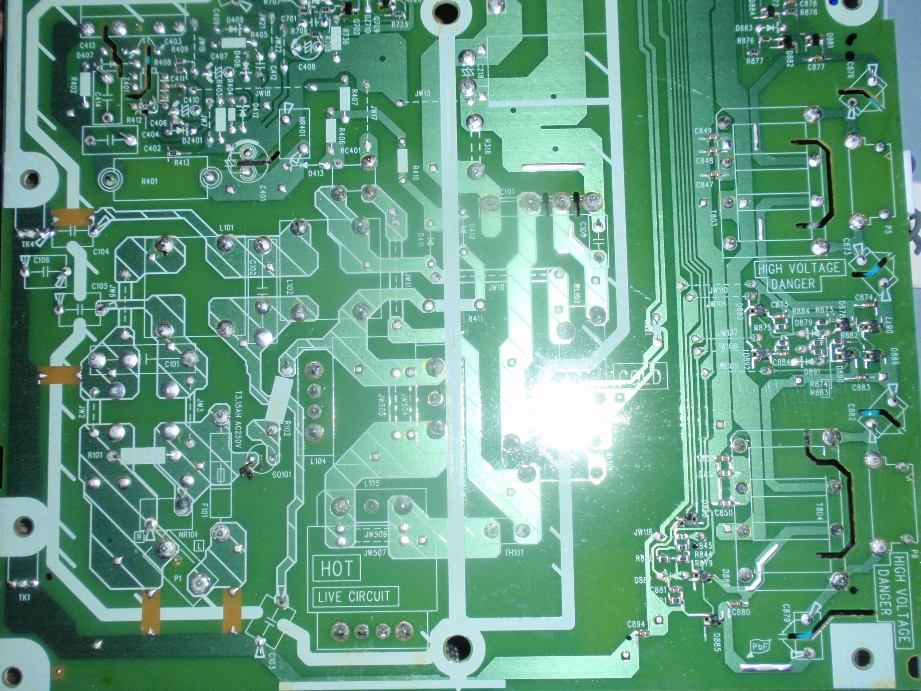

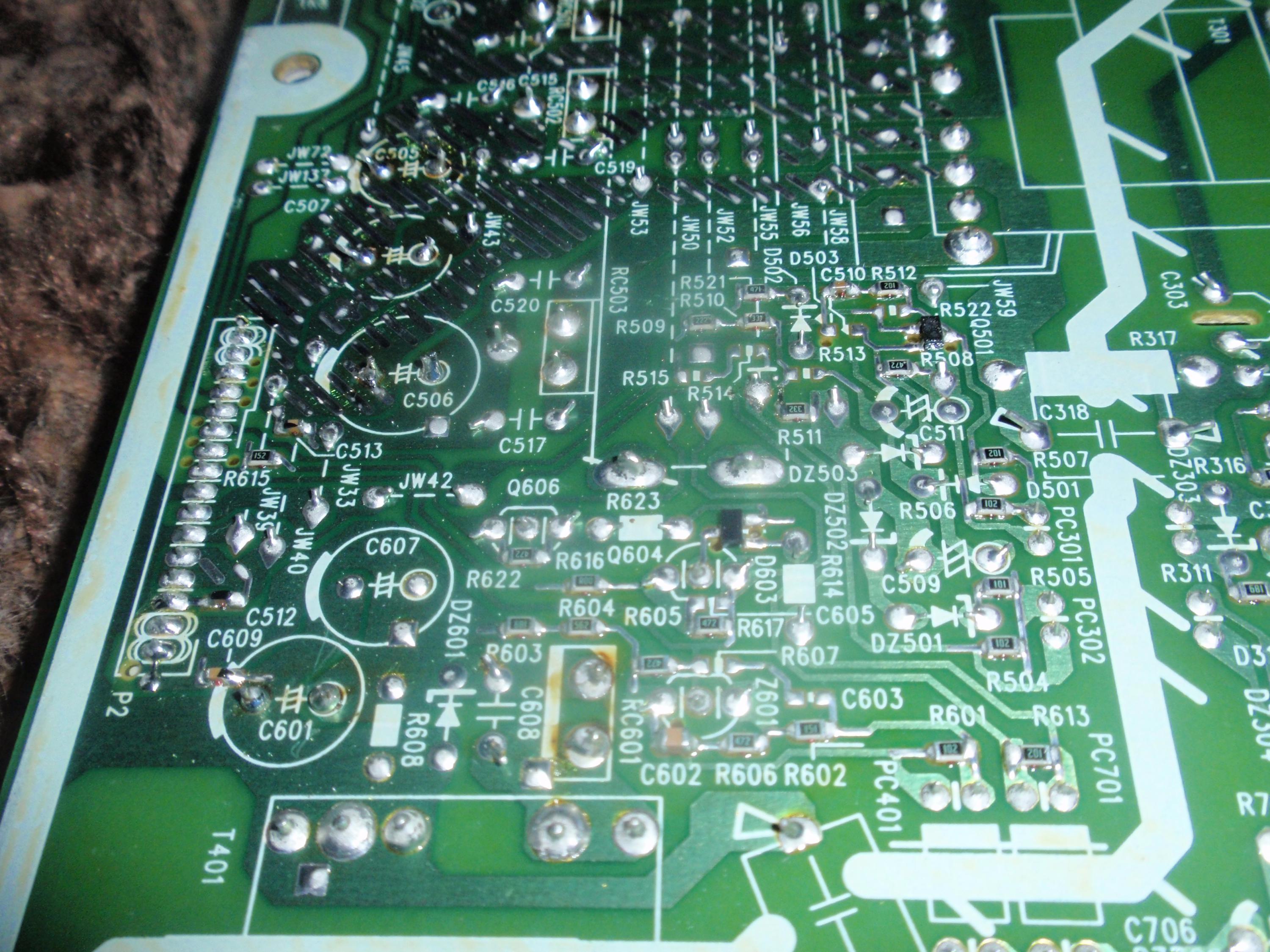

                  pictures bothsides of the powerboard

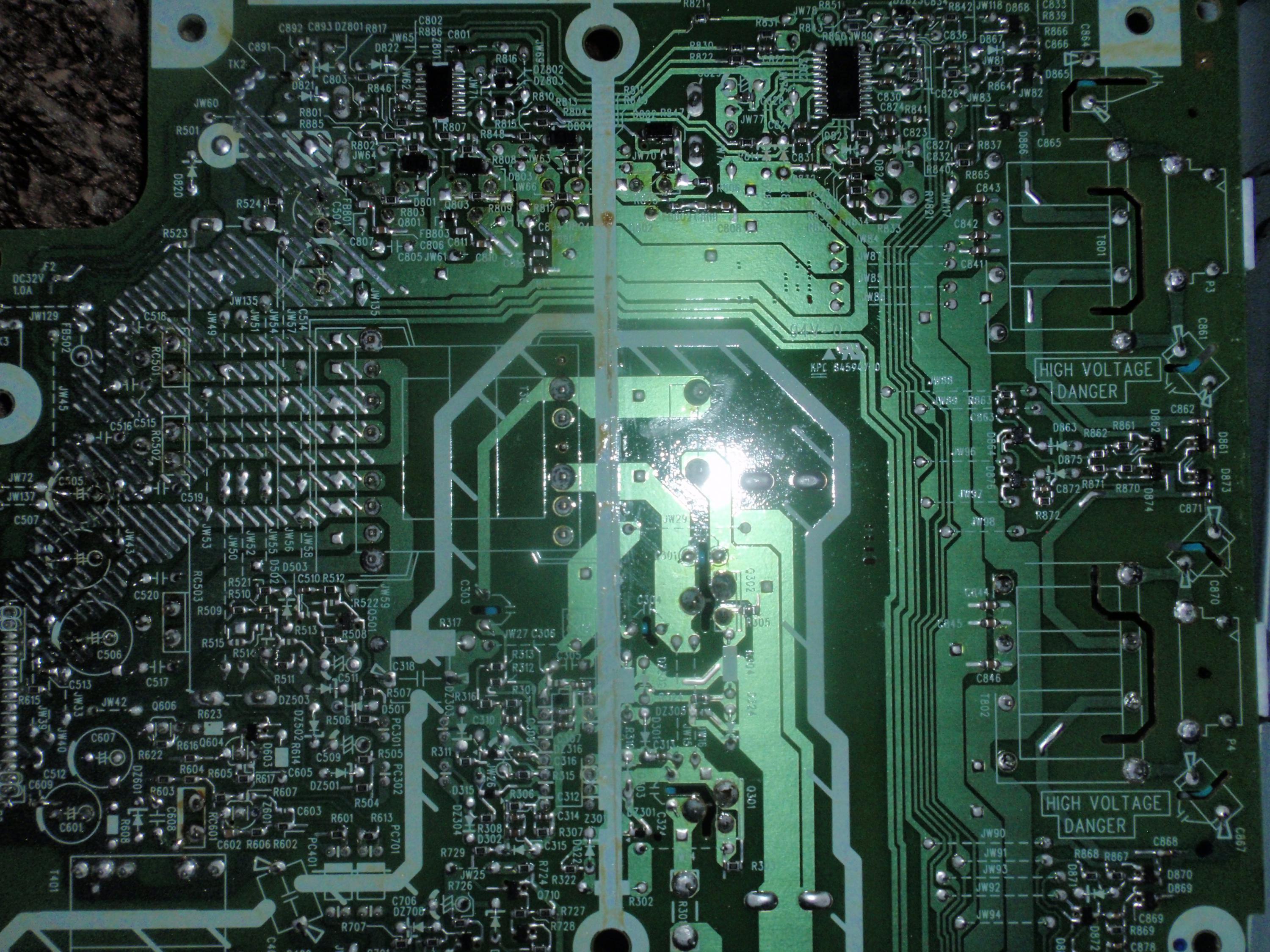

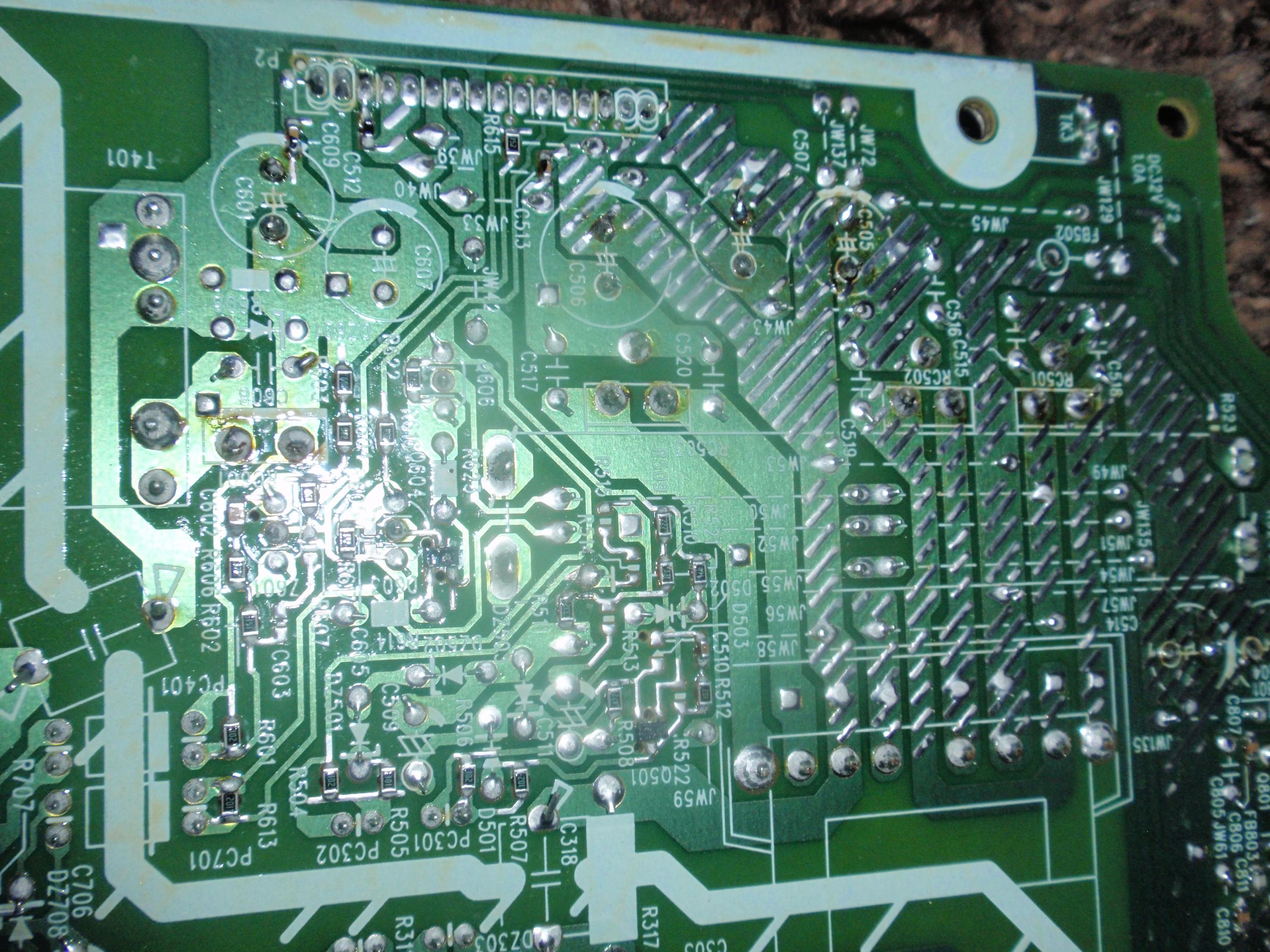

                    Need picture in the red box area, brighter too, I cannot easily see the traces.
                    • Antti
                      • Sep 2014
                      • 52
                      • Finland
                      any better?
                        OK, connector P2 pin 1 and 2 are tied together and connected to the white wire and red wire, and also connected to the filter cap C601 (+ pin), that is the standby power supply. So you need to find out if it is putting out steady DC using chassis as the ground ref for the meter.
                        • Antti
                          • Sep 2014
                          • 52
                          • Finland
                          I measured the white and the red wire next to it, both gave me steady 5.77, seems ok?
                            So it is not going up and down in sync with the LED then, right? If that is the case, the STBY power supply is OK and the problem is in the main board some where. I cannot find the service manual yet to see if there is any LED error codes.

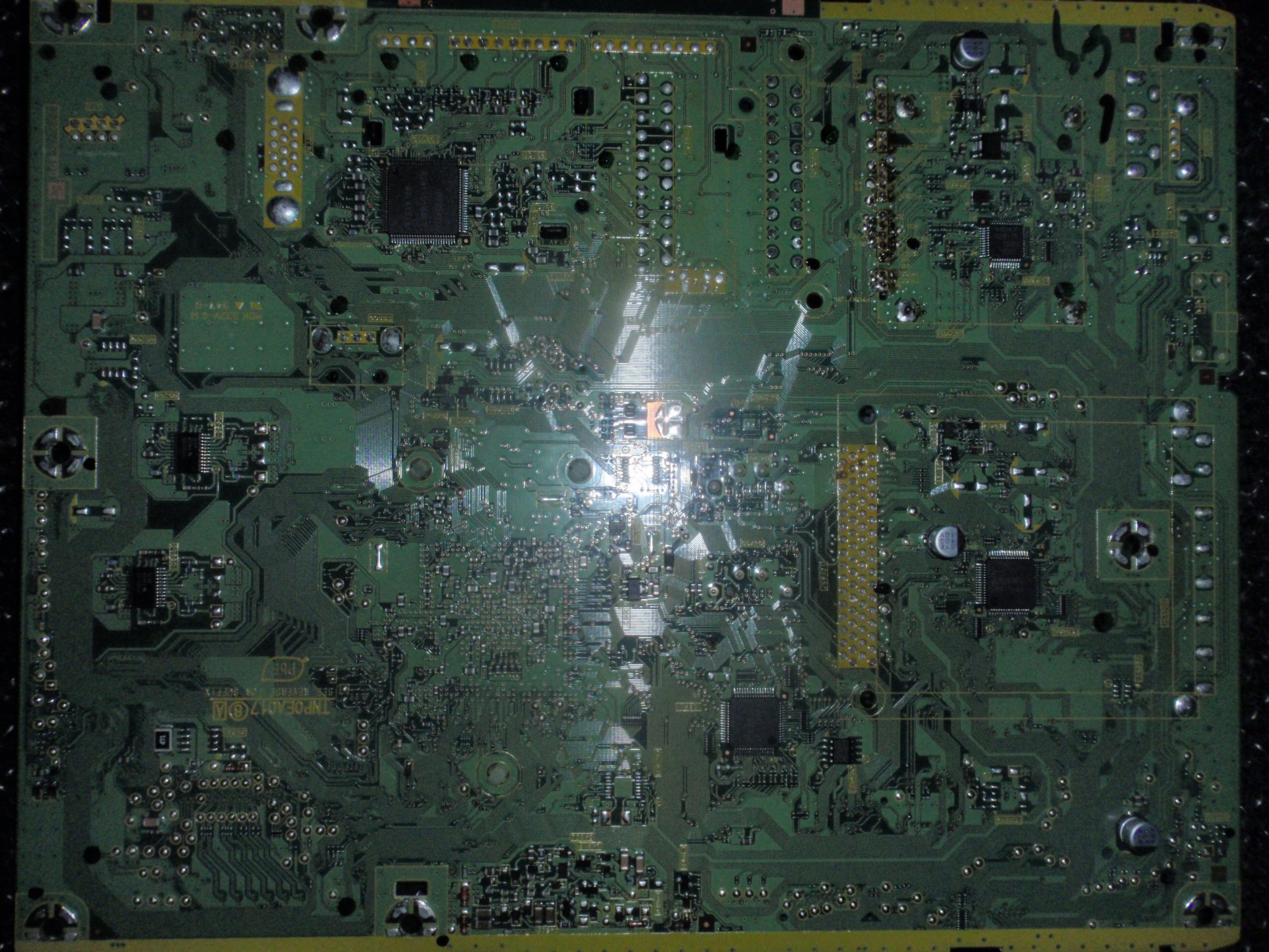

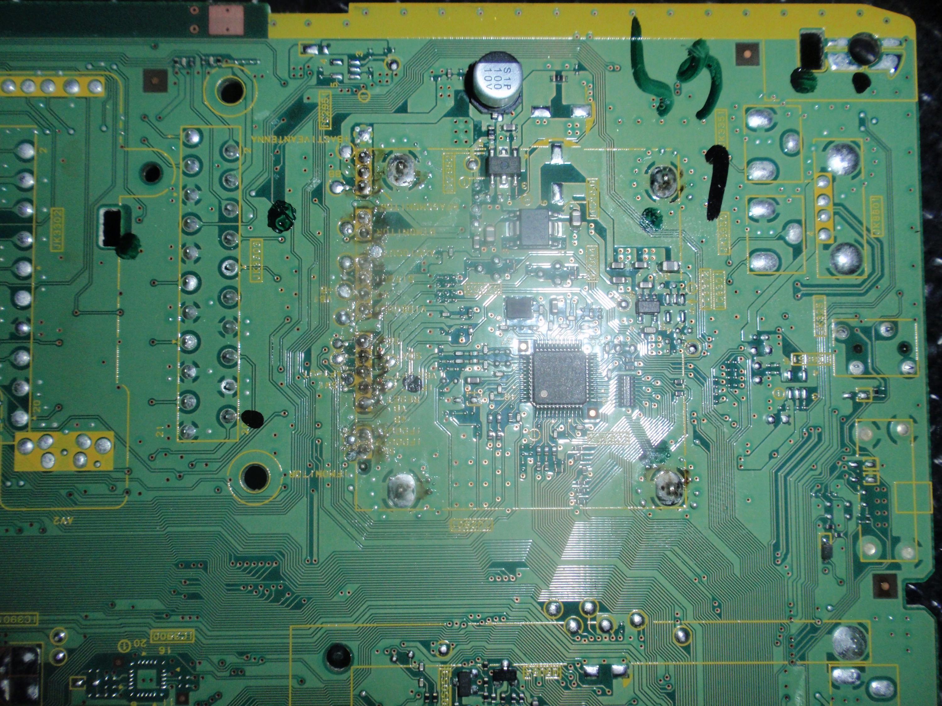

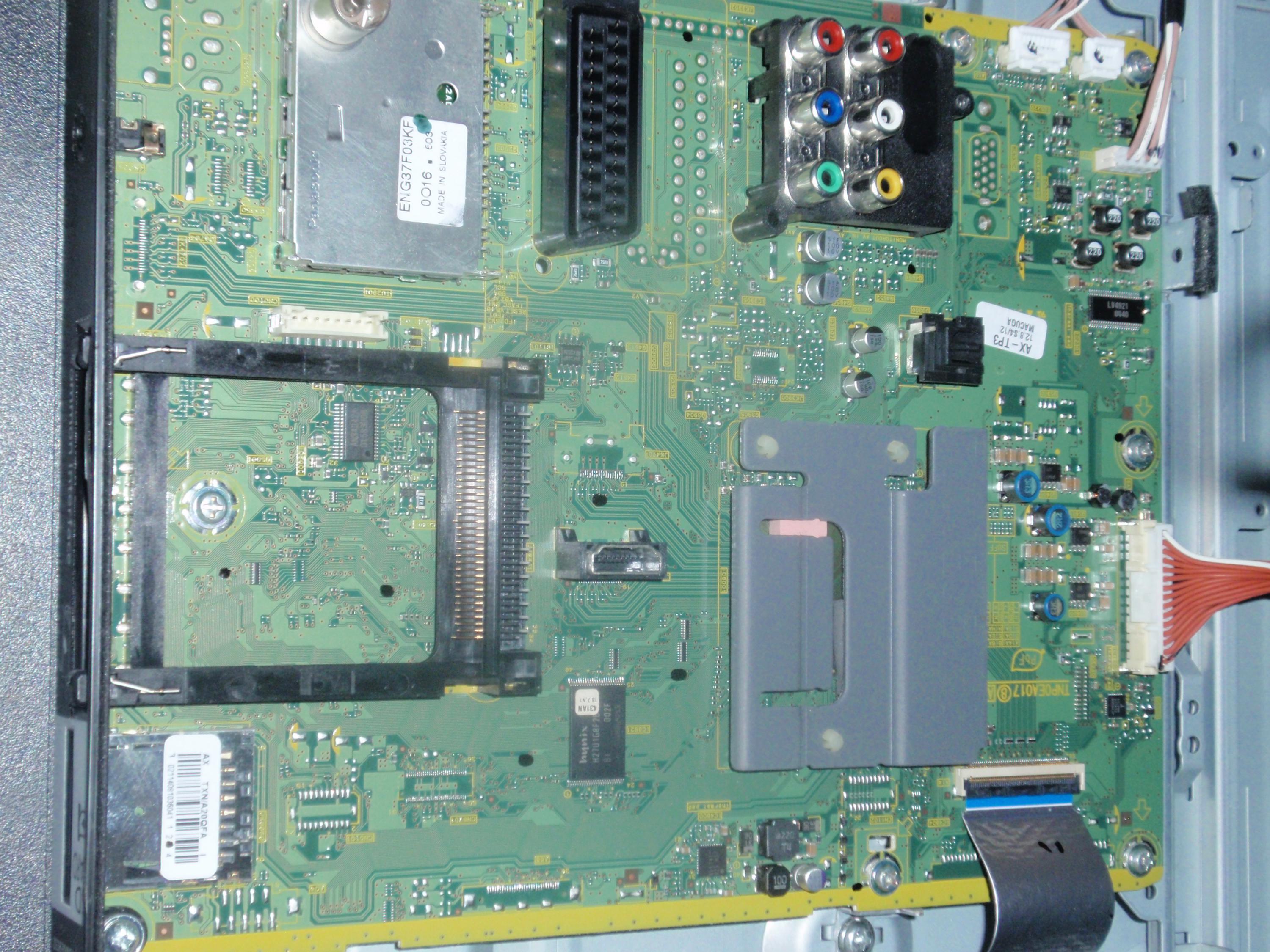

                              no, the power is steady. Green blinking is so fast that nobody cant count them

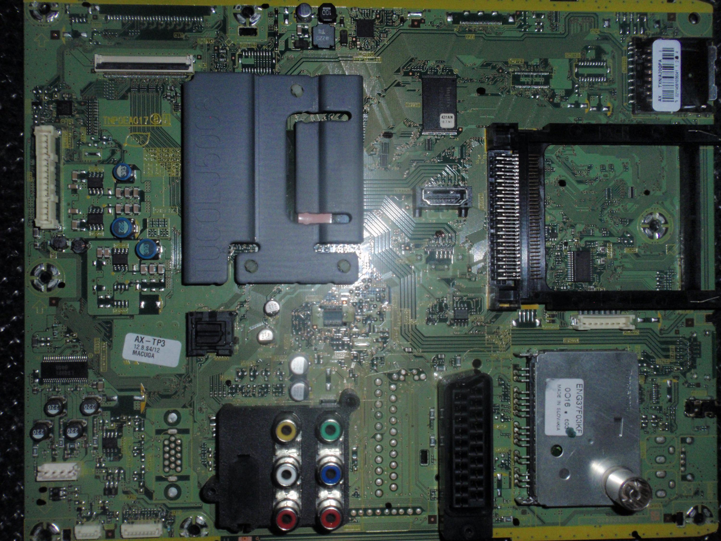

                              here is some pictures from mainboard, when i plug the antenna it shuts off and wont turn on..
                              and the antenna "socket" seems little burned?
                              • Antti
                                • Sep 2014
                                • 52
                                • Finland
                                Ok, i´ve pretty much troubleshooted the problem to the antenna/dvb.... what next?
                                should i check fuses? or change the whole antenna plug?
                                tv started normally, but when i plug the antenna, it shuts down and goes somekind of safe mode :o
                                  Without the diagram of the main board I cannot help out much. May be look to see if there are fuses on the main board, check the input/output of the voltage regulators, etc.

                                    Use "Galvanic Isolator" for the antenna http://www.dipolnet.com/galvanic_iso...hz__R48605.htm
