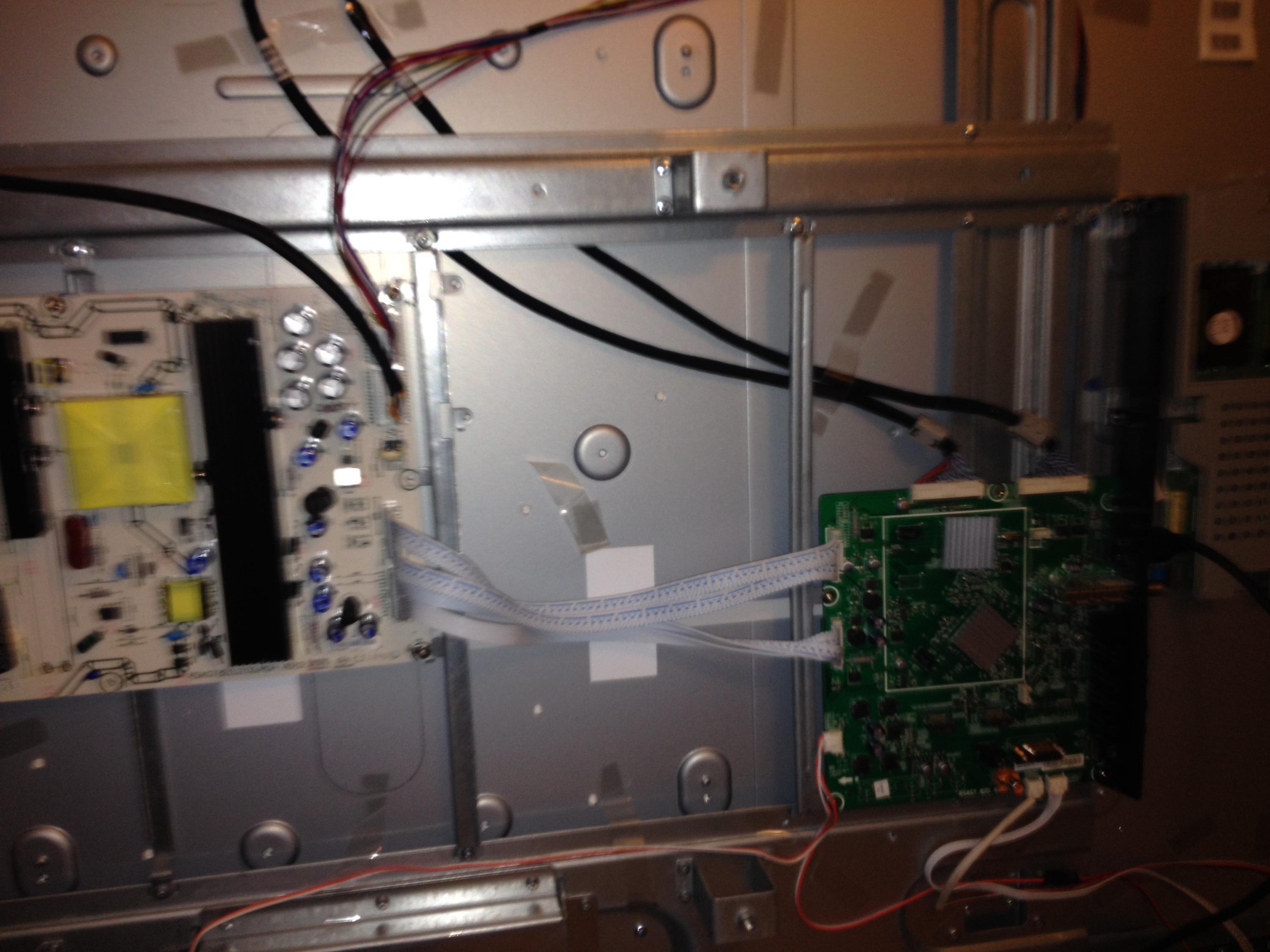

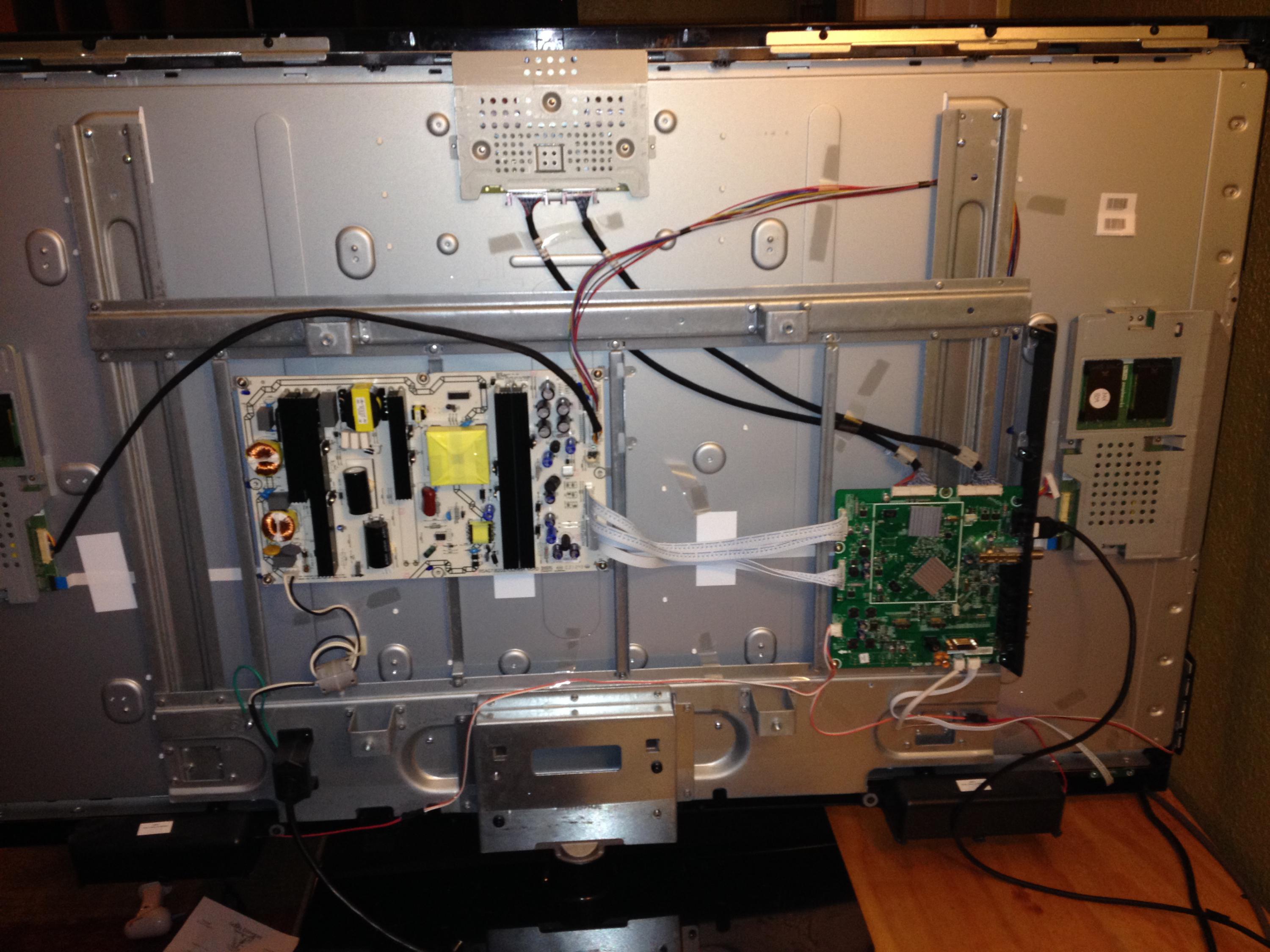

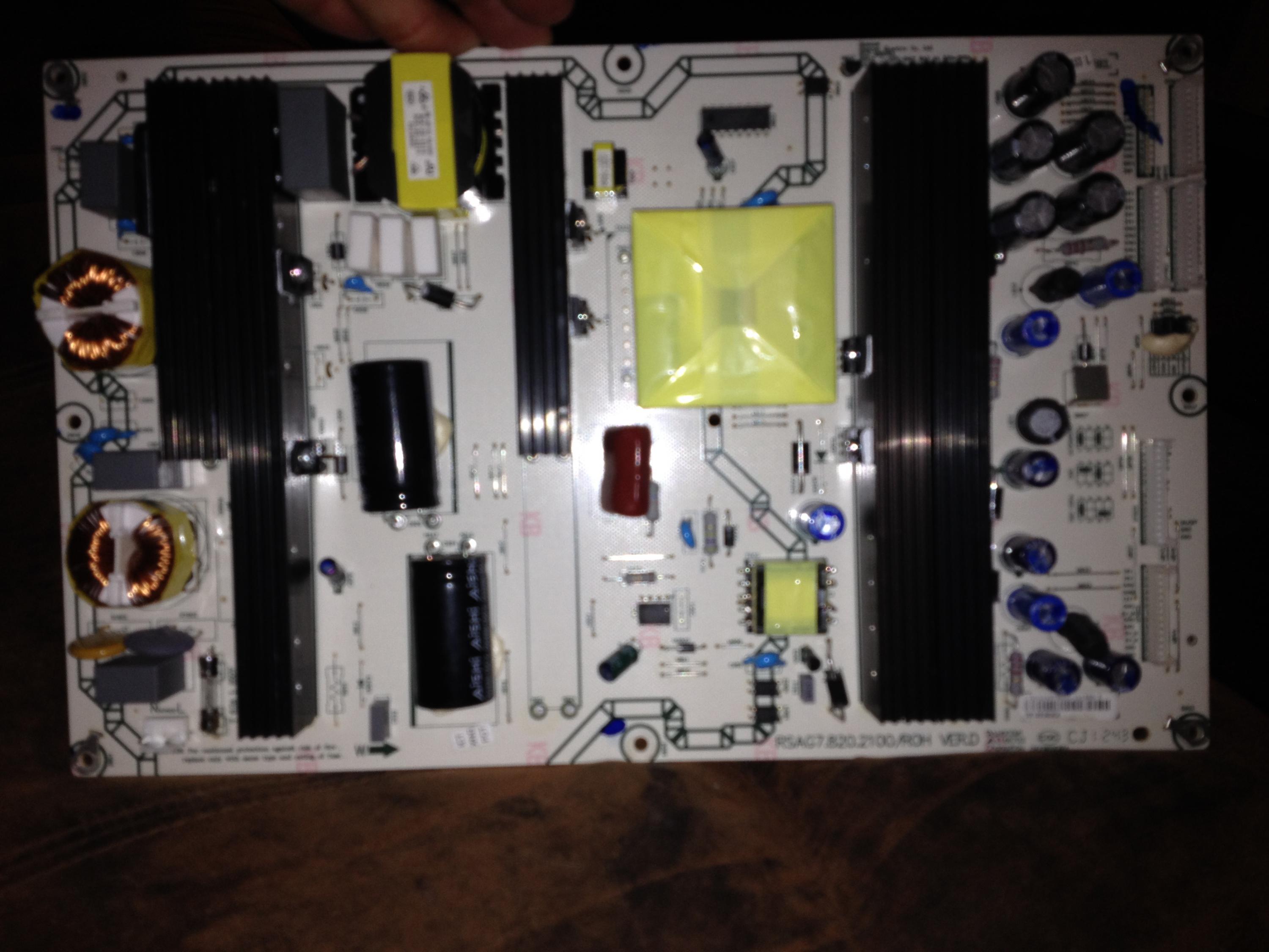

    Re: Insignia NS-55L260A13 LCD TV Won't stay on
    Here are some pictures of the board if it's any help

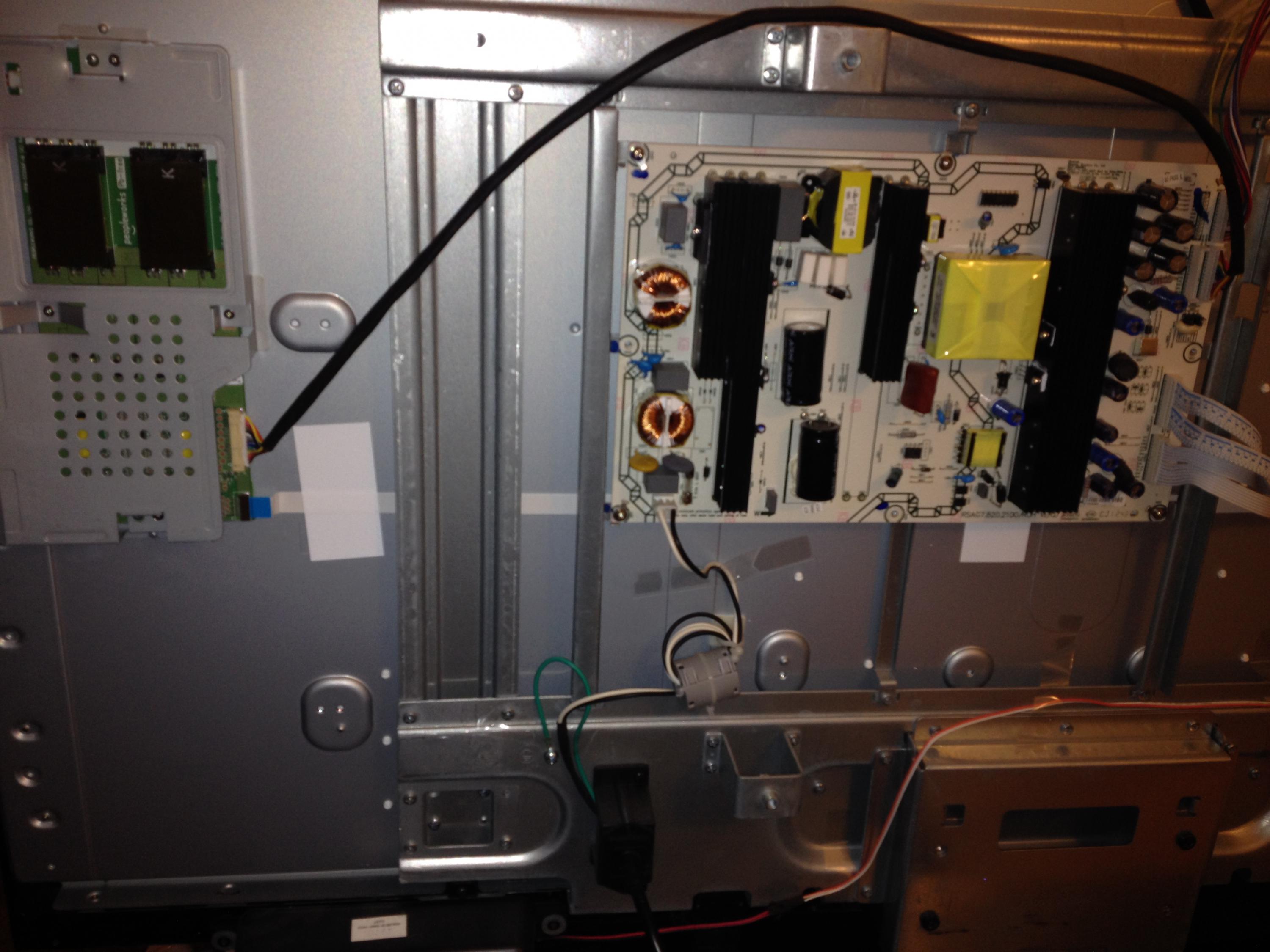

      Can we see the whole back side of the TV so we can see how all the boards are connected and also the pictures of the inverter boards?
        I hope these help, i apologize for the shotty iPhone photography. Thanks again.

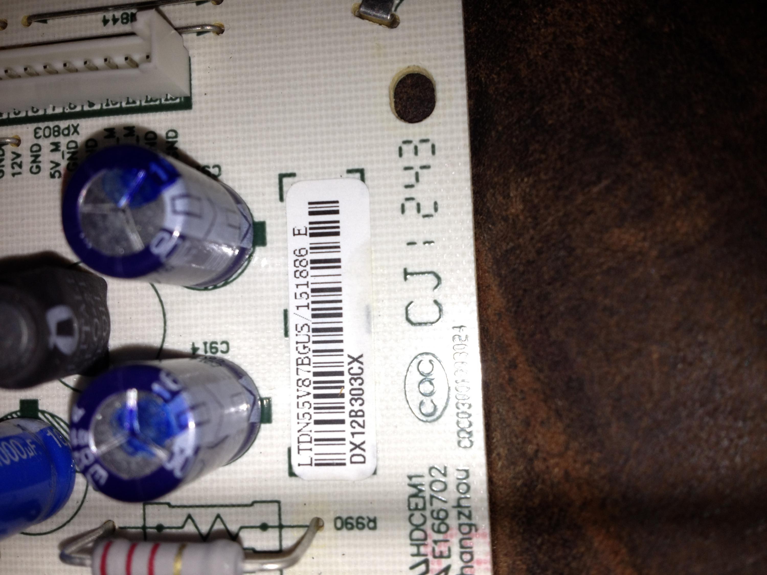

          Hmm, I am surprised that you are able to run the TV with just the master inverter, I would expect the inverter to go into protection shutdown mode.
          http://www.shopjimmy.com/media/catal...1/5/151886.jpg
          Those white connectors on the right side of the board, some of them I cannot read the label next to them. I am looking for INVR_ON/OFF (or BL_ON).
          Can you take closed up pictures of those connectors so I can see what the labels are?

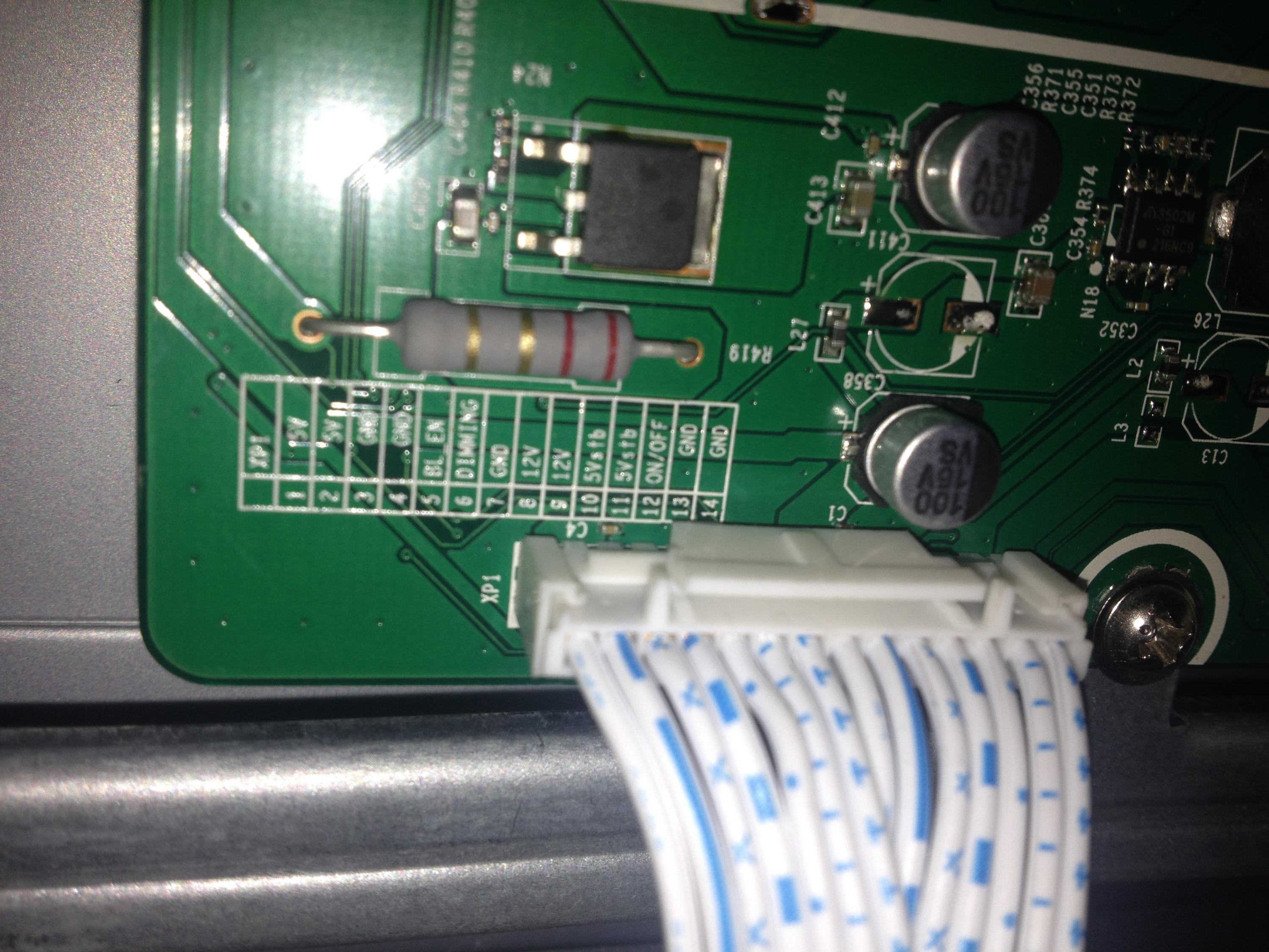

            Heres what i found, this is on the main board.
              BL_EN is the backlights on signal pin to turn on the backlights circuits, when TV is off, it should be <1Vdc, when the TV is it will be >2.5Vdc for backights to come on + dimming signals.
                I checked voltage there and while the set is off it reads 0 voltage. With the set on it reads around 4.5V
                  So it is there even when the backlights flash on and then go off?
                  If it is still there and the 24V is also present at the inverter conector, then the problem is in the invereter boards (MASTER and SLAVE).
                    The only thing that makes that hard to believe is that this is a different set of inverter boards and they do the exact same thing as the other ones did. I guess these are bad as well although they were guaranteed to work.... One other question, at the inverter board i have pins called BR11 BR12 SW1 and SW2 and voltages are as follows when inverter board not functioning but TV on:
                    BR11- 0V
                    SW1- 4.4V
                    BR12- 2.8V
                    SW2- 2.9V
                    Are these normal?
                      Which are the two inverter boards you have in your set? SJ has good pictures that can see things better.
                      http://www.shopjimmy.com/catalogsear...a+NS-55L260A13
                      I suspect that you have bad inverter board.
                          I see the ON/OFF (BL_ON) and two dimmimg controls (vbra, vbr b). BR = BACKLIGHTS DIMMING CONTROL.
                          http://www.shopjimmy.com/media/catal...-0613a-top.jpg
                          "BR11- 0V
                          SW1- 4.4V
                          BR12- 2.8V
                          SW2- 2.9V"
                          I would say is is normal.
                          The MASTER and SLAVE are used due to the lamps are very long for 55" TV, they cannot be driven by juts one inverter from one side of the lamp, the two works in push-pull mode to drive the lamps, if one inverter does not work, you will see half of the screen will be lit and another half will be dimmed due to lamps are not fully lit the full length of the lamps. I still do not expect the lamps to stay on if one of the inverter has failed.
