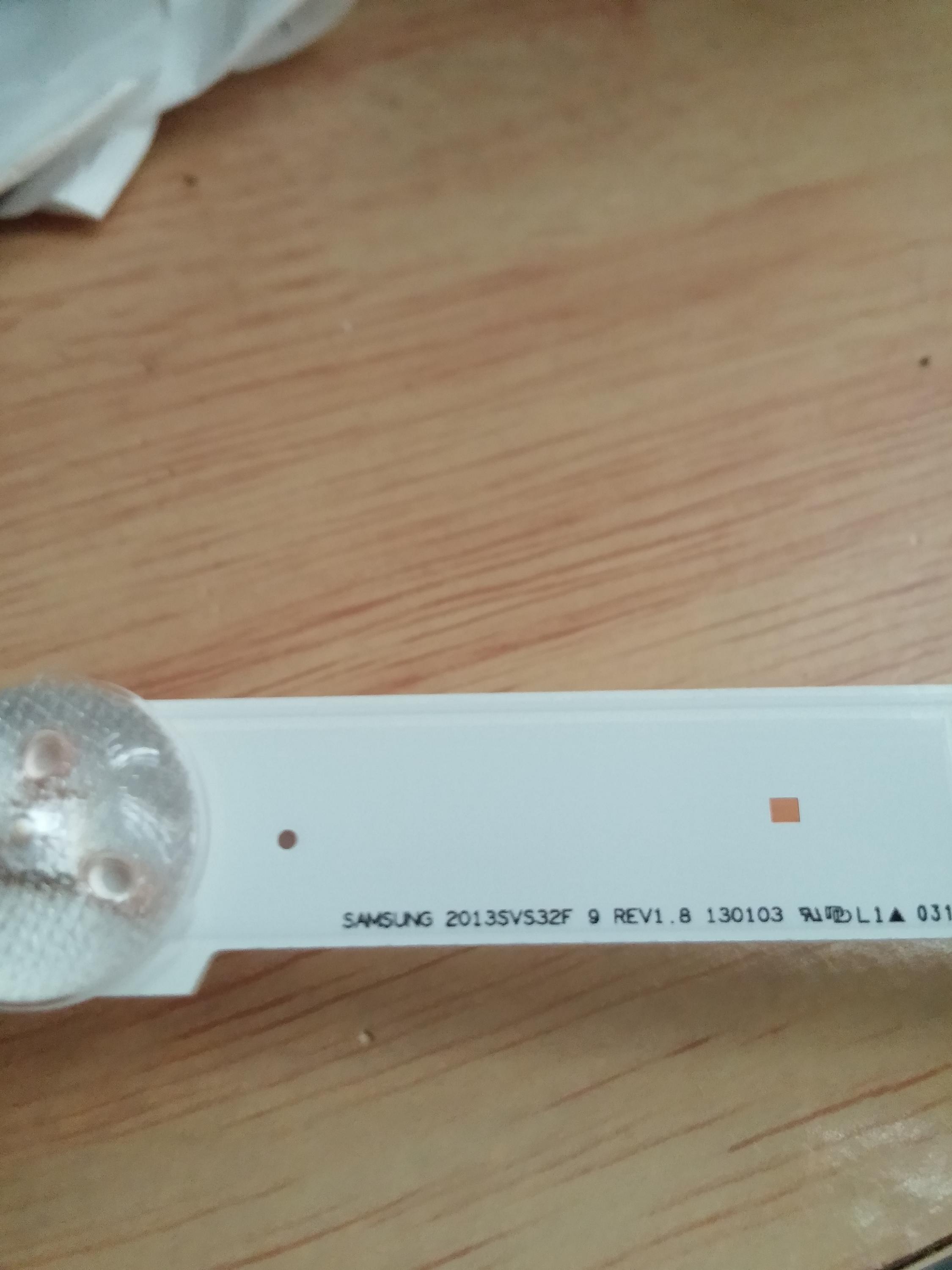

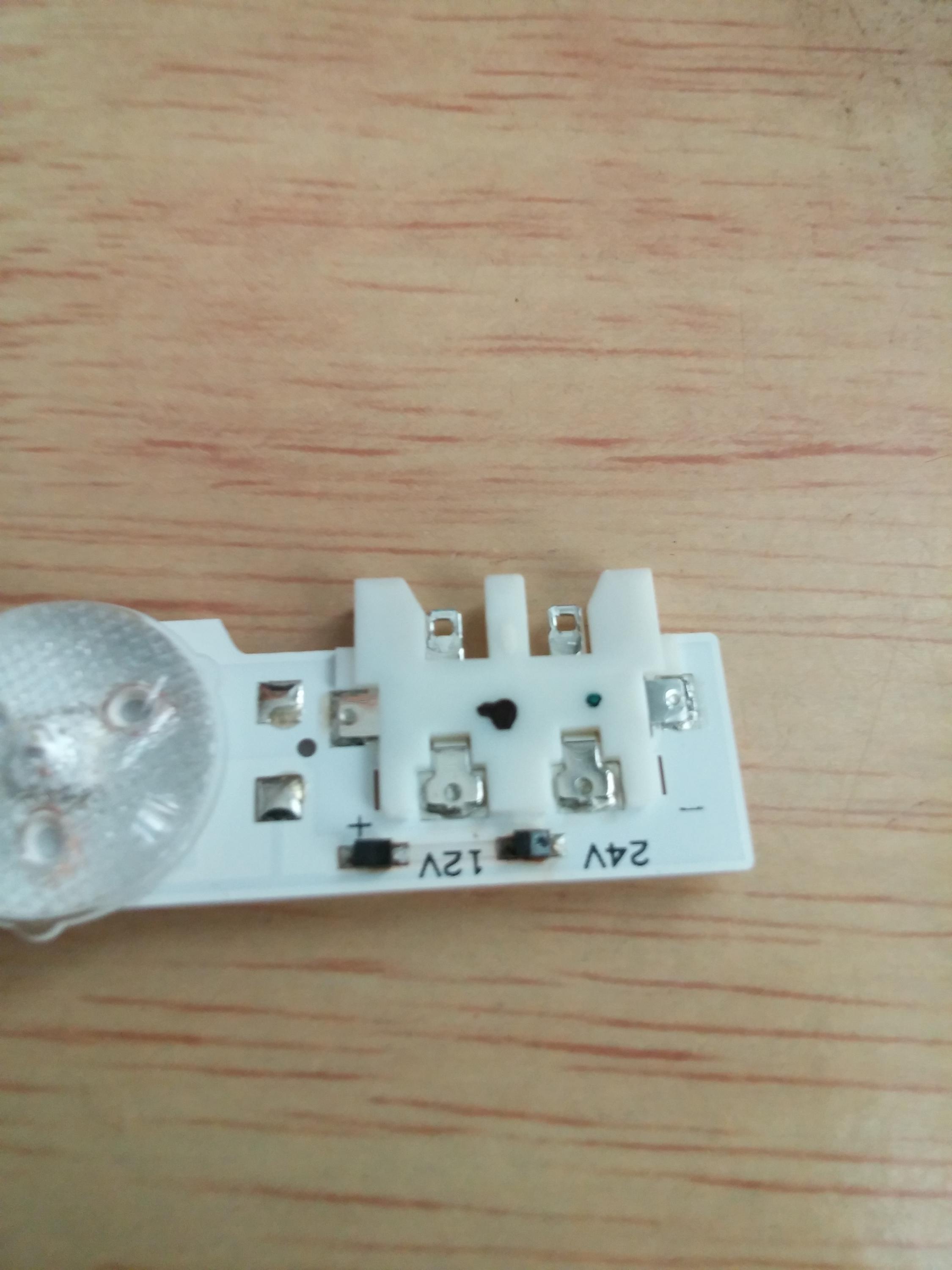

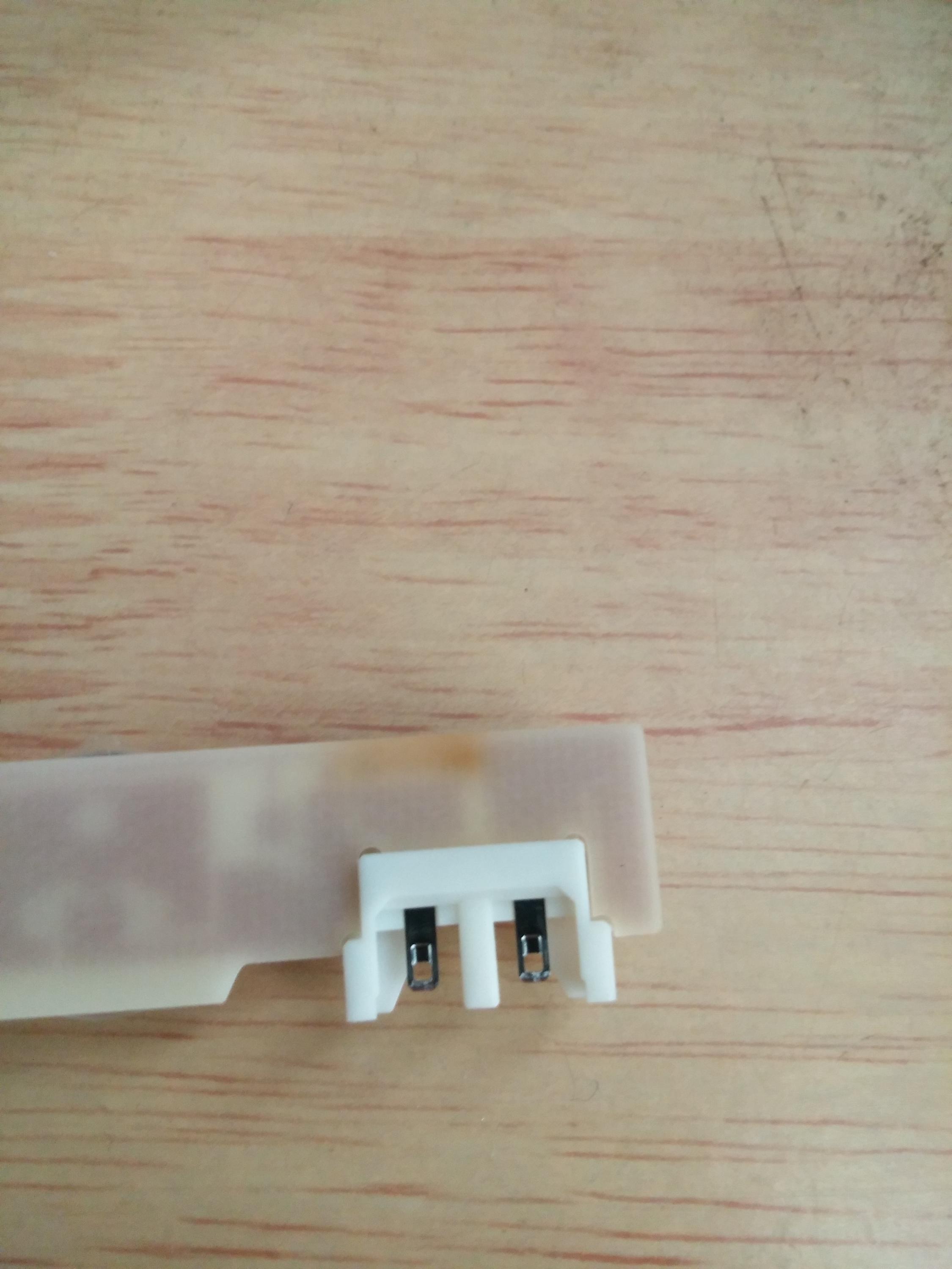

                                        It's been a while, but I got it apart and found one strip with some discoloration, I assume that is the problem one, do you know where I can find a replacement?
