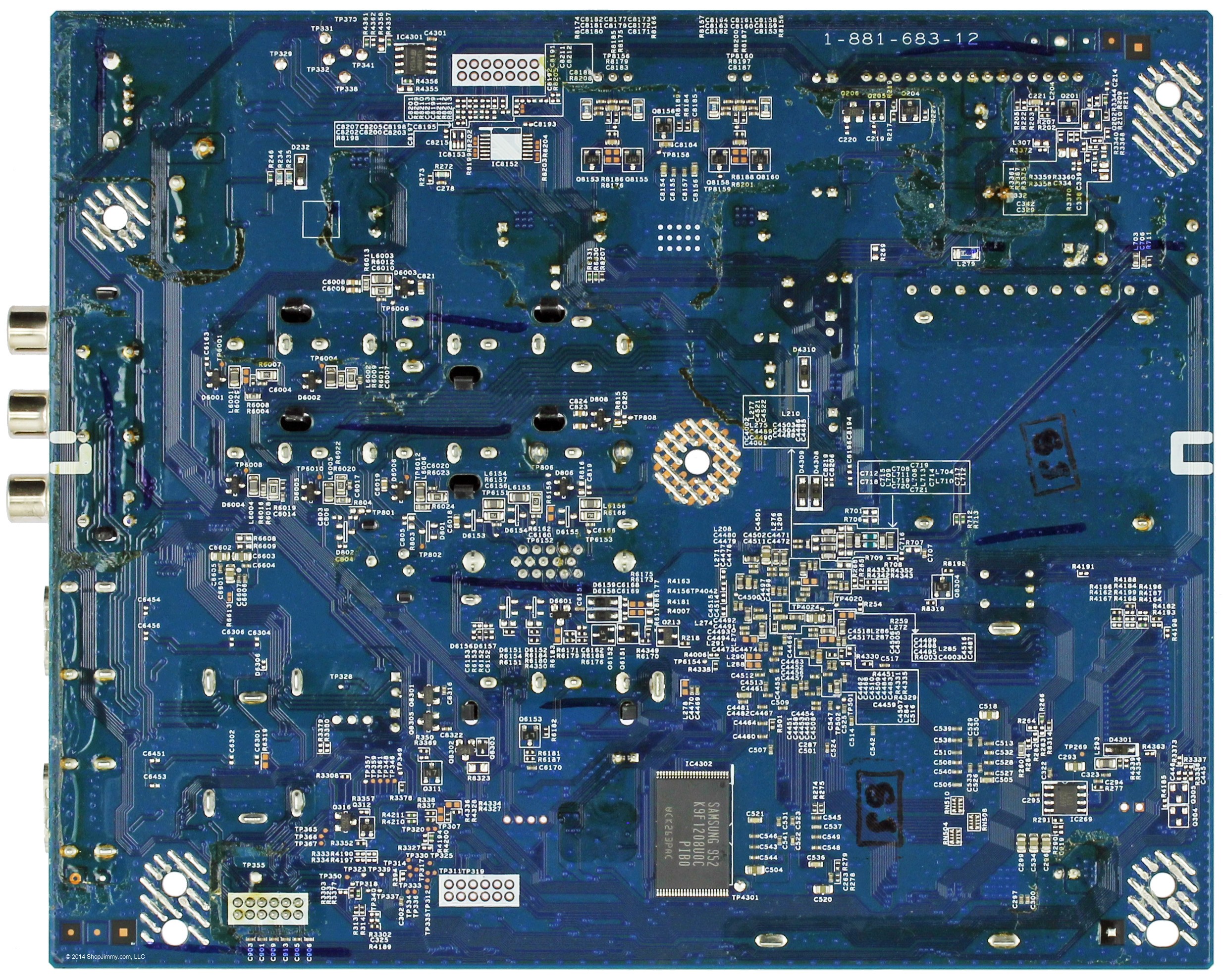

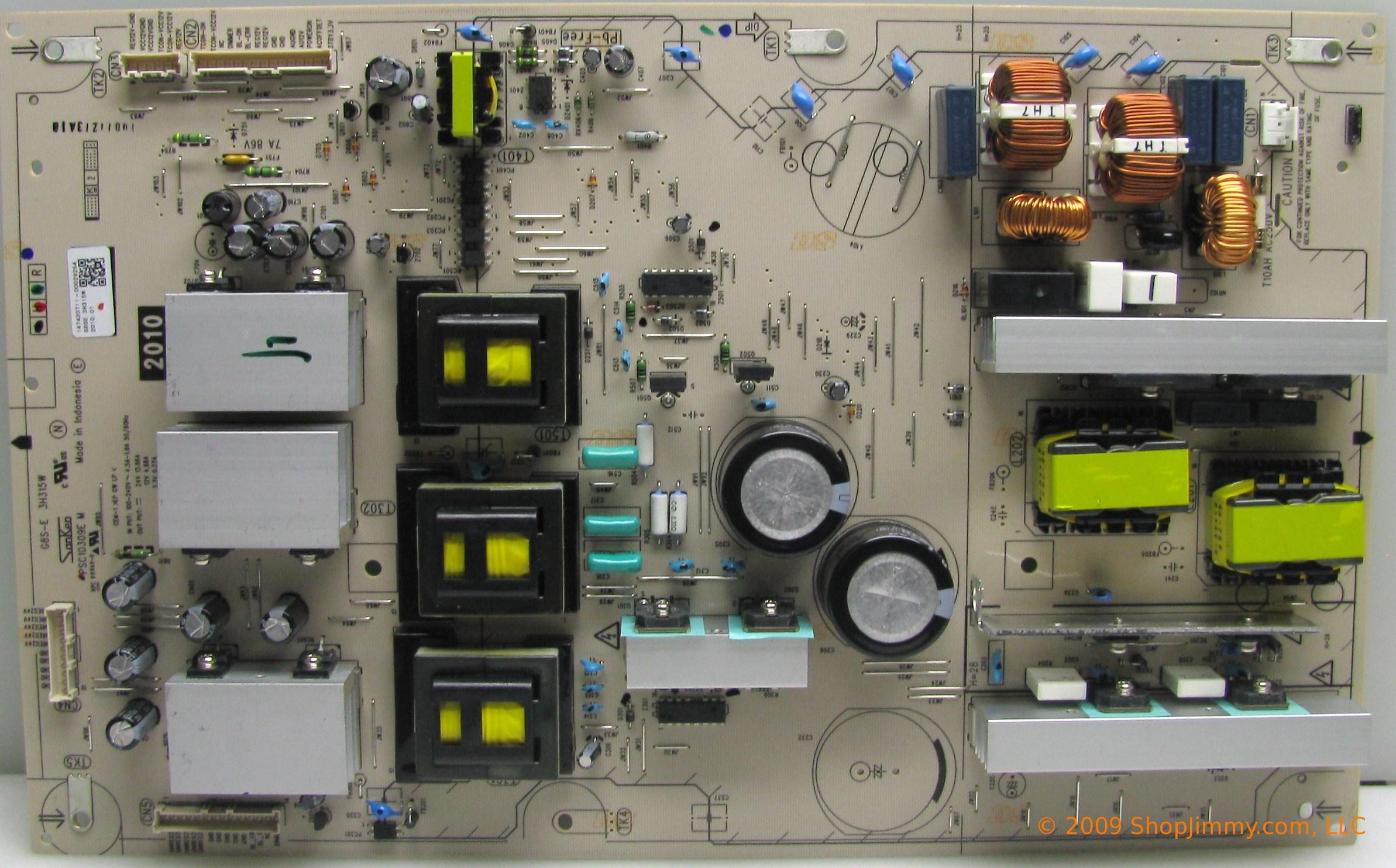

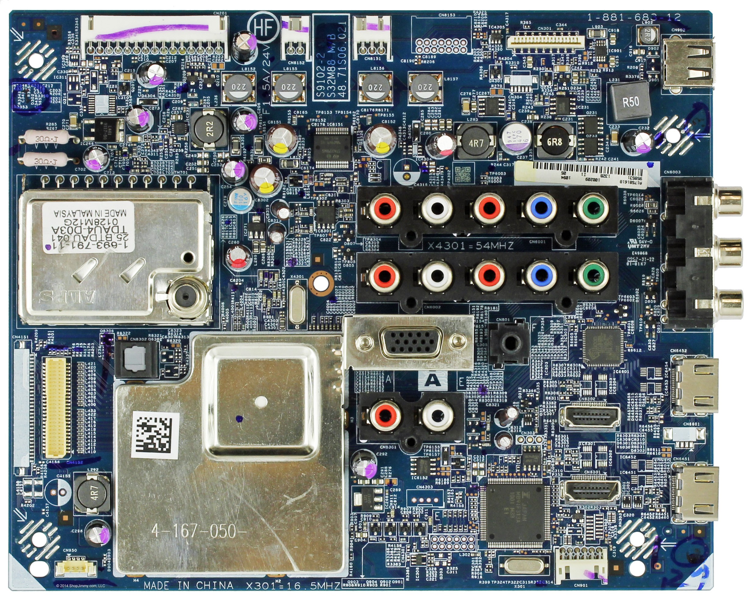

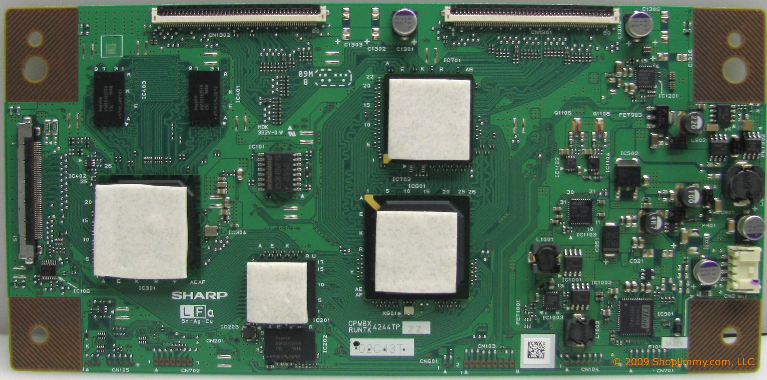

              Re: Sony KDL-60EX500 LCD TV Intermittently No Power
              Here are pictures of the main, TCON and PSU in that order.
              The mainboard picture is of the front and back side of the board.
              Any idea how I could start to find out which of these 3 boards is the fault?
                Start reading page 12 of the training manual.
                "when the fault happens the unit will not even power off with the remote or the side buttons the power led just stays green" This seems to indicate fault in the main board.
                  Thats what I was leaning to as well. it still could be the mainboard even though when the fault happens there is no image or back light at all?
                  what happens is you plug the set in then I get the red standby light no blinks or anything just steady as it should. then you press power and the green led comes on as it should and the psu relay makes 2 clicks instead of just the one like its supposed to and there will be no image or no backlights or anything. then if you try to turn it off via remote or button it just keeps staying in the green like its on and wont turn off. you have to unplug it from the wall outlet. when the unit is in fault mode i get all voltages from the psu except for the two 12 volt lines going to the tcon they are at 0 when the fault happens
                  when there is no fault the two 12 volt lines from psu to tcon has 12 volts on them. the tv does this problem intermitent.

                      I have. when the set is not working its missing the two 12 volts from psu going to tcon.
                      when set is working all voltages from psu are as they should be.

                        Can anyone shed any light on this one. I'm throwing boards at it with no success. have already thrown a psu at it and a main and same problem. someone in here mentioned its probably the main well I threw a main at it and still didnt work. unless the boards i'm getting are faulty don't know.
                        At least when I got the psu it worked for a little bit then did the same problem again after a day. Putting in the main did absolutly nothing.
                        measured the voltages again on the psu and like I said both 12 volt pins on the psu labeled tcon 12v is at 0 volts, but should be at 12 i am getting the 3.3 standby voltage when I power on the set its supposed to get 3.3 volts i oly get 3 volts don't know if thats an issue. this unit is supposed to blink when there is a fault yet I could disconnect tcon, inverters etc and no blink codes at all.
                        please someone help im $300 in already
